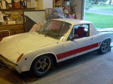

Click to view attachmentClick to view attachmentHi All:
Been looking for a car to drive daily that get some mpgs. Found a nice RX-7 and a 944, then remembered a friend of mine has had a 914 for 20 years, garage kept the whole time. He takes it annually to a mechanic to see if it needs anything. Right now, won't start and they think it needs starter.
It is for sale. He asked me to "make offer". I don't know anything about these cars except for what I read here, so looking for a little help.
1972. Think it's original motor and F.I.. Said to run well, and I believe what they are telling me, but I would be buying it "as is" without hearing it run or driving it. They drove it about a tank of fuel's worth every summer for the last several years.
Obvious Problems:
Surface rust on back truck floor (think I could Por-15 it)
Rust bubbles on body, including under both door handles
The rear trunk hinge mounting tab is broken at the body. (Needs welded?)
Missing rubber pieces over bumpers (are there any decent used ones?)
Missing side marker lights
Repainted. Original color was orange. Repaint is lousy
Top of roof not smooth. (This bad paint or maybe a repro roof?)
Seats re-done in red velour (yuk!)
Needs starter or ?
Car shows 85k miles but ODO has been broken for 20 years.
Basically a 40 year old car that's never been restored.
What do you think it's worth?
These things sure look fun!
Thanks!
Rand

The most important factor is how bad the rust is under the battery tray, down the frame rail toward the firewall, along the rear corner of the floor on passenger side, around the suspension console, etc. You'll hear it called "the hell hole." That one area will determine the car's value more than the other items you listed combined.

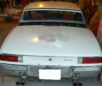

The standard roof was not painted. It looks like fiberglass. Rough, pebbly surface and they were flat black. I guess it was the 912 that had a roof that matched the car, but it did not come off.

Rust will be much worse than it looks. $1500

tops originally had the textured finish. sounds like the one you're looking at was just painted over.

if there's not too much rust, see if they'll take a grand? someone else here recently got a decent one for $750! i recall paying $1000 for my '71 1.7 w/ very little rust (ca car) about 15 years ago. if it were running w/ little to no rust, it might be worth $2000-3000 or more.

That car could definitely be a DD, but you will need to go through every bit of it to do so. I wouldn't buy it without inspecting it with a magnifying glass for rust. These have been known to rust in half from time to time...
