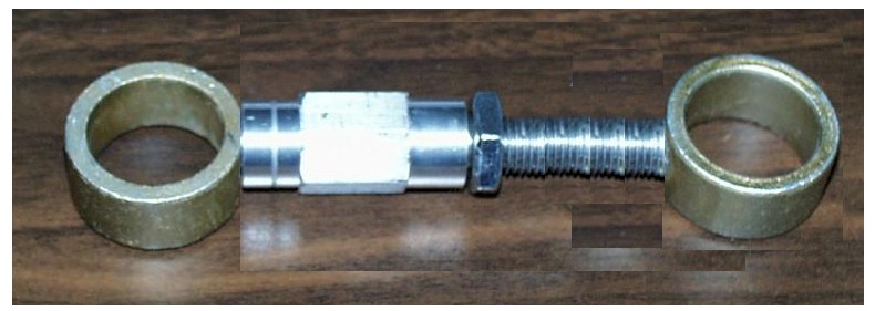

If you make these, make one side adjustable
http://www.914world.com/bbs2/index.php?sho...41858&st=20
See post #29
Linkee doesn,t seem to work
This is how I did mine.
Paul

i'm thinking one side should have screw -and one side should receive it?

Standard and reverse threads so it can expand and contract as needed.

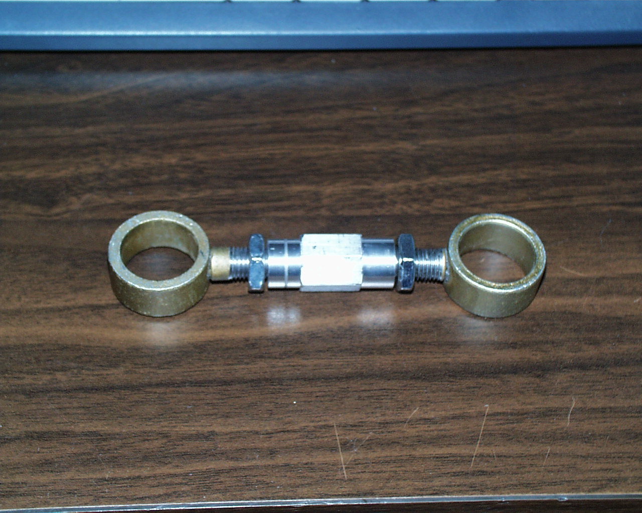

Here is a titianium pair, 3/4" shorter.

I agree with Eric. You would want to be able to adjust the pre-load without removing the link on one end.
Personally, if I was going to go through the trouble to make them, I would just make both sides adjustable. I know that you only need to adjust one side for pre-load, but why bother with two designs.
