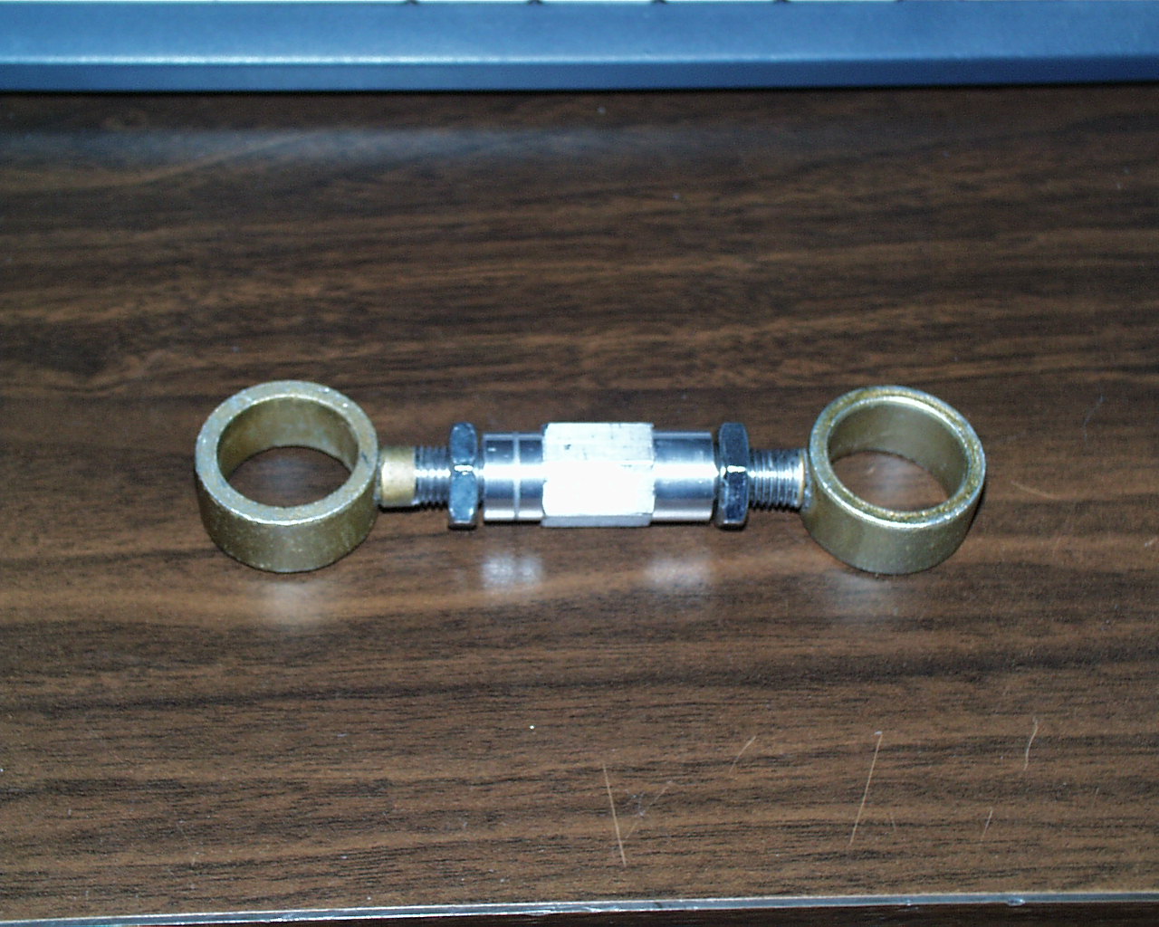

If you make these, make one side adjustable

i'm thinking one side should have screw -and one side should receive it?
what do you guys this about this and about price point?

Standard and reverse threads so it can expand and contract as needed.

clearly there are some that would like a simple set - like stock
and a more elaborate set that is adjustable

I agree with Eric. You would want to be able to adjust the pre-load without removing the link on one end.
Personally, if I was going to go through the trouble to make them, I would just make both sides adjustable. I know that you only need to adjust one side for pre-load, but why bother with two designs.
