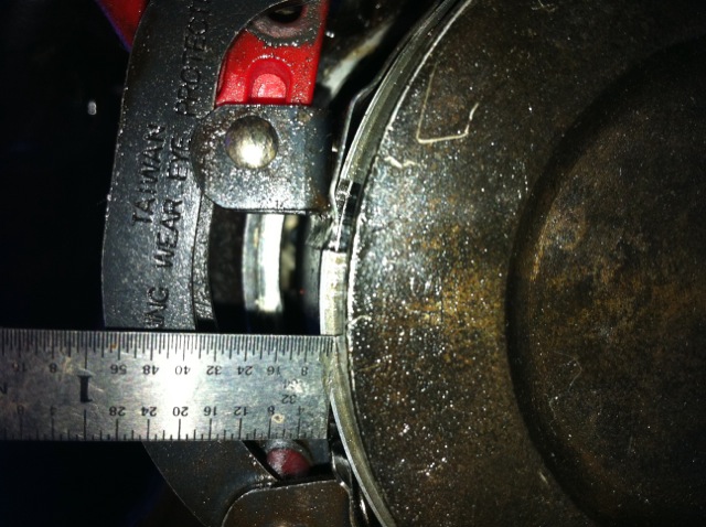

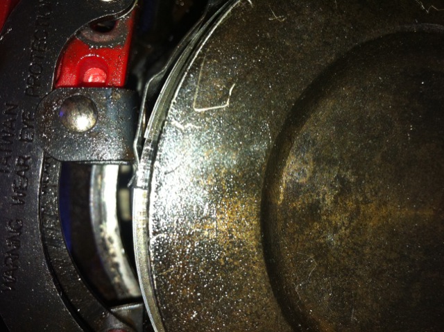

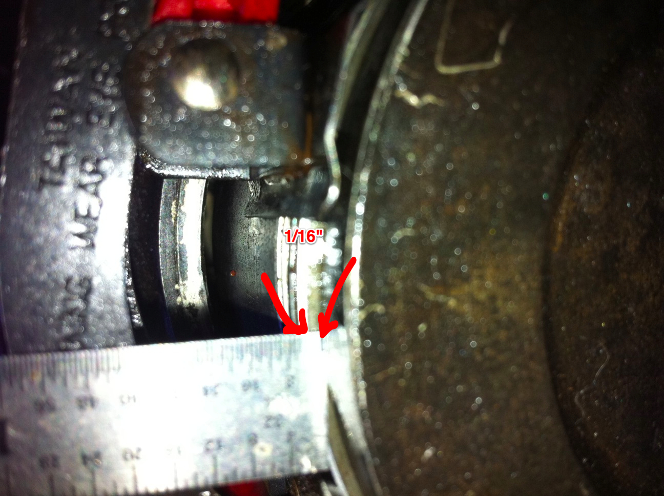

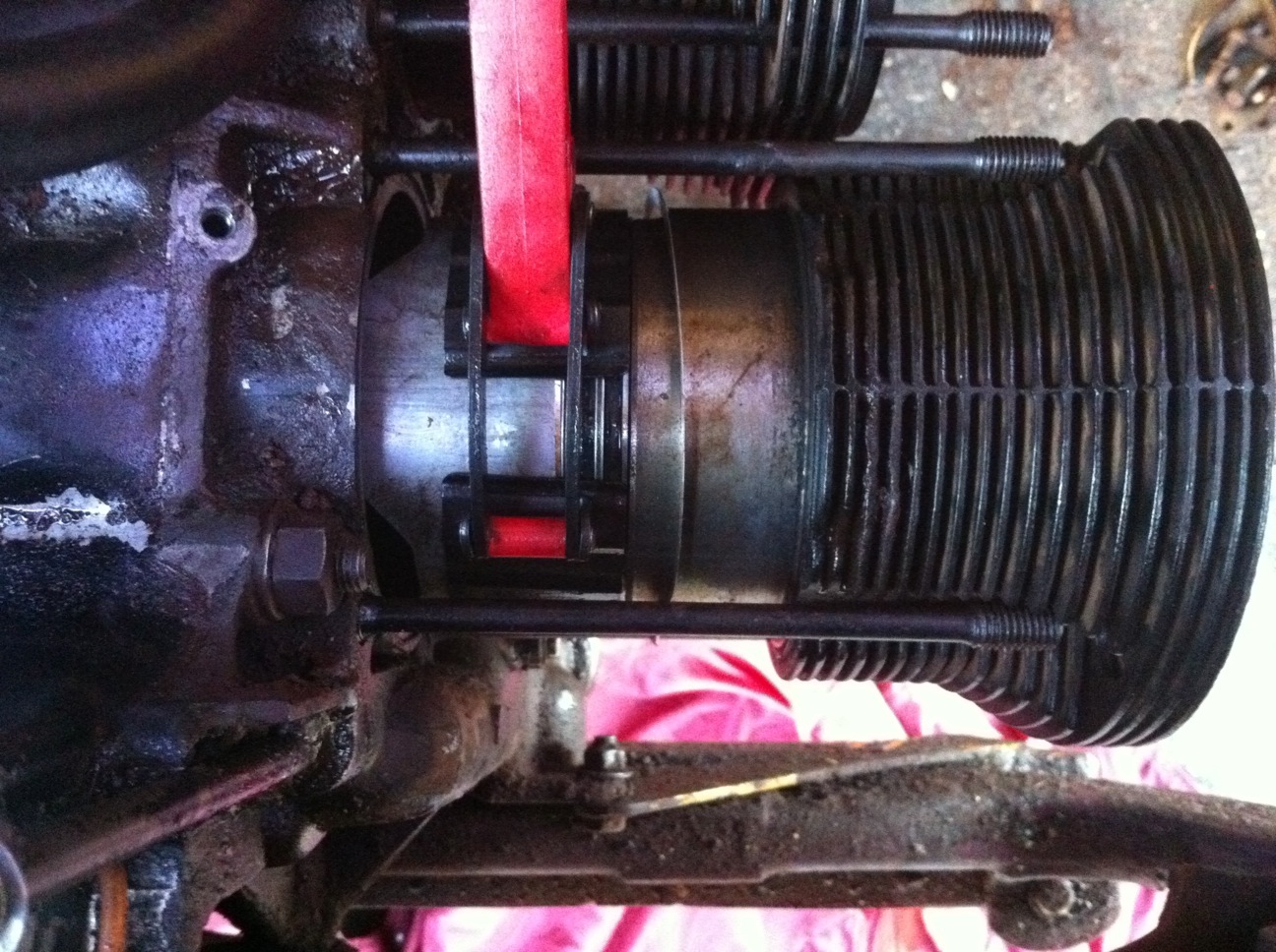

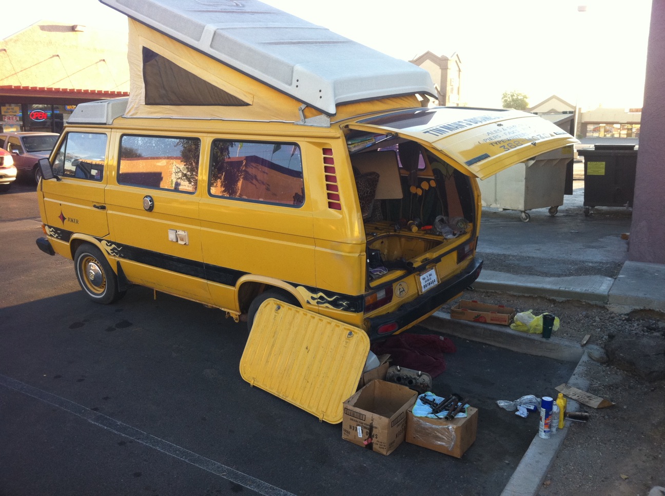

Here are some pics, the ring sits out about 1/16th of an inch. I used pretty good force this morning, using a piece of wood over the end of the cylinder and wacking it with a, um... rock (IMG:style_emoticons/default/blink.gif) as I don't have a hammer (IMG:style_emoticons/default/dry.gif) ... and it didn't budge. Don't worry, I tried and stopped after a couple of hits. Egad!
Anyway, here they are...my lovely location, and the cylinder in place, trying to go on, and the ring up close with a measure...

Ok. I'm with ya now. It appears you're ring is too thick, but you said the other went on ok. Pull the ring off and try to insert the outside of the ring in the groove to check for proper thickness. One little speck of debris in the groove will give you fits.

It appears to be flush on the bottom 1/2, but like the pics on the top half of the piston?! Weird.

If you compress the ring and place it in the cylinder( without the piston) and there is end gap filing won't help, don't file the surface contacting the cylinder wall or it will never seal.
I would check the groove where the ring sits, probably dirt keeping it from seating. You could check it against the old ring if you still have it, see if it wrong size but if one went together probably dirt.
Good luck

Either your ring compressor is catty wampus or worn out and not compressing the ring as it should, wrong size ring (which I doubt as the top one fit), the ring groove has trash in it, or your not holding your mouth correctly (IMG:style_emoticons/default/happy11.gif) If it is really tight in there and you suspect that the compressor is misaligned you could go to the hardware store and get a large hose clamp, instead. Someone here will step up and assist if your close enough. Good luck, buddy!
EDIT: Are you getting the compressor on squarely or just squeezing it and calling it good? It really helps to get a good square position before compressing.
