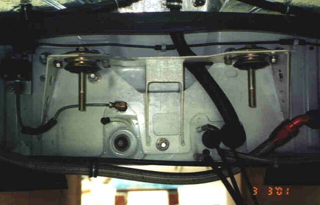

I have recieved a couple of pictures showing the bulkhead mount for the front motormount, I understand how to center the mount left to right. (east-west) How do you determine how far up or down it goes. I'm running zenth carbs with rainshield aircleaners. I realize the north/south adjustment will help in their clearance. How far up or down? Help me out you 6 converters you!!! (IMG:style_emoticons/default/pray.gif)

Mine is the Velious type and it rests on the lower lip.
Couple things:
With the short manifolds, my 2.4L fit in....barely..... with watershields.
The tall manifolds on the 2.7 caused me do do some percussive modifications to the rear firewall.....that was after I used some spacers to lower the front of the motor bout 1/2 inch.
You *should* be OK with the Zeniths....at least for clearance (IMG:style_emoticons/default/biggrin.gif)

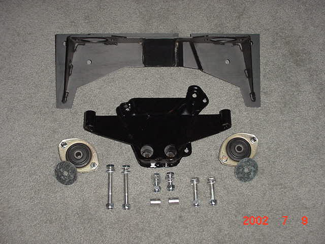

Hey JP,
what does the mount look like that attaches to the engine?? Or does the engine mount directly to the bulkhead mount??
thanks
JWest
post Jul 27 2004, 01:44 PM
Posts: 1,663
Joined: 6-January 03
From: Fort Worth, TX
Member No.: 97
Mike, here is the complete mount.
Mueller
post Jul 27 2004, 01:49 PM
914 Freak!
Posts: 17,155
Joined: 4-January 03
From: Antioch, CA
Member No.: 87
thanks, I couldn't figure out how the darn thing fitted (IMG:style_emoticons/default/smile.gif)
any idea if he sells the kit minus the nose cone (piece on the engine)?
my VR6 swap might be easier with a bulkhead mount
