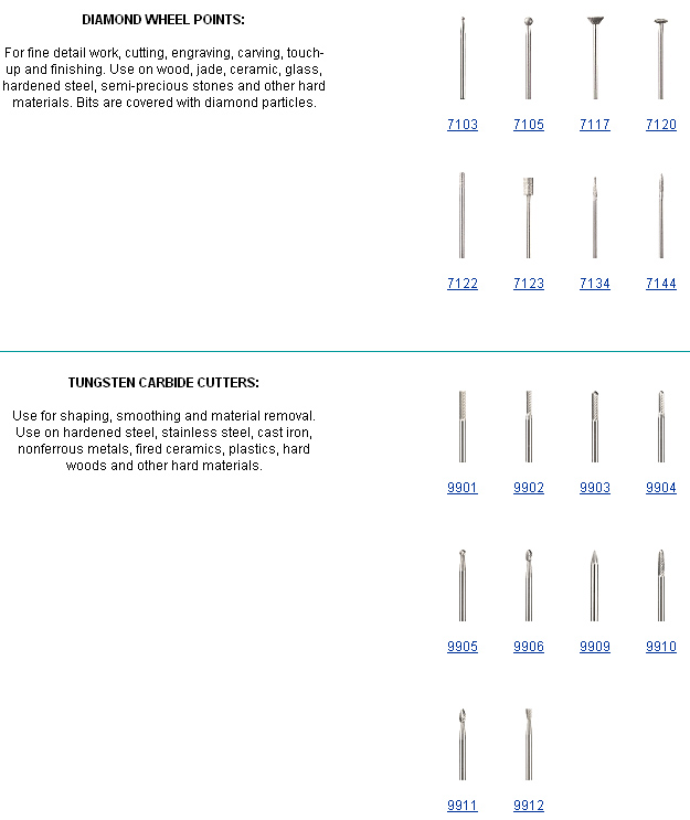

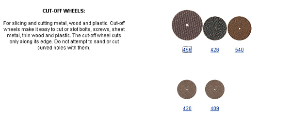

yeah, I'm trying to make it pretty. I want to be able to remove material where I want to only.
This is what I've found at the Dremel Webpage. Would these be better than Aluminum Oxide?

Carbide cutters for a die grinder are the best I've used.. they really hog out the material, you can litterally carve out the bead from an inside corner (like inside the front trunk weatherstripping groove for instance). Unfortunately they're pretty expensive. They also spray you with little metal shavings that are VERY sharp, and get under your skin quite nicely.

if you have the room, I think the small cutoff wheels are better and easier to control for removing material.

the problem with the carbide cutters is that it is very easy for the tool to "ran away" from you, or at least that is my experiance (too much coffee???)

I have more trouble with that using dremel tools than with die grinders.. not sure why.

My experience with the Dremel cutoff wheels is they don't last very long. The medium brown colored ones that look like something pressed together last only a few seconds cutting steel, and break very easily. The fabric-looking ones last longer, but still rarely more than a few minutes. You can actually watch the things shrink. You seem to remove about as much material off the wheel as you do steel from the weld...
There's a speed control you can get for a Dremel that will allow you to slow it down a good bit, which might help. I have a variable speed Ryobi with a flex shaft, and slower speeds seem to extend the life of cutters and grinders a bit, but only a bit. I think the slowest speed on this thing is still way too fast. My air grinder is quite a bit slower.

I have had this experience also. They tend to bite in and gouge at exactly the wrong time. I always end up making a bigger cut than I intended.

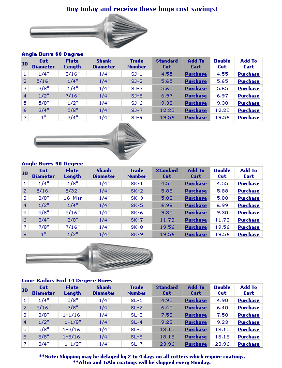

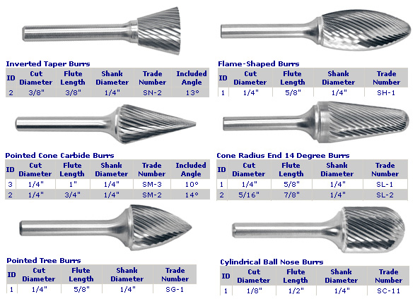

I found these and other bits at: American Carbide
What is meant by Standard Cut and Double Cut?

That cone radius ruby is one of those I use.....and that's a very good price. Dunno the difference...but at those prices, get one of each in the 1/4 or 5/16 size & see which you like. I get em' at a tool supply outfit up the street for about 12 bucks each. (IMG:style_emoticons/default/sad.gif)

I ended up buying these carbide bits from the vendor listed above. 8 bits delivered for $45. Seems like a deal to me (IMG:style_emoticons/default/biggrin.gif)
