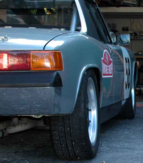

machina
post Jul 29 2004, 03:44 PM
Posts: 2,030
Joined: 21-June 03
From: Miami Beach, FL
Member No.: 848
7's, no flares...
Aaron Cox
post Jul 29 2004, 03:49 PM
Professional Tinkerer
Posts: 24,548
Joined: 1-February 03
From: Corona, CA
Member No.: 219
camber and offset play a role tho (IMG:style_emoticons/default/wink.gif)
