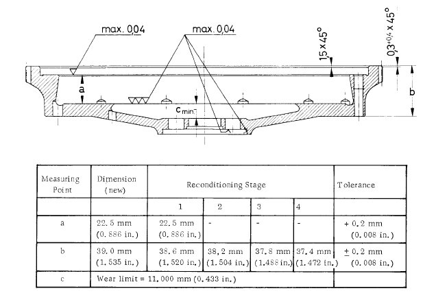

I just received a new Sebro flywheel from Pelican.
The new flywheel has the proper A an B measurements, but 'C' is only 9mm. According to the chart below my flywheel is already out of spec by 2mm! Has anyone else encountered this?

Is it made out of a better/ different alloy? That might be why....did you cal and ask them? That's what I would do first.
I do know that if your going for a lightened flywheel, slot of material has to be taken from somewhere to make a noticeble difference

9mm is correct for the type 4.

QUOTE(rjames @ Oct 21 2011, 08:48 PM) *
IIRC someone said that this is the spec chart was for a -6 flywheel , not the -4 flywheel. I could be wrong , but the thread concluded that the 11mm dimension was for the -6 not -4 . Maybe search would help.

QUOTE(sixnotfour @ Oct 22 2011, 04:30 AM) *
Ahhh.
Perfect, thanks!

Where does that information come from? I cannot find specs for the -4 flywheel; only for the -6 one.
