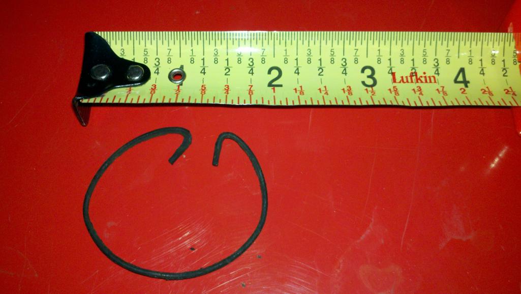

I am in the last stages of getting my car back together after almost 4 years. I was cleaning/organizing the garage, getting ready to put the engine back in, and I found this on the floor. (IMG:style_emoticons/default/confused24.gif)
I vaguely remember seeing it before, but I can't remember what/where it came from. To give you an idea of where it could have come from, I will tell you where I have been.
- removed engine/tranny (75 1.8)
- rebuilt tranny
- took engine down to shortblock, replaced accessable seals, did a lot of cleaning and painting
- removed gas tank, replaced all soft lines, filter
- ran SS fuel lines in the tunnel
- replaced all vacuum hoses
- replaced 1.8 exhaust with SSEs, 2.0 ducting and a bursch
Getting ready to put the motor back in, but I would really like to find the home for this thing. (IMG:style_emoticons/default/unsure.gif)

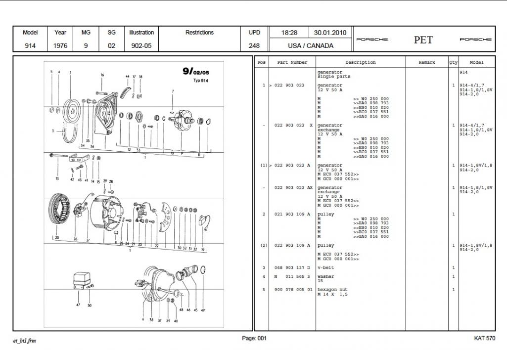

I think its the clip that holds in the cooling boot for the alternator on the shroud side.

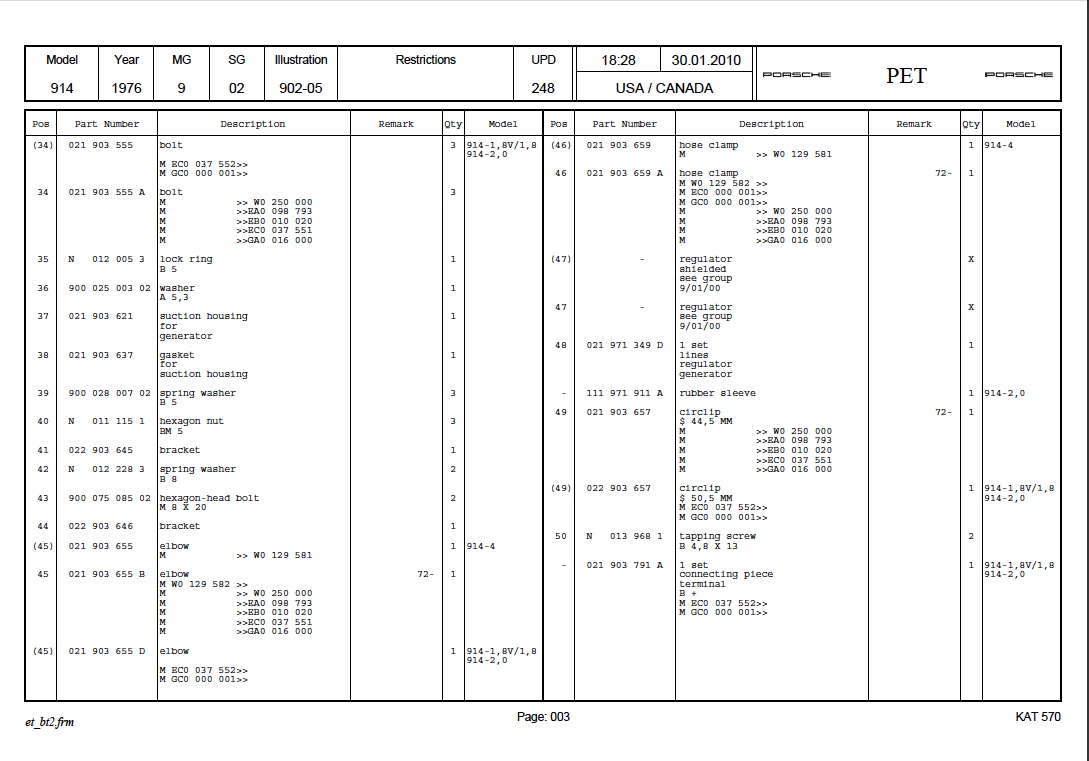

It IS the clip for the alternator. #49 below. Measures 44.5 mm... roughly 1.75" You have to take off the front of the shroud to get at it.
