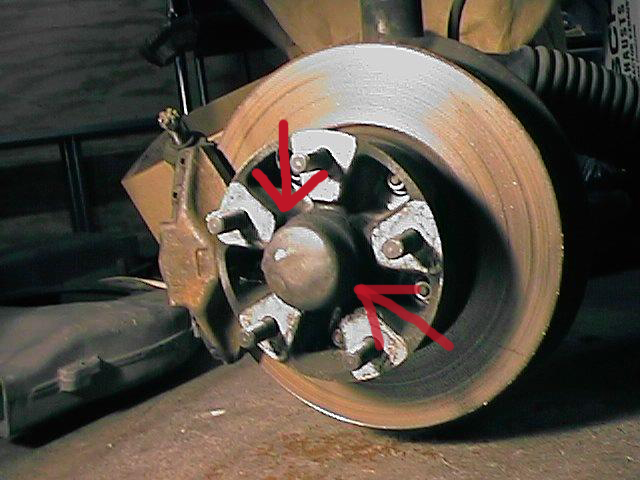

Well, I've got a 1986 911sc front suspension that I want to bolt onto my 914 but wa would like to replace the rotors. I can't even get pass the center cap !!! Does anyone have any suggestion on removing this cap??

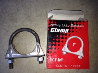

Buy this clamp from local auto parts store, should buck or two. Clamp it on the dust cap then you have something to use your pry bar against, work it evenly on it one side then the other. Thats what I use. I cant take credit. I read it on the pelican board.
Good Luck

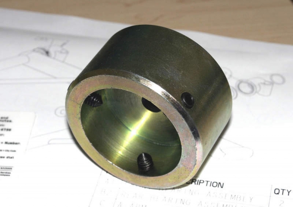

The inspiration for this came from helping Matt DeMaria of Stuttgart Performance Engineering tech my car for a DE one weekend. Matt said my front bearings were loose, and told me to remove the dust cover and tighten them up. So I asked him "You got a big ol' chisel I can use ta take the dust cap off?". Matt looked at me like I was insane, and then proceeded to explain to me that pounding the dust cap off with a chisel like a ham fisted gorilla eggs out the hub, which is made of aluminum. Do it too much, the dust cap won't seat anymore and you have to buy new hubs. "Fair enough. So how do you remove them?" I asked. "With this - the factory tool made specifically for this job" he said. (BTW, this is how Matt does everything - the right way, with the right tool. Its pretty impressive to watch him work on stuff, IMO).
Turns out, the the factory tool is a pretty simple contraption - a metal cap with 3 set screws attached to a slide hammer. The cap goes over the dust cap, and the set screws are tighened into the groove around the cap. One good whack with the hammer and you're done - cap off with no side load to egg out the hub. Here's a picture:

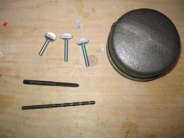

Step 1. Get your materials. Here's what you need:
(1) 2" cast iron pipe cap.
(3) #10-24 x 1" Thumbscrews
(1) #10-24 tap and drill bit set
(1) Bolt (M6 x 25mm in my case) to attach the tool to your slide hammer
(1) Slide hammer. Mine is a $10, 10lb POS from Harbor Freight. One of the best $10 I've ever spent on a tool.

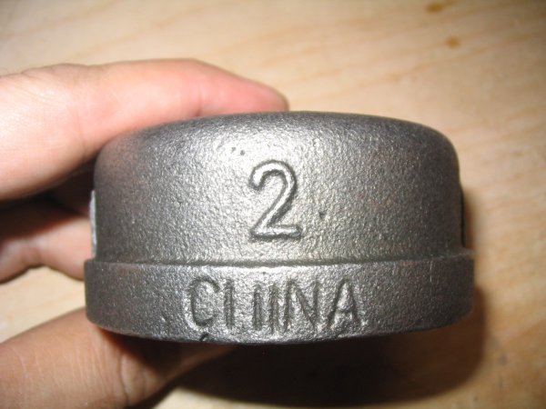

This is the key to the whole tool - the 2" cast iron pipe cap. $3 at Home Depot, IIRC.

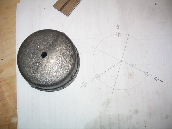

Step 2. Drill a hole in the center of the top of the pipe cap for the slide hammer mounting bolt.
Step 3. Mark around the edges of the cap at 120 degree angles. You can see the template I used in the picture above. This doesn't need to be super precise, obviously.

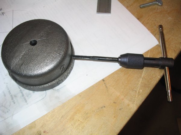

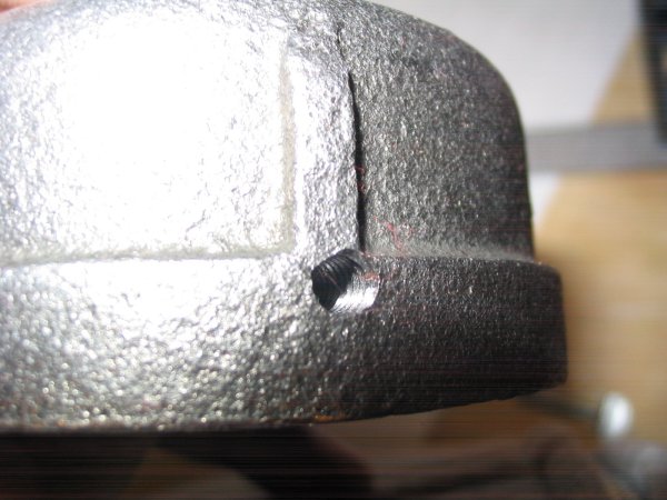

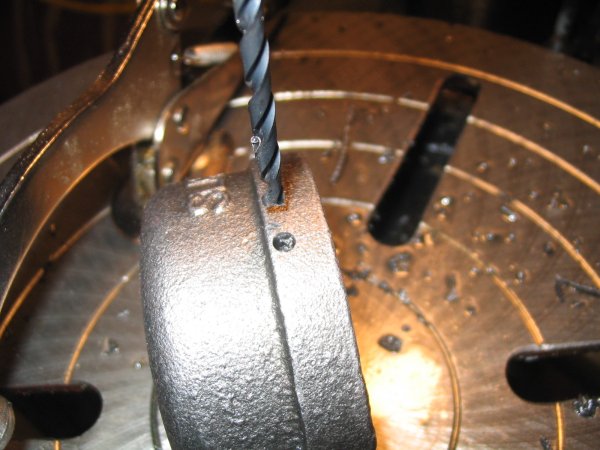

Step 4. Center punch at the 120 degree marks 8.5mm (0.330") from the edge of the cap. Drill with a #25 drill bit.
Step 5. Tap the holes with the #10-24 tap. I bought a cheap drill and tap set from Home Depot for #10-24, came with the right drill bit for the tap. Remember to use a lubricant when tapping the hole (always a good idea ). This cap is cast iron, which is soft and taps very easily.

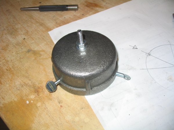

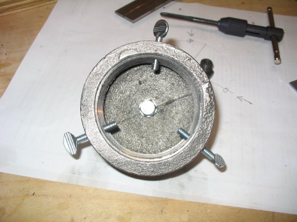

Step 6. With all three holes along the edge drilled and tapped, install the thumbscrews and the slide hammer attachment screw.
Here's a shot from the bottom, showing how the thumbscrews will grab into the dust cap groove:

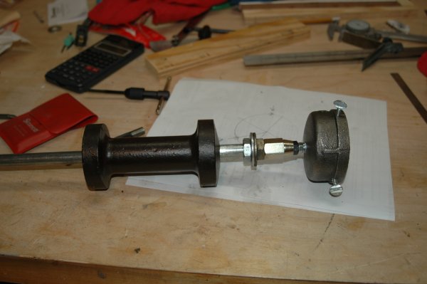

Step 7. Attach to the slide hammer...
And you're done! Total time to build, about 30mins.
