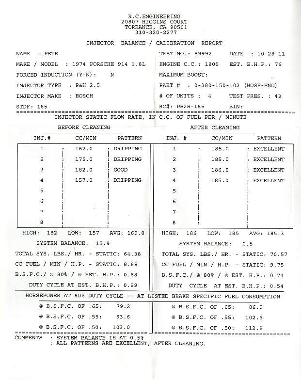

While I am replacing all my fuel lines and having the intake manifolds powder coated I decided to have the injectors checked out.
Three were OEM VW Bosh units (Grey) and one was a green aftermarket one.
I picked up three extra OEM Bosh injectors at a good price, but had no idea if they even worked.
I took in all six OEMs and asked RC to weed out the not so good and give me back the top four units.
Here are the results, and RC was super nice and turn around was next day ! I highly recommend them !! (IMG:style_emoticons/default/smilie_pokal.gif)
When I picked them up they asked if the car was even running ! They were way off and these were the best four !
Here are the test results...Perfect, and right on spec !

I've used both Witchhunter and RC Eng. on several cars, including my present Suby-powered 914 project. Witchhunter charges $20/injector, while RC charges $24/ea. Both include new new o-rings and pintle screens, and they send 'em back quickly with spec/flow sheets. One of the best WIIT (while I'm in there) things to do...
