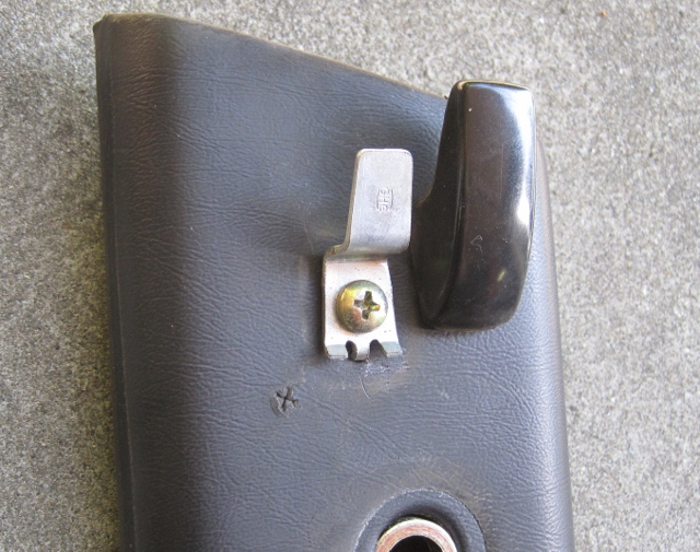

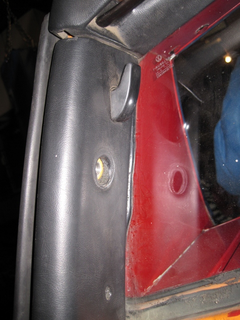

So I am in the process of reattaching the rear window glass since it rattles. But kinda stuck at the vertical targa pads. After removing lower screw and 17mm bolt for the seat belt winder, it still wants to stick on there. There is a plastic hook on it. Am I supposed to take it off to remove the pad or it comes off with the pad? How do you take the hook off the pad? Asking prior to break something.

There is a plastic cover on the hook. Get a small screwdriver under it at the bottom, between it and the vertical, and pry it up and off. There is a phillips screw holding the hook on and the vertical to the rollbar.
