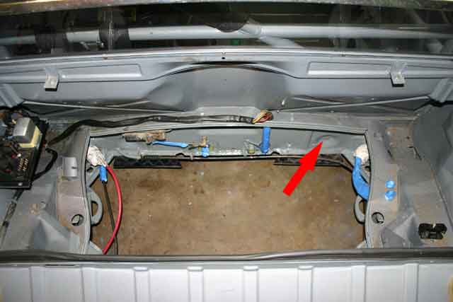

Need to cut 1 1" hole in the rear firewall for a -10 bulkhead T for the accusump. My unibit doesn't go to that size and the one that does is $60.
Can I use a hole saw or large normal drill bit to cut thru the sheetmetal (already have those bits)? Don't want to screw it up.
hole will be right here...

post Aug 5 2004, 07:52 AM
914 Freak!
Posts: 19,148
Joined: 23-December 02
Member No.: 8
Hole saw. That is double thick right there.

Honestly.. do'nt put it right there. Sooner or later you will need a brace from the control arm ear forward and that area is perfect to tie into. VERY strong right there and the brace wont interfere with any engine setup you run.

QUOTE(Brad Roberts @ Aug 5 2004, 09:54 AM)
Thanks for the advice brad, I appreciate it.
The accusump manual valve is really near the centerline but I thought putting the T near the center might interfere with the fan area, brake lines etc. The port into the oil gallies on my motor enter from the right side so I figured somewhere on the right side of the firewall was a good place.
I want to do a clean install, maybe I'll put it higher up where the sheetmetal is not doubled up.

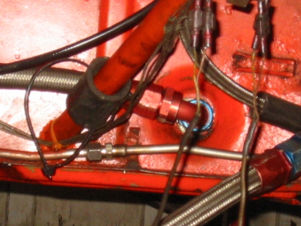

Brad Roberts
post Aug 5 2004, 08:03 AM
914 Freak!
Posts: 19,148
Member No.: 8
That *looks* like dirt in the engine compartment..
Those dimples are where the two sheet metals come together. Otherwise that wall has a 3/4 inch air gap so tying into it next to the dimple for a "ear supoprt" you only get a piece of sheet metal hanging in the breeze.
Did that make sense ?? I'm still half asleep.
B

No, your clear. I get what you mean about the metal joining at that location.
Actually the "dirt" is rust particles. We left too many filings from fabrication and they rusted when they got wet. Next time I'll clean up better after cutting metal.

ChrisFoley
post Aug 5 2004, 06:04 PM
I am Tangerine Racing
Posts: 7,990
Joined: 29-January 03
From: Bolton, CT
Member No.: 209
There's nothing wrong with going through that location for your oil line Dave.
Putting a brace from the suspension console to anywhere at the bottom of the firewall is fine. That way you are relying on the floor (which is perfect for the job) as additional reinforcement for the brace.
