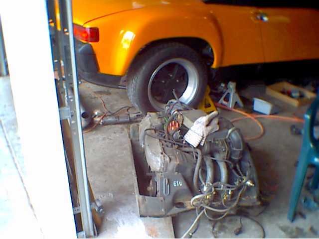

Okay, so this is about the 5th 914-6 conversion I have done. They are all drivers to this day. Heck, Even Craigh Laughlin has one of my old ones! My goal is to put as many 914-6's out on the road as possible since I think that is what the desing intended for them to be anyway. Anyway, I have heard soem thoughts about costs or how hard it is to convert. Nah, just time really. yeah, a few parts, but mostly just some time. Lets visit the part$ shall we. You will probalby need the following (as in not worth making):
Tank - Lots-o-options, but don't spend over $500 on one
Headers - $450 - 500
Mount - Zowie! Lots-o-options here as well. I have a jig to make my own, it works, but takes time. It is not hard, but takes a lot of time. I gave up and grabbed a patrick moly mount just today. I am running out of time.
Everyting else, you can make or do yourself. I will show you how in this thread over the next couple of weeks since that is all the time I have left!

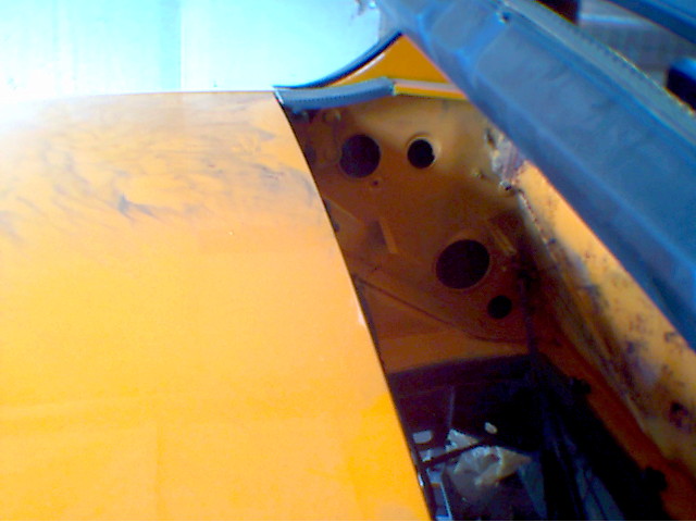

Here is a shot of the holes drilled for the oil tank. Yep, I am using a Vellios tank yet again. They work great and use the later filters. Also, you can go down to your local industrial supply shop and have them make the pressure hose for like $40. The suction hose is even easier, but more on that later.

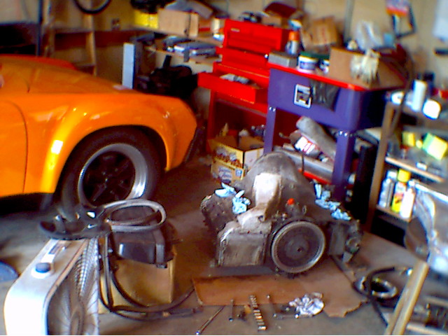

Root_Werks   Out with the old..... Eric Paine is coming up ton...   Aug 5 2004, 01:33 PM

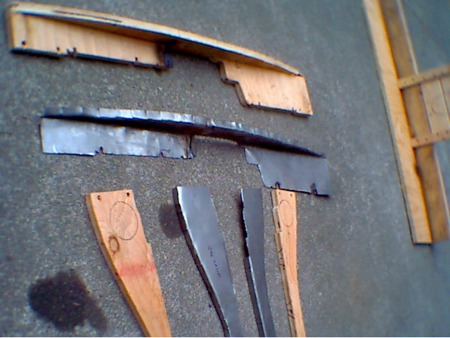

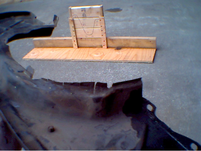

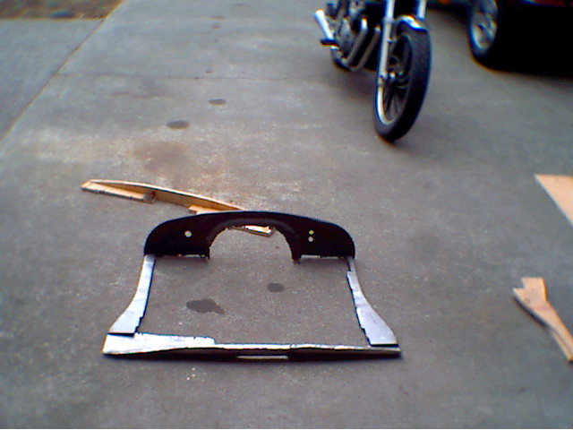

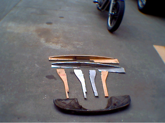

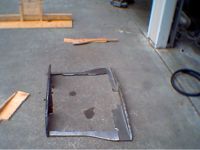

Root_Werks   Lets talk tin shall we? ;) BTW - thanks for al...   Aug 6 2004, 08:13 AM
Root_Werks   Ooooooo :huh: That looks tough huh? I cut a fe...   Aug 6 2004, 08:18 AM
Root_Werks   A closer shot of the 3 peices you have to make and...   Aug 6 2004, 08:20 AM
Root_Werks   What all the pieces look like together. I painted...   Aug 6 2004, 08:22 AM
Root_Werks   Another angle. You will notice that I had to tac ...   Aug 6 2004, 08:24 AM
michelko   :o :trophy: Very impressive work, canĀ“t wait t...   Aug 6 2004, 08:25 AM
Root_Werks   So there you have the tin! 22 gauge can be cu...   Aug 6 2004, 08:32 AM
