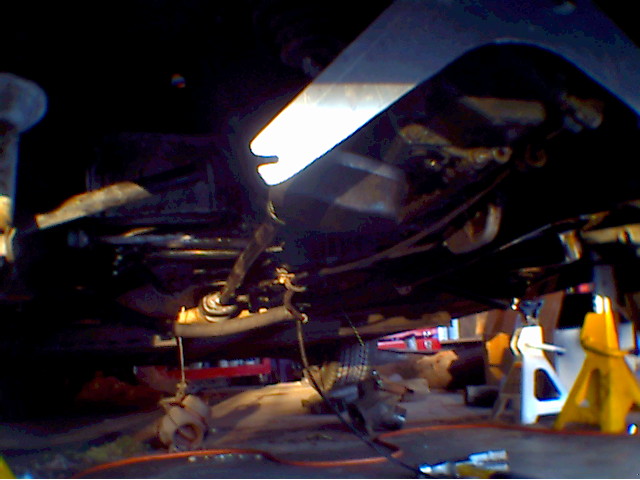

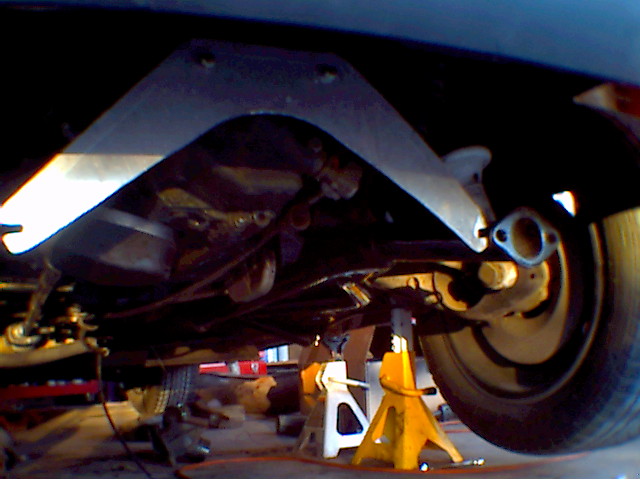

Root_Werks   Lets talk tin shall we? ;) BTW - thanks for al...   Aug 6 2004, 08:13 AM
Root_Werks   Ooooooo :huh: That looks tough huh? I cut a fe...   Aug 6 2004, 08:18 AM
Root_Werks   A closer shot of the 3 peices you have to make and...   Aug 6 2004, 08:20 AM
Root_Werks   What all the pieces look like together. I painted...   Aug 6 2004, 08:22 AM
Root_Werks   Another angle. You will notice that I had to tac ...   Aug 6 2004, 08:24 AM
michelko   :o :trophy: Very impressive work, canĀ“t wait t...   Aug 6 2004, 08:25 AM
Root_Werks   So there you have the tin! 22 gauge can be cu...   Aug 6 2004, 08:32 AM
Root_Werks   Note on the above picture I used the AN fittings. ...   Aug 6 2004, 08:42 AM
