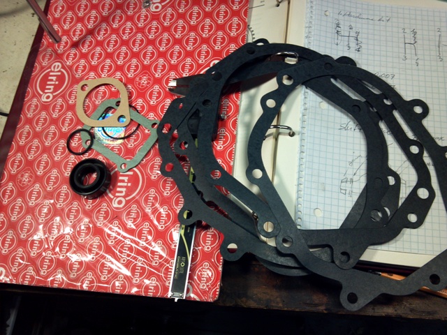

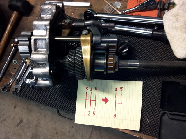

The engine's finished-
Remember this 3 speed you created?
I'm ready to stuff the tranny for thanksgiving-
The original gasket shims measured = 0.021"
The "elring" kit shims are 0.009" each, so the closest I can get to 0.021"
is 0.018". So what do I do? I need 0.003" more?
root
post Nov 13 2011, 11:18 AM
Two Wheeled Type4 Completed!
Posts: 849
Joined: 5-May 04
From: Sterling, VA
Member No.: 2,026
WAIT! - False Alarm Dude! I just re-measured the original 3 shims:
0.007"
0.007"
0.005"
0.019" total < -------- so I'm O.K.! (IMG:style_emoticons/default/biggrin.gif) (IMG:style_emoticons/default/beer3.gif)
Any final pointers before I sew it up? (IMG:style_emoticons/default/confused24.gif)

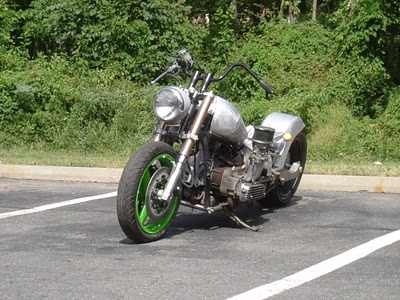

It's going on my two wheeler type 4.
Jockey shift and foot clutch, don't want to shift alot.
And really don't need more than 3, definitely won't use reverse.
Dropped 28 pounds of tranny part weight!

What question do you still have for me? (IMG:style_emoticons/default/confused24.gif) It looks like you figured it all out (IMG:style_emoticons/default/smile.gif) The shift pattern you drew is correct, except it is 2-3-4. The 5th gear slot is empty.

Prospectfarms
post Nov 14 2011, 07:39 AM
Posts: 495
Joined: 7-March 11
From: Louisville, KY
Member No.: 12,801
QUOTE(root @ Nov 13 2011, 05:07 PM) *
QUOTE(smontanaro @ Nov 13 2011, 02:00 PM) *
I'm confused about why you'd want a three-speed transmission... (IMG:style_emoticons/default/confused24.gif)
Flipping through responses and was astonished by this photo. Didn't know.
(IMG:style_emoticons/default/aktion035.gif) (IMG:style_emoticons/default/smilie_pokal.gif) (IMG:style_emoticons/default/welder.gif) (IMG:style_emoticons/default/pray.gif)
Cool.

Oh ya, to your original question to me, close is good enough with the gaskets. These boxes are far past needing super fine tuning. Plus, with your bike it would be no issue with the low weight.
