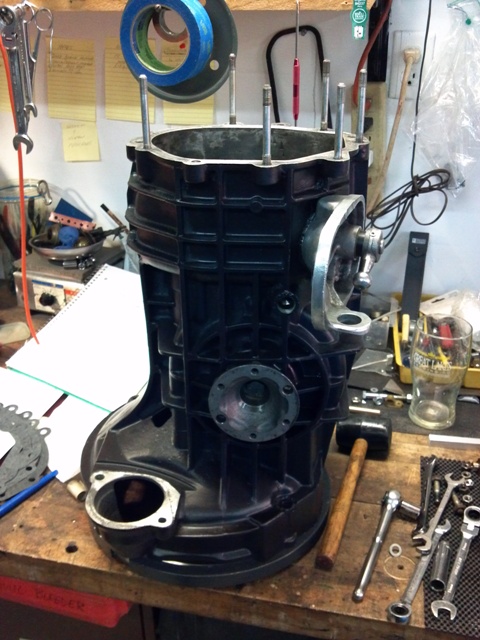

The engine's finished-
Remember this 3 speed you created?
I'm ready to stuff the tranny for thanksgiving-

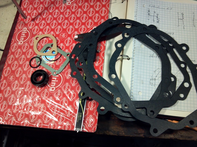

The original gasket shims measured = 0.021"
The "elring" kit shims are 0.009" each, so the closest I can get to 0.021"
is 0.018". So what do I do? I need 0.003" more?
root
WAIT! - False Alarm Dude! I just re-measured the original 3 shims:
0.007"
0.007"
0.005"

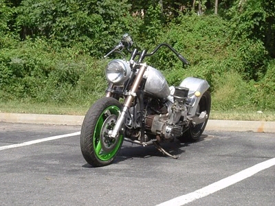

smontanaro
I'm confused about why you'd want a three-speed transmission... confused24.gif
r_towle
I know you built it for that case...but it begs me to wonder if you could section that case and reduce the length now....
Rich
root
QUOTE(smontanaro @ Nov 13 2011, 02:00 PM) *
It's going on my two wheeler type 4.
Jockey shift and foot clutch, don't want to shift alot.
And really don't need more than 3, definitely won't use reverse.
Dropped 28 pounds of tranny part weight!

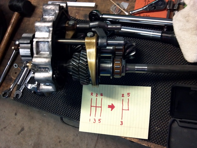

Dr Evil
What question do you still have for me? confused24.gif It looks like you figured it all out smile.gif The shift pattern you drew is correct, except it is 2-3-4. The 5th gear slot is empty.
Nope, I'm good now I just re-measured the original 3 shims:
0.007"
0.007"
0.005"

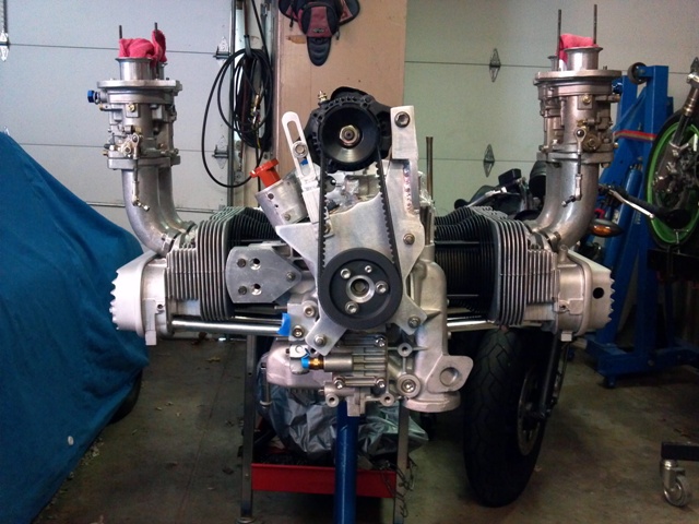

Flipping through responses and was astonished by this photo. Didn't know.
Cool.
Bills914-4
aktion035.gif idea.gif , cooling of heads and cylinders , Bill D.
http://www.thesamba.com/vw/classifieds/detail.php?id=968764
VaccaRabite
given the light load that this engine will face in a bike, I doubt the cooling ducting is needed.
VaccaRabite
QUOTE(root @ Nov 14 2011, 12:20 PM) *
Carb pops could be highly amusing as well.
idea.gif Could you use shorter intake runners to lower the carbs a few inches?

Oh ya, to your original question to me, close is good enough with the gaskets. These boxes are far past needing super fine tuning. Plus, with your bike it would be no issue with the low weight.
