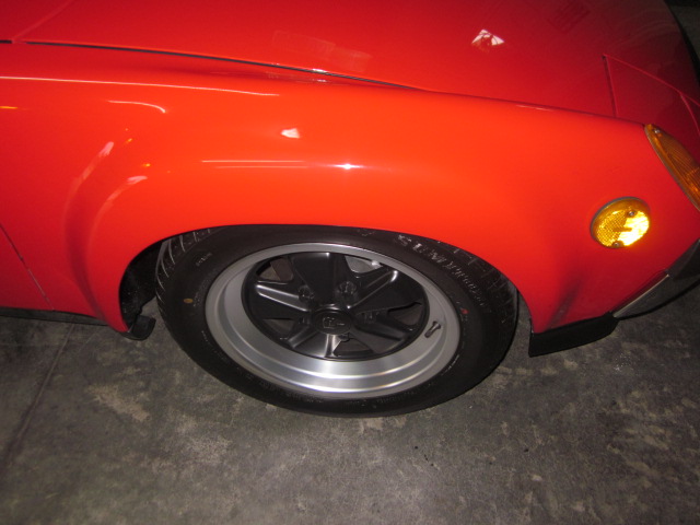

So the local tire shop mounting my recent re-finished 14x5.5 Fuchs does not have the right vavle stem, luckily the owner checked on the installer's work and notice the the regular valve sem was not seated properly. So is there special valve stems for the 14" of Fuchs in general, or is it that the tire shop was not adequately supplied with the valve stems ??
I can see where the hole where the valve stem seats is especially thicker than the typical wheel. I should have taken a picture. Anyone have any been there done that before comments ??? Thanks in advance Ted |

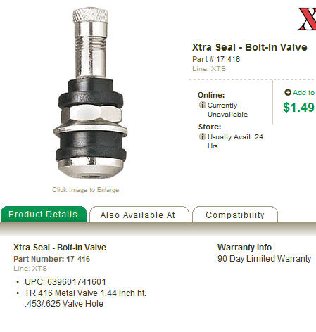

Drums66 ......The stems are regular, but I'd get metal... Nov 16 2011, 05:08 PM

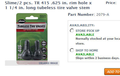

porsche913b_sp So what I read on pelican I need the TR415 stem. I... Nov 16 2011, 06:52 PM
porsche913b_sp So I tried the TR415, but there was no way the fat... Nov 22 2011, 06:35 PM![]() ![]() |
