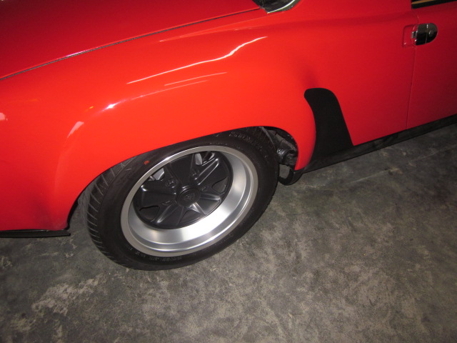

I just installed 16'' fuchs....with new valve stems....no problems...regular valve stems!

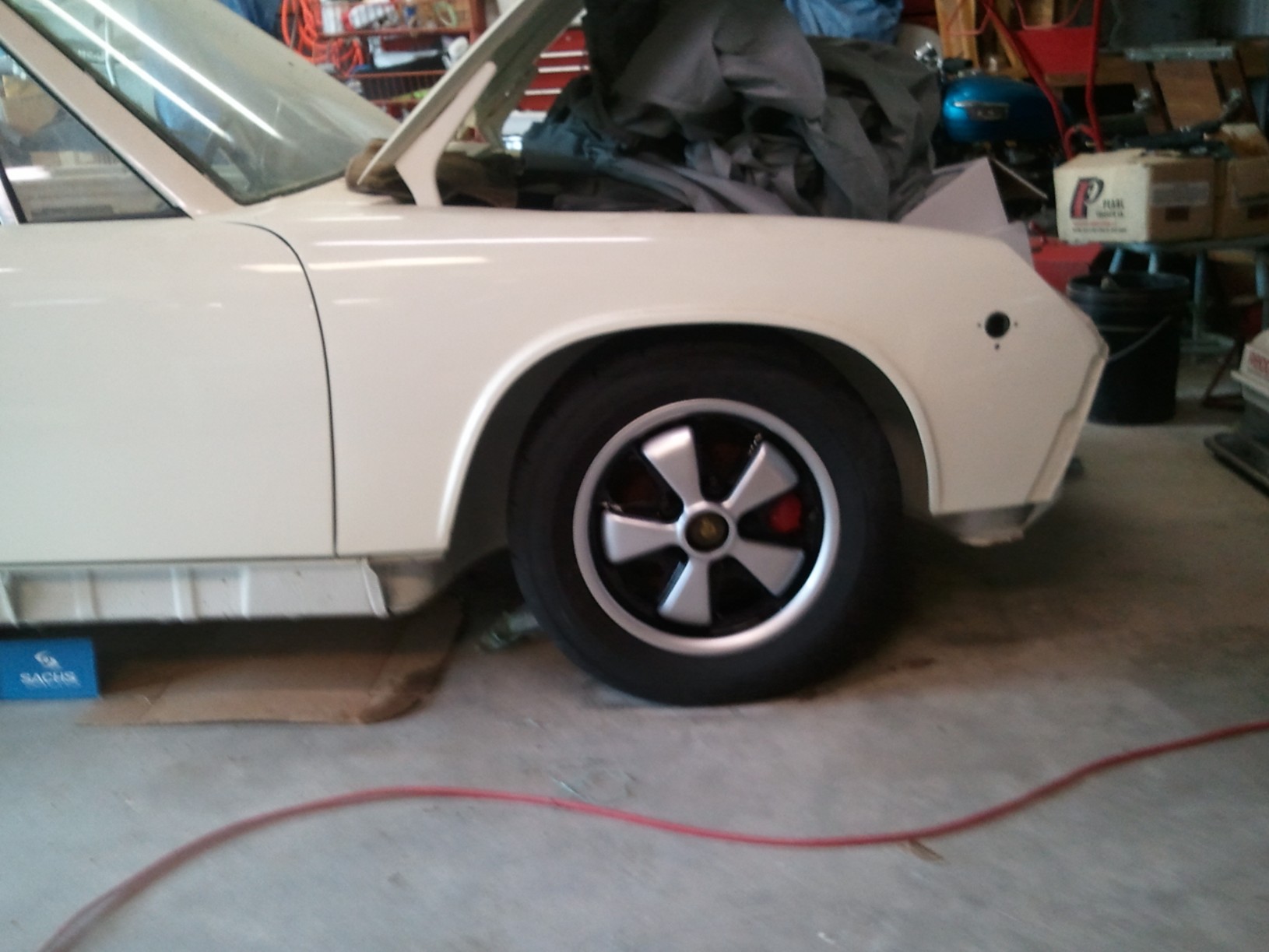

You may already know this, but the 14" fuchs were originally fitted with tubes (at least mine were) however, they should be able to find valve stems that will fit OK These are mine with 195 /60 Dunlops fitted
pete000
QUOTE(maxwelj @ Nov 16 2011, 11:30 AM) *
The early Fuchs were designed for tubes and the valve hole is bigger. You need to use the correct dia valves. No bead lock on the rims either, but I hear thats not a big deal.

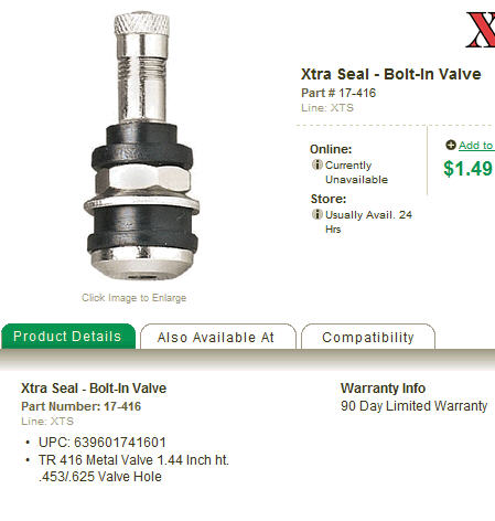

popcorn[1].gif bye1.gif popcorn[1].gif(or at least the slip-on sheilds!)

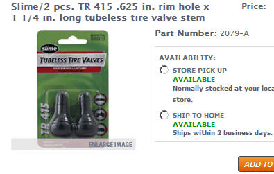

So what I read on pelican I need the TR415 stem. I tried the threaded metal version since it had the same diameter but it was not long enough going thru the wheel.
I'm going to have the tire shop try the rubber one tomorrow and let you'all know.
FYI, the regular valve stems do not fit.
913B
So I tried the TR415, but there was no way the fat base stem was going to fit. I had to eventually use inner tubes for 4 of my 5 fuchs. Strangely one of the fuch the standard stem worked. Apparently they were produced different years. My only regret was not taking a picture of the hole and how the TR415 did not fit. I read somewhere NOT ALL TR415 was the same, oh great.
