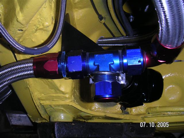

Original tank with no way to drain except remove hose. I am going to be making new oil lines. I saw one of our guys that has put a "T" with a cap in line with the oil cooler. Has anyone added a drain plug to the tank? Tank is out of car now.

This is the best I've seen so far. Somebody on this site had posted this a while ago.

I also used an AN16 T on mine. I love his bracket though. I need to find a better way to fasten down my T. It moves around to much when I take the cap on and off. I also saw another post a while back of someone that used JB weld to install a quick drain in there T.
