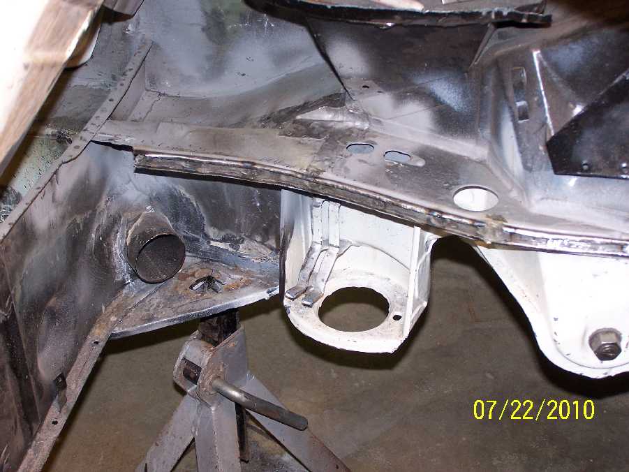

Bob , that piece is fairly flat on top ( horizonal ) until it turns on top of the engine mount and slopes down to the hell hole . Yes it does mount on top of the engine mount . I had to patch mine , here's a pic of mine ( not the best in the world , but an idea of what you may be wanting to see / know ) .

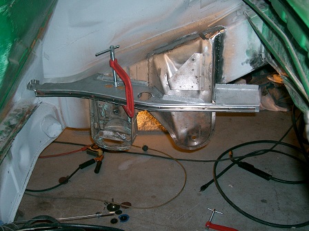

Thanks Jack. With the help of your pic I was able to figure things out. The shelf needed to be "flattened out" a bit in the front. Additionally, I had previously welded in a new top section on the engine mount. The new section was a little higher in the front, amplified over the length of the engine shelf, it caused it to be quite a bit higher at the front firewall. Adjusted the top of the engine mount with a big hammer. (IMG:style_emoticons/default/biggrin.gif)

(IMG:style_emoticons/default/piratenanner.gif) Bob , that looks great !!!!! (IMG:style_emoticons/default/piratenanner.gif) The shelf is just spoted / tacked along the edge of it on top of the long , engine mount , suspension mount , and the piece that you don't have installed. Keep up the good work !!!!
