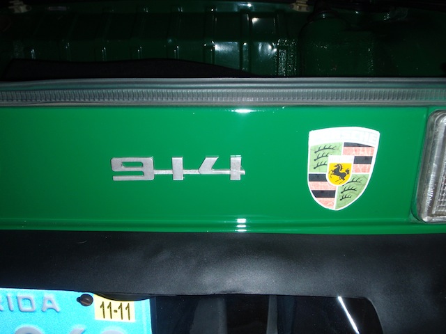

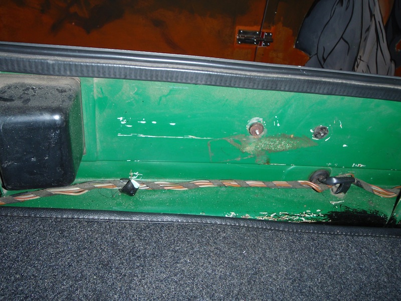

I have a 73 1.7 914 but there is no model designation on the rear panel next to the "914" There is also no sign of holes where the badge would be (original paint on inside of trunk). Was there such a thing as model designation delete or were the original "1.7" stick on?

Porsche in their infernal wisdom, initially didn't think they needed to make a distinction between the two 4 cyl. 73 models, then later came up with the badges - possibly only after their USA marketing arm began the distinction by calling the 2.0 as the "914 S" in their adverts, sales brochures, etc.
My 8/31/72 built 73 914-2.0 has the 914 badge mounting holes stamped in the sheetmetal (due to smooth back/inside face), but the 2 holes for the 2.0 are dimpled inside the trunk, as happens when they're drilled in after the original part stamping. So they must've added it later, but I don't know if that occurred at the factory, dealership, or in between.
I know it's the original rear wall piece, because it bears all paint colors since new L80E/Light Ivory, with the Sahara Beige (paint or tinted primer), Gold as when I bought it in 12/75, and the Copper Metallic and Anthracite/Dark Grey Metallic repaints which I did in 76 & 80 respectively.
Yours may have missed the addition of the 1.7 badge if it was an early build from July or August 72, or it could've been a replacement panel done over the years since new, or an owner delete where the hole was filled in & finished smooth. Those pix look like it may have been L80E originally or before, where the chips are..

Note the strange Porsche Crest decal that the PO decided to mask off for the repaint. It has a cracked and worn patina that is interesting and the gold has turned green but I'm not sure if I would have saved it. I originally thought that this might have been used to cover holes but no holes on the back side.

Thanks for the reply and the info! After you pointed out the white around the chips, I was afraid I might have a frankenstein car. I went back out to the garage and found the same chips in the front trunk. I'm thinking its just primer. The paint code on the door jam is L 64 K, ZAMBEZI! Also checked for signs of dimples on the back panel. None where the 1.7 would be. I think the car was built in sept. I also suspect that I have become curious about this variance in an attempt put off replacing the clutch cable. (IMG:style_emoticons/default/biggrin.gif). although it is perfect driving weather here in the panhandle of Florida. Time to get out the jack stands.

My '73 had the "914-1.7" aluminum (not plastic) numbers.
The plate between the tail light assemblies, had factory holes,
with no dimples or pressings, just clean holes.
My '74 has the "914-2.0" black plastic numbers.
When I finish my '74, I want to run the "914-1.7" letters just
to deflate peoples' preconceived notions and to uphold everyones'
belief that German horses ARE bigger.

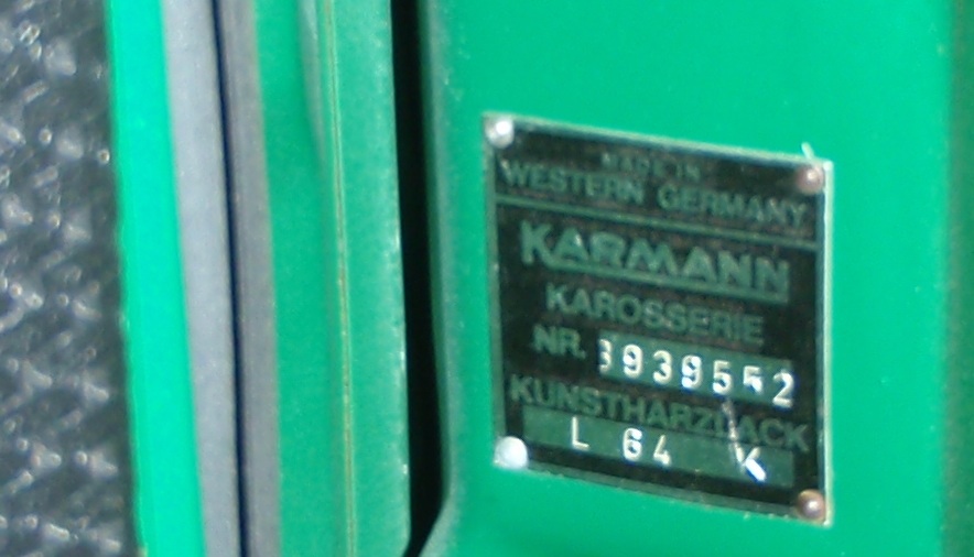

Look at the VIN sticker & use the year on it to pull up that year's calendar with Googling (if the sticker is gone, then about 10,000 to 12,000 is my guess for the car's production in 72 vs. 73 - or a little less than 1/2 in oher MYs - except all 76 MYs were 75 built).
Your 4732903490 is easily a 72 build 73 MY, so get the 72 calendar, then use the Chassis No. above the color code on the plate above to get the week in the year (even one day on the calendar counts as a week in their system).
First 2 digits are week in year - yours is 39th week
3rd Digit is workday of week - yours is 3 or Wed.
4th & 5th digits of 95 is the Karmann Plant designator -
.....96 was used on early 914s to designate 100 on the next number set
6th & 7th digits are the number of car built that day - yours is 52nd
.....5th digit as 6 translates to 95 + 1 for 100s

Cool! Thanks for the info! And good advice now that my car has a birthday too (IMG:style_emoticons/default/biggrin.gif) . ((9/20/72) by my calculations) two days after the first episode of M*A*S*H. Same day Paul McCartney got in a little trouble for his farming activities.
