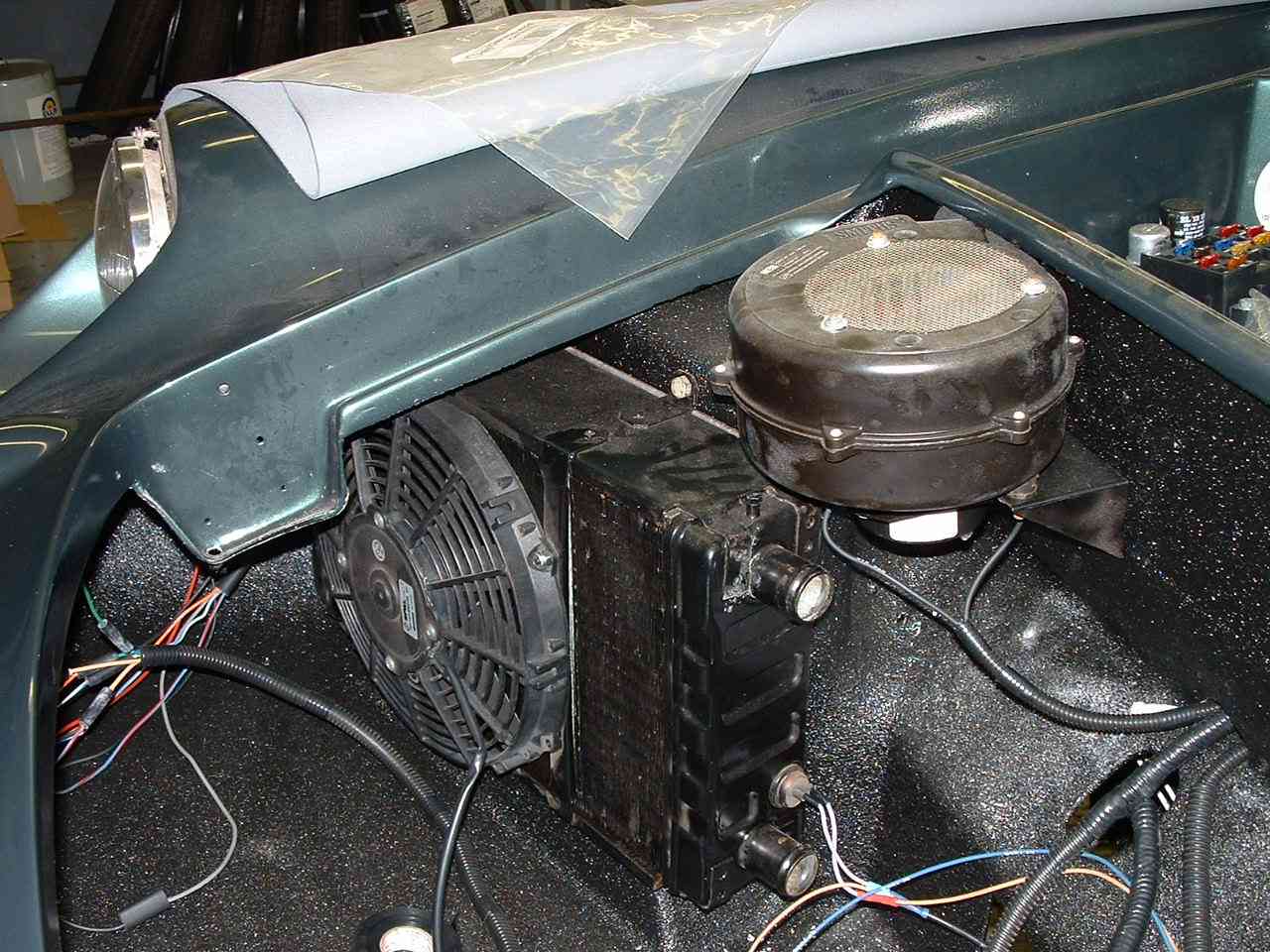

I've been using Wurth undercoating spray for a couple years on both street and race cars and am very happy with the results. Prep is minimal, goes on easy.
If you shop it hard you can get it down to under 9 bucks a can. I think the last case I bought was about 6.75 a can, but I know the Wurth rep.
Line-x is really good but it takes a lot of prep. I line-x'ed the entire inside and underside of my Lotus and very please with how it turned out.
