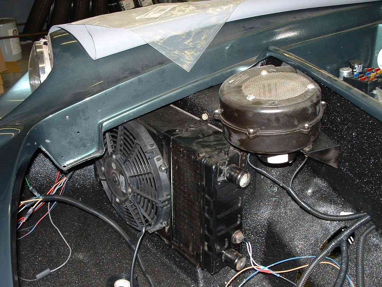

Line-x is really good but it takes a lot of prep. I line-x'ed the entire inside and underside of my Lotus and very please with how it turned out.
