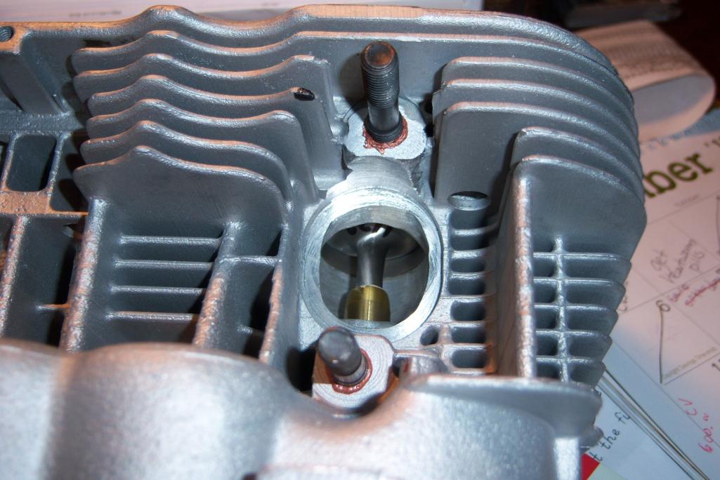

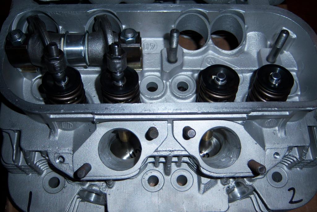

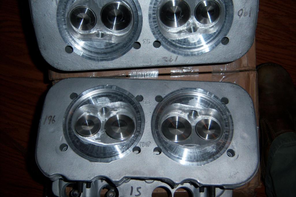

Where would we be without great craftsmen? 1.8 heads with new 2.0 sized valves, 1.7 rockers and swivel adjusting screws for my soon to be 1911 cc fuel injected 75.

53 CC should give me 8:1

That right plug hole in the last picture looks eaten a bit.

I wouldn't be surprised if Len added a notch for a CHT sensor ring.
And most builders are using SS valves. But Len would have to explain his own reasoning. That I'm not sure on.

Want perfection? Start with a brand new casting, otherwise you are always going to have some compromise. Len made these look great and the right spark plug hole has been modified for a CHT sensor as Mark stated.. Without that, life is hell.

QUOTE(Valy @ Nov 21 2011, 09:19 PM) *
And why the SS exhaust valves? The sodium filled are still available and not so expensive/
He welded everything closed, then tapped new. You might just be seeing some exterior weld. the right plug you refer to is the notch for the CHT.
That's where I tied the weld into the casting. It bubbled a bit from oxidation. If it had been a critical surface I would have cut it out and rewelded. Since it's just the exterior around the CHT probe notch I let it ride.
