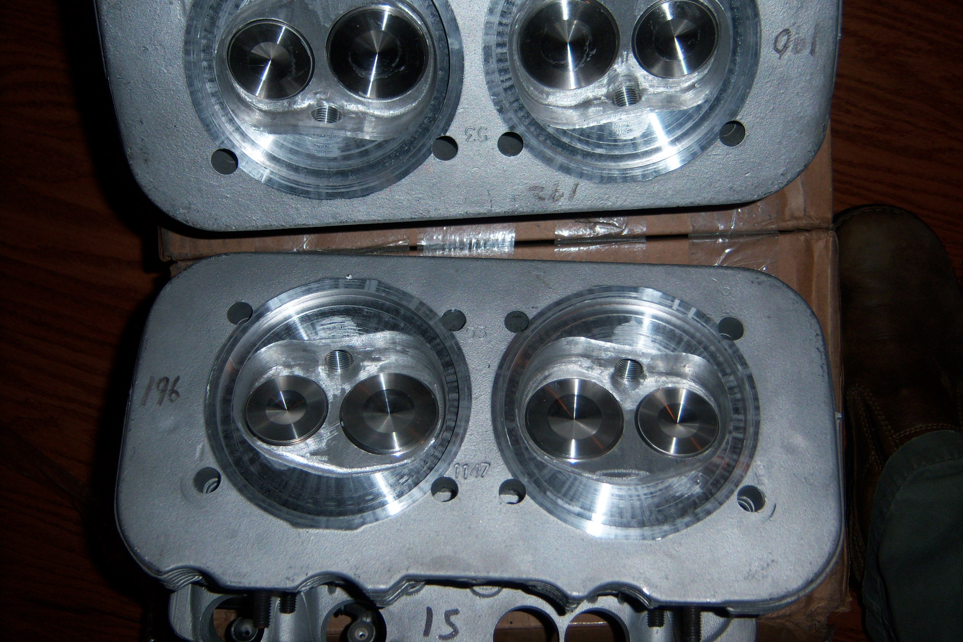

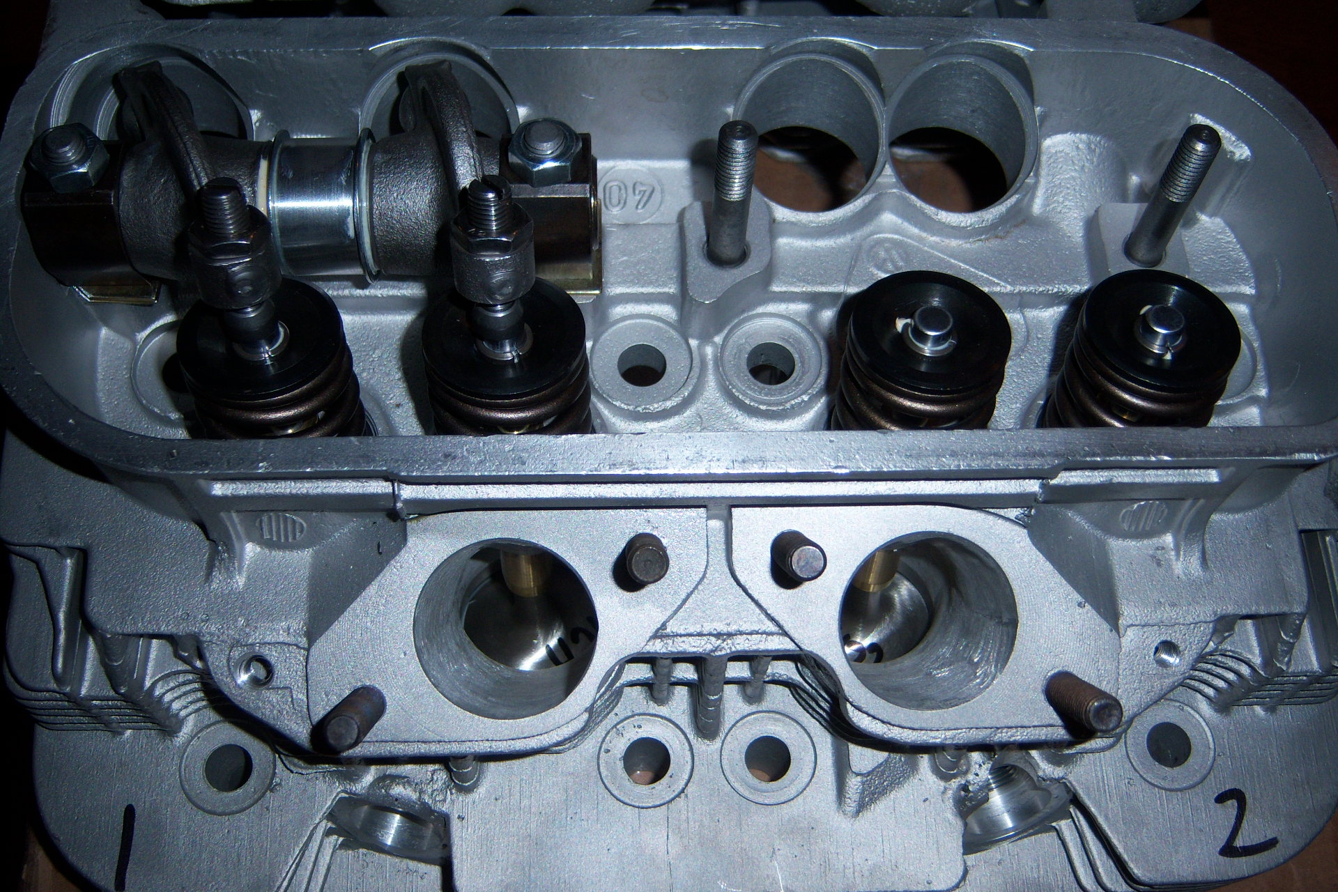

Where would we be without great craftsmen? 1.8 heads with new 2.0 sized valves, 1.7 rockers and swivel adjusting screws for my soon to be 1911 cc fuel injected 75.
I love stickers!
Nice thick valve seat!
53 CC should give me 8:1

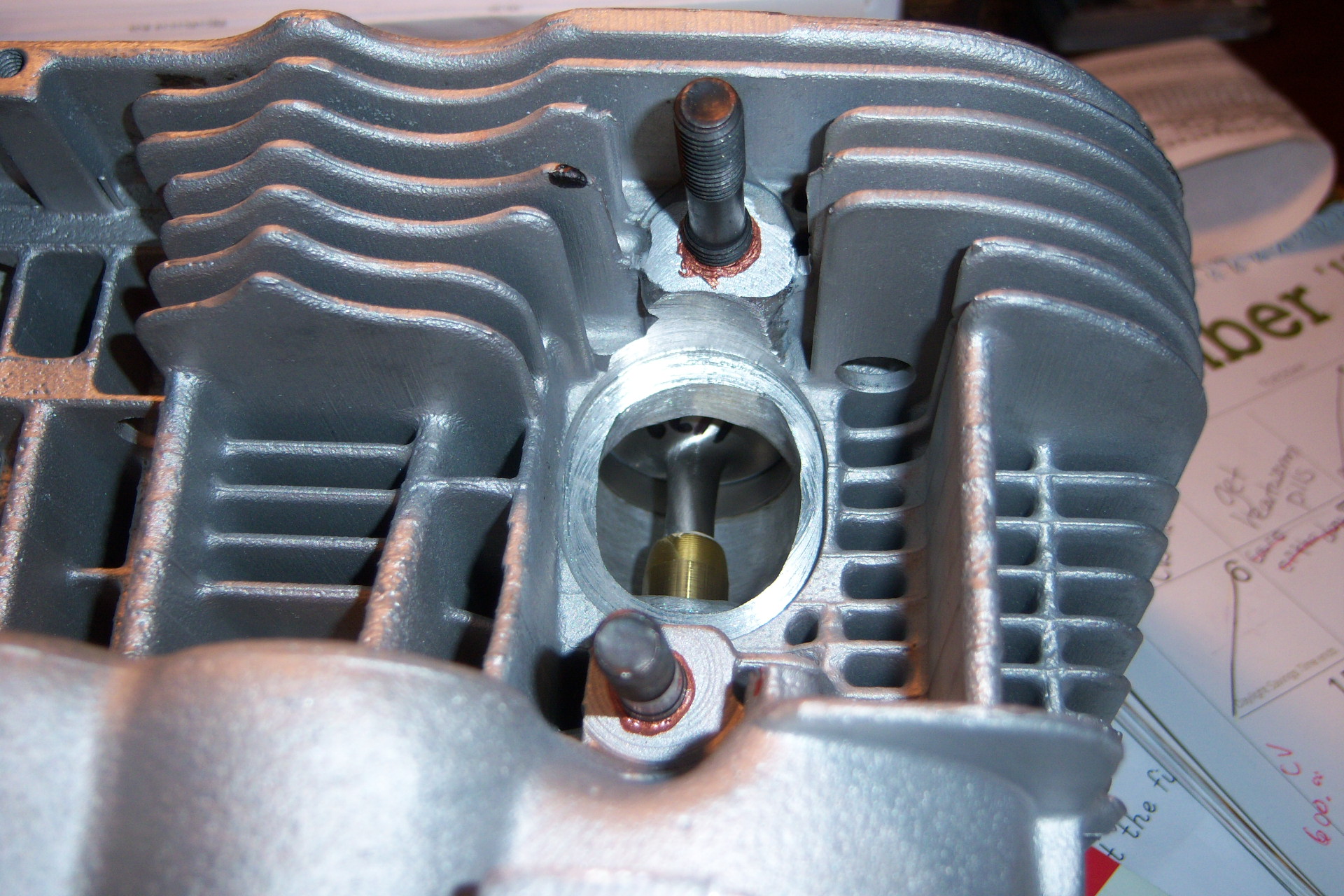

That right plug hole in the last picture looks eaten a bit.
And why the SS exhaust valves? The sodium filled are still available and not so expensive/

I wouldn't be surprised if Len added a notch for a CHT sensor ring.
And most builders are using SS valves. But Len would have to explain his own reasoning. That I'm not sure on.
They are after one fails and takes out the entire engine. Been there, done that and added the ten thousand dollars worth of broken parts to my trophy shelf. When a sodium filled valve fails, it doesn't break.. It explodes.
Heads look great to be nearly 4 decades old.. Len does awesome work.

Want perfection? Start with a brand new casting, otherwise you are always going to have some compromise. Len made these look great and the right spark plug hole has been modified for a CHT sensor as Mark stated.. Without that, life is hell.
He welded everything closed, then tapped new. You might just be seeing some exterior weld. the right plug you refer to is the notch for the CHT.
That's where I tied the weld into the casting. It bubbled a bit from oxidation. If it had been a critical surface I would have cut it out and rewelded. Since it's just the exterior around the CHT probe notch I let it ride.
Definitely not a fan of them either. Thank goodness for modern (late 20th century) valve technology so we have alternatives. Admittedly the sodium filled do seem to hold up okay when new and with only so many miles of not so sprited driving, but at some point when they go, they go ugly! On the other-hand the SS just keeps on rolling along. I have NEVER seen one break without first colliding with a piston.
