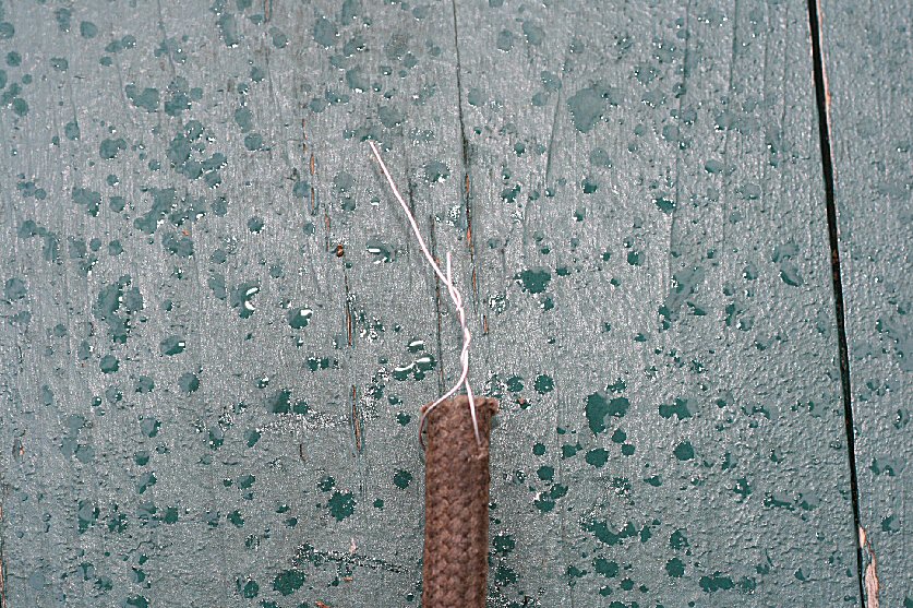

I was changing out my vacuum hoses when I found one that I was not looking forward to changing: The small hose from distributor to throttle body. The hose ran under the intakes plus other parts I could not see even with a small mirror! I knew fishing it back was not going to be easy because of limited space for my hands.
Then, I got a brain fart and drilled a small hole in the old hose and placed a small wire through the hose then pull the old hose out. (See photo) I cut the new hose about 1 1/2 inches too long and did the same and pull the hose through by the wire! I cut off the excess below the drilled hole and wire! Even a blind hog finds an acorn every now and then! I want to take time to wish the 914World Community a very Happy Thanksgiving. I have learned so much you y'all! Terry Attached image(s)

pt_700 neat trick, thanks for sharing!
perhaps an ... Nov 22 2011, 03:47 PM
Tom_T Terry - great application of an old trick!
