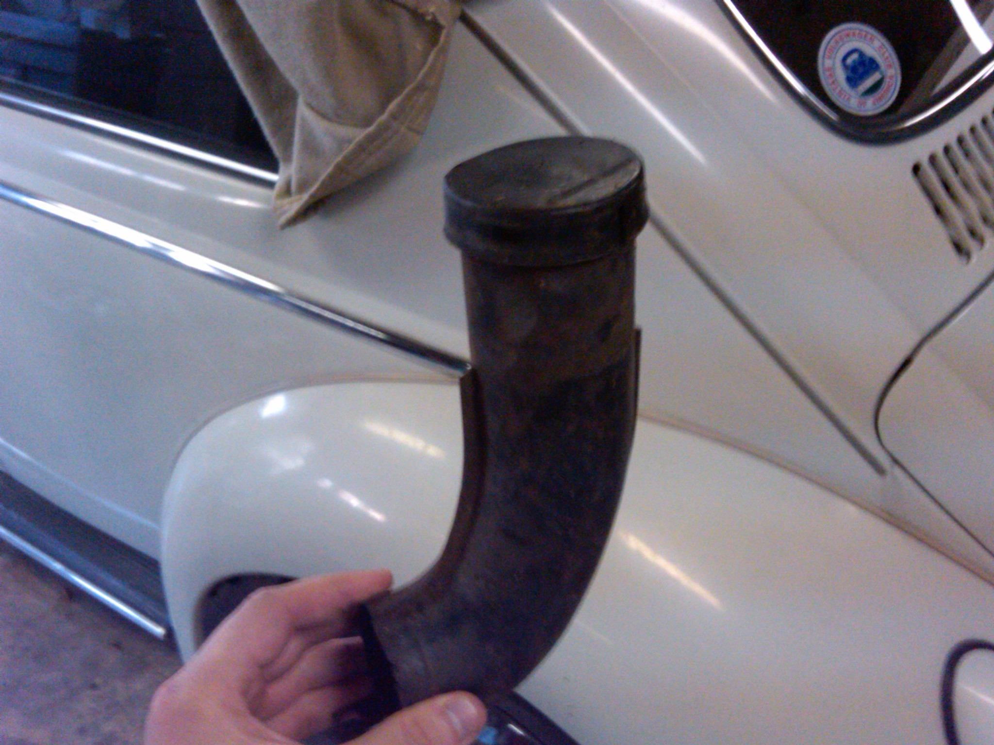

I would be happy with the cap method Mark mentioned. Anyone have a photo of the cap? I have never even seen one.
dlee6204
post Nov 25 2011, 09:46 AM
Howdy
Posts: 2,162
Joined: 30-April 06
From: Burnsville, NC
Member No.: 5,956
A photo of said cap...
Rick, if you want it, its yours.

An easy solution was provided for me at Home Despot, there are rubber plumbing caps that even come with clamps for under $5.00. It has worked well for me.
rick 918-S
post Nov 25 2011, 10:47 AM
Hey nice rack! -Celette
Posts: 21,038
From: Now in Superior WI
Member No.: 43
Cool! The photo Doug provided and the Home Depot source suggestion will work great!

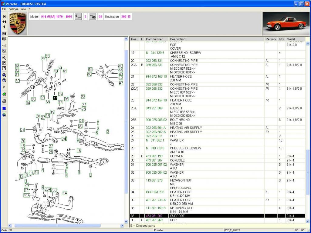

Mike I still need the right and left part #23 in the diagram for the early style H.E.'s. That will complete the heater for Sandy's car. We'll be driving this thing in the spring! (IMG:style_emoticons/default/driving-girl.gif)
Gint
post Nov 25 2011, 06:05 PM
Mike Ginter
Posts: 16,098
Joined: 26-December 02
From: Denver CO.
Member No.: 20
23 is just flexible hose. I sent you a PM rick. I thought you needed 24 and 25.

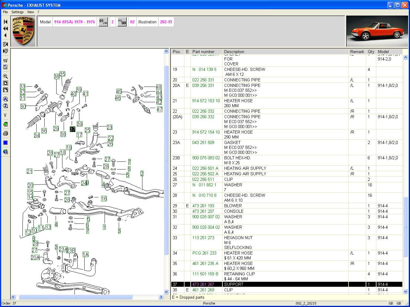

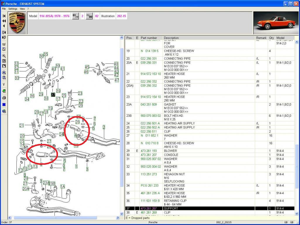

QUOTE(Gint @ Nov 25 2011, 06:05 PM) *
Got the PM Mike. I'm a dork... (IMG:style_emoticons/default/confused24.gif) (IMG:style_emoticons/default/biggrin.gif)
Here's what I need.
