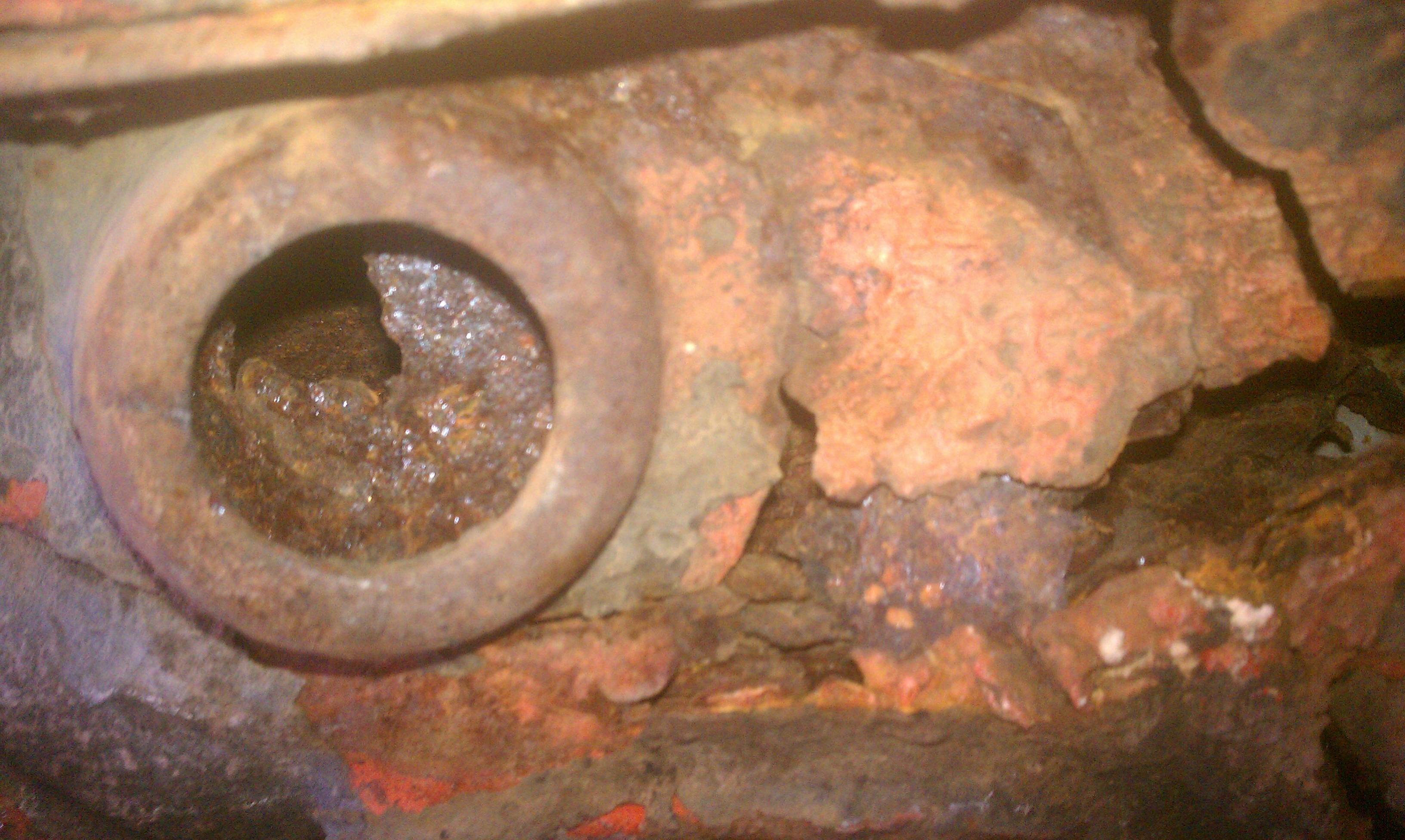

Okay, decided to take a few phone photos of some of the rot on Christine today. I have some sort of movement underneath that I am trying to pinpoint and solve. Noticed the rot seems to be a little bad on the passenger side. So, here's the question, Would you (IMG:style_emoticons/default/driving.gif) this car with a 2056 and stock injection in it? (IMG:style_emoticons/default/confused24.gif) She pulls really strong since the rebuild a couple months ago.

Is that the long? Holy crap.

QUOTE(underthetire @ Nov 26 2011, 07:51 PM) *
That's what's left of the backbone of your car. So no, i wouldn't drive it that way ... (IMG:style_emoticons/default/shades.gif)

What the hayul are we looking at?

QUOTE(RickS @ Nov 26 2011, 10:52 PM) *
That is the pass side long under the hell hole. With a big ass crack and lots of rust. It needs fixed before the car starts to fold up. Chritine deserves to have that patched up!

QUOTE(RickS @ Nov 26 2011, 09:52 PM) *
That is right by the jacking point behind the jack post. Just in front of the suspension ear. Looks like the rear of the floor pan is ready to drop on the ground. It is a little worse now than when I drove her to the Buttercup build 814 miles each way, but not a lot worse. So much for a good ol blue plate California car.

QUOTE(Vacca Rabite @ Nov 26 2011, 09:58 PM) *
Zach
(IMG:style_emoticons/default/agree.gif) Zach but it is slow going as it is trying to pay Scott for the one he already has. I hate to defer any funds away from that project. Thinking of a temporary patch until the other is finished. Was hoping to drive Christine the 900+ miles to Hershey next year. (IMG:style_emoticons/default/confused24.gif)

Wrapped steel plate with stainless rivets from front wheel well to a 45 at the rear long and continue up and around to engine bay. Tack/glob the shit out of it and drive sheet metal screws threw a select 50 odd locations around the "U" you create. This should extend halfway under the pan and eliminate the donut in the rear with plate. Of course I would never do this shit to any of my cars, short of the '70 out back that I purchased just like above.

So how long have you known about it and not said anything? and yes your crazy, one pot hole and you'll break her back (IMG:style_emoticons/default/sad.gif)

To answer your question yes you are crazy. Patch her up and drive her.

Would I drive it Yes,is it a good idea No.I have driven some sketchy stuff,but more often than not,it does not end well.Jaymann from PA

I would find a way to patch that until a proper repair can be made. Yes these cars are tough, but that looks pretty bad.
After getting my car running, I tore around the neighborhood for a few weeks with no tags, registration or insurance...after starting the restoraion, I realized how much could have gone wrong. (IMG:style_emoticons/default/sad.gif)

Doesn't appear safe to drive down the road for yourself or others on the road.

Your passenger seat belt mount down by the long might be compromised. Be careful.
