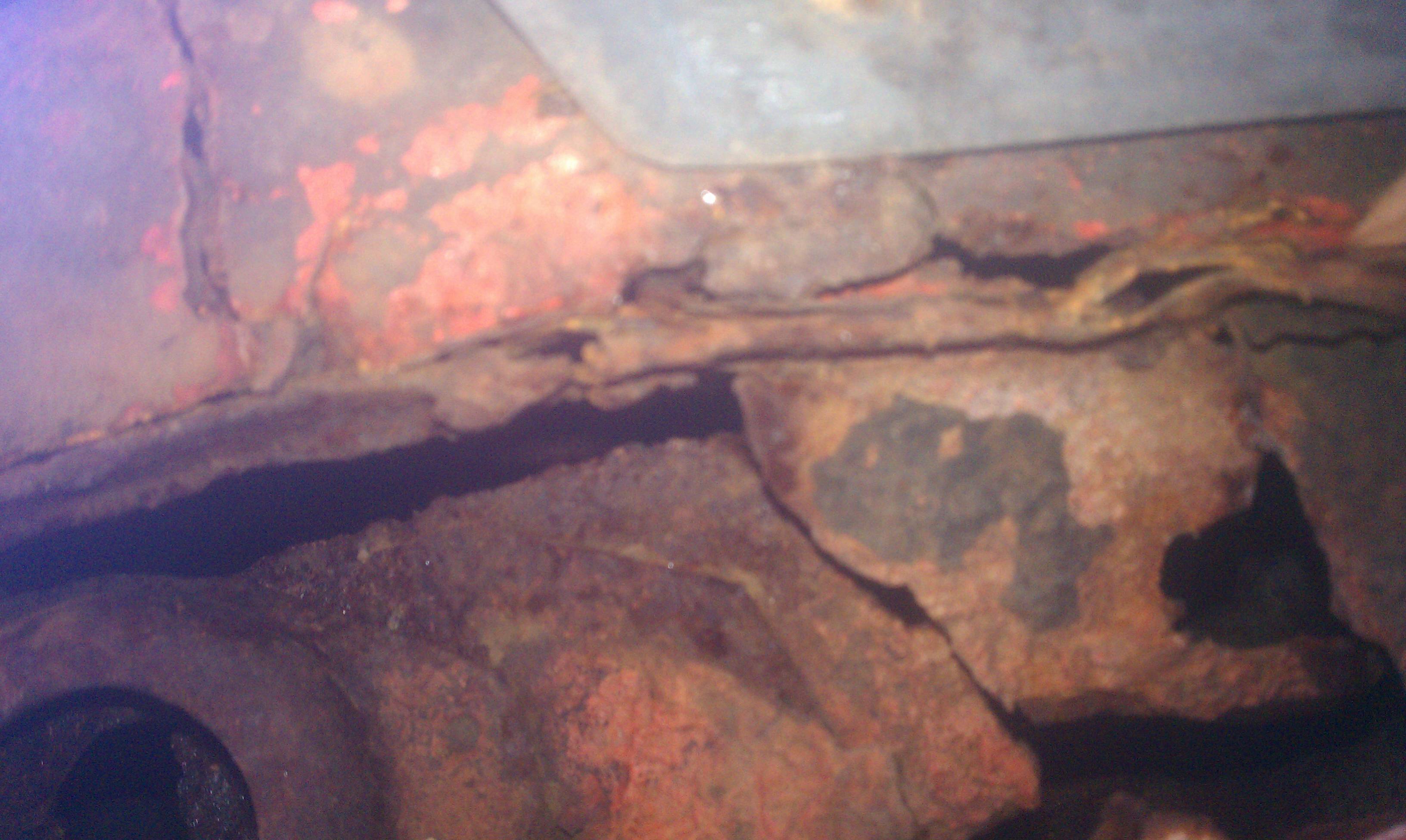

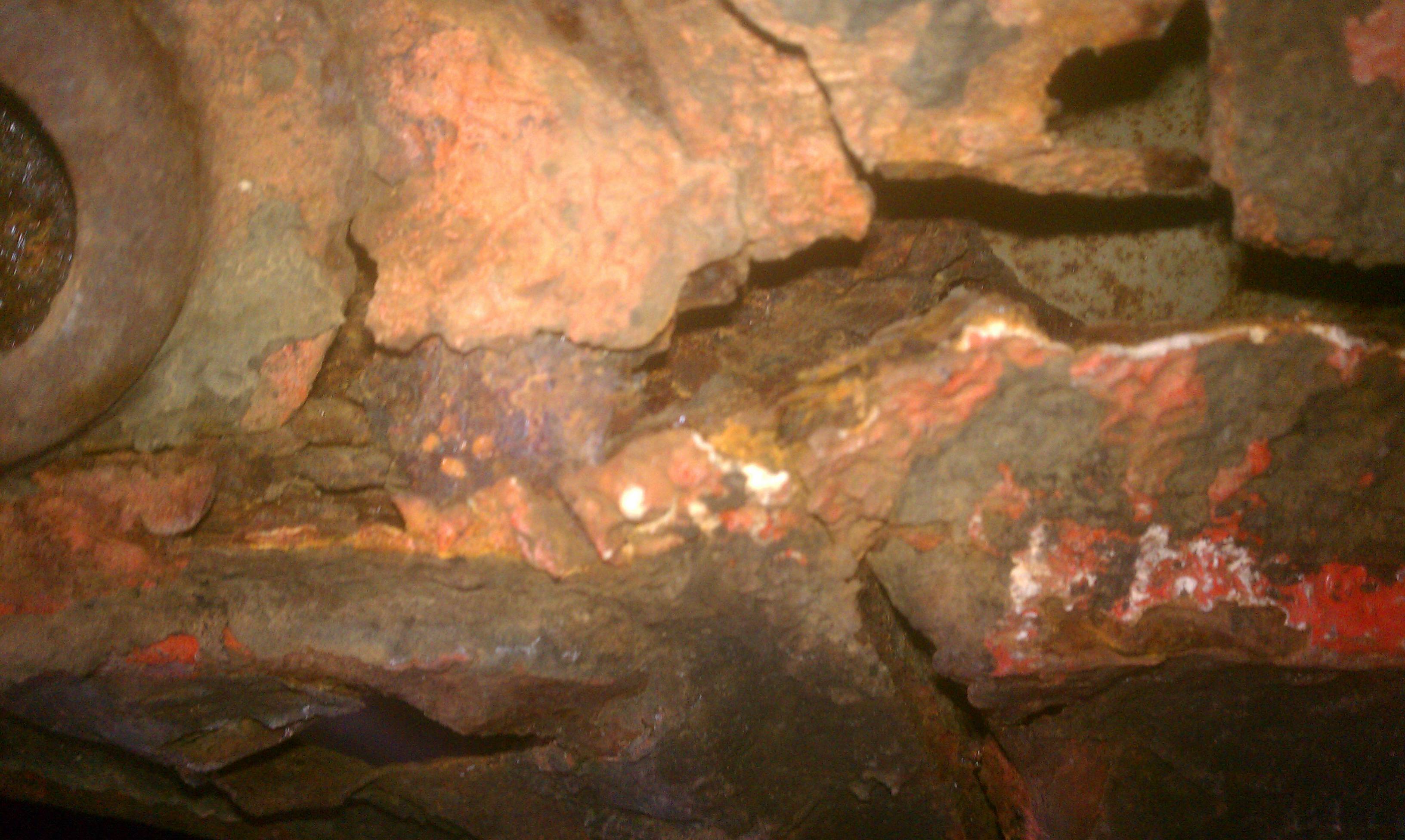

Okay, decided to take a few phone photos of some of the rot on Christine today. I have some sort of movement underneath that I am trying to pinpoint and solve. Noticed the rot seems to be a little bad on the passenger side. So, here's the question, Would you driving.gif this car with a 2056 and stock injection in it? confused24.gif She pulls really strong since the rebuild a couple months ago.

Is that the long? Holy crap.
QUOTE(underthetire @ Nov 26 2011, 07:51 PM) *
That's what's left of the backbone of your car. So no, i wouldn't drive it that way ... shades.gif
RickS
What the hayul are we looking at?
VaccaRabite
QUOTE(RickS @ Nov 26 2011, 10:52 PM) *

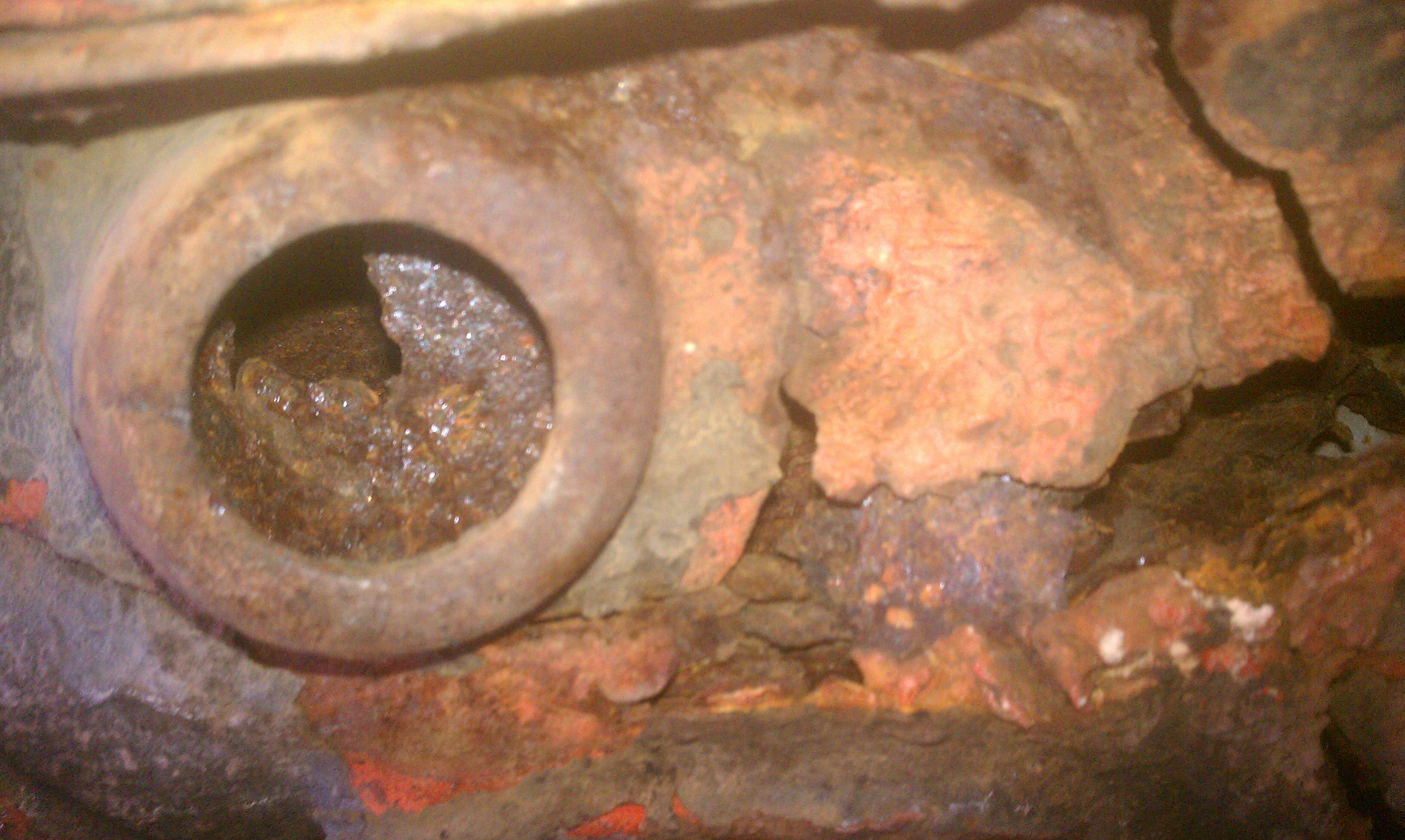

That is the pass side long under the hell hole. With a big ass crack and lots of rust. It needs fixed before the car starts to fold up. Chritine deserves to have that patched up!
Zach
hot_shoe914
QUOTE(RickS @ Nov 26 2011, 09:52 PM) *
That is right by the jacking point behind the jack post. Just in front of the suspension ear. Looks like the rear of the floor pan is ready to drop on the ground. It is a little worse now than when I drove her to the Buttercup build 814 miles each way, but not a lot worse. So much for a good ol blue plate California car.
