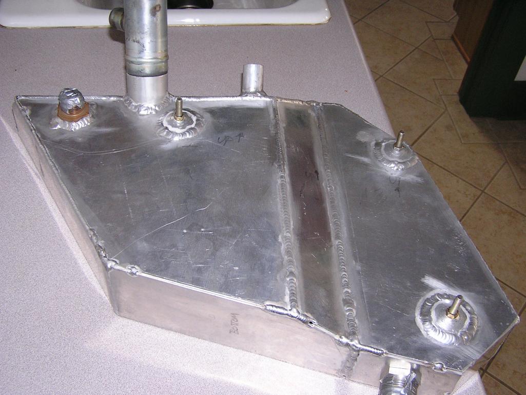

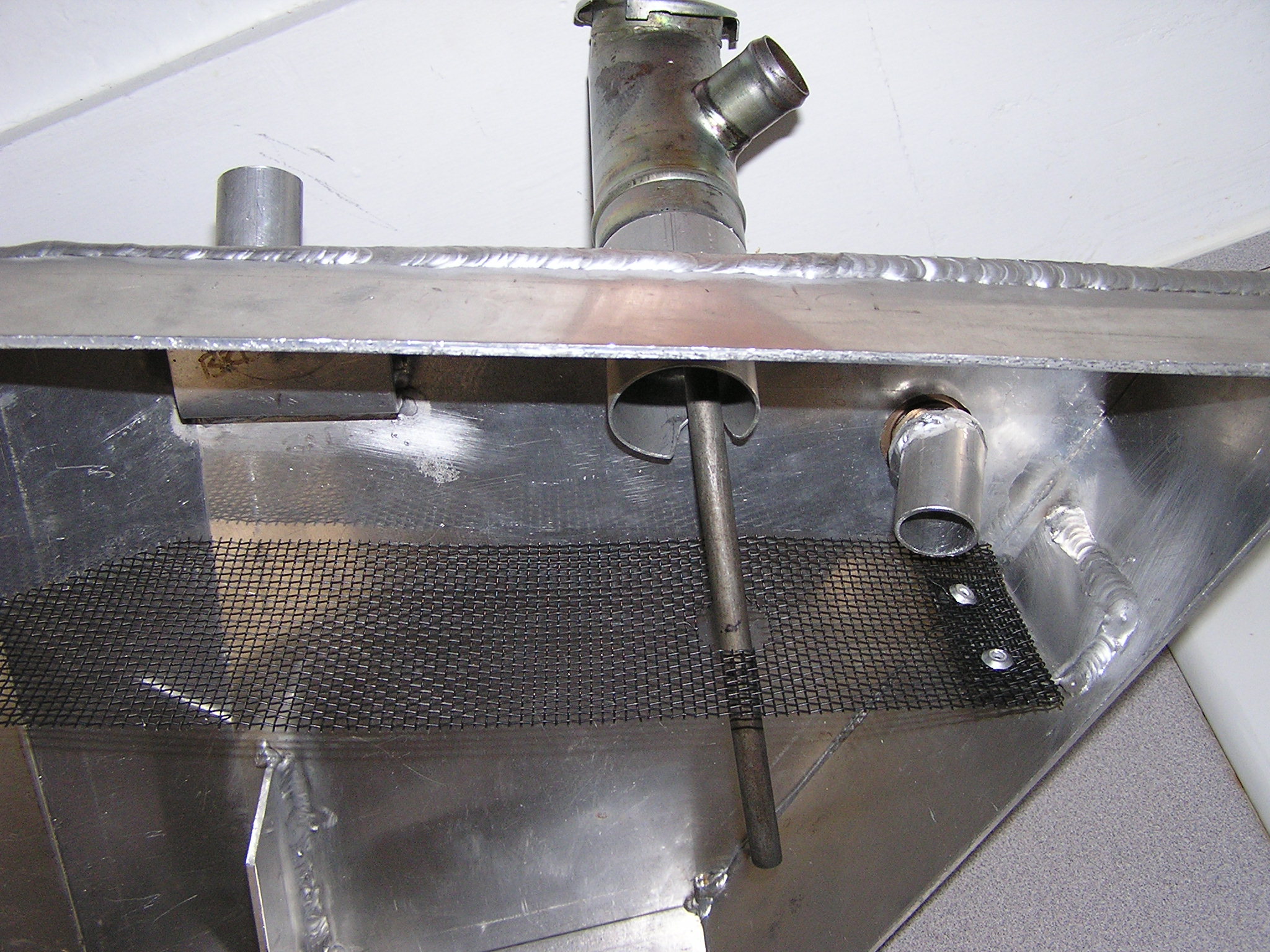

post Dec 1 2011, 11:02 PM
Posts: 12,179
From: Colorado
Member No.: 47
here is one I made
