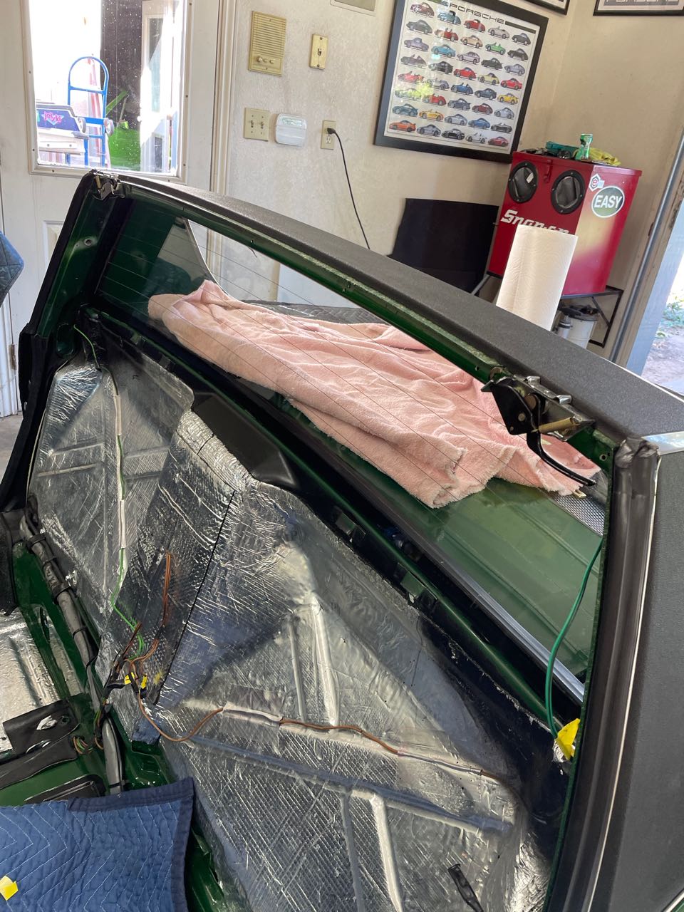

What is this insulation stuff? What keeps it there? Looks nice and modern. Does it work for the other side?
QUOTE(Cairo94507 @ Oct 29 2022, 08:14 AM) *
Cairo94507
post Oct 31 2022, 01:50 PM
Post #43
Michael
Posts: 10,797
Joined: 1-November 08
From: Auburn, CA
Member No.: 9,712
@stoneman30hotmail Thats just an off-shoot of Dynamat for sound deadening. It will stick where ever you put it. (IMG:style_emoticons/default/beerchug.gif)

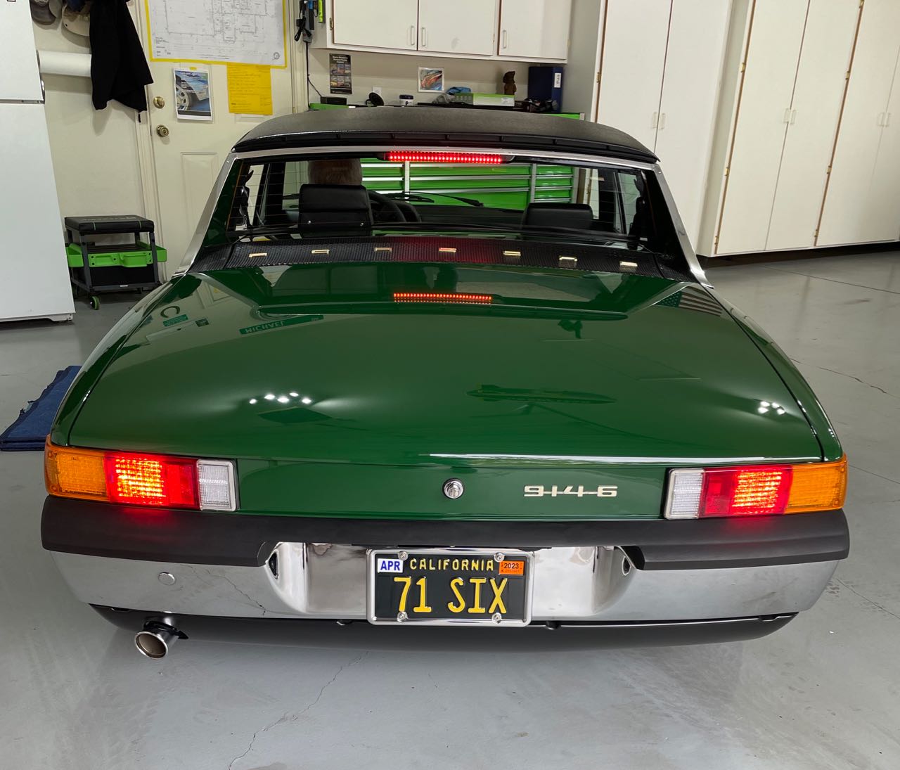

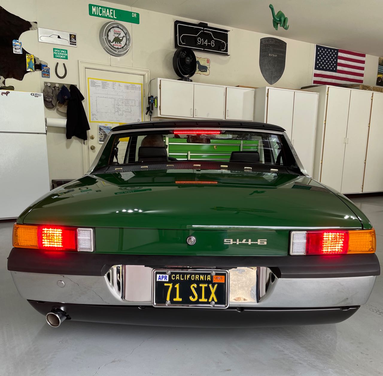

Member No.: 9,712

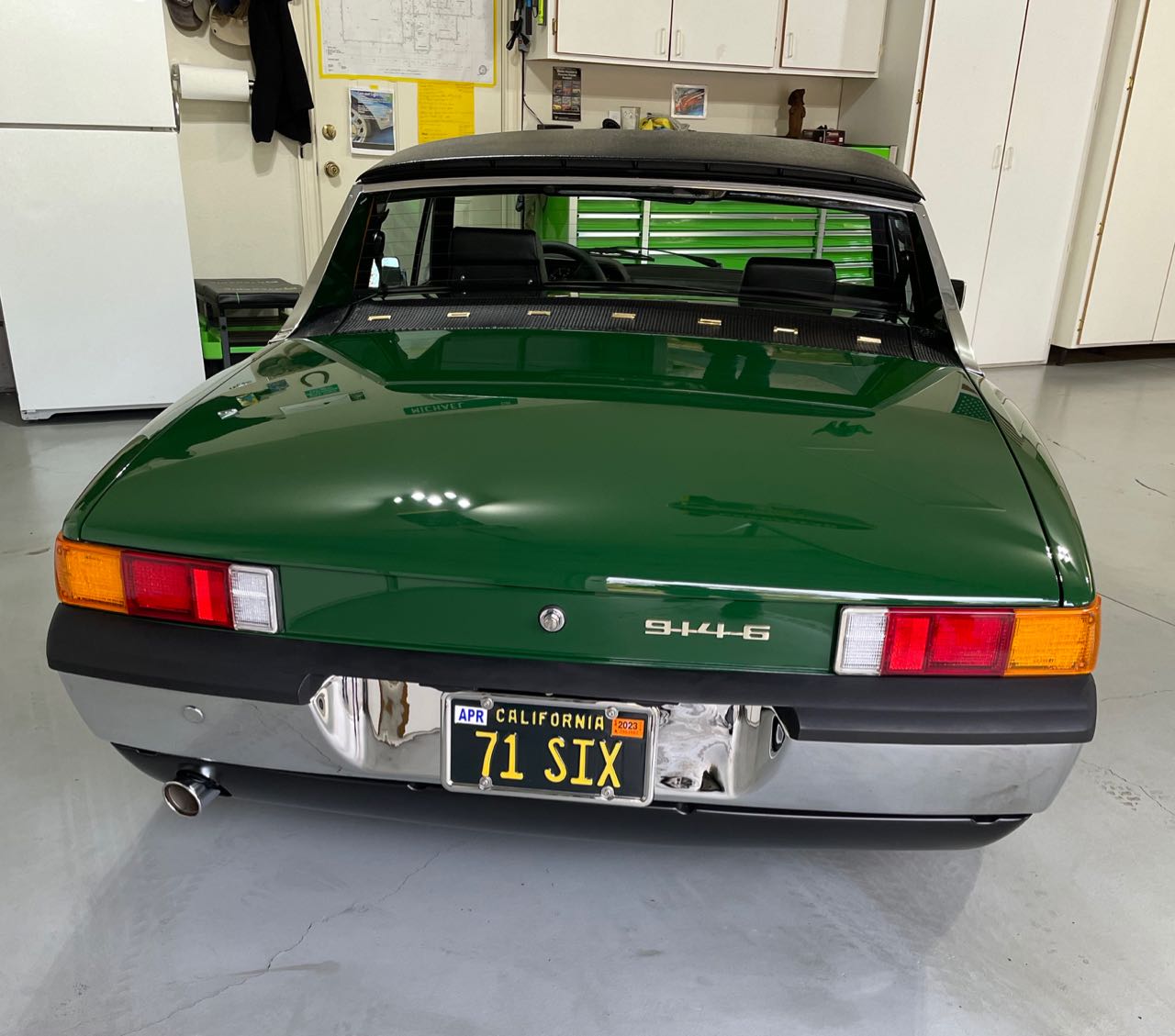

OK, spent the day getting her cleaned back up and putting on a nice coat of wax. Here is the new hi-mount LED brake light.
