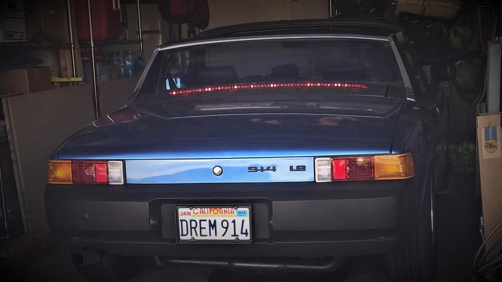

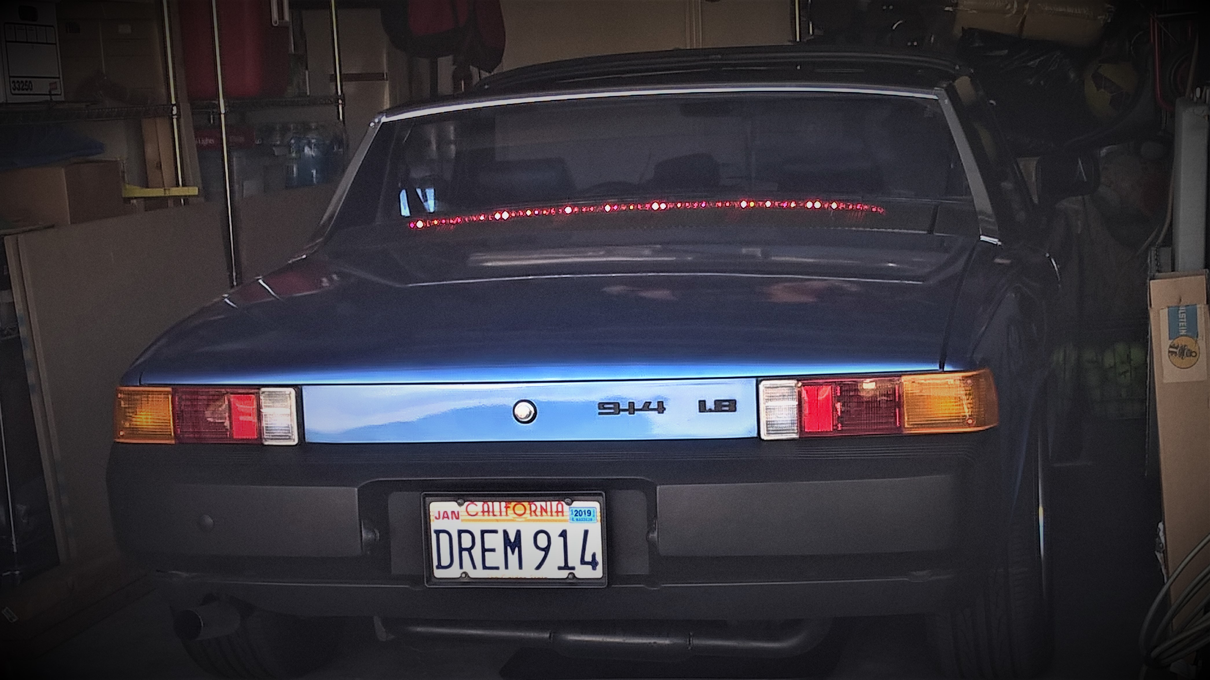

Mocked up a 3rd brake light option under the engine grille.

Love that color. Sometimes I wished that I had taken more time to find one in that shade of blue.

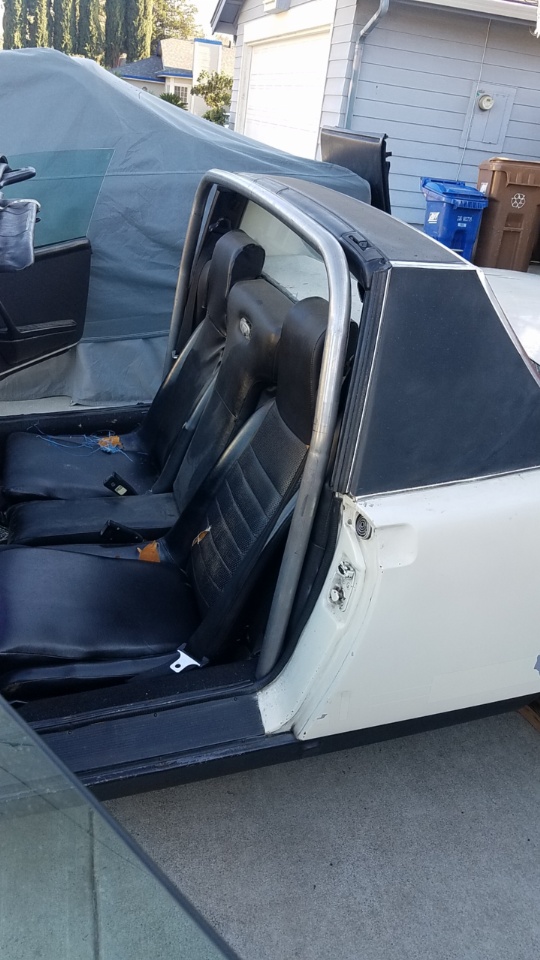

Today, took car cover off and mocked up my GT roll bar copyAttached Image

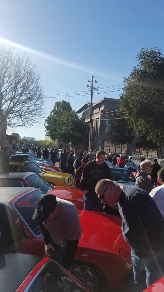

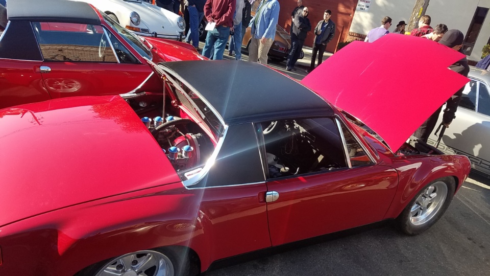

Yesterday we went to EASY, huge crowd and so many people.
No pictures but I must have seen $10K+ worth of Magnus Walker wheels there....

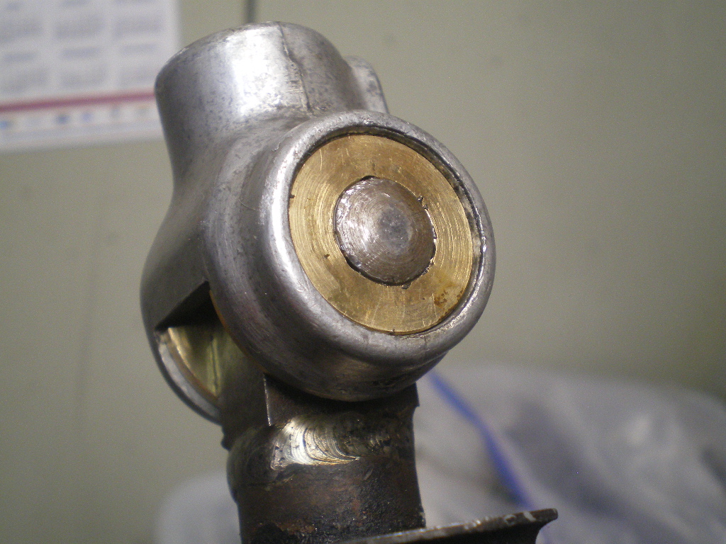

Shifting on Rote was hit and miss when looking for 1st or reverse. Discovered one rounded conical screw and deteriorating bushings at the firewall. Ordered the brass replacements vs. OEM plastic. 5 times as much but I'm looking for improved shifting and durability on this antiquated system. I've been spoiled by the Subaru trans and cable shift on another car. (IMG:style_emoticons/default/av-943.gif)

Also check for slop at the shift console bellcrank that uses a roll pin. I found a lot of slop there, so I drilled and tapped a threaded hole for a small bolt set screw at 90 degrees to the roll pin. Took all the slop out of that connection. Shift pattern is much more predicatable since.

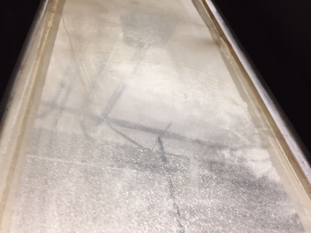

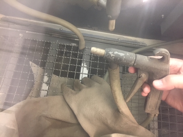

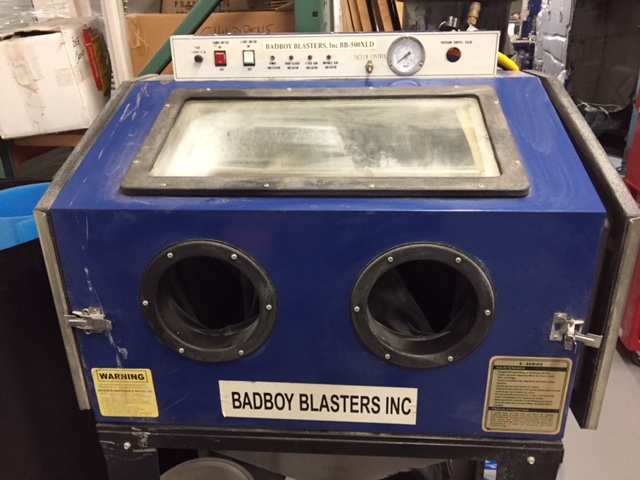

So I am working on my DIY Zinc plating and I had to fix my blaster that I have not used for 6 years. In it I found parts for the carburetors for #41. Off the Eric at PMB good find just in time.
The plastic in the front was so crazed that I had to feel my way to blast so I removed the panel and remover the front 1/16 plastic and put it back with a clean protective sheet in the back. Never use Windex on plastic as it can cause crazing on acrylics.

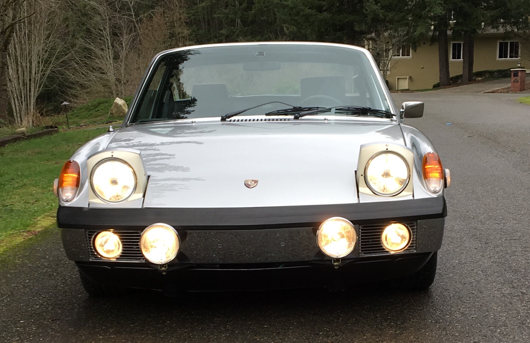

Adjusted headlights, daytime running lights and driving lights.

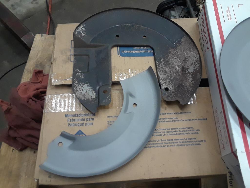

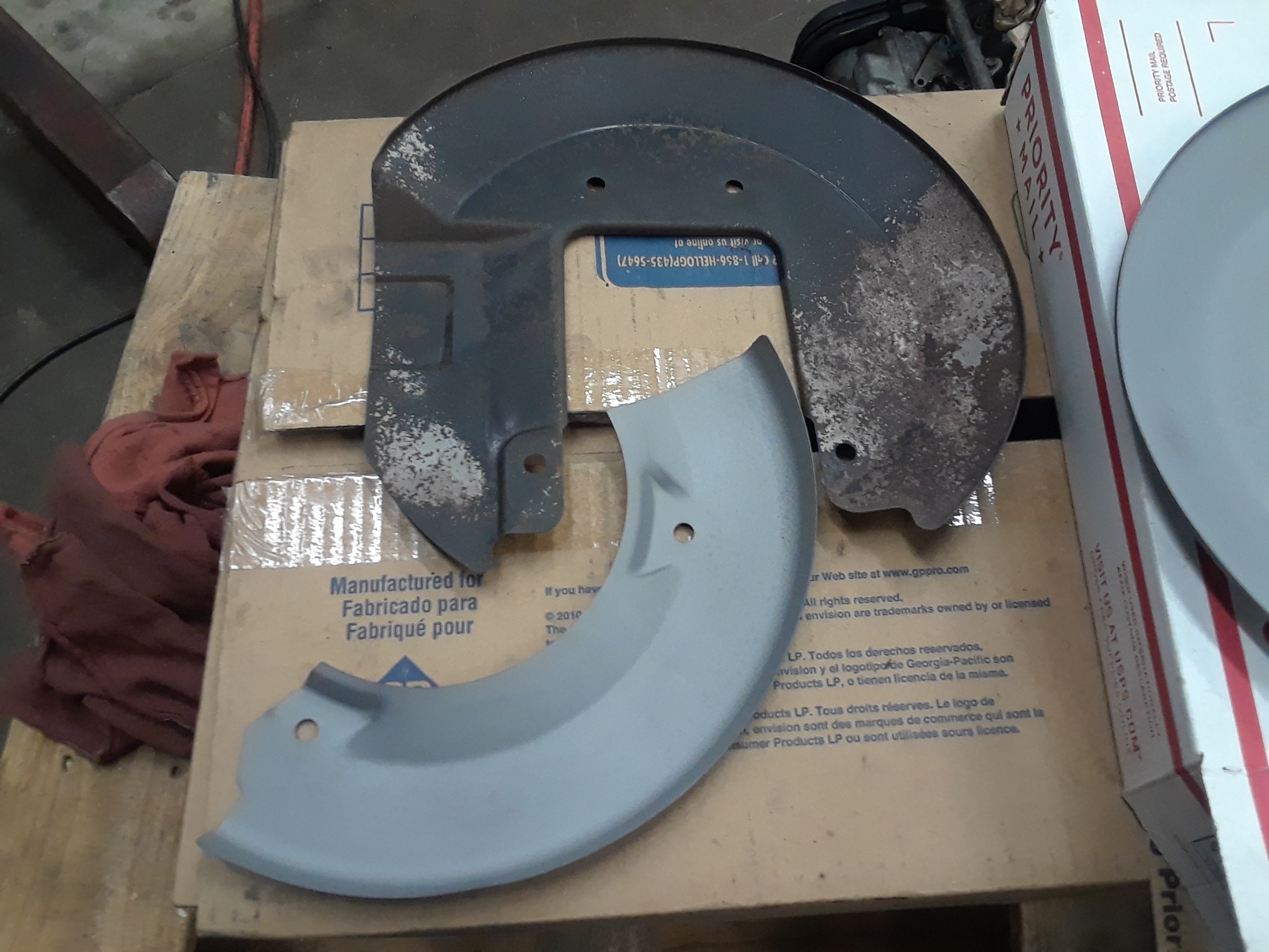

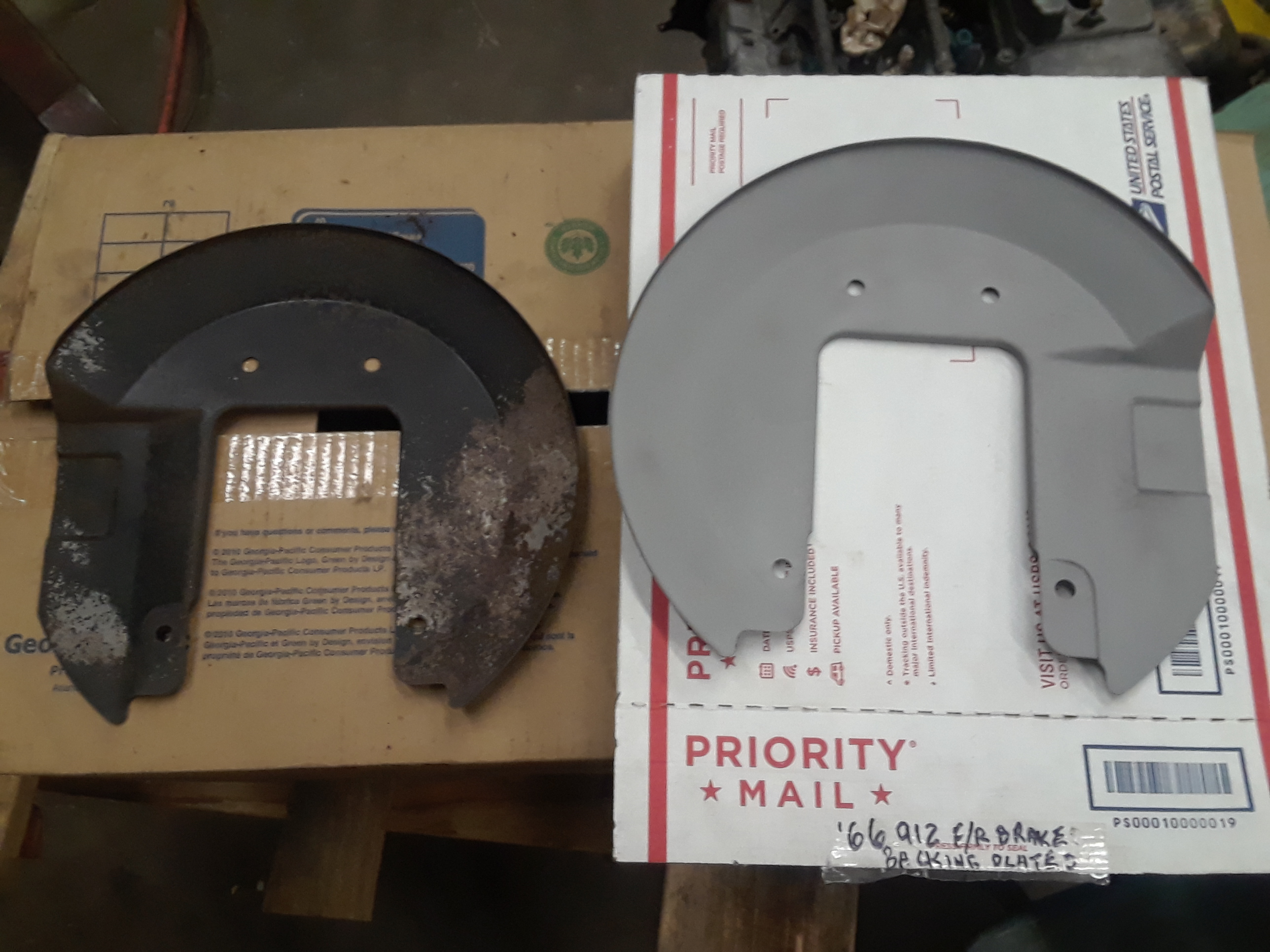

On the subject of blasting, I finished up with the remaining backing plates for the '66 912 at shop class tonight.
Before & After shot of the front plates
Finished off the last of the (4) rear plates
Will wash & prime the parts tomorrow, then paint all of it later in the week. It will be nice having all these parts ready to bolt on when I get the calipers back from PMB.
Also blasted a passenger side 912 head pipe/HE. Will get the same treatment after the backing plates are done.

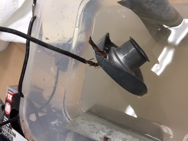

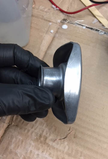

Working with the blaster and the vacuum was full of crap. What I mess to clean up. Found out that the “do your own Zinc plate” needs to sit in the vinegar and Epson salts for a couple of days to get the Zinc to go into solution well. More Zinc till it looks like gray primer. The gold finish did not come out to good and I ordered more of the SODIUM DICHROMATE DIHYDRATE 1 Pound to get the mix to look like what was on the Internet. After I get it all worked out I will post my workings.

Installed the brass bushings last nite. Very tight fit. Pricey little bastards! Hopefully I will be able to test these out this weekend. (IMG:style_emoticons/default/beerchug.gif)

Looks great so far, do you have a link to the recipe you are following?

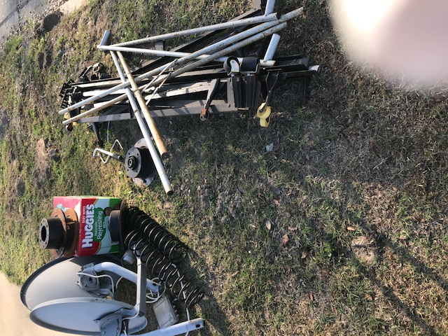

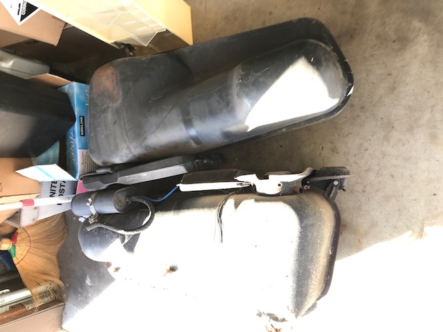

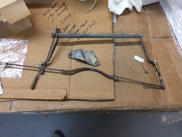

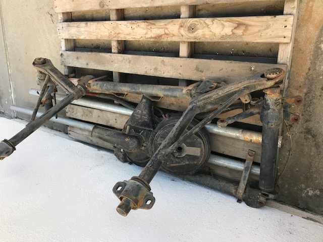

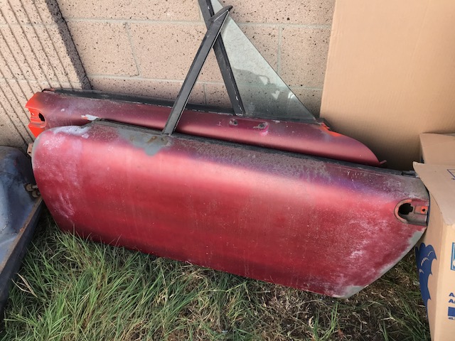

gave all of these to a metal crap guy last friday.
