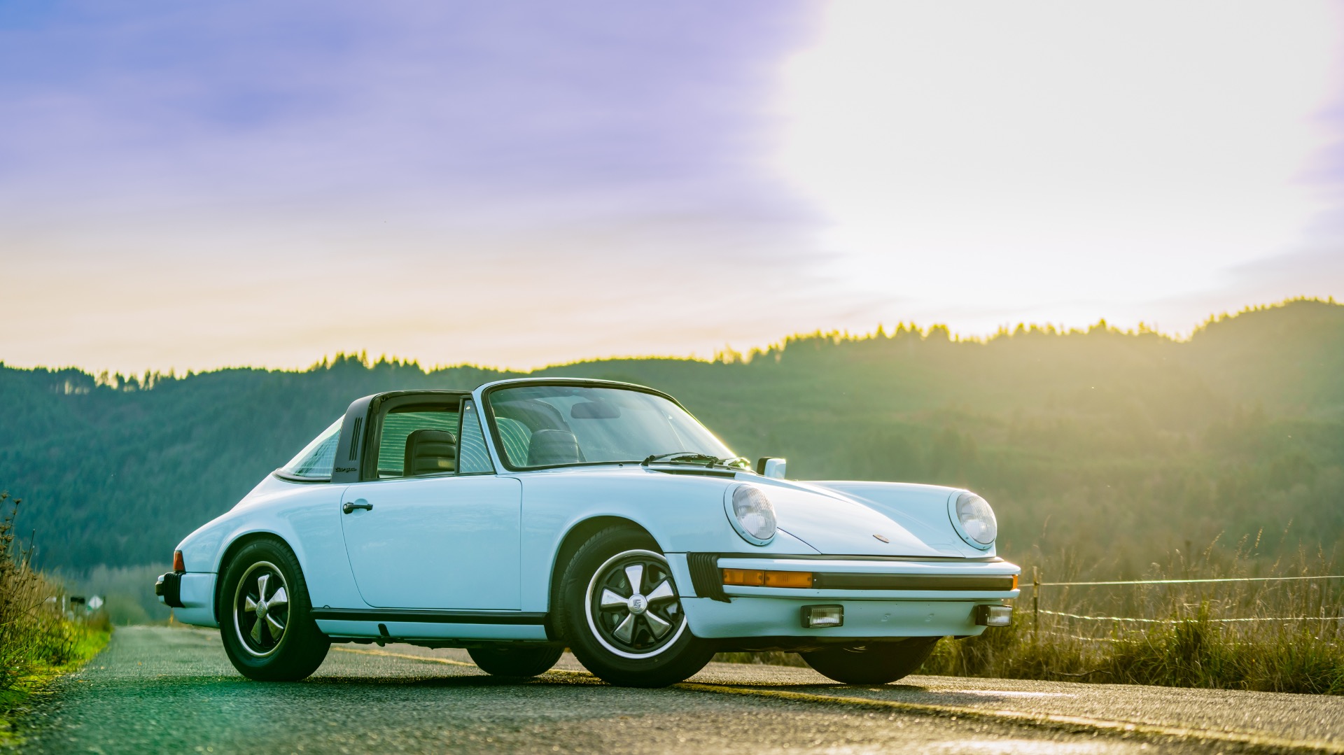

Bought a companion for our 73 914... we loved the color and the history of fine mechanic’s who have worked on it. Our mechanic Chris worked at the Seattle Porsche-Audi dealer during the time this car was purchased.

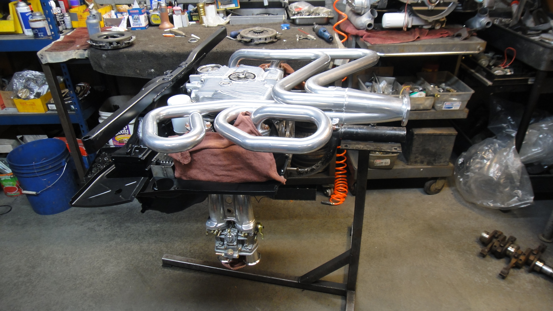

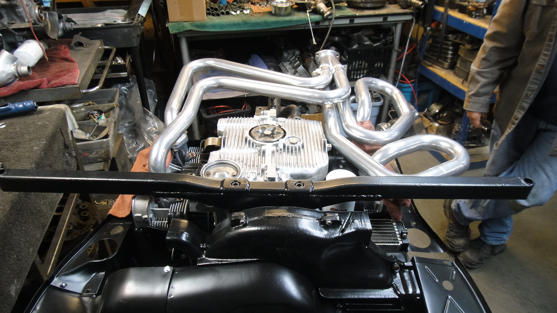

got the headers on today.Attached Image Attached Image

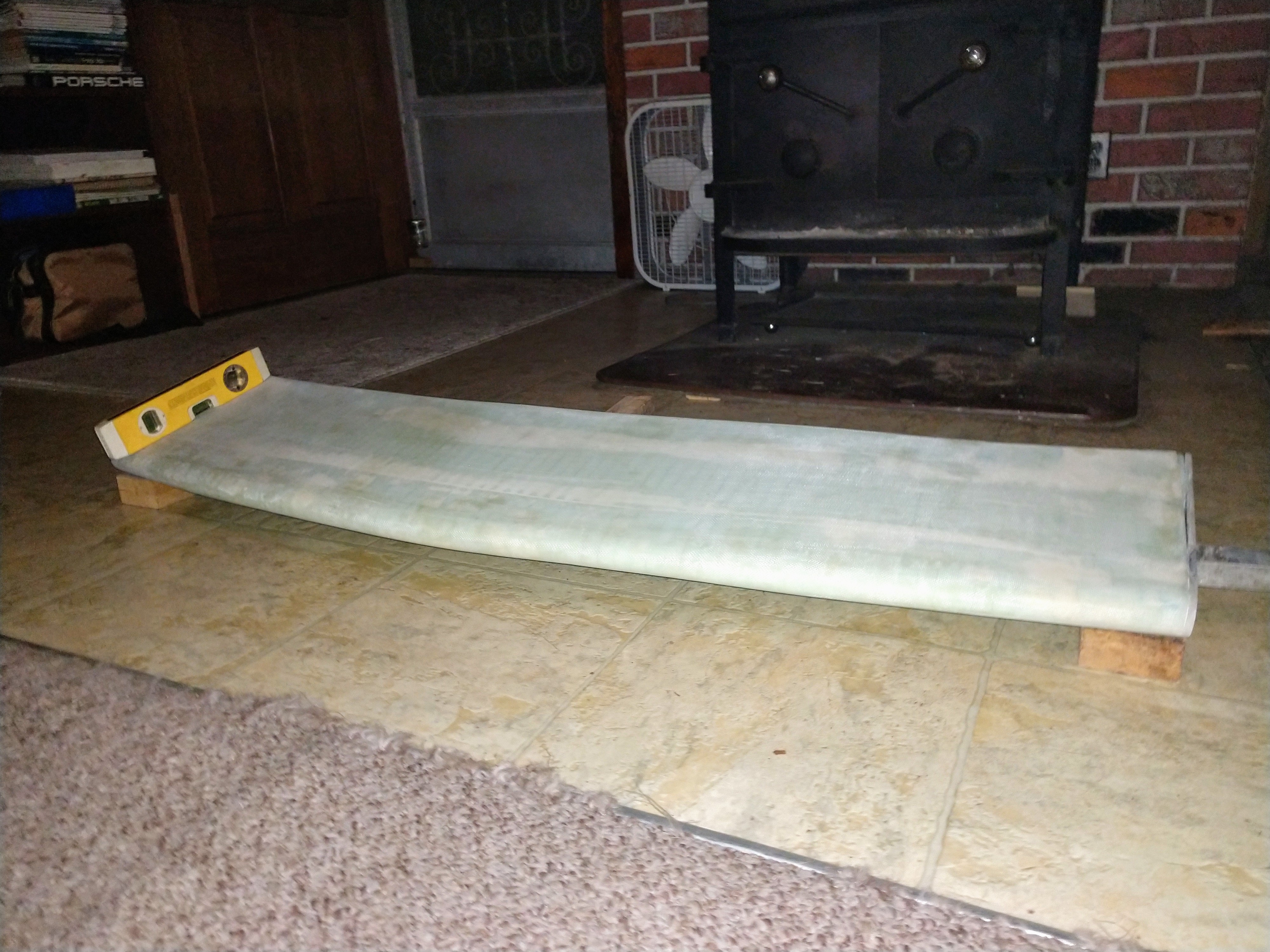

I blocked up the front foil about 2" off the floor just to see it. In the picture the foil is tilted at 10°. I like it and will try to get it to sit 3" off the ground mounted on the car. I have ordered 4" wheels and will put them on the pivot point for the foil. They should keep the nose off the ground. I have a color in mind and may paint the foil before mounting it.

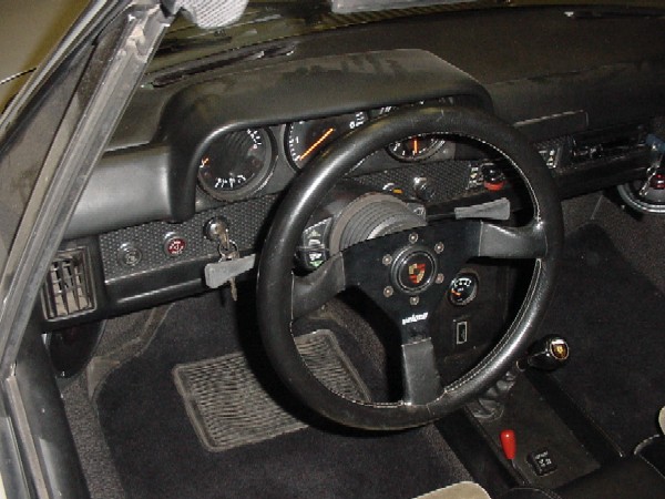

Well I haven't been posting much, or working-on or driving my cars, but I am getting back into some 914 projects. Last weekend, new Momo steering wheel and Dansk muffler.

I hope nothing 'foils' your plans (IMG:style_emoticons/default/rolleyes.gif)

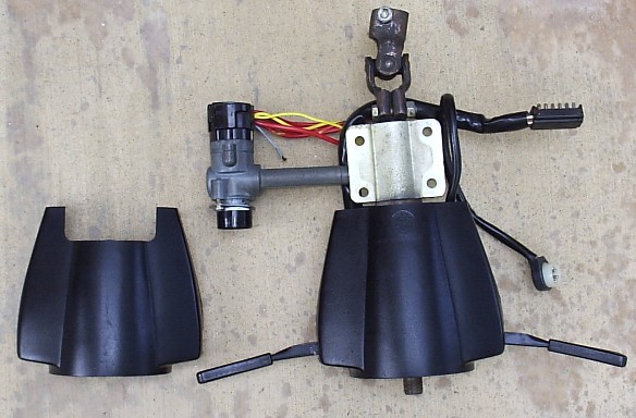

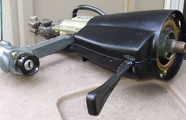

QUOTE(mb911 @ Feb 4 2019, 02:44 PM) *
Assembled my steering column today with the 914 rubber clam shells and the switches I got from Mark Epstein.
For some reason the right stalk is very very close to the steering wheel.. No idea why.
Do you have 911 switches and not 914/6 switches?
The 914/6 switch levers are flatter and are closer to perpendicular to the column. They are shorter and don't have the double curve of later model 911 levers. The lever functions are sticker graphics on the clam shells, not the lever ends.
Compare yours to the pictures below.
The first picture is a salvaged steering column assembly from a 1971 914/6, VIN 9141430335.
Picture 2 shows the straight levers and the function graphics on the clam shells.
links to scrapped 9141430335:
http://www.914world.com/bbs2/index.php?act...mp;viewid=12206
http://www.914world.com/bbs2/index.php?showtopic=52138
NOTE: clam shell on the left is 911.

QUOTE(type47fan @ Feb 13 2019, 04:02 PM) *
Do you have 911 switches and not 914/6 switches? The 914/6 switch levers are flatter and are closer to perpendicular to the column. Compare yours to the pictures below.
Pictured is a salvaged steering column assembly from a 1971 914/6, VIN 9141430335.
Oh that could be the issue.

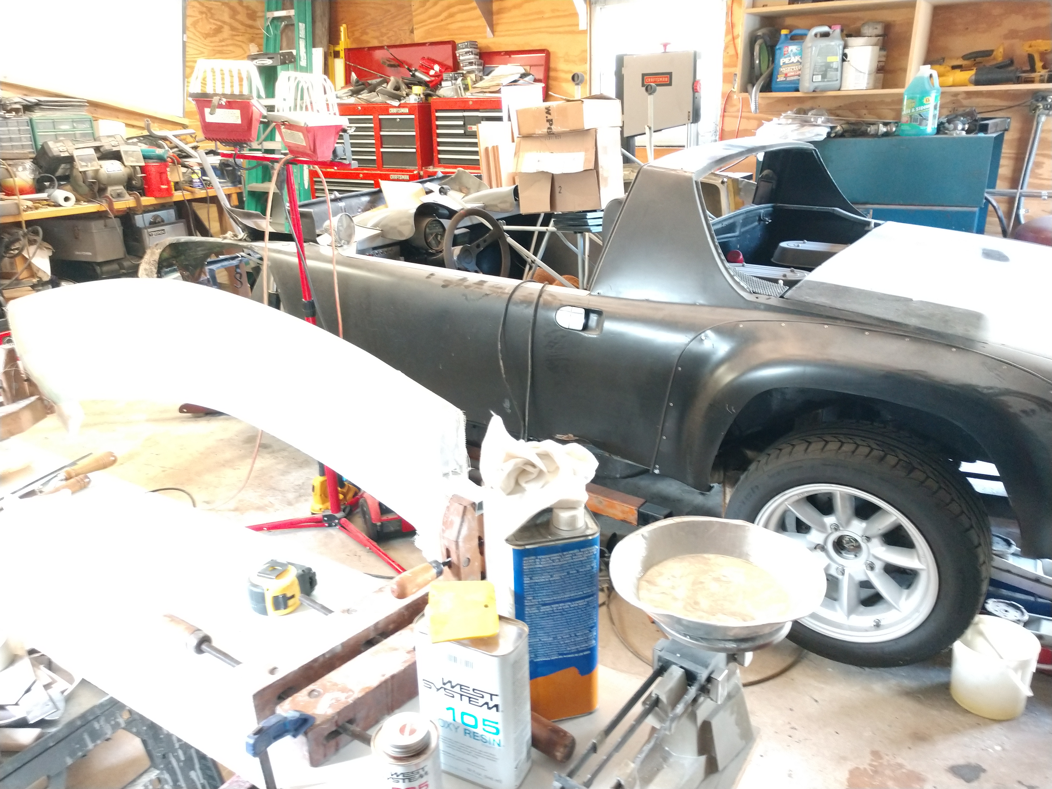

Have to wait to drop the front suspension I'll keep going forward with the wing.

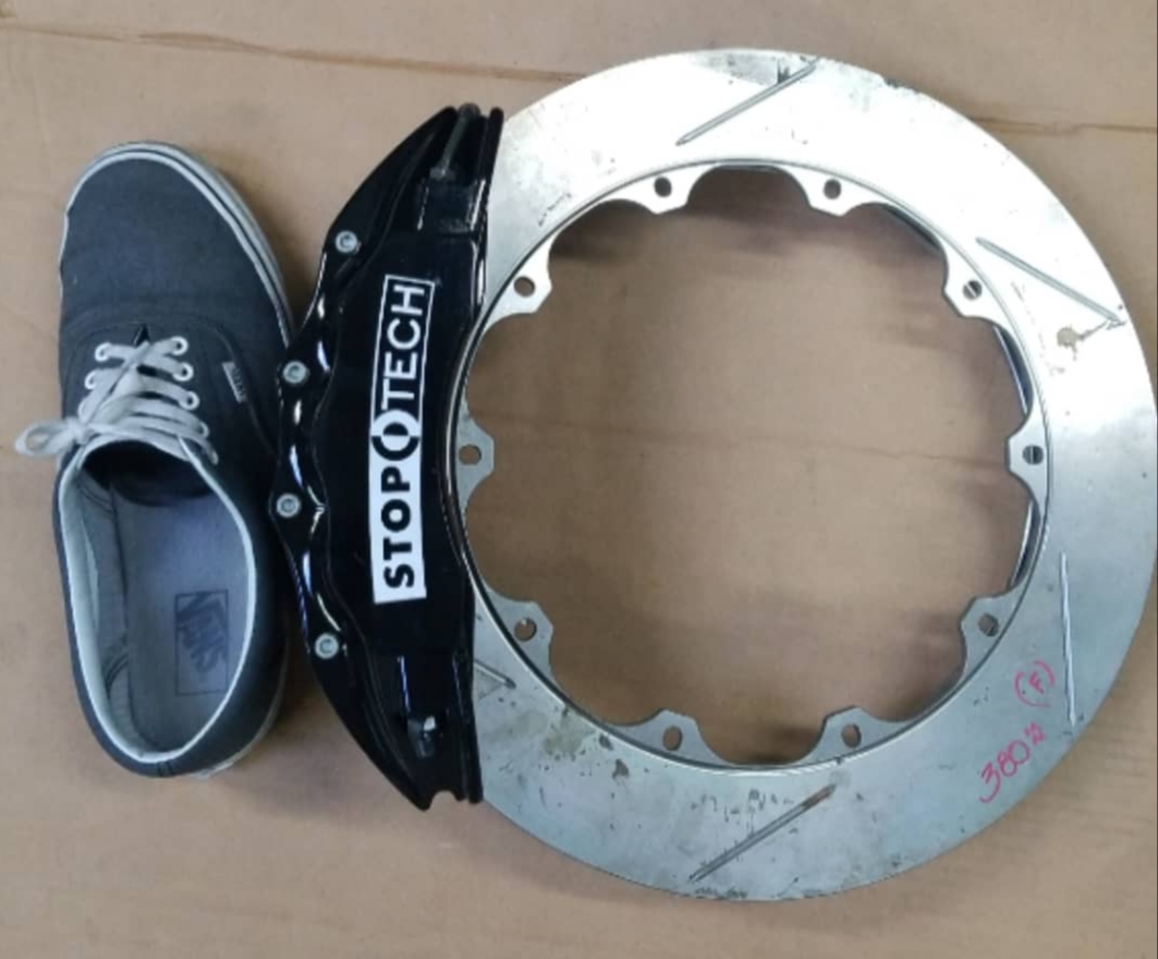

Picked up some brake components from StopTech r/d dept. for trial fitting to the JRZ front struts (shoe is not being installed)

QUOTE(Maltese Falcon @ Feb 16 2019, 09:33 AM) *
Um ... brake shoe? (IMG:style_emoticons/default/rolleyes.gif)
