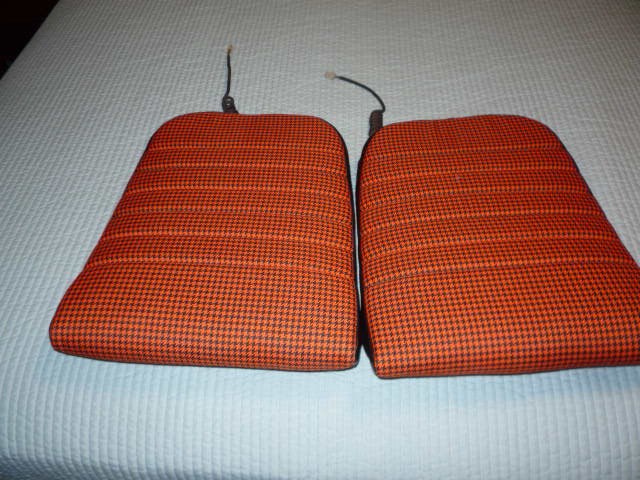

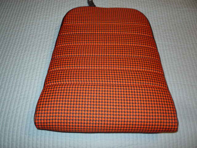

Did some seat work. Got seats stripped and cleaned up. Bottom cushions went pretty quick. Sides are heating up so they can be stretched on. Not liking how they are fitting, may take to professional. Car is a L20C orange 75, converting to black interior from aftermarket tan.

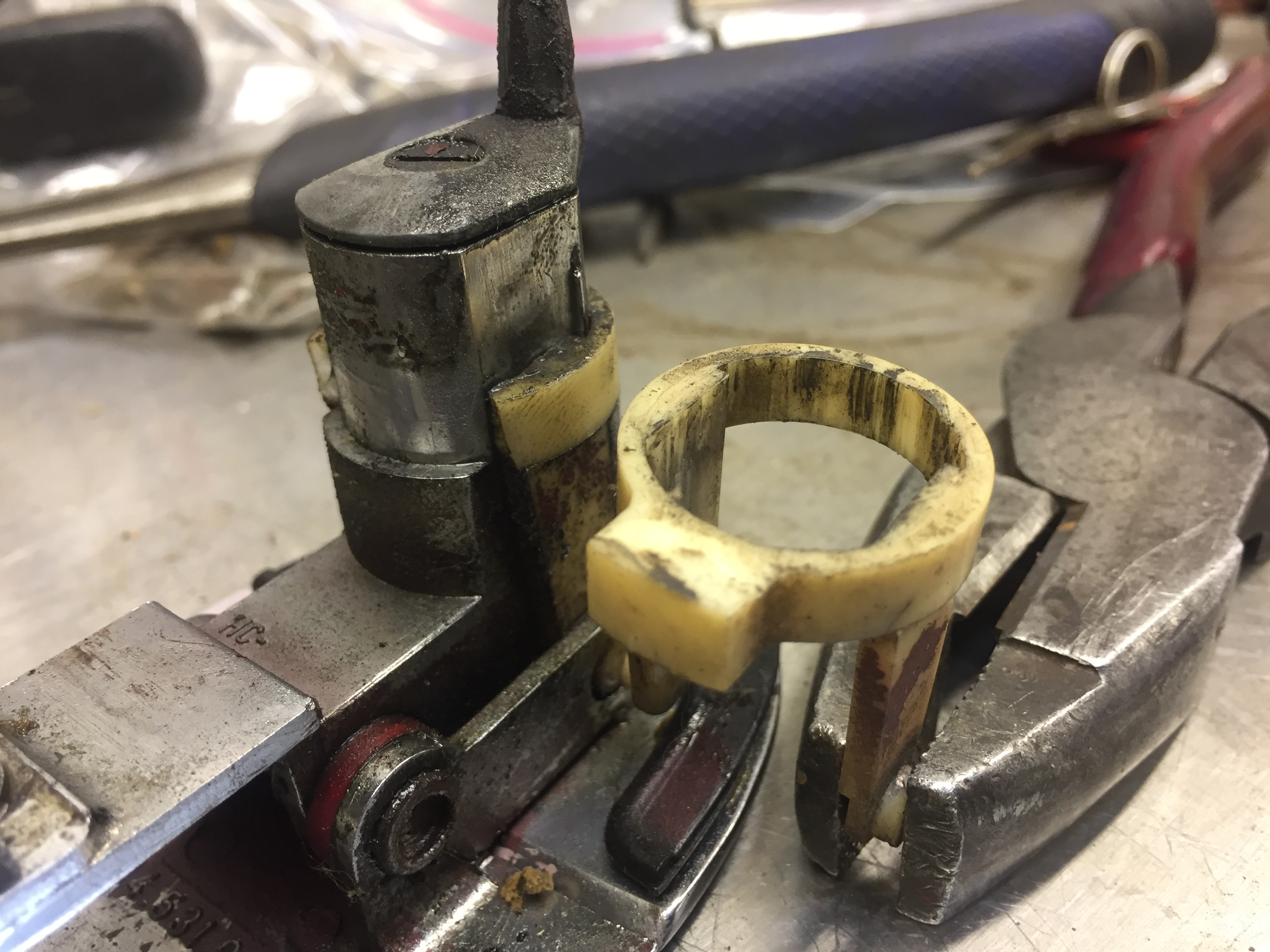

Had to grind off retaining screw on left door handle to get it out - became clear why it wouldn't work - when what was hidden could now be seen - nylon plunger was broken off out of sight....good plunger part from right door shows. Rt. door broke in weak cast section - both door handles failed after I got the car.....

QUOTE(Gatornapper @ Apr 27 2019, 07:30 PM) *
Spent 4 hours last night trying to get driver's door handle to work - plunger inside misses the latching mechanism. Did some bending on the metal flange that is supposed to hit the plunger, but now the plunger hits it but then then slides off. Guess I'll be taking another whack at it. Cannot figure out what has happened. One day the handle worked, next day it didn't.
Anyone know a history of this happening?
But there are 2 other issues:
I pulled the latching assembly at least a dozen times, completely re-conditioned it, even soaking it in carb cleaner, re-lubing it. The sliding movement up and down of the locking assembly is far too difficult, as if something is binding - but I sure can't see what it is.
Also, went to remove the 10mm nut on the door flange that is hidden with the door closed to remove the handle assembly - and guess what? The stud embedded in the cast door handle material spins in the cast metal. So I cannot get the nut off.
Any suggestions for that?
GN

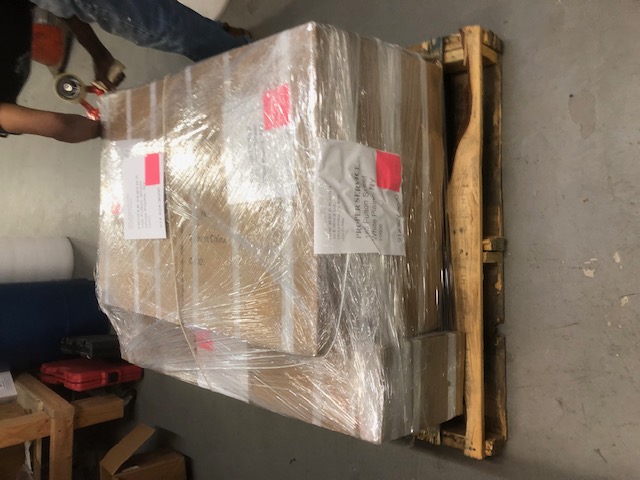

Packed up the front Carrera suspension to go to Jo Proper back east. Lots of work to pack each part in individual boxes so nothing would get damaged. In is in great as new shape and will stay that way.

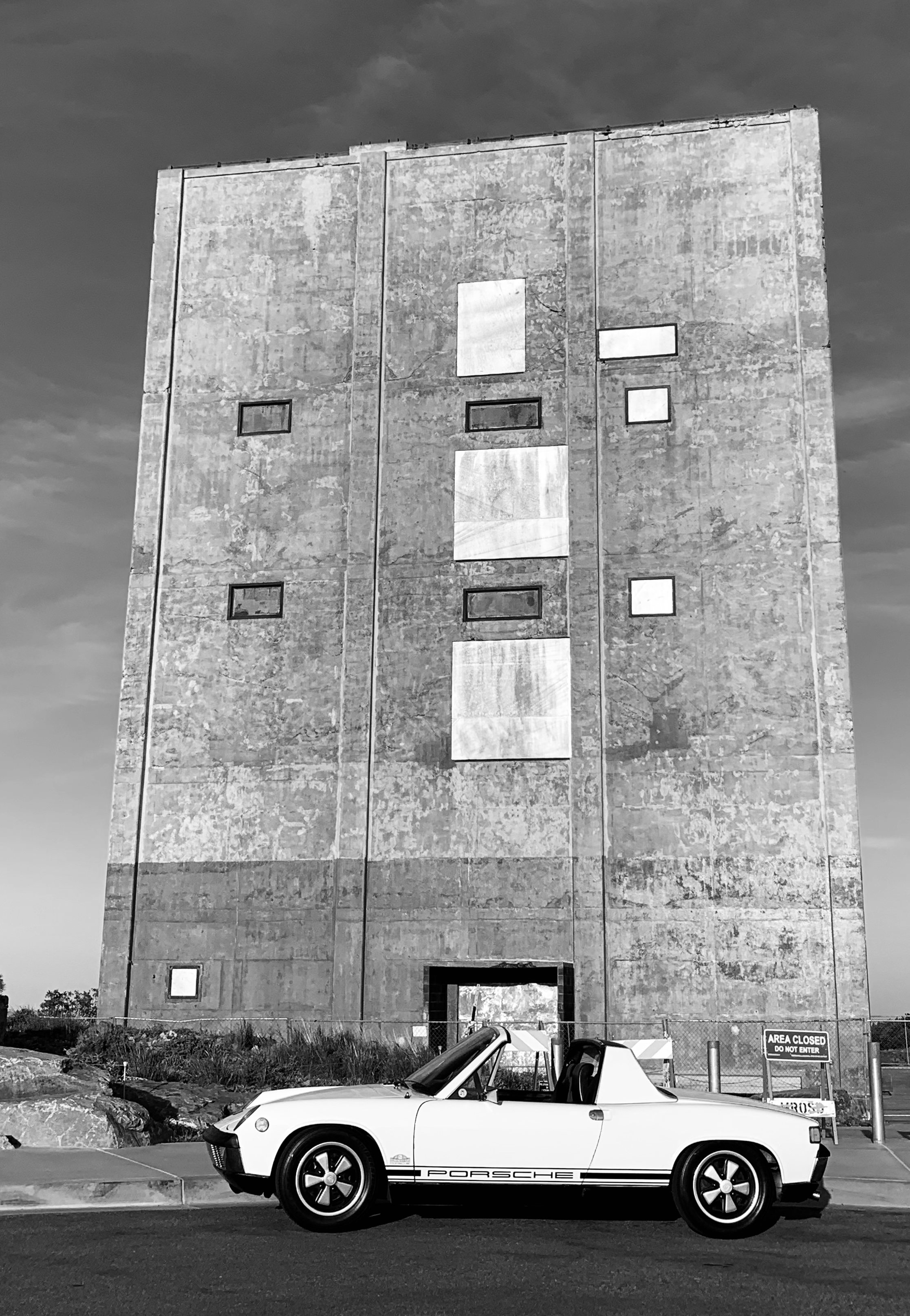

Took it out for an evening romp on the back roads near my house to the top of Mt. Umunhum in San Jose. About an 11 mile road to the top and did not get stuck behind a single car. (IMG:style_emoticons/default/piratenanner.gif) (IMG:style_emoticons/default/aktion035.gif) (IMG:style_emoticons/default/driving.gif) (IMG:style_emoticons/default/smilie_pokal.gif)

QUOTE(Michael N @ May 2 2019, 09:02 PM) *
Ok, being on the east coast, and many years since I was in San Jose, can you tell us what that weird wall that looks like OSB is behind your beautiful Teener?

QUOTE(914Sixer @ Apr 29 2019, 07:38 PM) *
Mark, those look great, where did you get the material?

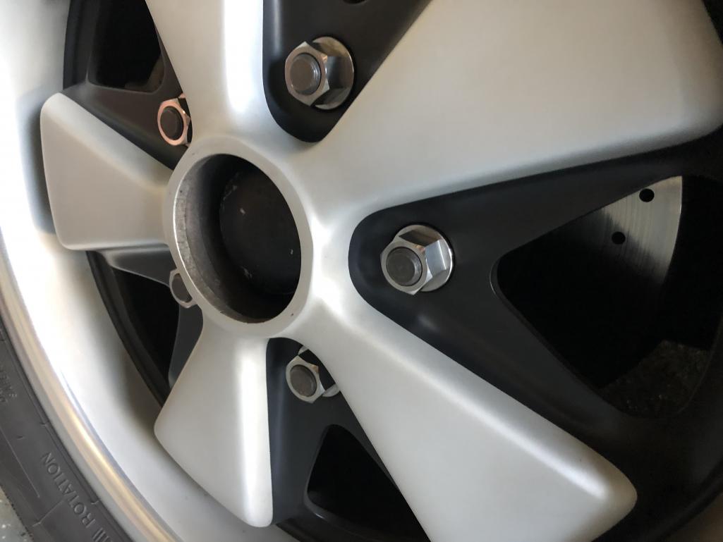

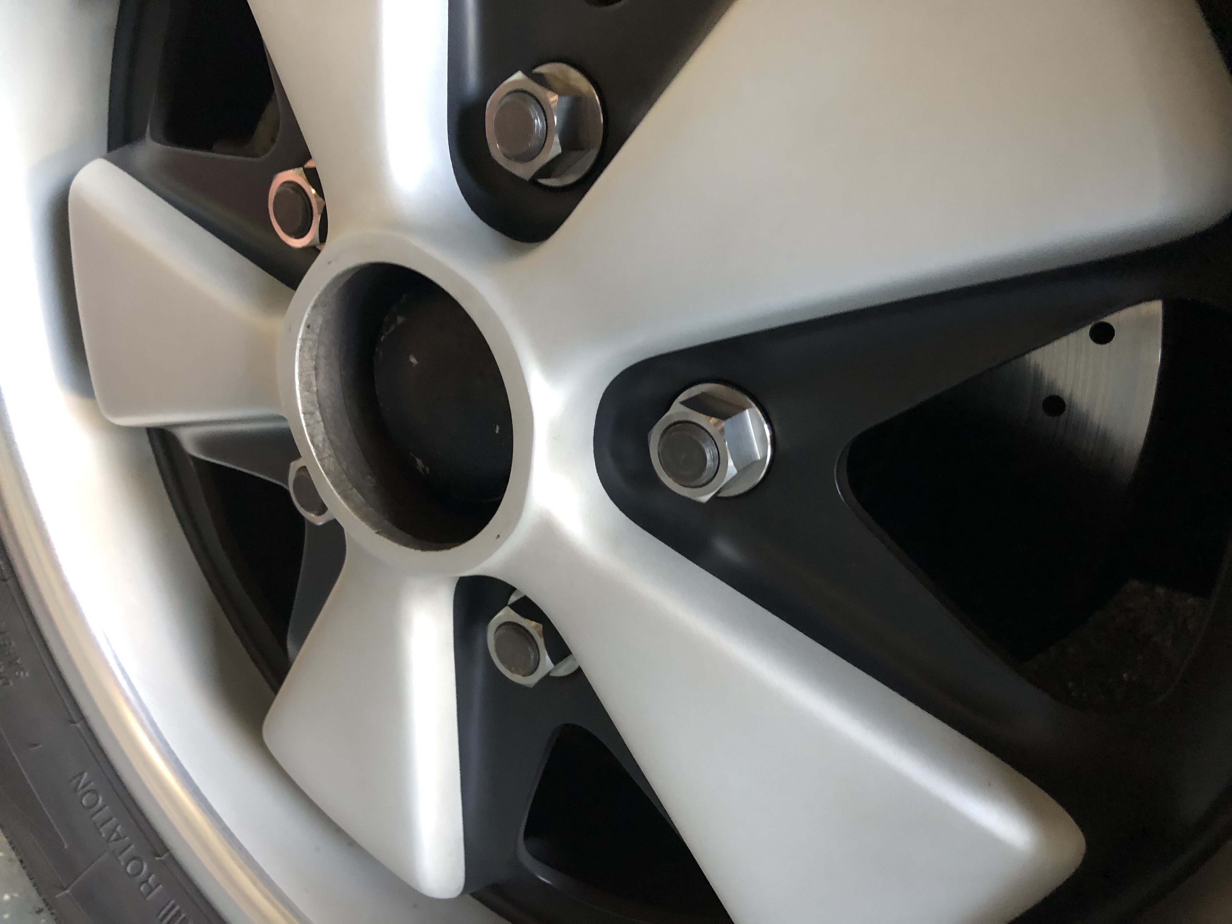

New raw titanium lug nuts.
Just because.

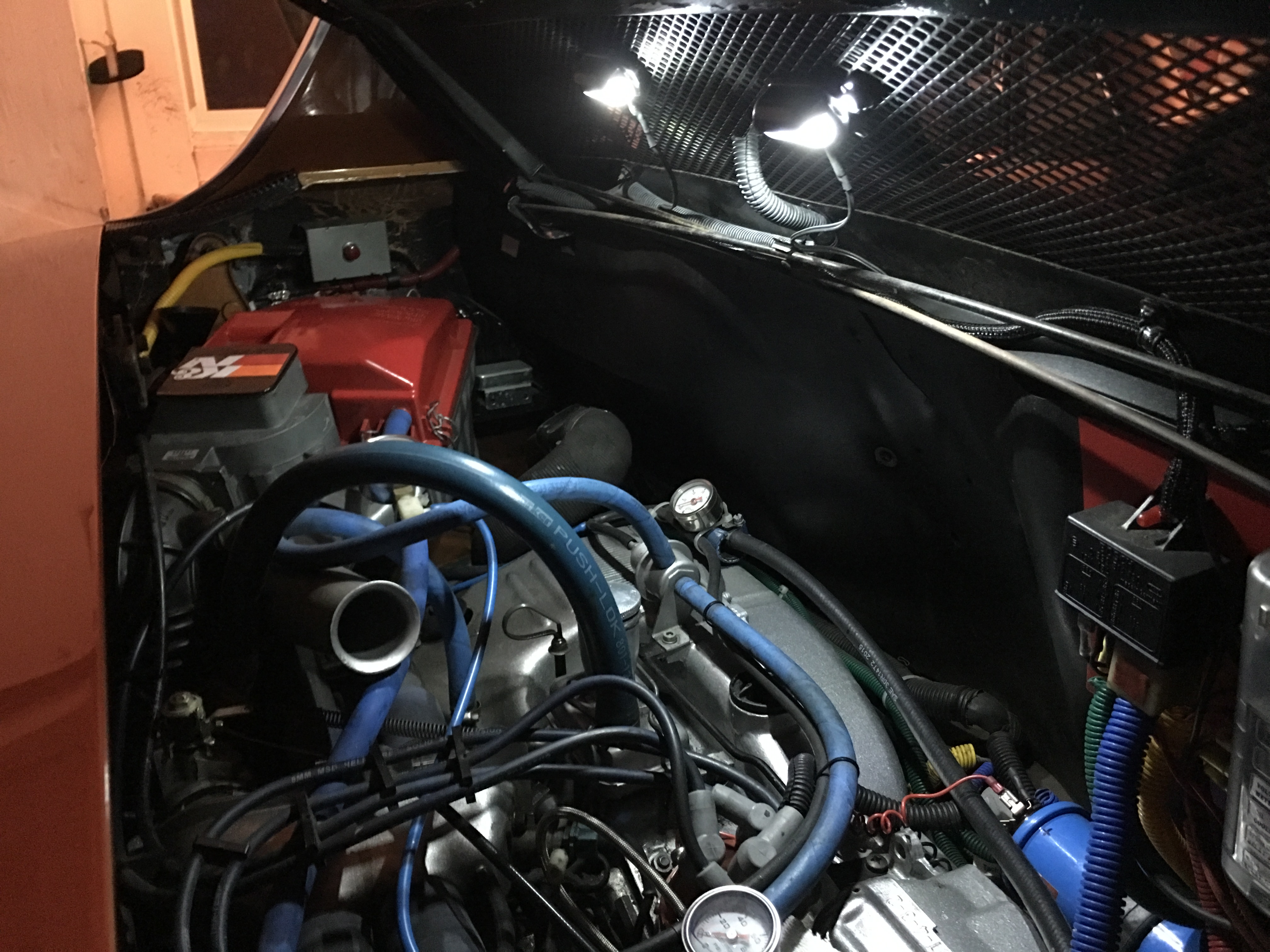

Installed two LED lights on engine lid. The lights are LED license plate lights. They attach to the engine lid by rare-earth magnets and can be moved. The lights ground is activated by a tilt switch attached to the lid. Lights only come on when the lid is raised

QUOTE(jim_hoyland @ May 3 2019, 08:18 PM) *
Nice job. Jim

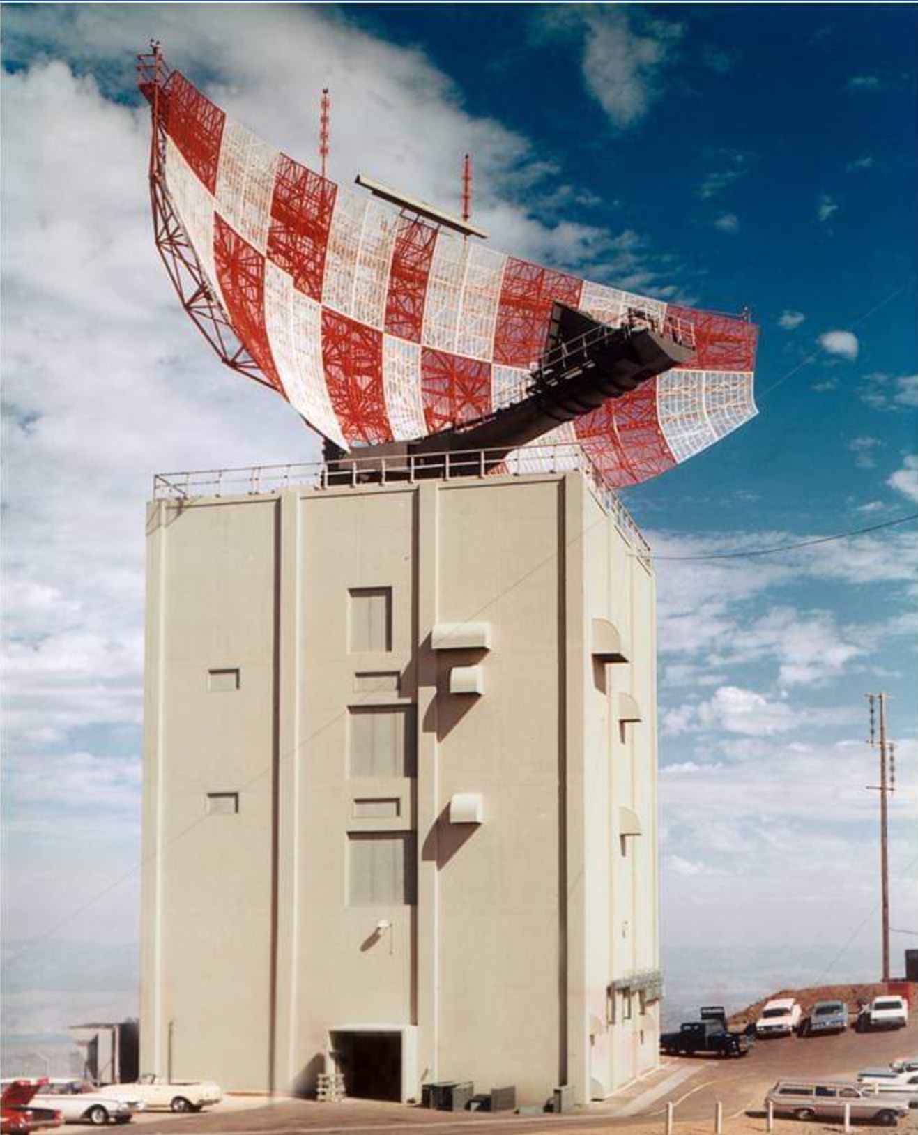

QUOTE(Gatornapper @ May 3 2019, 04:20 AM) *
It is the remnants of an old Cold War Era Air Force radar station that was part of a network that overlooked the West Coast. Opened back up to the public access last year for the first time in decades.

Wow! Thank you! Makes total sense now, more info than I'd ever guess!
Looks like a perfect ride for a 914!
GN
