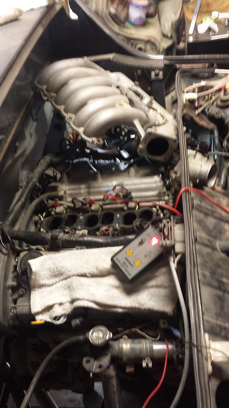

Bad squirts deja vu. 5 of 6 injectors stuck again a year later. (IMG:style_emoticons/default/ar15.gif) (IMG:style_emoticons/default/ar15.gif) (IMG:style_emoticons/default/ar15.gif) (IMG:style_emoticons/default/ar15.gif) (IMG:style_emoticons/default/ar15.gif)
(IMG:http://www.914world.com/bbs2/uploads_offsite/live.staticflickr.com-431-1558475053.1.jpg)
Once again a day away from running for the 12th time (IMG:style_emoticons/default/wacko.gif)

Nissan side feeds are kind of known for that.
Have you considered a top feed conversion if there is one?

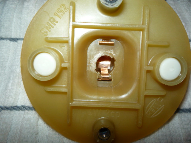

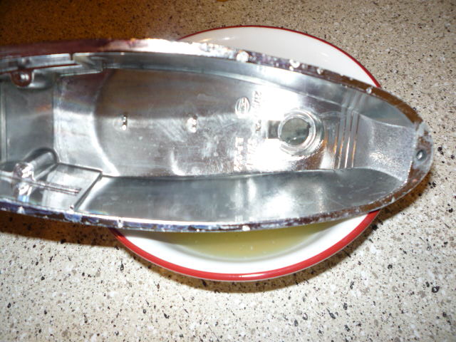

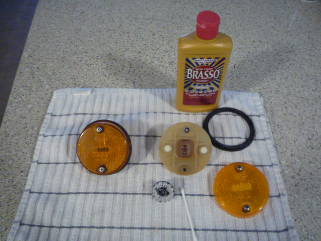

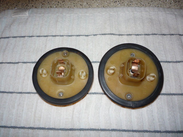

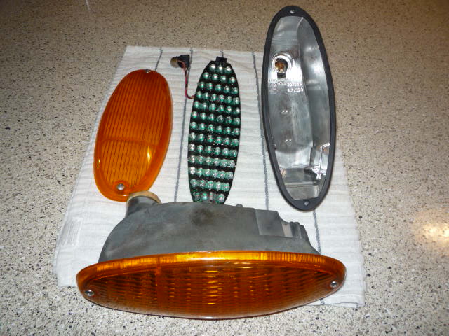

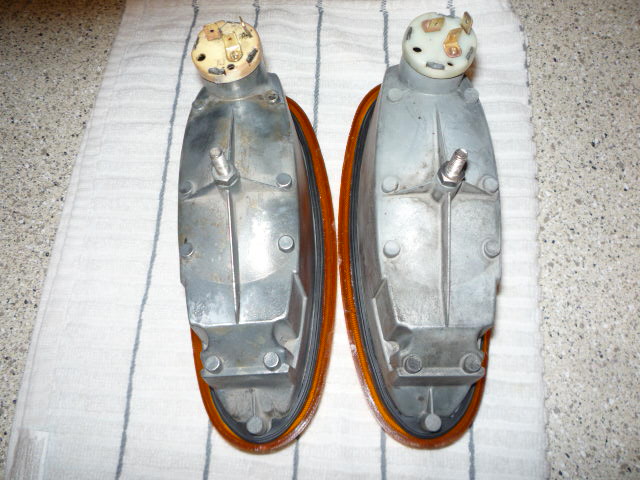

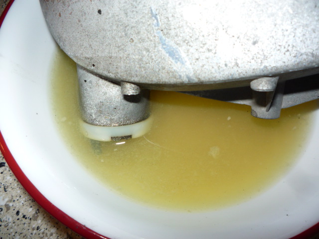

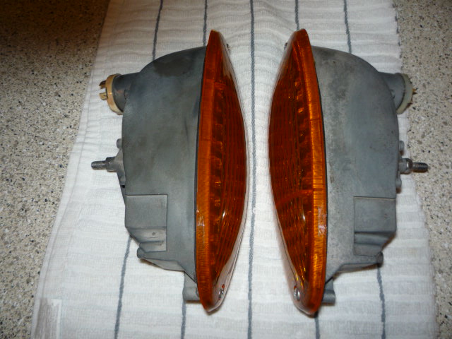

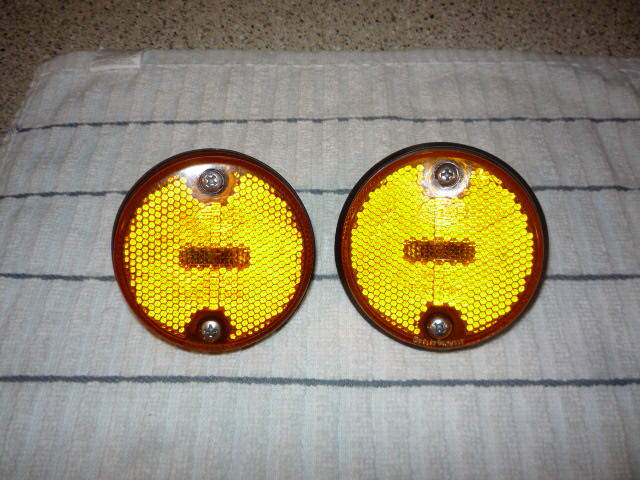

Spent the better part of 5 hours cleaning and restoring marker lights and turn signal buckets. New gaskets on all pieces Did Spokes LED upgrade. Probably a little anal on the cleaning but I am good with it. Let the bucket bulb end soak in lemon juice to clean corrosion out of inside of socket. No good way to get it done.

CLR bathroom cleaner actually works pretty well for that.

Looks nice ... how's it run?
BTW, nice repro bumper end caps are available from several 'Bus/Vanagon' vendors, and are fairly inexpensive. I replaced all of mine.

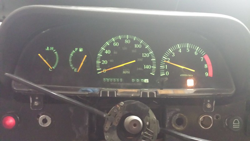

(IMG:style_emoticons/default/piratenanner.gif) (IMG:style_emoticons/default/piratenanner.gif) (IMG:style_emoticons/default/piratenanner.gif) (IMG:style_emoticons/default/piratenanner.gif) (IMG:style_emoticons/default/piratenanner.gif) (IMG:style_emoticons/default/piratenanner.gif)
(IMG:http://www.914world.com/bbs2/uploads_offsite/live.staticflickr.com-431-1558506596.1.jpg)
Still a few issues, like the Walbro fuel pump whines like a fuching jet engine. About a full days worth of work left to do before WCR and some shake down runs (IMG:style_emoticons/default/biggrin.gif)

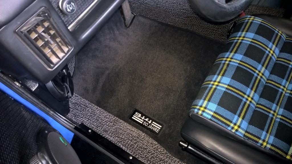

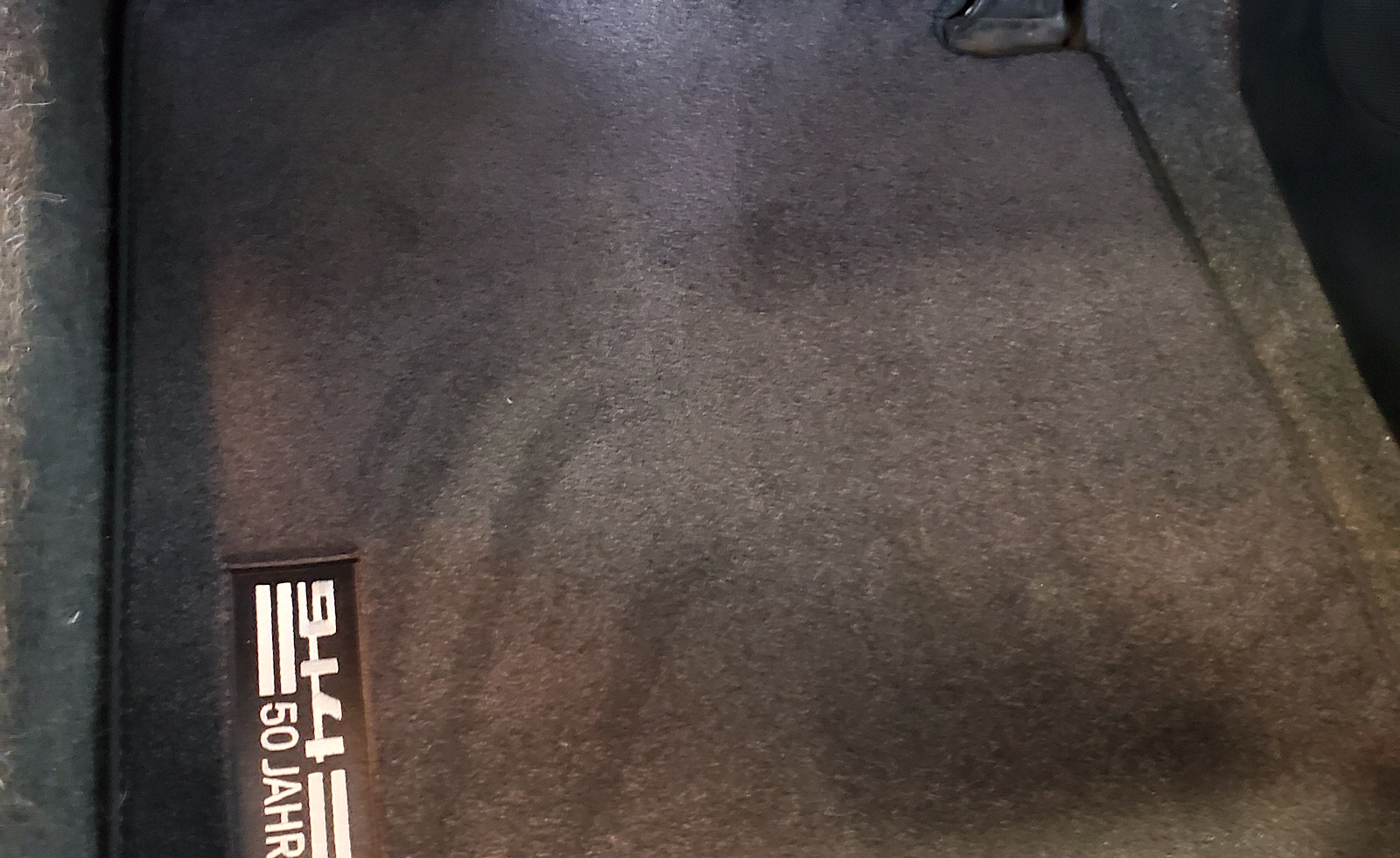

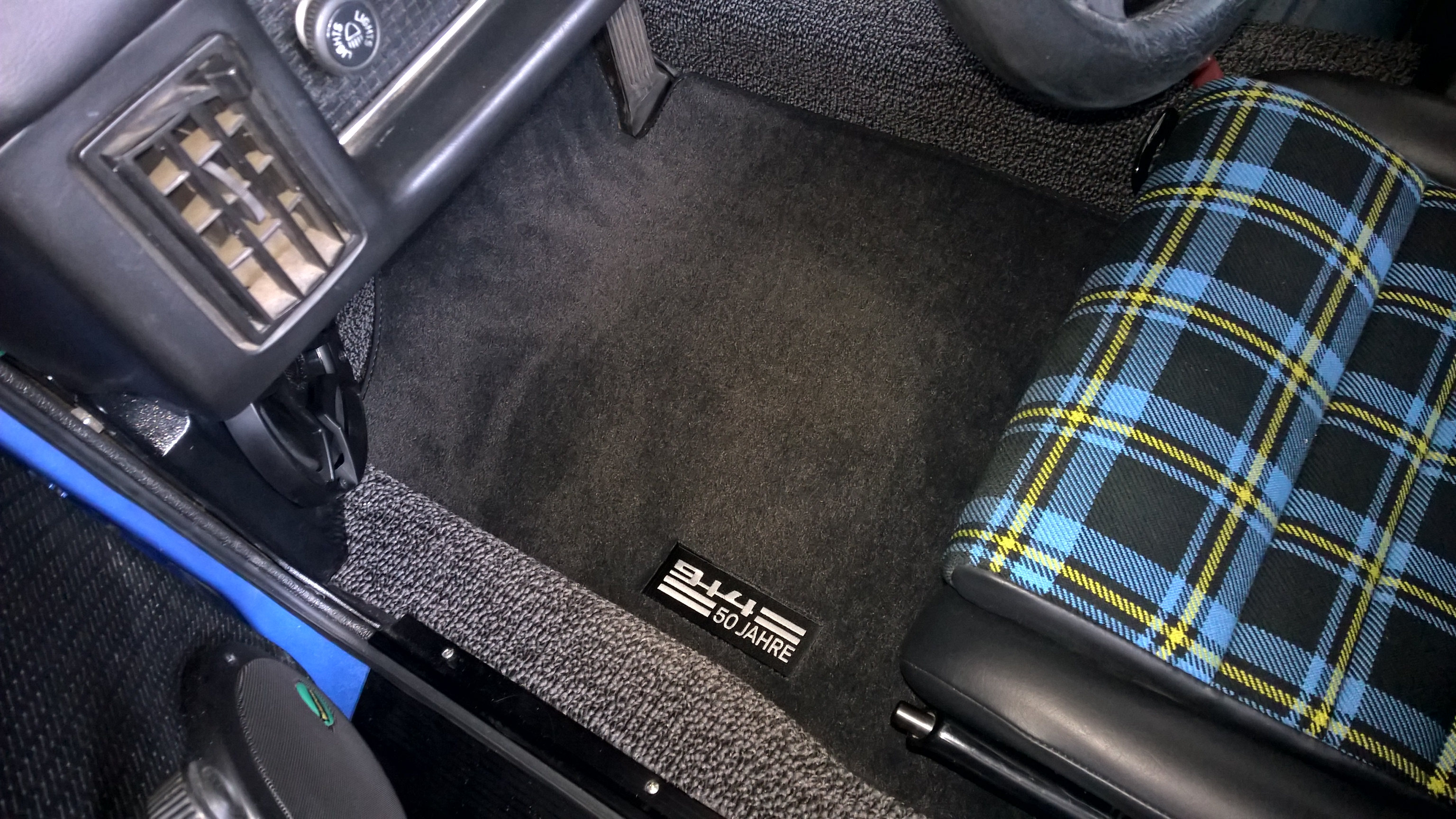

Installed the 50th anniversary carpet

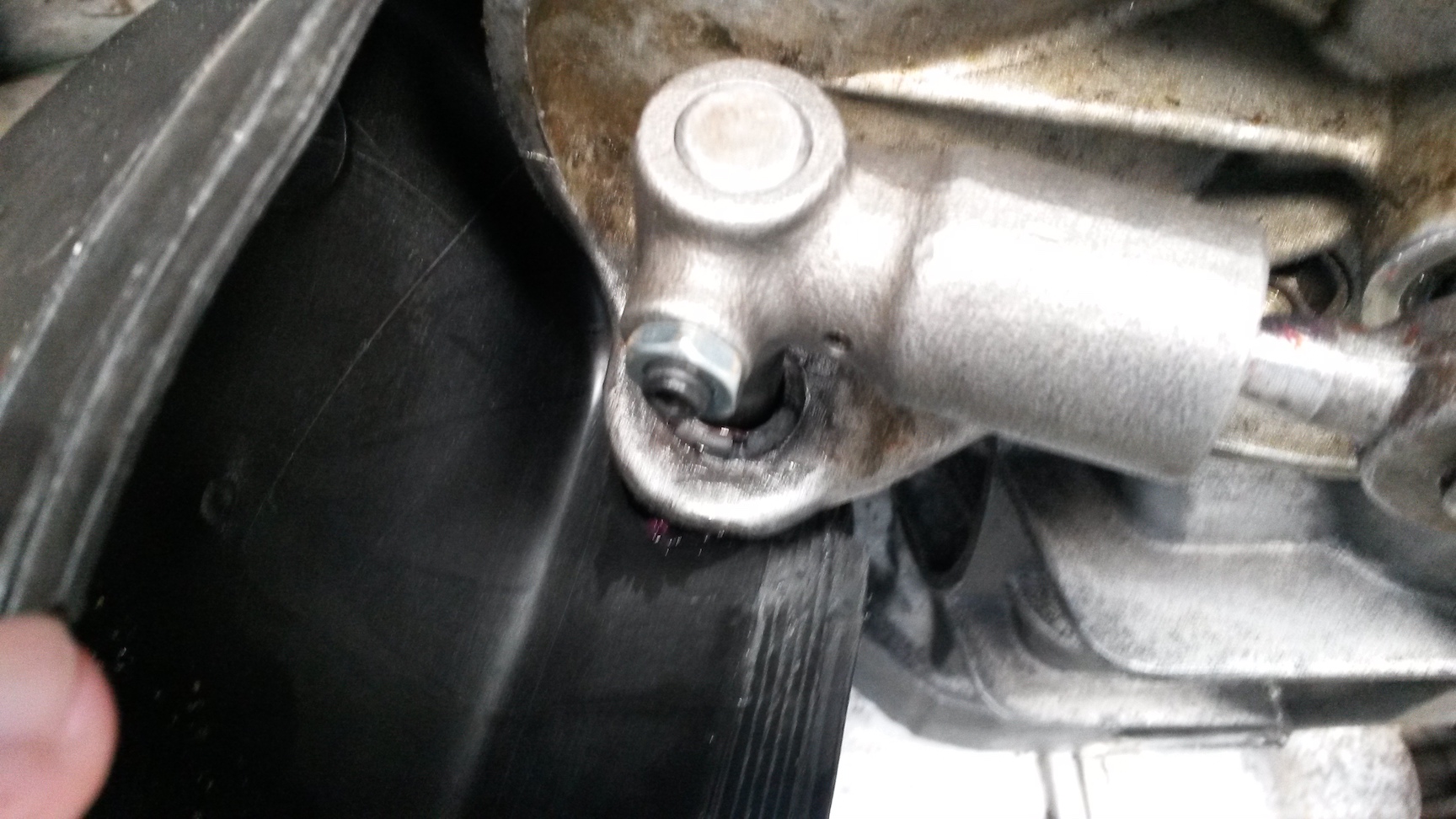

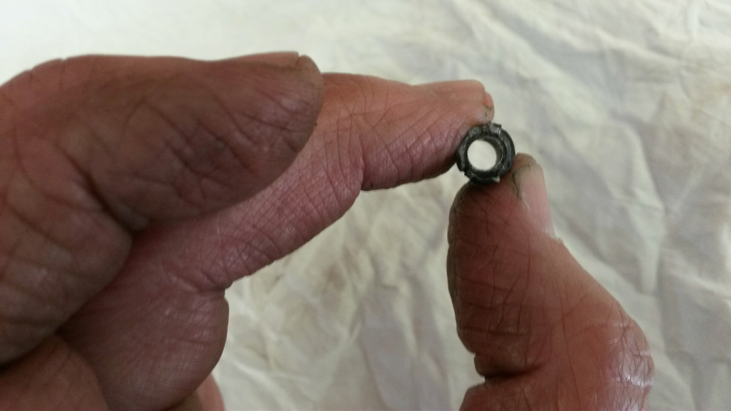

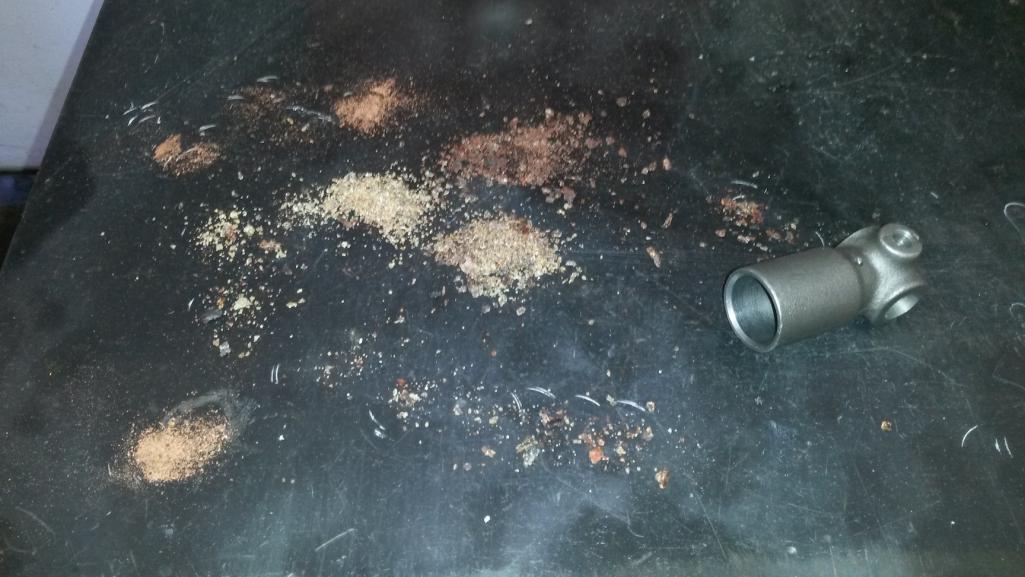

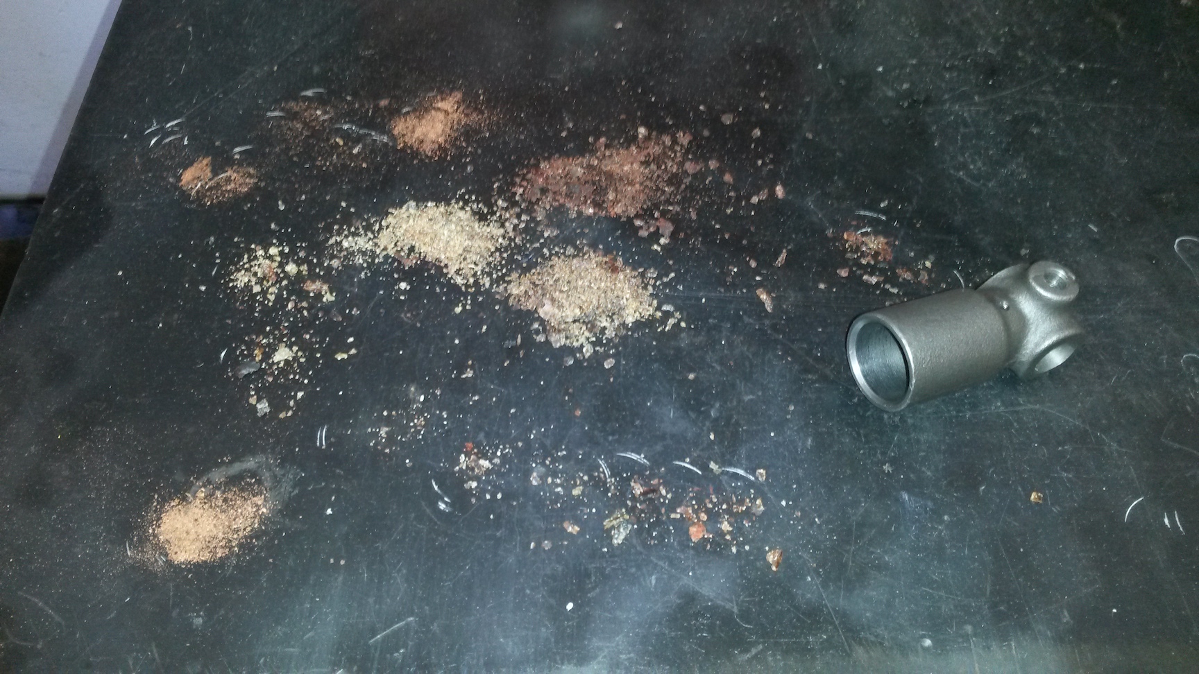

Shift linkage couplings.
Spent most of the day fighting a stripped out Allen-socket on a cone screw. Not sure who effed it up, but I’m betting on the garage I took the car to last year (I wanted a “professional” to give it a going over after years of DIY stuff on my part).
Hated having to drill it out, but it couldn’t have gone much better if I’d used a drill press:
I was able to (hand-held) drill straight through the screw and sever the tip of the cone without touching any of the threads…
Lucky me—the other screw was in good shape and came out pretty easily. So did the remains of the ball cup bushing:
(IMG:style_emoticons/default/barf.gif)
Could explain why the shifter felt like a broomstick in a bucket.

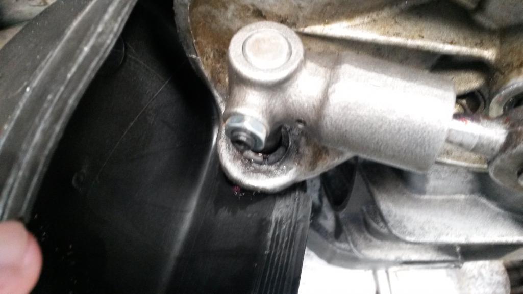

Put it all back together using new coupler bushings, cup bushing, and cone screws with locking nuts:
Sorry, can't remember the cone screw vendor, but they're on this site (please chime in--I want to give credit where credit is due (IMG:style_emoticons/default/cheer.gif) ).
Oh, and while I was in there, I used some parts of my old parts plus new parts from from 914rubber.com (Thanks Mark! (IMG:style_emoticons/default/bye1.gif) ) to make it look a little more original:
Unbelievable change in shifter feel. WAY more precise, not "loose" in gear. It's going to take some getting used to...so 70+ mile test drive. NICE!

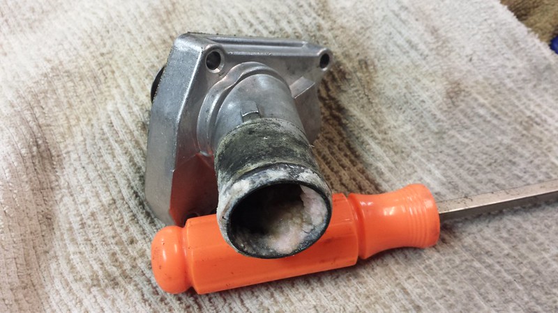

Crud! (pardon my french) Leftover Toyota Pink coolant was not my friend. Need to drop the engine to pull the water pump to see why it's not circulating. (IMG:style_emoticons/default/stirthepot.gif) (IMG:style_emoticons/default/hitfan[1].gif)
(IMG:http://www.914world.com/bbs2/uploads_offsite/live.staticflickr.com-431-1558722314.1.jpg)
Just another day....

Yeah, and that's that high-priced 'special' Toyota coolant ... what is that up to these days? ... $40./gallon? (IMG:style_emoticons/default/dry.gif)
Volkswagen is the same. I believe most import vehicles have their own proprietary fluid 'requirements' these days.

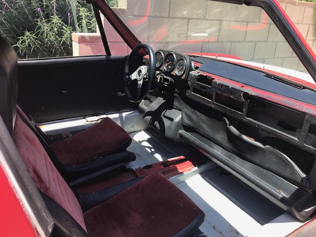

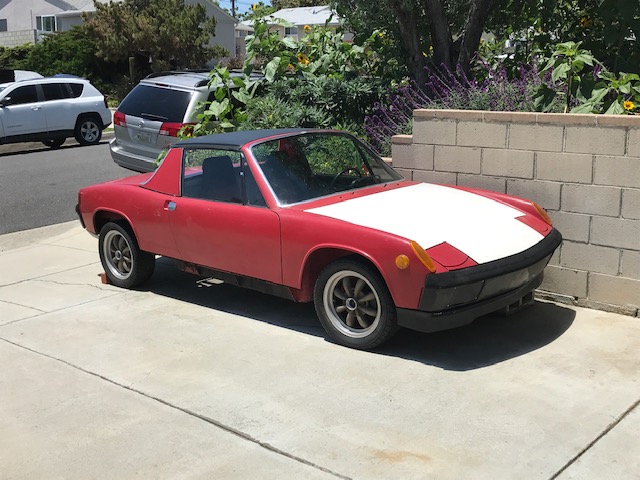

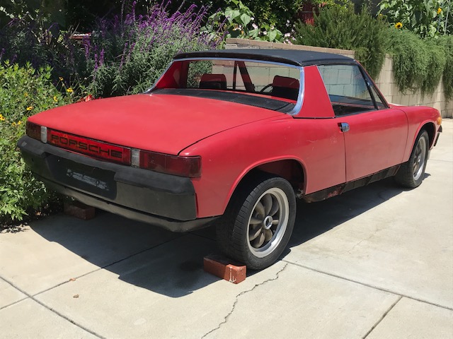

Washed my 74 project that is parked at my daughter’s place and since I helped them cleaned their driveway this morning for my 2 yr. old grandson’s bday celebration.

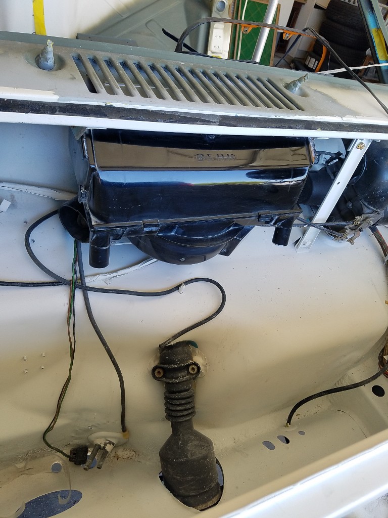

Cleaned up the plastic fresh air blower case. Did the whole 800 grit to 2000 wet sand paper thing followed by cutting compound on foam pad to finish. Attached Image

Installed 50th Anniversary carpets. Nice color match to the 75/76 Salt and Pepper weave.
