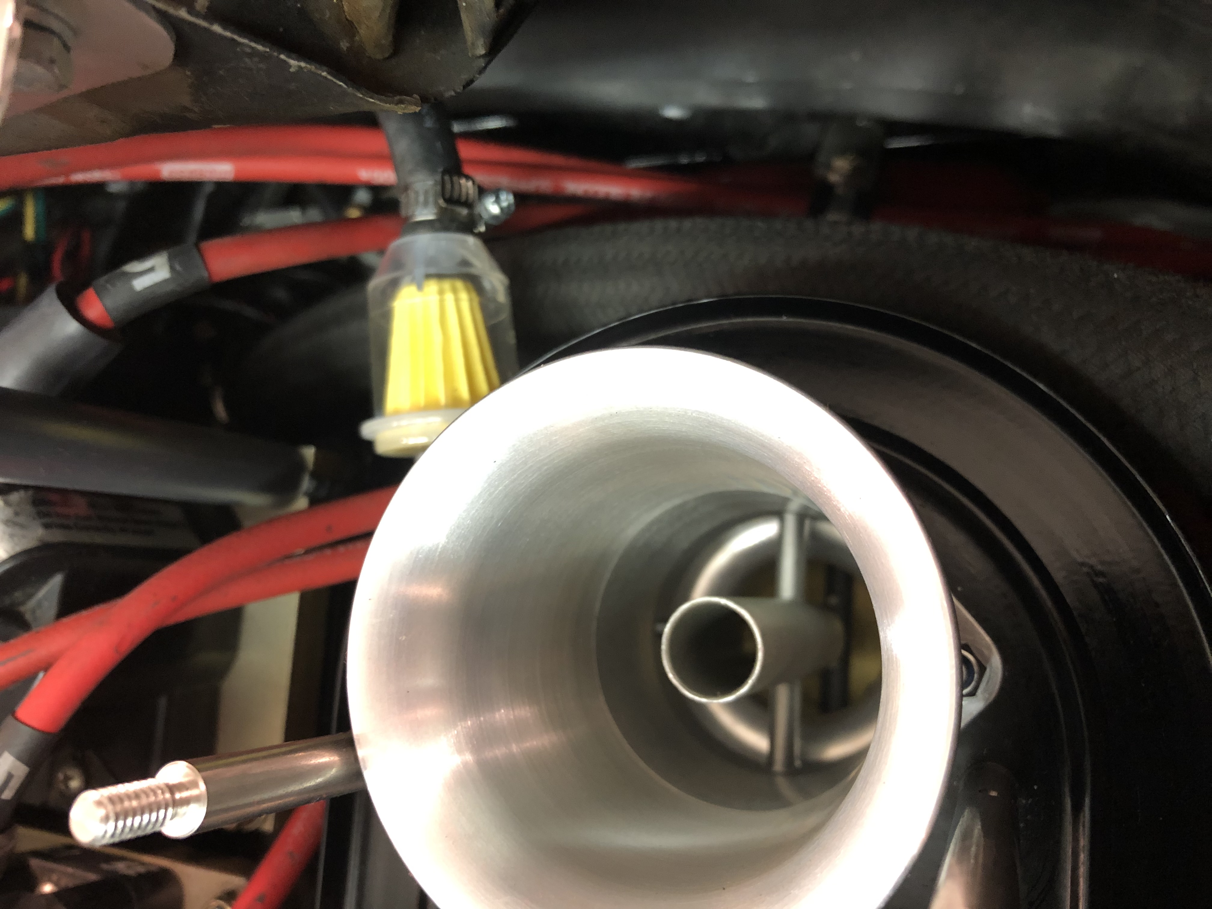

Had what may have been blockage in idle circuit of PMO’s. Cleaned out idle jets and the cards. Added two filters. Attached Image

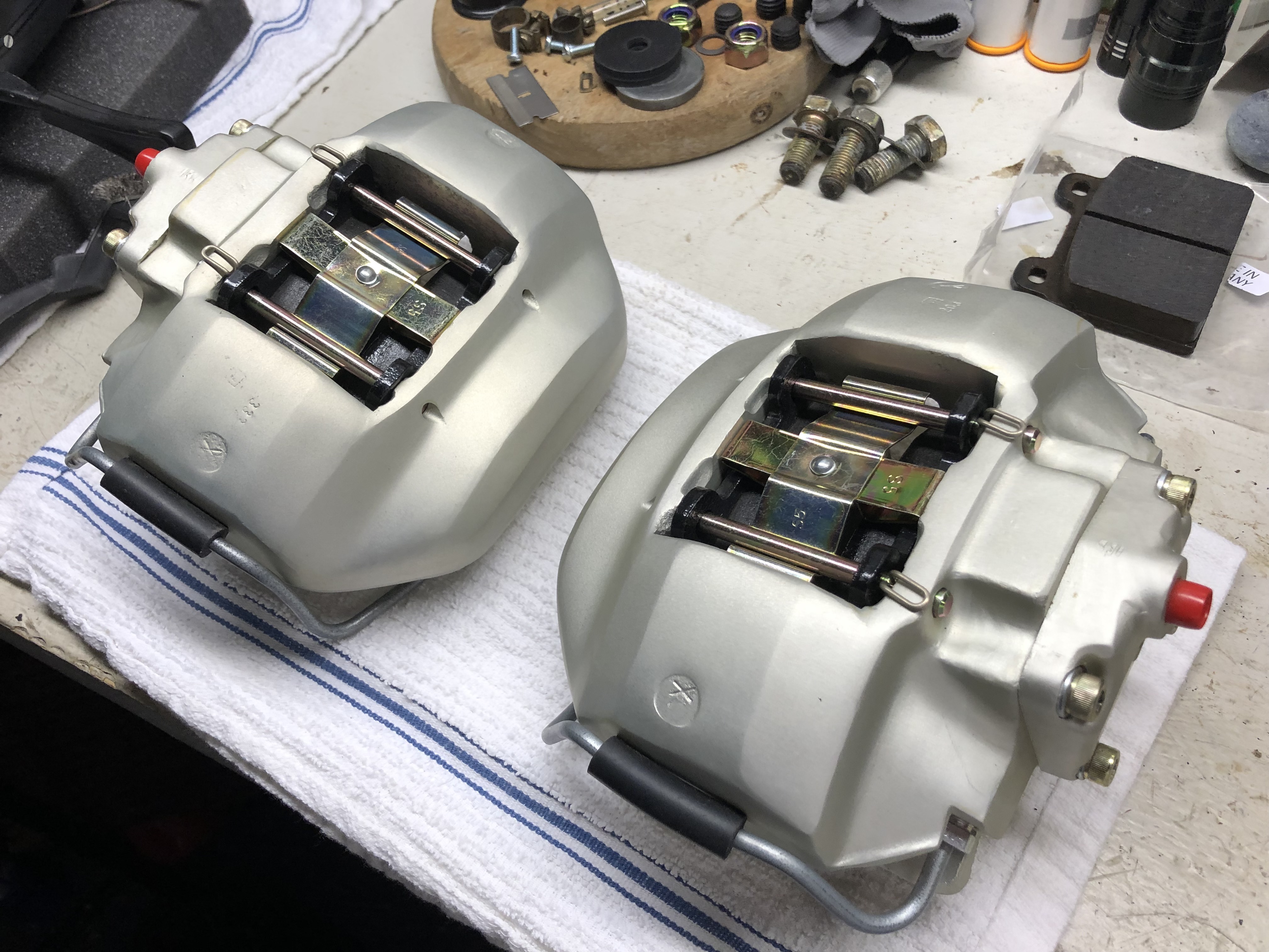

These are going on the car today:

Those look nice Lawrence. (IMG:style_emoticons/default/beerchug.gif)

PMB Rebuild?

Yes, all PMB.
I ditched the rock shields, cleaned things up a bit, re-installed the rotors and new calipers.
Then; bled, re-bled, drove, pumped the pedal, seated the pads, took the wheels back off, re-bled, and now I have a pretty decent pedal. I had a few issues.
It's amazing how friggin' heavy "A" calipers are.

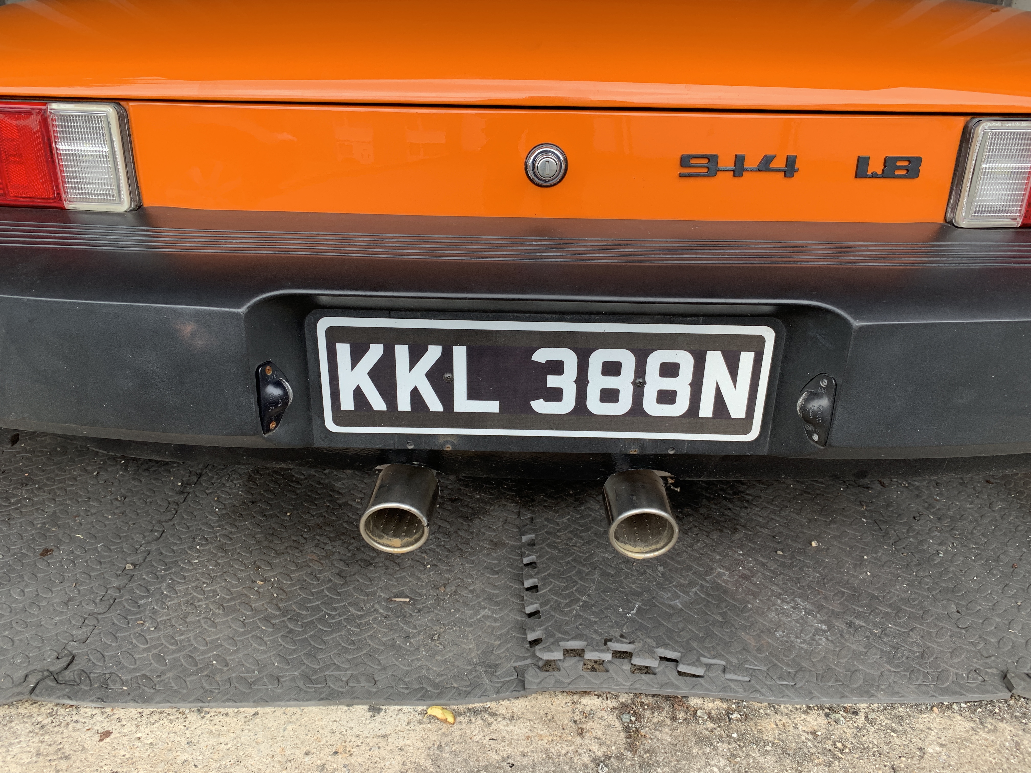

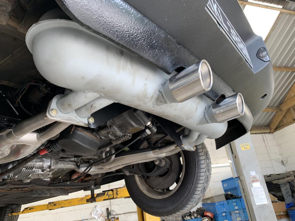

Installed SSIs and Dansk sport muffler. Great sound, pops a little on the overrun (need larger idle jets) but definitely better through mid-range and top end compared to the previous awful 2.0-litre heat exchangers and Bursch muffler.

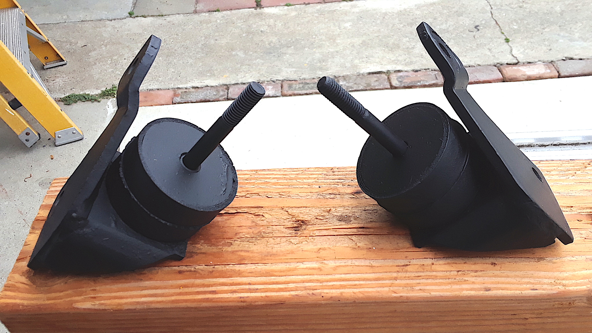

I gots me some new late style engine isolator mounts with brackets for my 71's conversion. Got them on ebay for $30. ... cleaned them up and painted them yesterday (IMG:style_emoticons/default/biggrin.gif)

KSCarrera - Love the tips with the finishers on them. (IMG:style_emoticons/default/beerchug.gif)

Those look nice Mark, I did that when I had my motor pulled to refresh and paint car last year- mad a huge difference, found mine were actually sheared in 2 and the motor was just sitting on the bar!!! (IMG:style_emoticons/default/huh.gif)
It’s a good thing to check when buying a 914, I guess it had been like that for oh probably since I bought the car! So 8 years or so??
