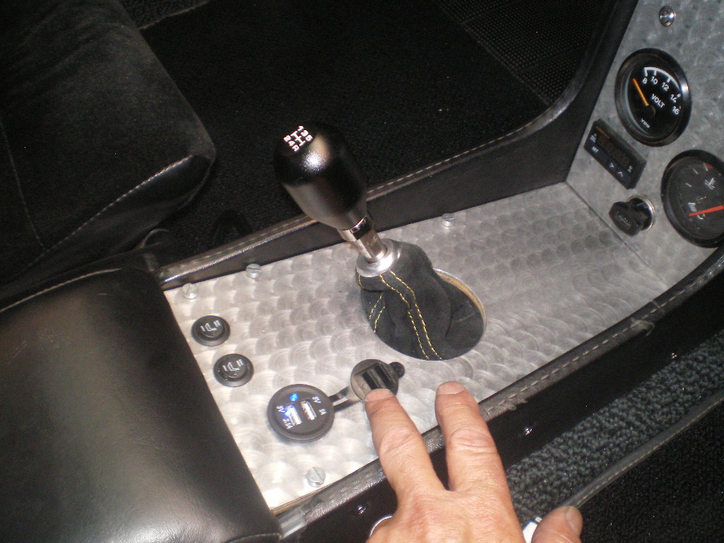

Some more of "Because I'm Bored out of my Mind" projects. Removed my old driving lights and replaced with them with a pair of Fog Light's recently refurbished. Next I refurbished my seat belt holsters with "Back to Black" and new stickers. While I was at it I installed a dual port USB outlet for my wife's iPad and iPhone. It's the black round thingy right next to the seat heater switch's. After installing it last night I lifted the cover only to find that it is lit and I had wired into a "hot" wire. (IMG:style_emoticons/default/headbang.gif) Removed the neg battery cable and returned this AM and tied into a switched hot line. It probably would have taken 60 days to drain the battery but ............

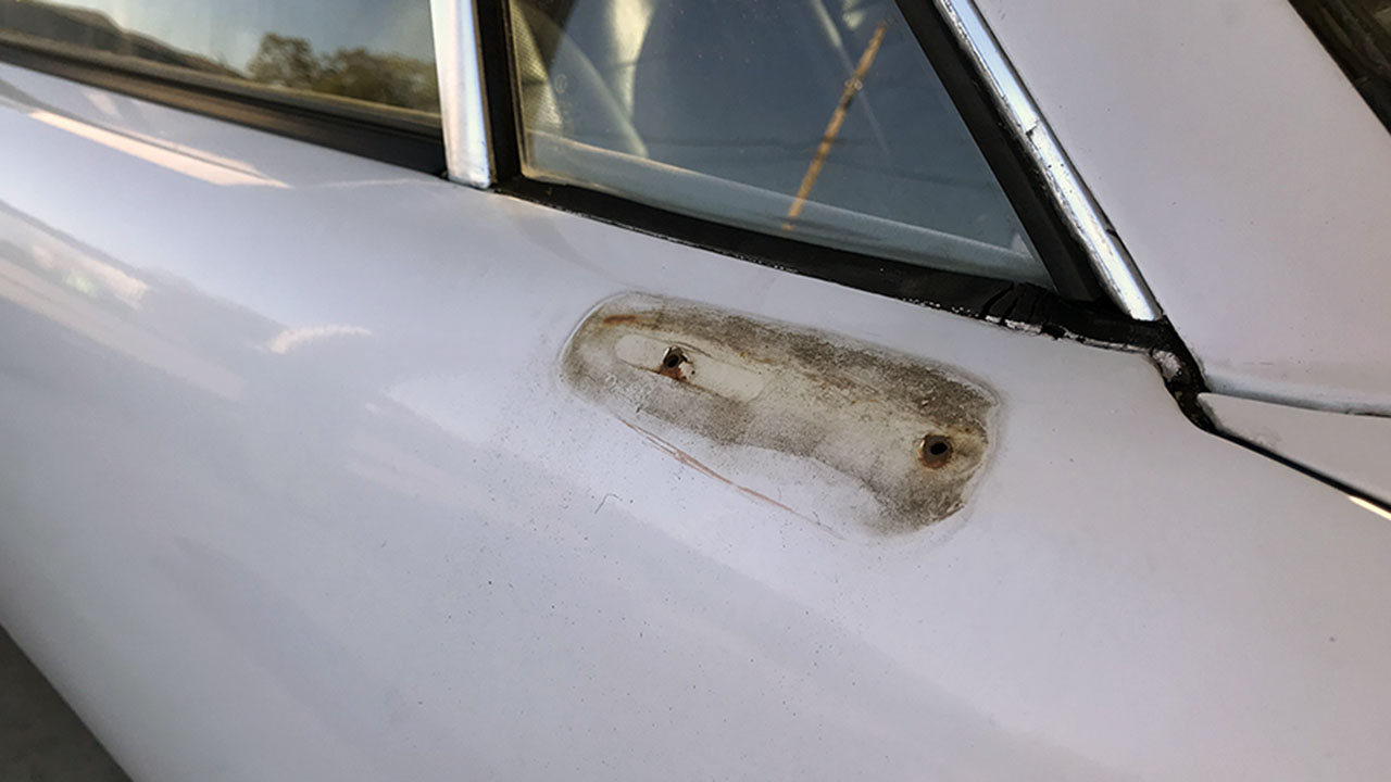

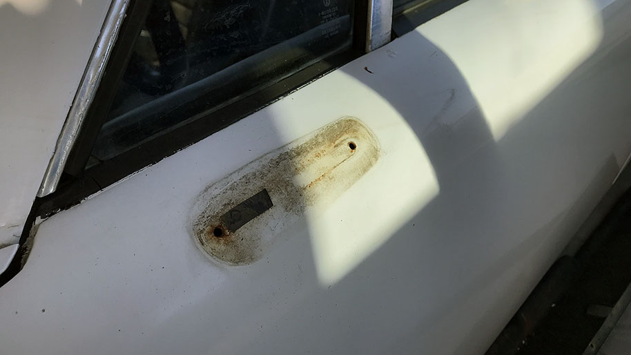

Removed the aftermarket mirrors (IMG:style_emoticons/default/blink.gif)
Will have the holes filled and install stock mirrors after I have some bodywork done.

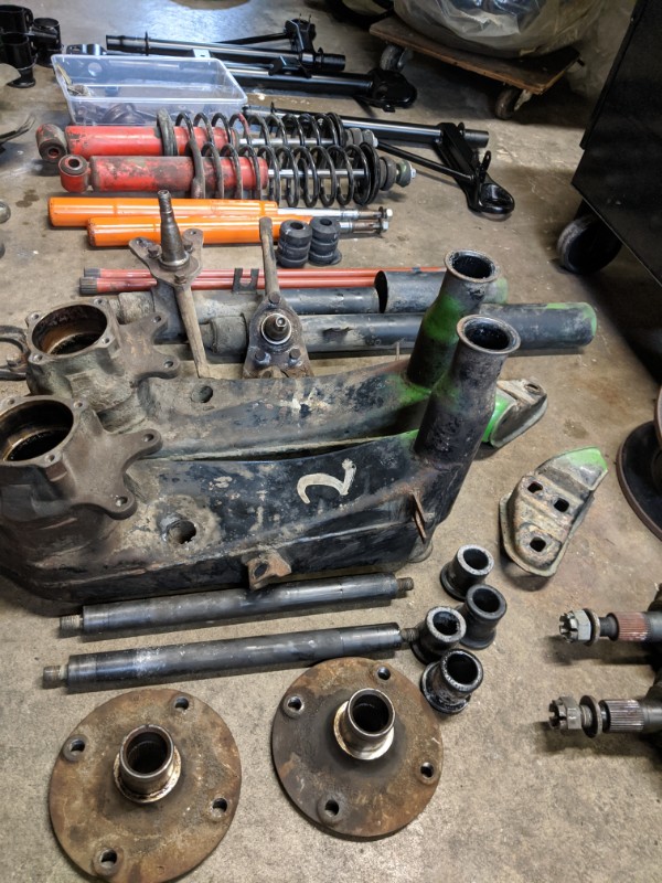

Finished breaking down the suspension today. I was dreading removing the trailing arm pivot shafts after reading about all the burnt rubber. But I was pleasantly surprised when the pivots came out easily in my press. Spent a couple hours bead blasting some of the parts (many hours left to go), some got painted, others are set aside for plating.
-Derek

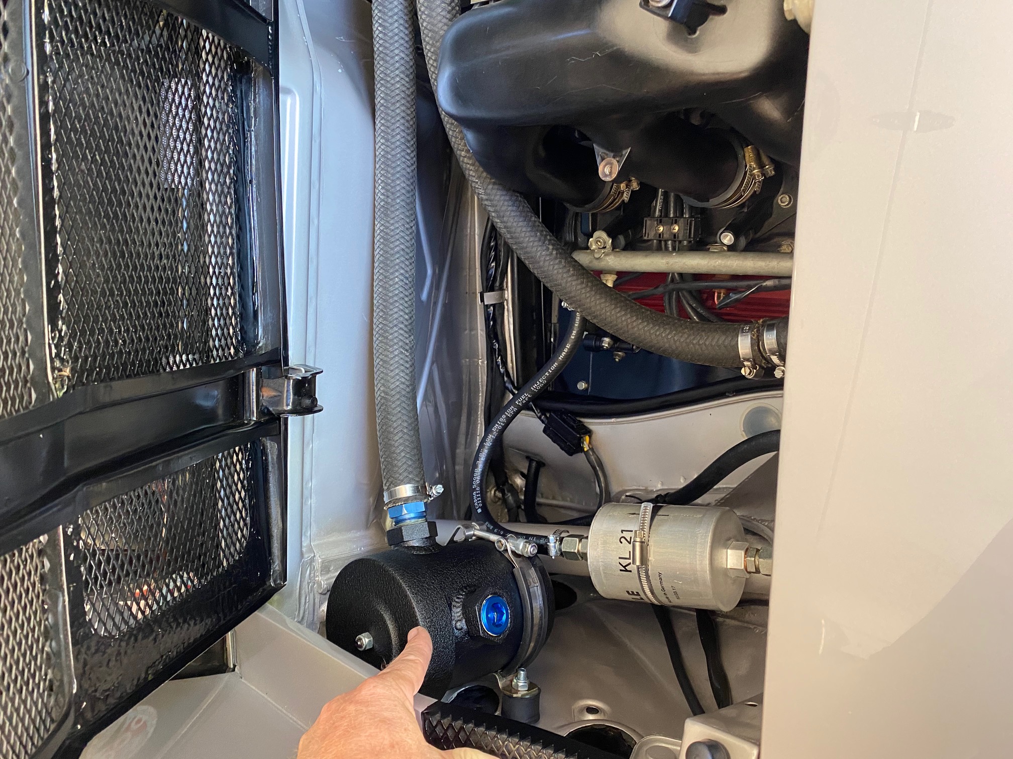

(IMG:style_emoticons/default/dry.gif) After a flatbed home after this glorious start:
I spend ~6 hours cleaning oil out of the engine bay, the puke tank in the "plumbing" decided to spit maybe ~2 quarts out into the left side of the engine, spilling down thru the DS helll hole and onto the headers. Very strange, after clean up, engine starts runs makes good pressure and I can't find any leaks or anything out of the ordinary. $hit day though when I thought I was going on a nice morning run with the fellow 914world group
Oil appear to have poured out of this breather:

Sorry that happened Eric. What is the oil capacity of that system? Is it possible it was overfilled? It sure cleaned up nicely. Of course I am sure it was spotless to start with too. (IMG:style_emoticons/default/beerchug.gif)

Engine oil level to full? Happened to me before..

It has the oil "keg" in the frunk--hold something crazy like 12 quarts +
This car was a concours queen for a while so it was CW clean everywhere and when I got a hold of it, it only took a weekend to get it back to white glove status.
QUOTE(mb911 @ May 3 2020, 06:40 AM) *
That's the going theory--I hadn't added any oil but the previous caretaker may have. PMS suggested that since it was the first real run in the past ~6yrs for the car that there may have been oil that settled in one of the breather lines or whatever and my "spirited" drive to get up to OC may have finally brought things to the perfect storm where it tried to expand and resulted in the mess.
My shoulder blades hurt today from rolling around underneath it yesterday mopping all the oil off.
I've started it up several times and it's making good oil pressure, checked the 'keg' with an improvised dip stick (welding rod) and oil level seems good. Once the oil was mopped off the underside and headers I can't find anything leaking anywhere (IMG:style_emoticons/default/confused24.gif)
Going to take Oscar up on his generous offer of borrowing his trailer and take it out to Patrick Motorsports this week for a sanity check before running it again. I'm very apprehensive to just drive it with the 3.8 motor because if there is something at play I can't afford a catastrophic event on that motor, literally, its above my pay grade (IMG:style_emoticons/default/blink.gif)
