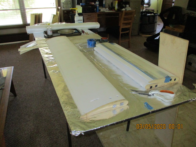

Got what I wanted on the trailing edge of the rear wing this evening. Making up the edge sure made it come out clean.

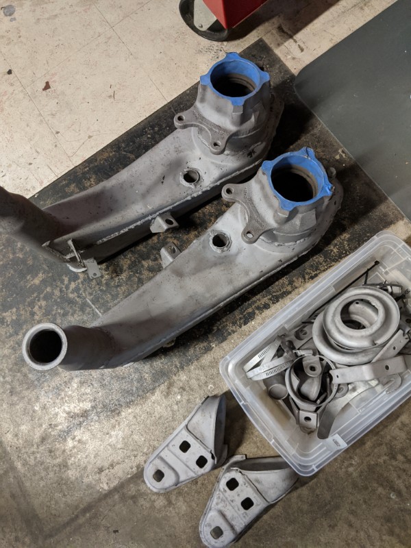

2.5 hours running a blast cabinet. Oiled the parts that are being set aside for plating, then painted the trailing arms and pivot brackets.

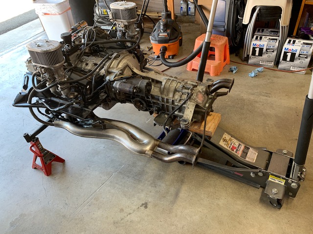

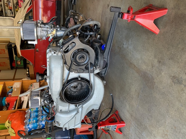

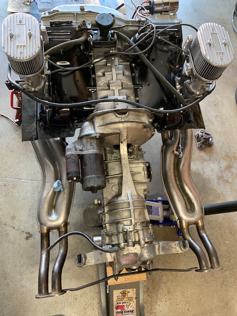

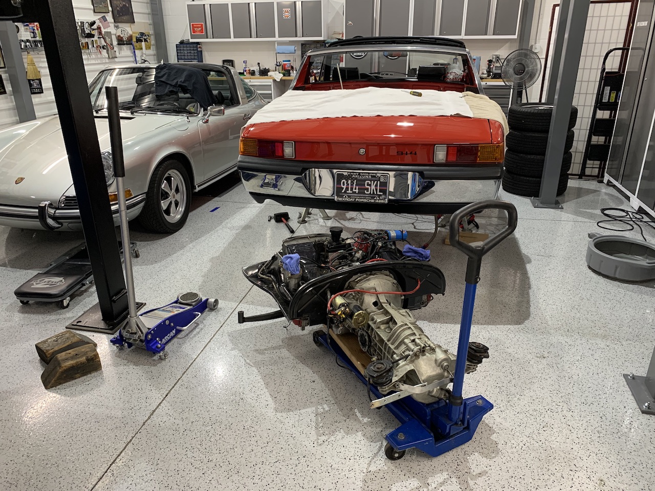

Another Porsche friend helped me drop the engine on the '73.
A birthday present to myself- I guess all the Mexicans celebrate my birthday for some reason...Attached Image

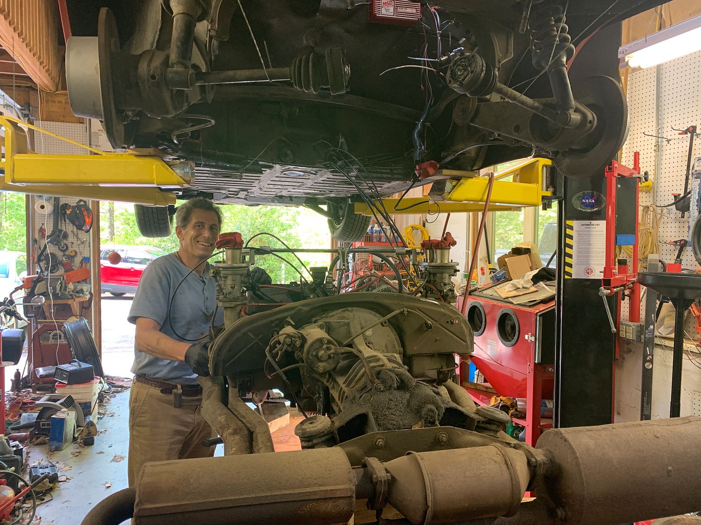

SKL1 and I have similar timing - but his engine looks new (so I wonder why he dropped it), but mine clearly hasn't been dropped ever and has 44 years of dirt, grease & junk covering it.
Dropped it today with the great help of Rickb45 who is my close-by resident friend who is an 914 expert on so many things. Few hangups on right carb where fuel line attaches and a couple other glitches, but overall went well.
With car on my 10k lb. lift, we dropped engine onto 4x12's on a motorcycle lift table which gives me multiple great heights to work on engine.
Long list of TTD's (Things to Do): new alternator (harness looks great, like rest of car - as you'd expect for a car with only 60k miles ), install cooling vanes a former PO had removed, install new T'stat from AwesomePowderCoating, remove, clean & repaint tins, completely & thoroughly clean both engine & transmission, clean & repaint engine bay - and whatever else shows up as needing to be done.
Here's a pic of Rick at the end of the job - a huge public thanks for all the help!
PS: note how clean and rust free the pan is...incredible......as Rick keeps telling me, this is a gem of a car in amazing condition in every way......

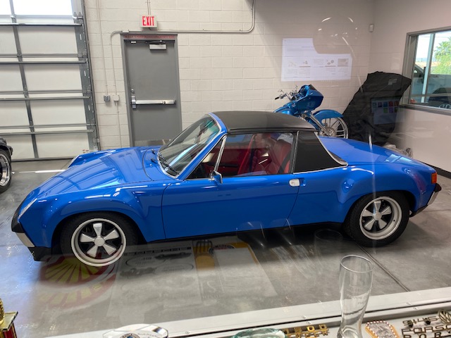

I was able to borrow his trailer to take my 6 from San Diego to Phoenix to Patrick Motorsports to investigate the oil issue I had heading to the SoCal drive last weekend.
1st time I'd ever been there, they built the car originally and my gamble was that since they built it, they'd be able to spot any DAPO issues immediately and resolve them... That happened within 15 minutes of them looking at the car. Root cause of the oil puking event was that DAPO (brother of the original owner, who didn't "know" the car) had oil changed to Brad Penn, not an oil you should be using in a 3.6 motor that wants full synthetic.
Good news for me, easy fix, also got to inspect the other filters and everything was really clean and no special suprises like engine glitter (thank god!)

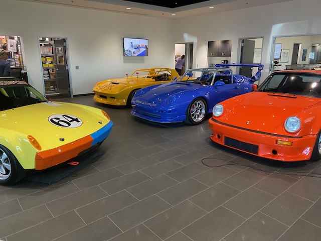

Wow do they have some amazing stuff there, I held back from taking a bunch of pictures to be respectful of the owner and the customer's but did grab a few Attached Image
The owner is a super nice guy and you can tell he has a serious passion for what he does (IMG:style_emoticons/default/first.gif)

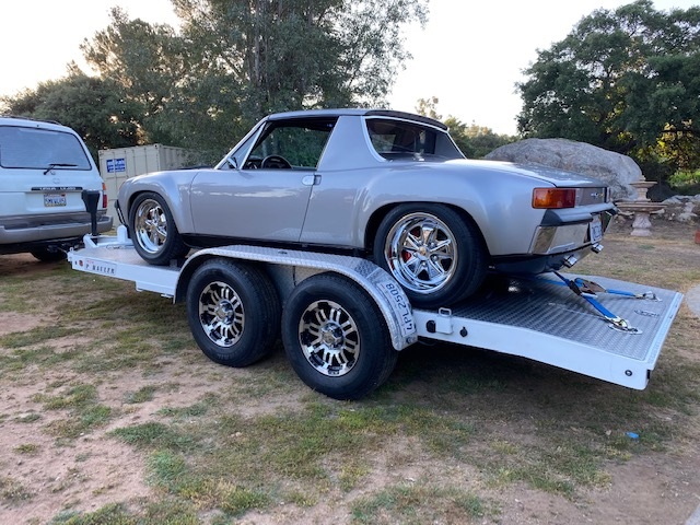

Glad all worked out using my P Hauler.
You car looks stunning on it.

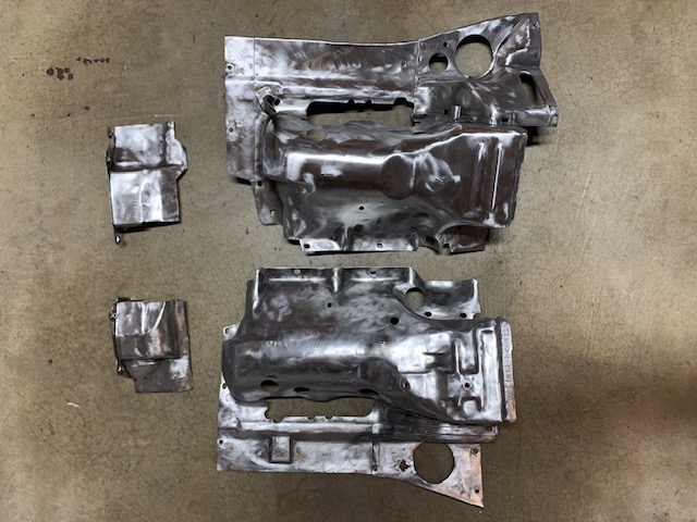

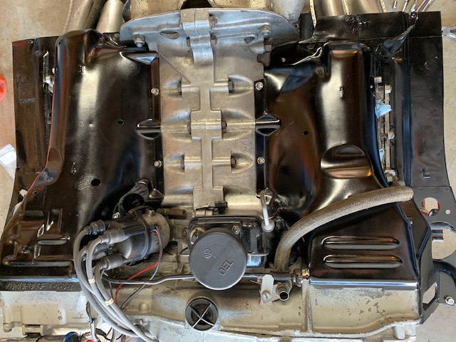

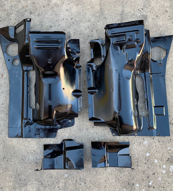

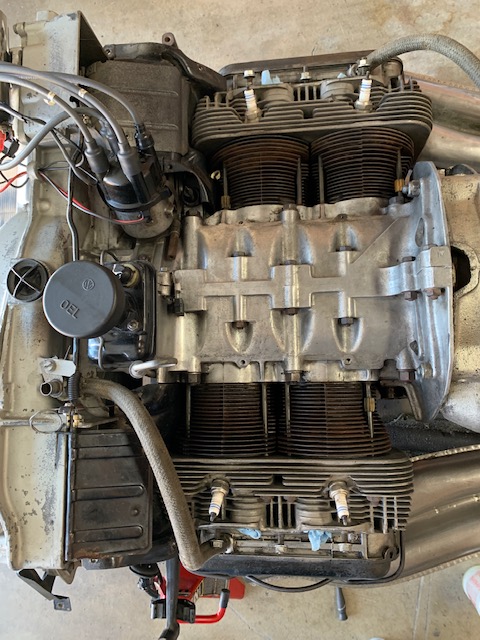

Pulled the carbs, intake manifolds and tins off the engine & started cleaning it up. Want to paint the tins before putting them on. Put in cooling vanes PO had removed - actually the flap over the cooler was in, but left to flap freely so that some air was flowing over the cooler, the air pressure was probably lifting it some so oil cooler was probably only getting a fraction of the air it should have. Have new T'stat ready to go in after cleaning engine.

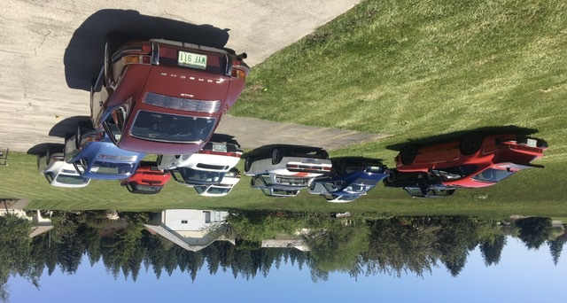

Drove it to a field with a bunch of old beaters who drive way too fast. All have very sticky tires.
Three 6s, two GT style and my skinny. Attached Image Attached Image

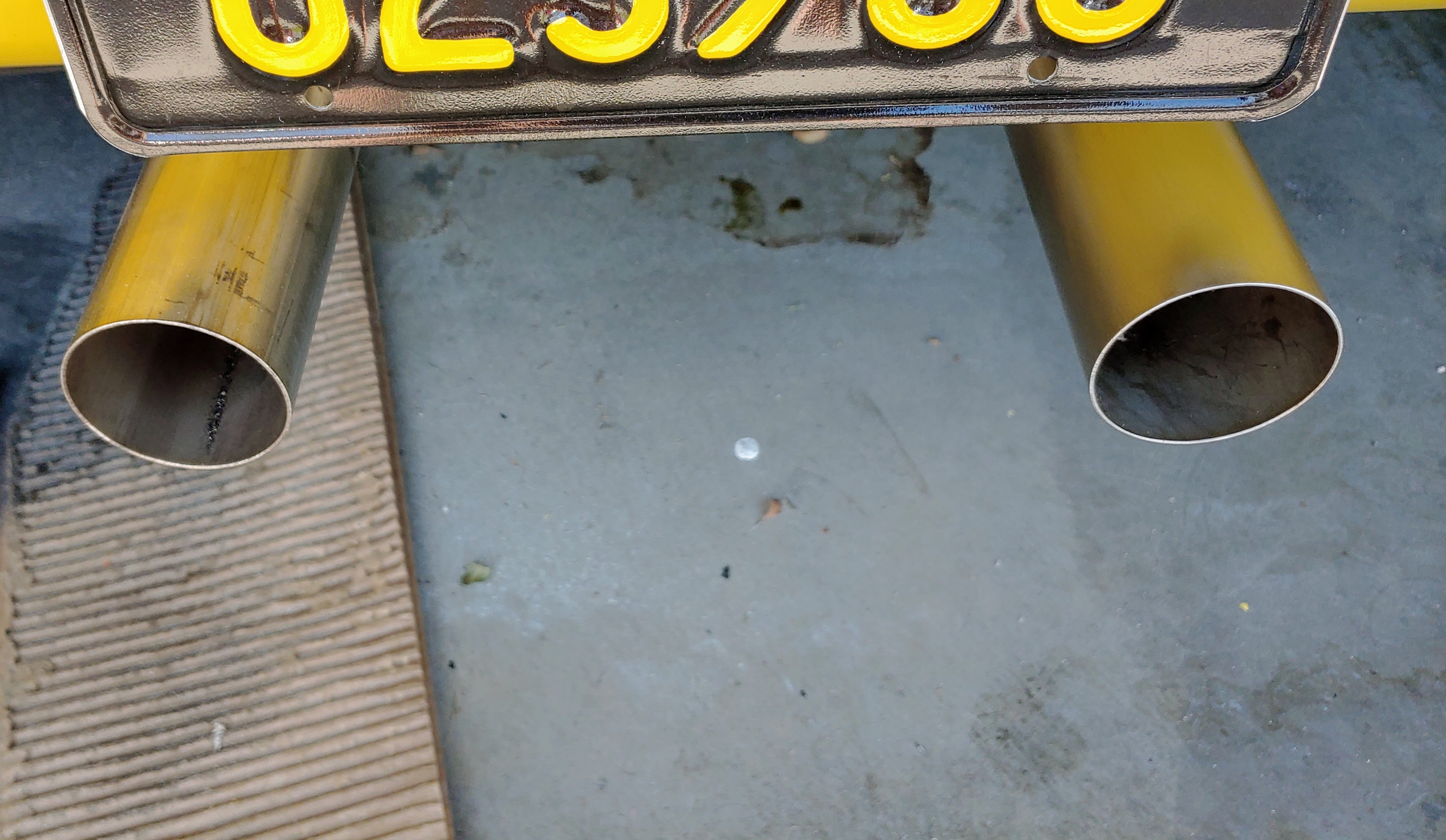

Sanded down the exhaust pipes today to even out the finish. Left is before and right is after.Attached Image

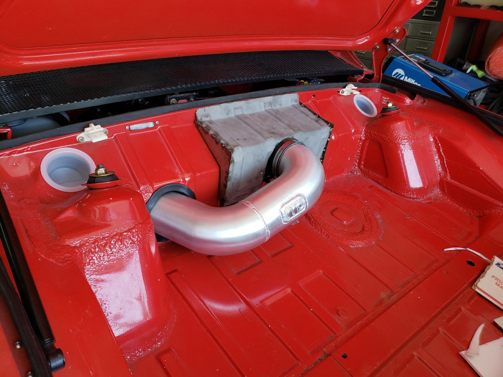

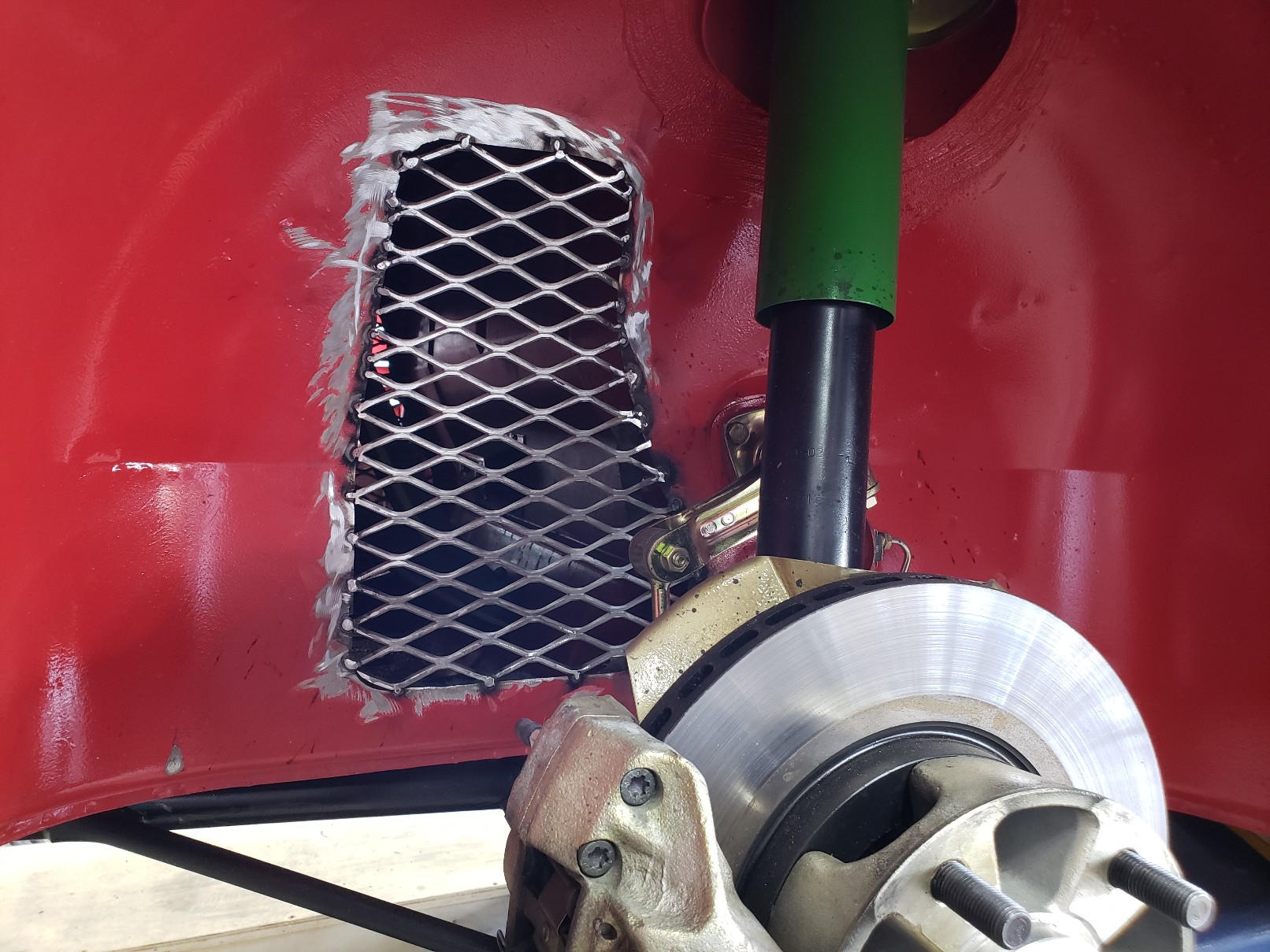

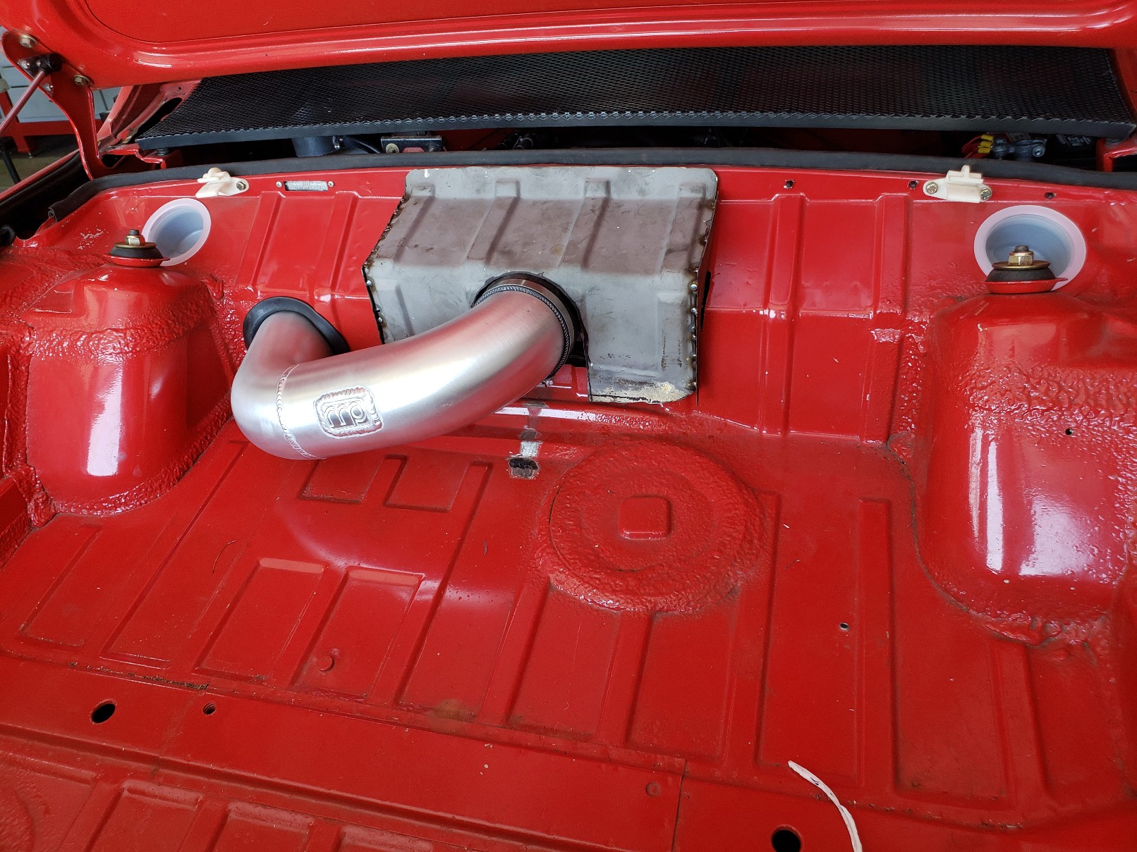

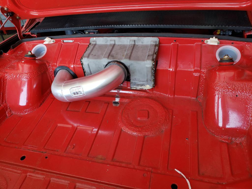

Thank you to Rich @914werke who came through again by sending me some sheetmetal so I can fabricate throttle body cover for my V8 car. A few more hours of trimming and painting left...here it is mocked up. Also added expanded sheet metal to fender vents...paint later.

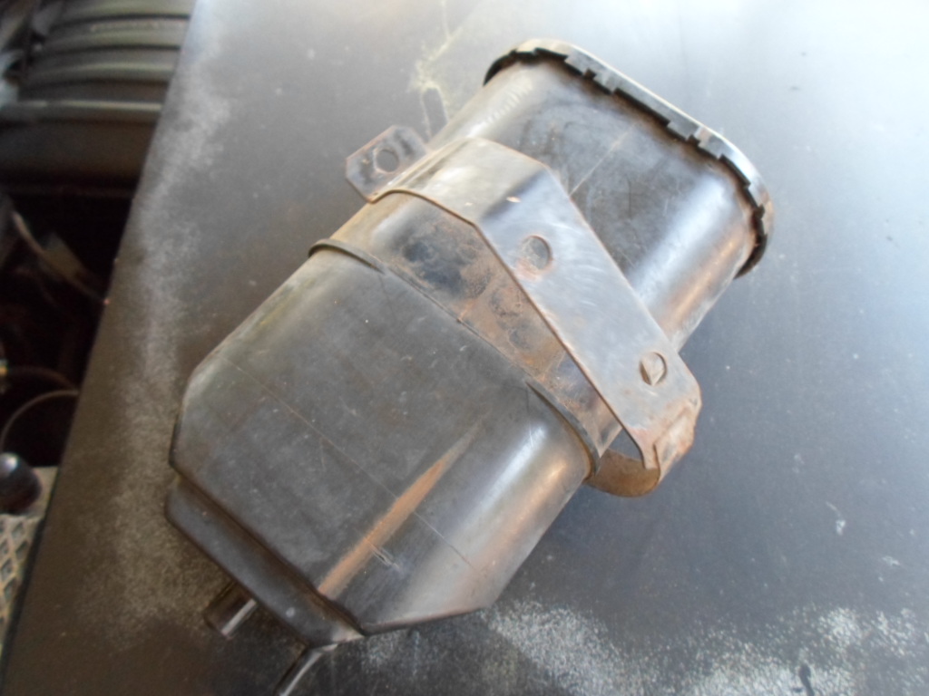

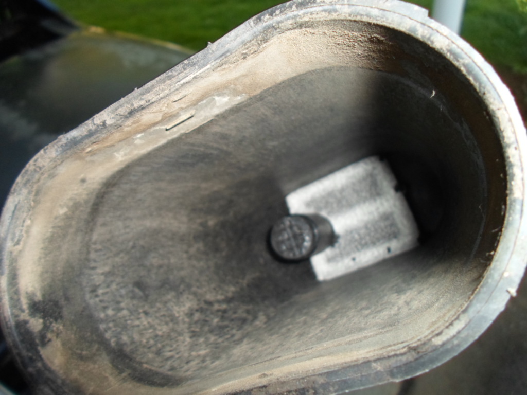

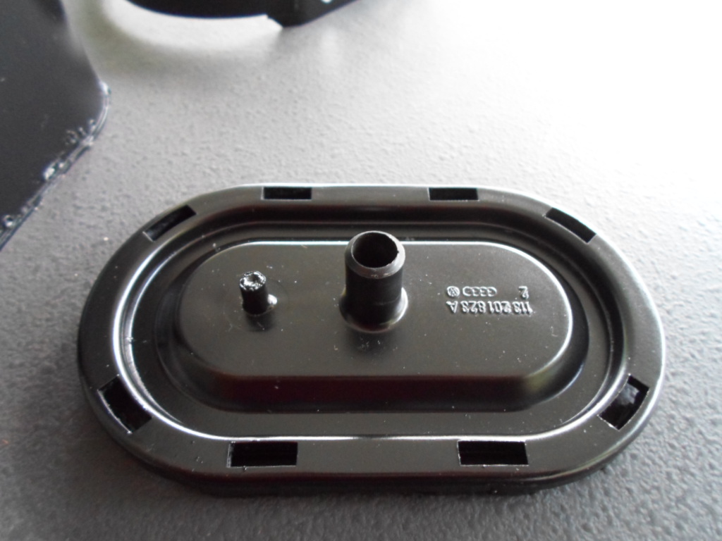

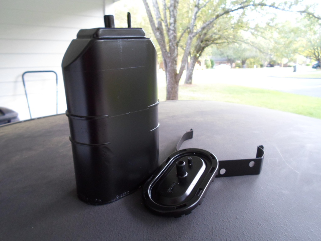

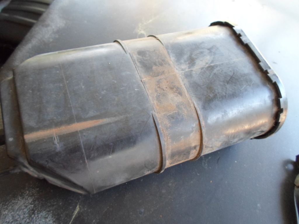

Since all the cool kids are doing it, and I'm cleaning up the engine bay anyway, it seemed like it was time to freshen up the charcoal canister a bit. I'll add the new charcoal tomorrow and reinstall. Thanks for the tips Ian!
