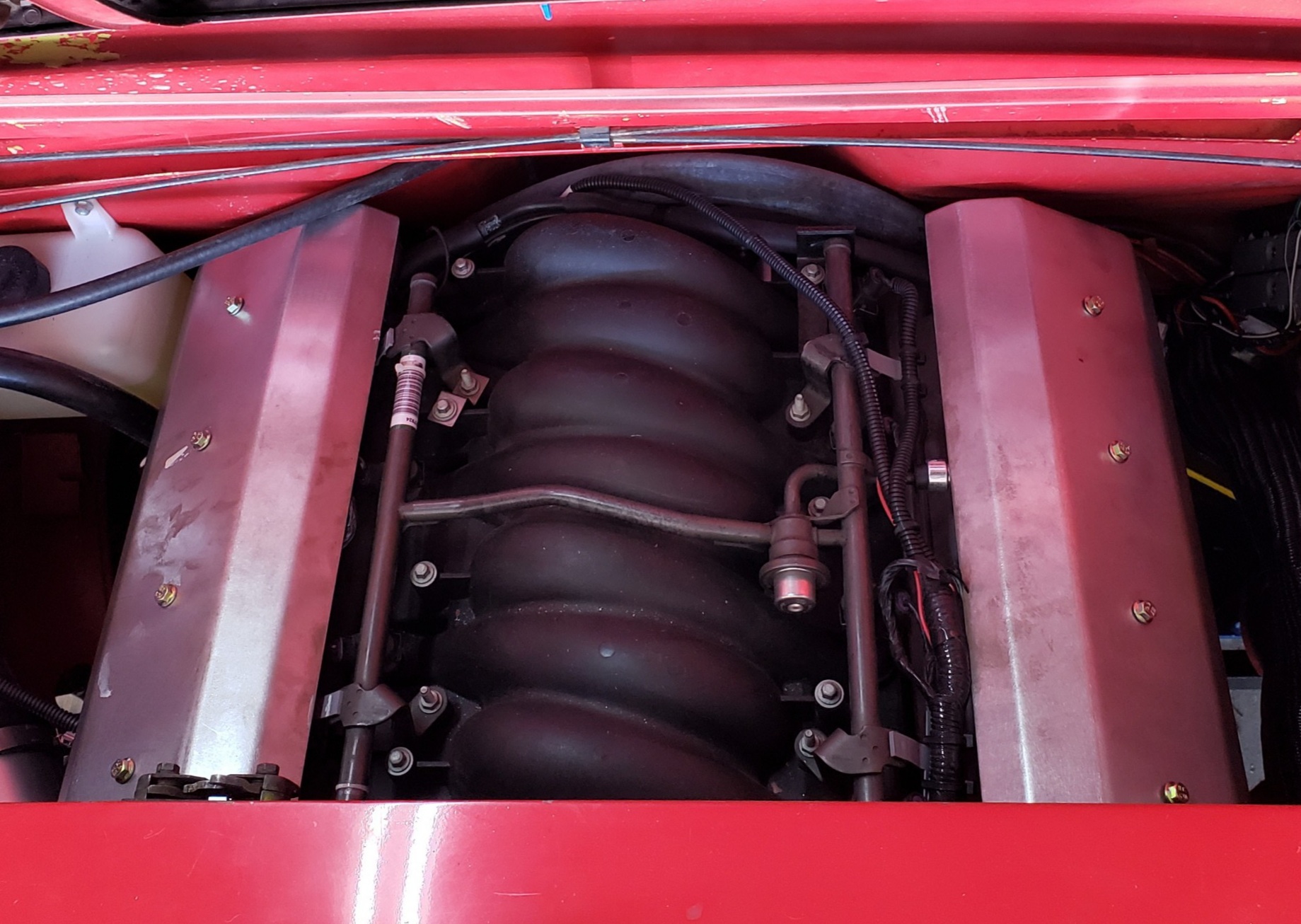

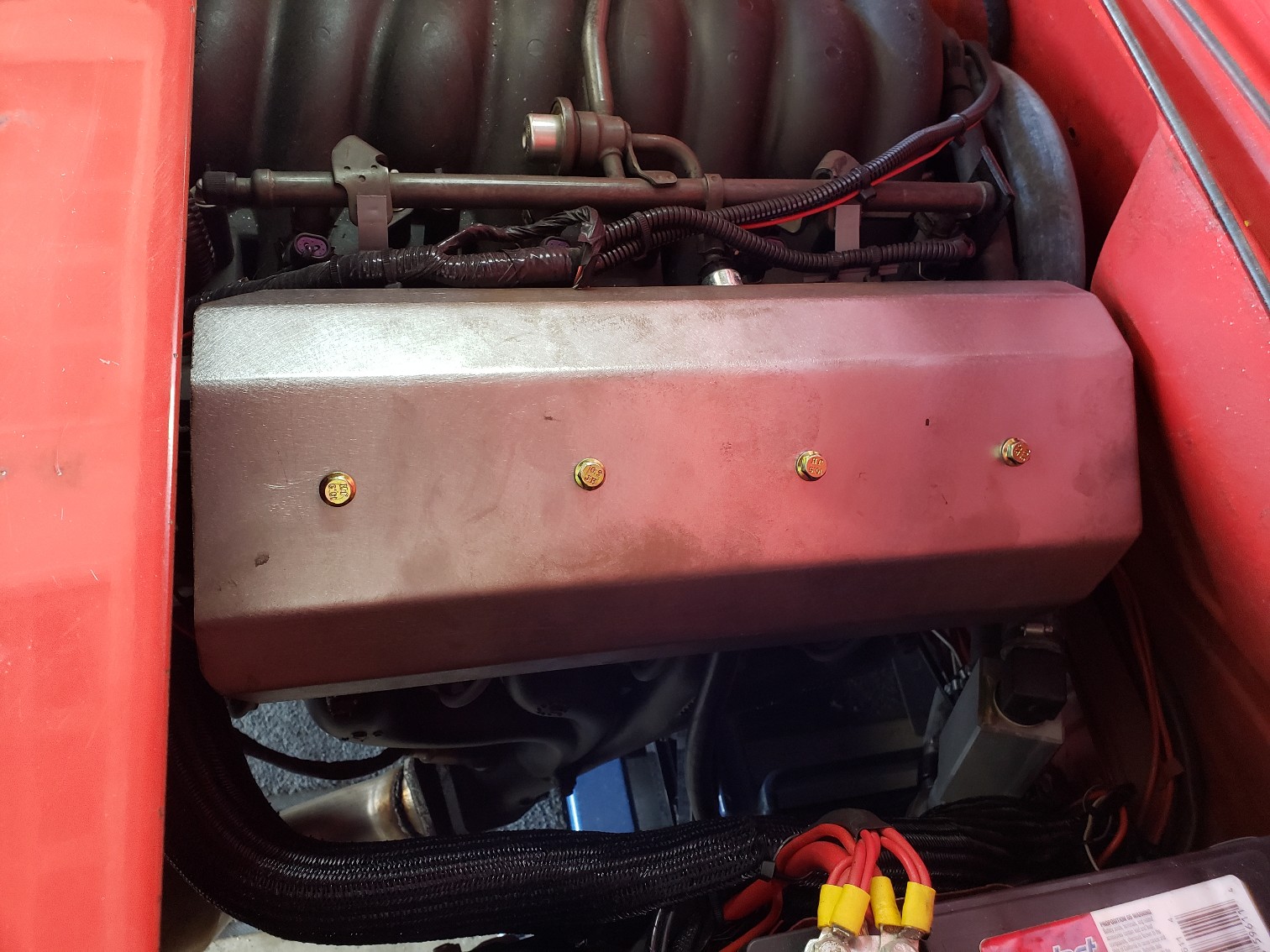

A little more massaging of intake cover I started this weekend.
Not a fan of excess wiring or exposed trunk cut outs that are typical with subaru or V8 engine conversions...
Oscar
Did you test to see if the top will still fit in there? From the pictures, it doesn't look like it will.
Clay
______________________________
Yes Clay..I did, photos are deceiving. About 1/2 clearance.
Installing with four 6mm rivnuts. using flathead 6mm thumb screws for easy removal.
placing 2mm rubber strip on back of cover to eliminate scratches or rattles.
Hope to paint cover soon.
Oscar

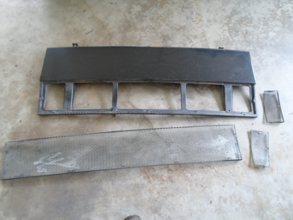

Started and/or finished a few small projects...

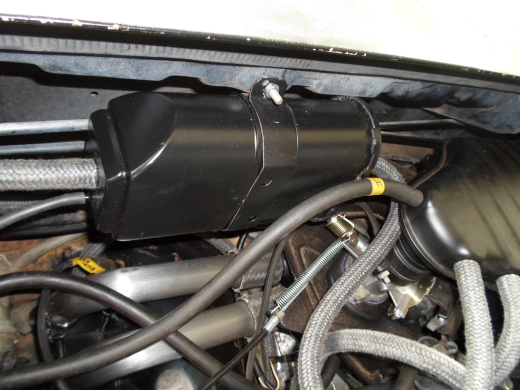

Installed BD Stone's Heater J Tube block off plates...unfortunately I ordered the nice black powder coated ones, when I should have ordered the half painted, patina-laiden ones to match my tins.
Reinstalled the freshened up charcoal canister...

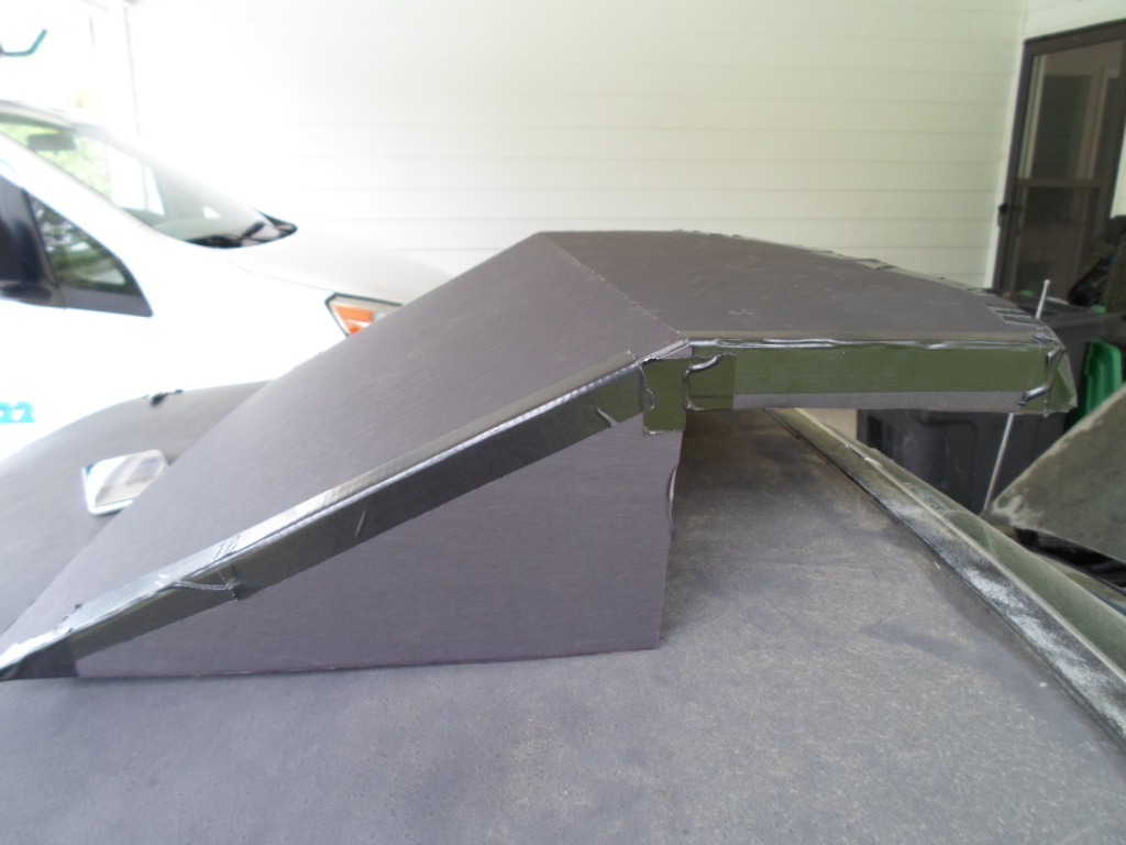

Started making an inexpensive GT-type front oil cooler shroud mold, that will ultimately be fiberglassed if all goes well...
Took apart the engine lid, and started sanding the grill parts....

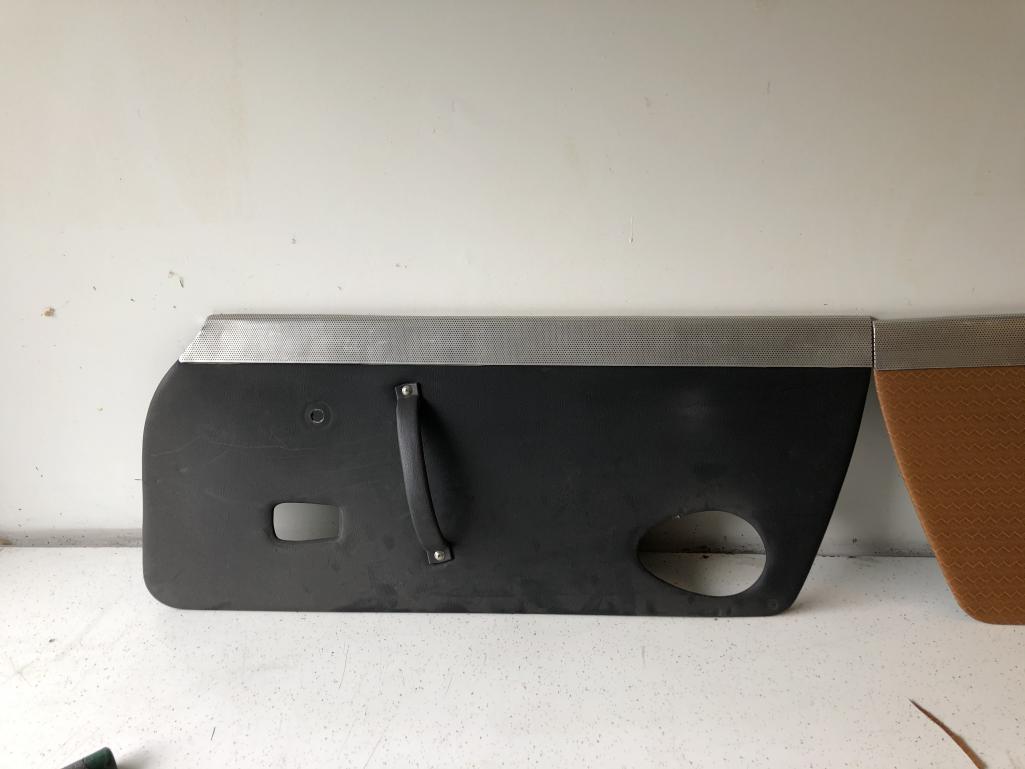

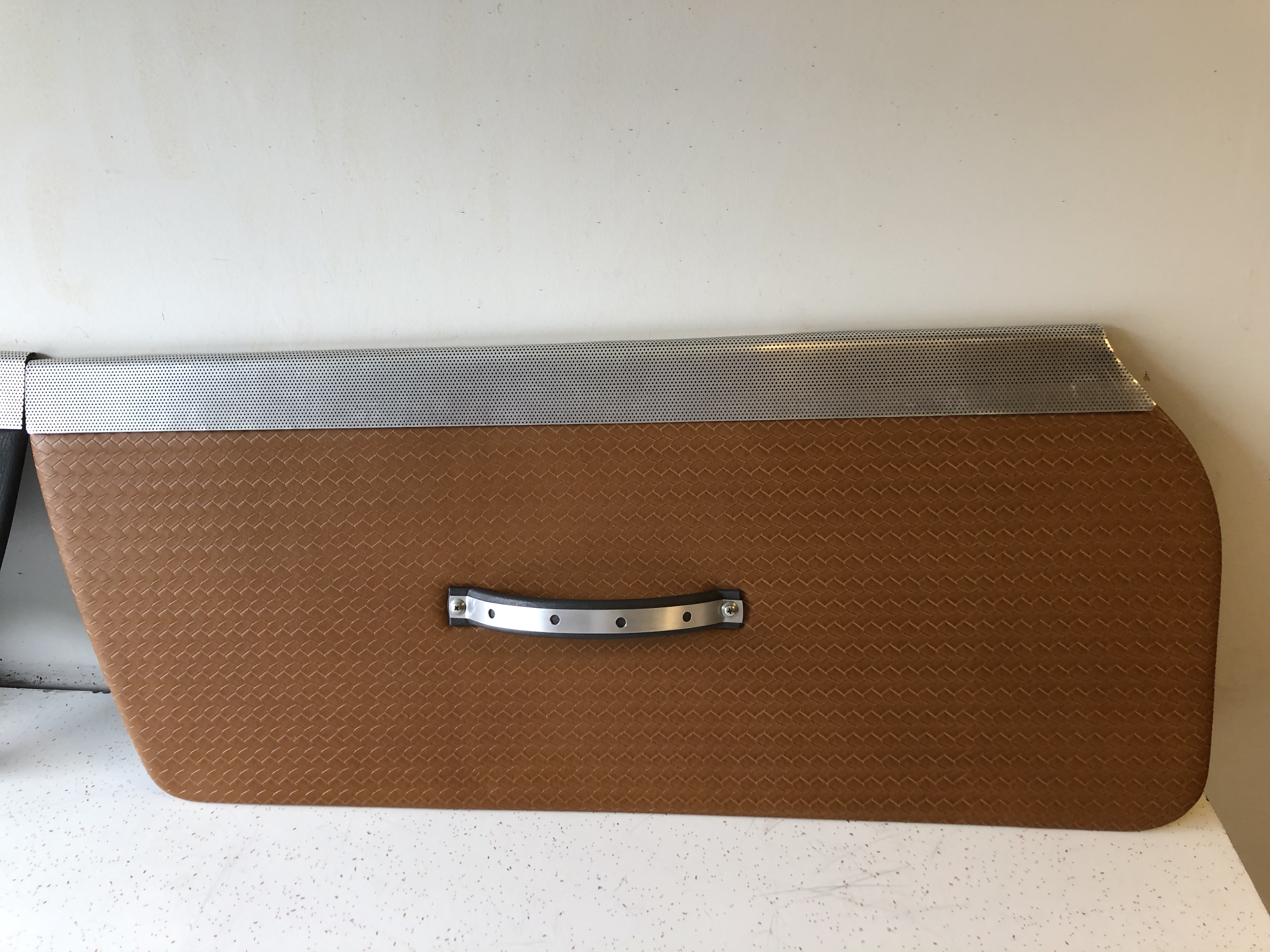

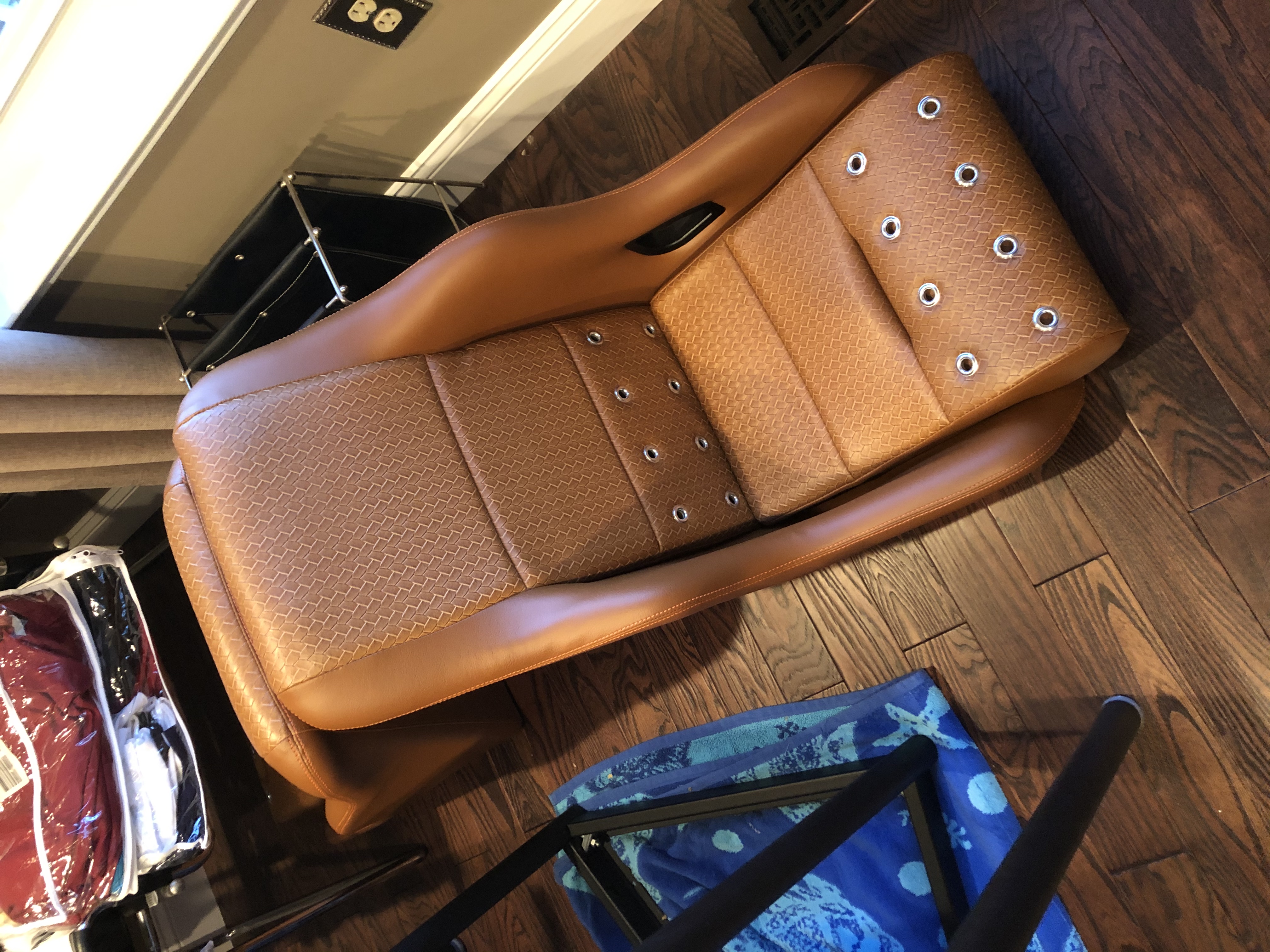

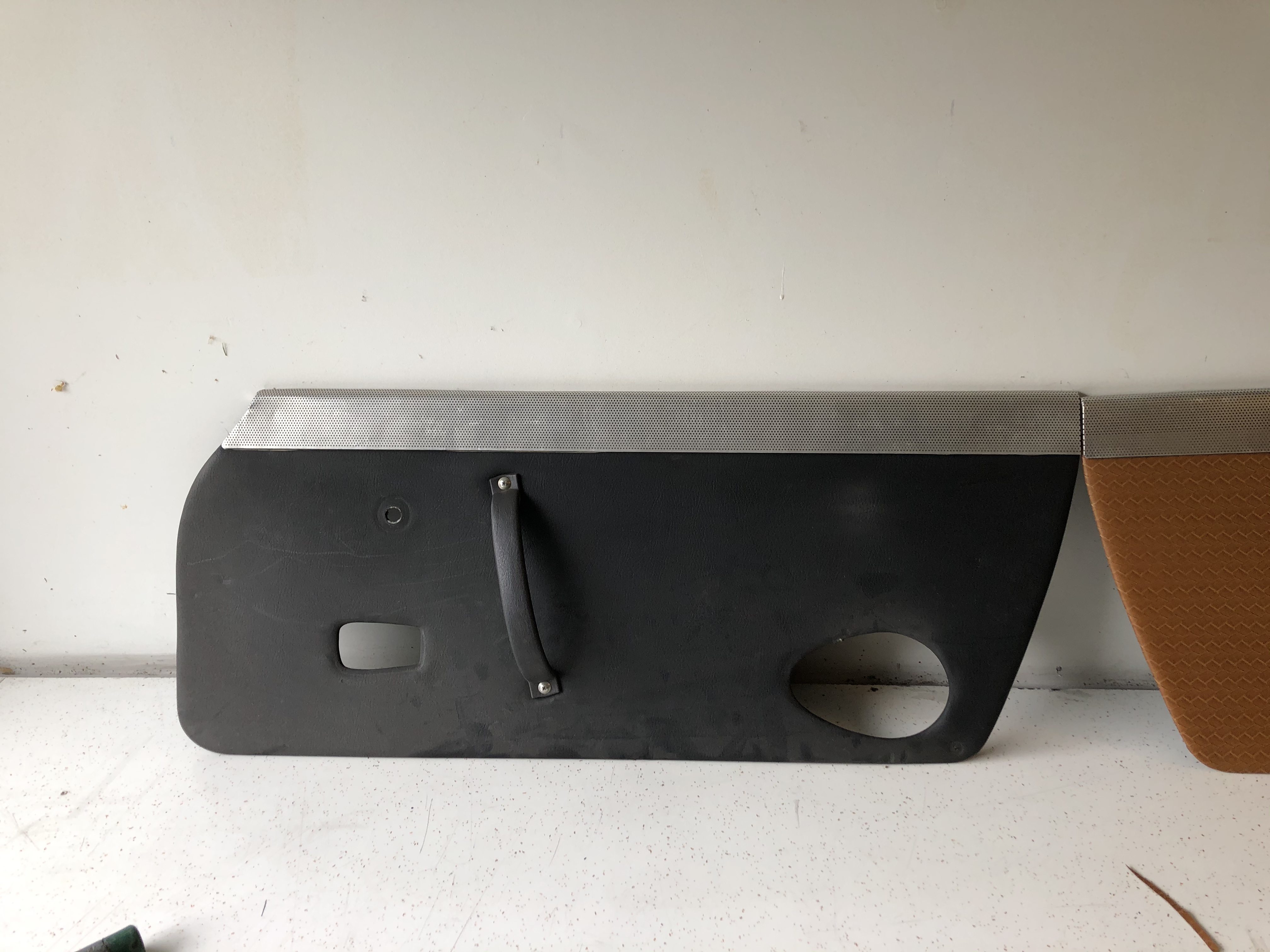

New door panels Vs old ones to match reupholstered seats

very nice seat

QUOTE(cali914 @ May 14 2020, 09:10 PM) *
very nice seat
+1

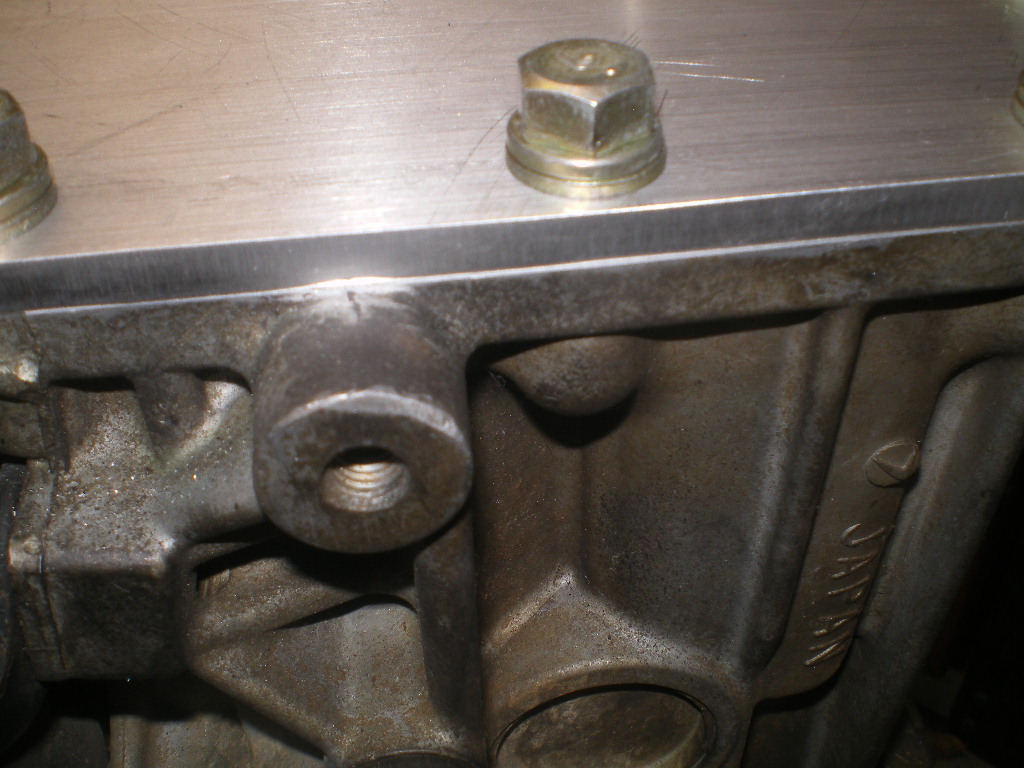

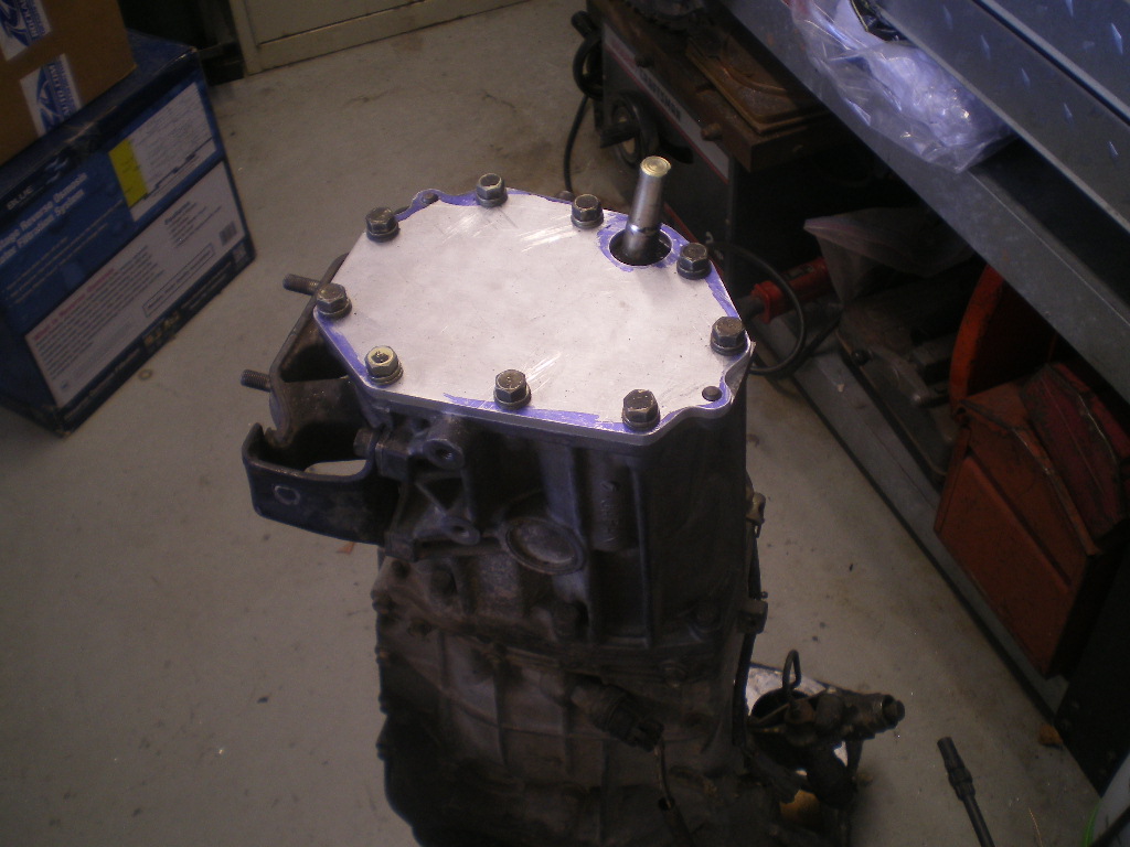

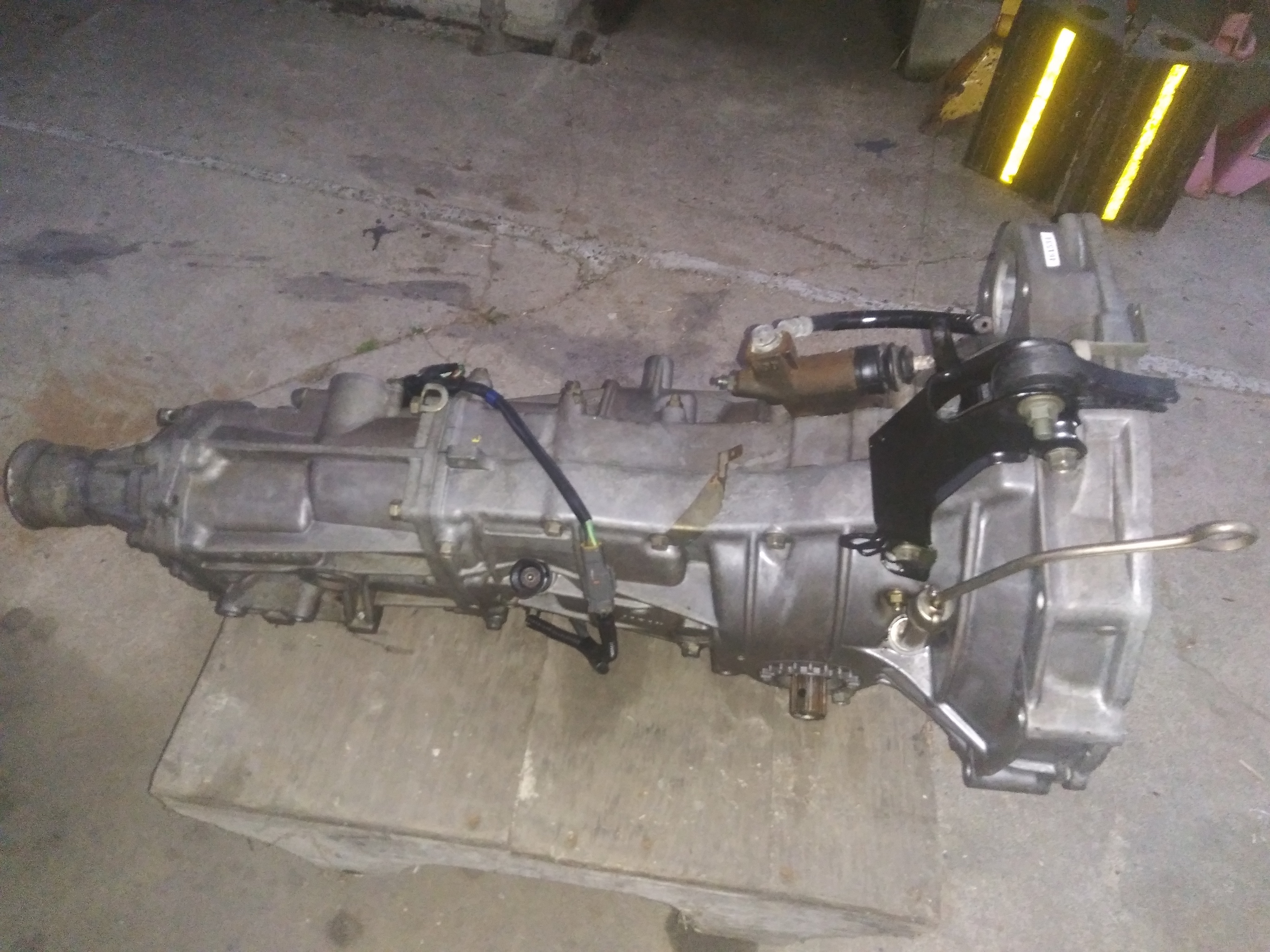

Just arrived today. I think i am going to try and make the 2wd locking nut and backplate myself. I have so much time on my hands might as well go for it. Any extra tips that are not on the great instructions that are already on the forum would be helpful. Attached Image

QUOTE(cali914 @ May 14 2020, 09:32 PM) *
If your output flanges align with your wheel centers you can keep that dipstick by straightening it and drilling a ~3/4" hole in the trunk floor, Throw away the brace unless you intend to hook it to a sky hook. The tubing on the slave cylinder can be straightened and re-bent to suit your needs. Use the tube that carried the old clutch cable as conduit for your AN-3 hose. It will keep it from sagging and trapping air bubbles. Did you buy that Forester trans? Just finished converting mine to 2 wheel drive yesterday.
Nice and clean. I'll wait 'till I test drive your car before I buy a similar transmission. (IMG:style_emoticons/default/smile.gif)
Do you have a set of transfer punches to get that bolt pattern for the new plate?

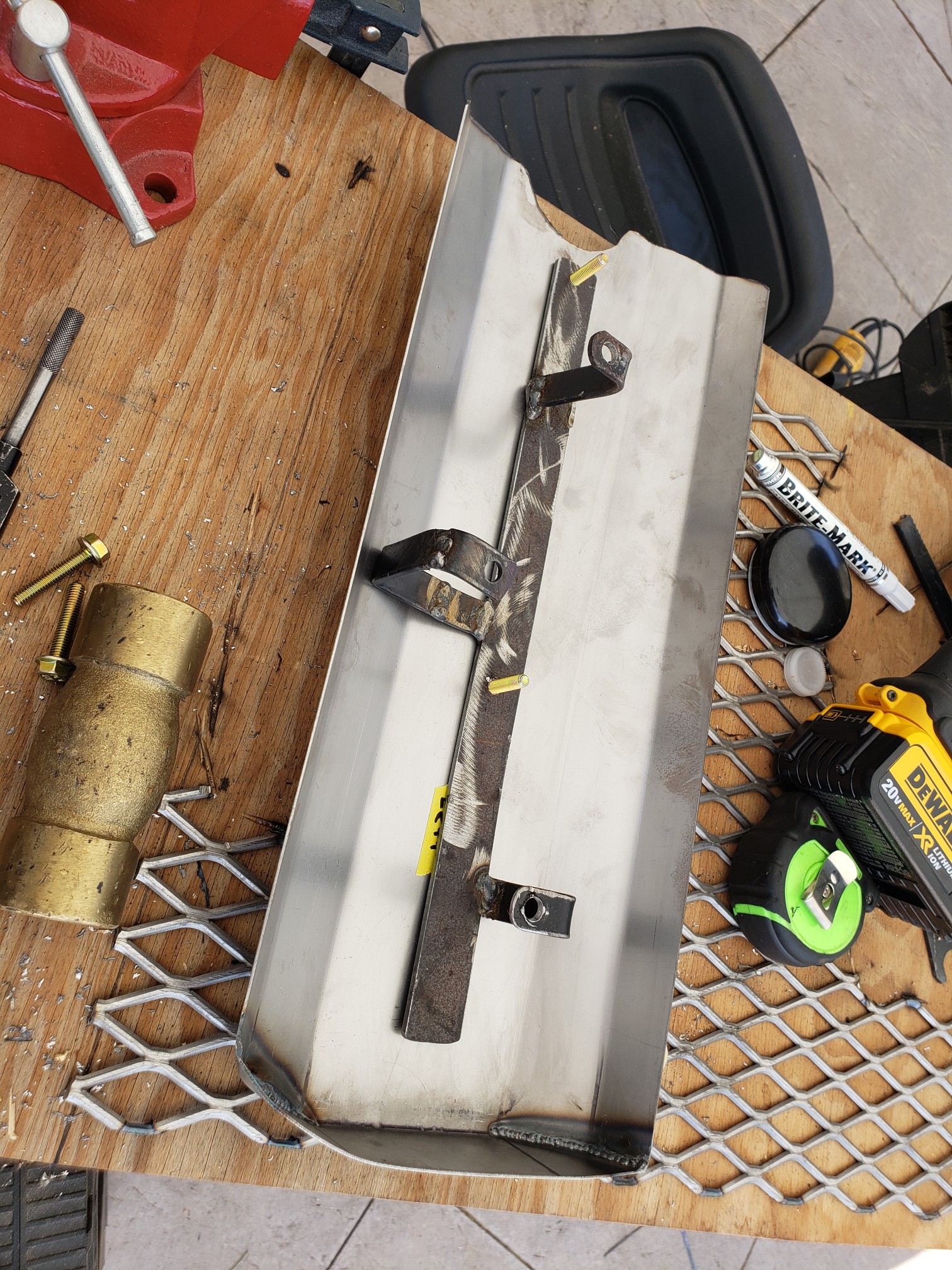

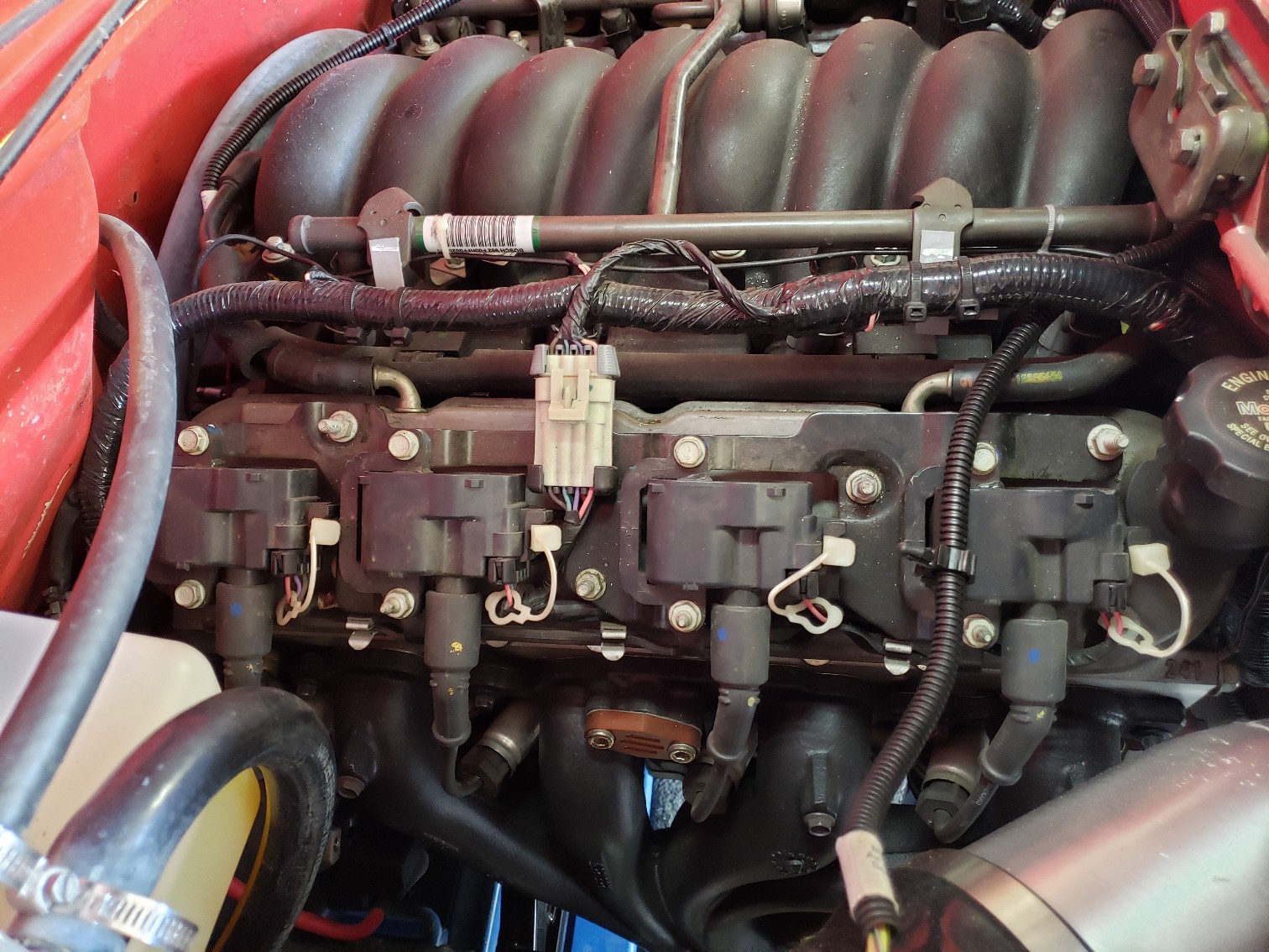

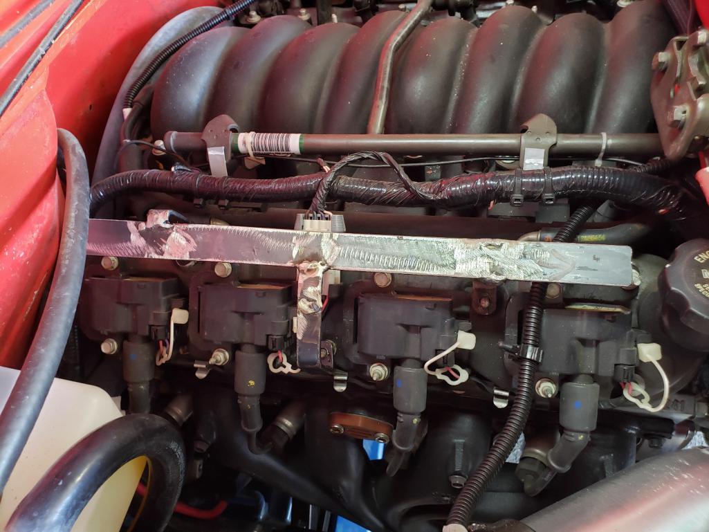

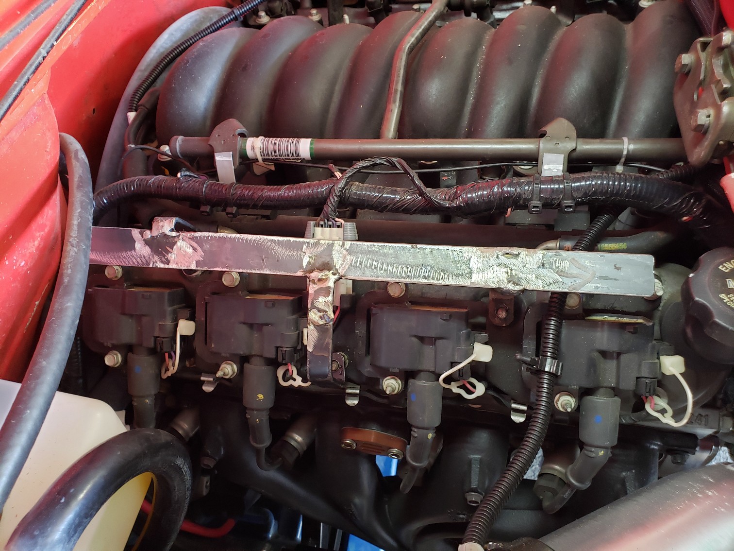

I didn't care for the look of the plain LSV8 so I fabricated some brackets and valve covers. Simple bolt on, only three 6M nuts hold down brackets to existing studs. I also used 6m bolts to attach covers. Took me 4 hours and lots of curse words.
I will powder coat later.
Oscar

Nice Oscar

wow nicely done again sir Oscar!

QUOTE(ValcoOscar @ May 16 2020, 03:12 PM) *
I didn't care for the look of the plain LSV8 so I fabricated some brackets and valve covers. Took me 4 hours and lots of curse words.
Oscar
@ValcoOscar - That is SOOOOOOO much better! (IMG:style_emoticons/default/aktion035.gif)
Now if only you knew someone who could stamp some sort of a design into those for you... (IMG:style_emoticons/default/poke.gif) (IMG:style_emoticons/default/happy11.gif)
Seriously, PM me if I can help.

[quote name='tygaboy' date='May 16 2020, 04:07 PM' post='2815924']
[quote name='ValcoOscar' post='2815908' date='May 16 2020, 03:12 PM']
Oscar
[/quote]
I've made hydroforming tooling...just not for personal use.
I will PM you a bit later. I'd love to help in any way.
https://youtu.be/CRvySEKCH-k
Oscar

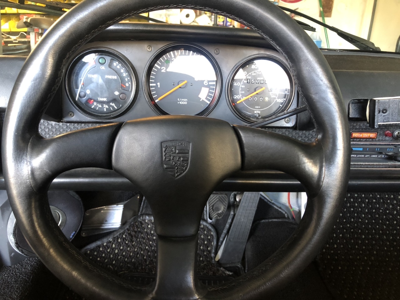

On the last 914 drive my ignition switch finally died and my daughter and her boy friend had to push start my car. So... replaced the ignition switch and while I was in there I replaced the upper steering column bearing, had Hollywood speedometer rebuild my tach with new glass, capacitors, etc. The Tach needle no longer bounces around like a cable operated 914 speedometer. I also finally wired up the turning indicator dash lights that stopped working after switching to spoke LED’s. Everything works now and looks much better.
Sorry about the glare in the photo.

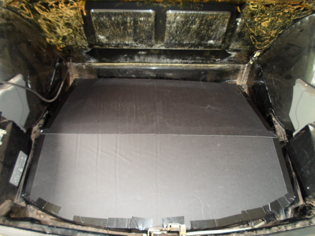

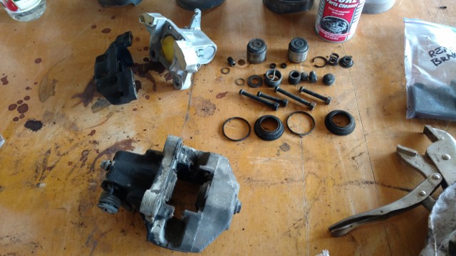

Rear Brake Cleanup
