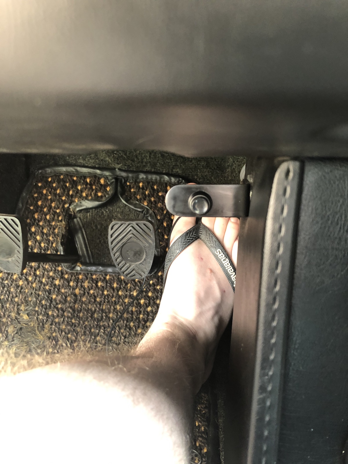

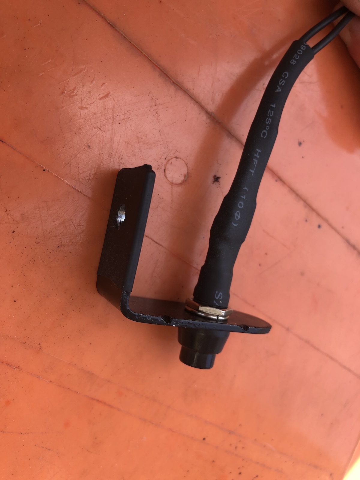

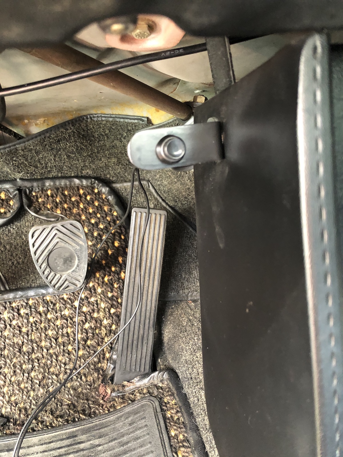

Today I pressurised the window wash system. Or so I tried. First the connection to the wheel was leaking air, so I fixed that, only to find out that when pressurised the system likes to leak the fluid out of the switch all over the dashboard (IMG:style_emoticons/default/headbang.gif)
So I decided to ditch the entire system. And just run a pump.
I've read the tutorial here in the classics, the one from Andy. And although I like the option for the stalk, I opted for the cheaper and quicker way just to add an temporary button (I need to have it all working in 14 days and at this point I don't want to go and mess with to much stuff).
So while I wait for the pump to come in I made a bracket with an always off switch to connect to the pump when it comes in. I just used a bolt from the center console to mount it. So I can take it out when I do it properly with the stalk.
Looks decent enough.
And not too close to my leg.

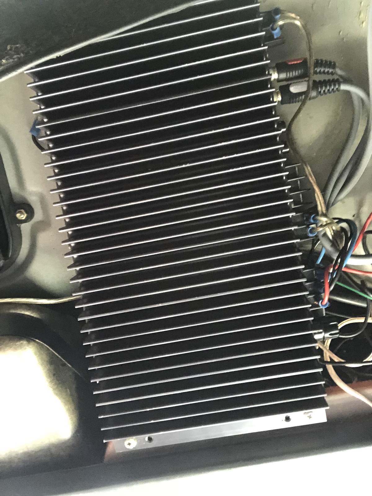

Also I found this big amplifier underneath my dash (IMG:style_emoticons/default/screwy.gif)

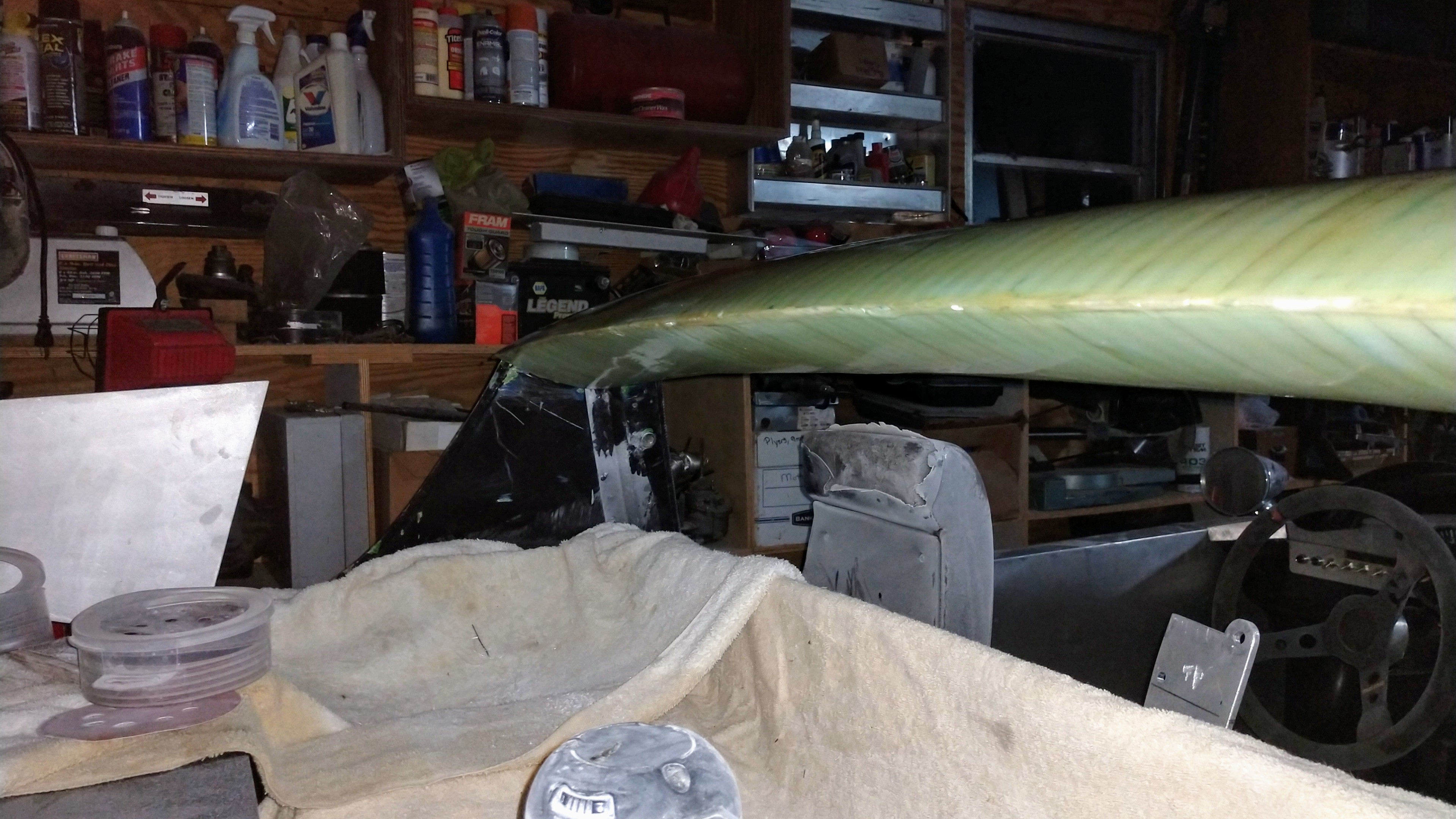

Sanding and putting on more glue.
Trying to get the trailing edge of the targa bar fairing to come to a point.

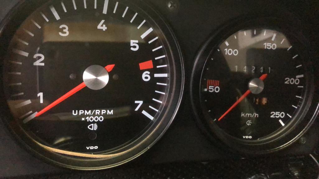

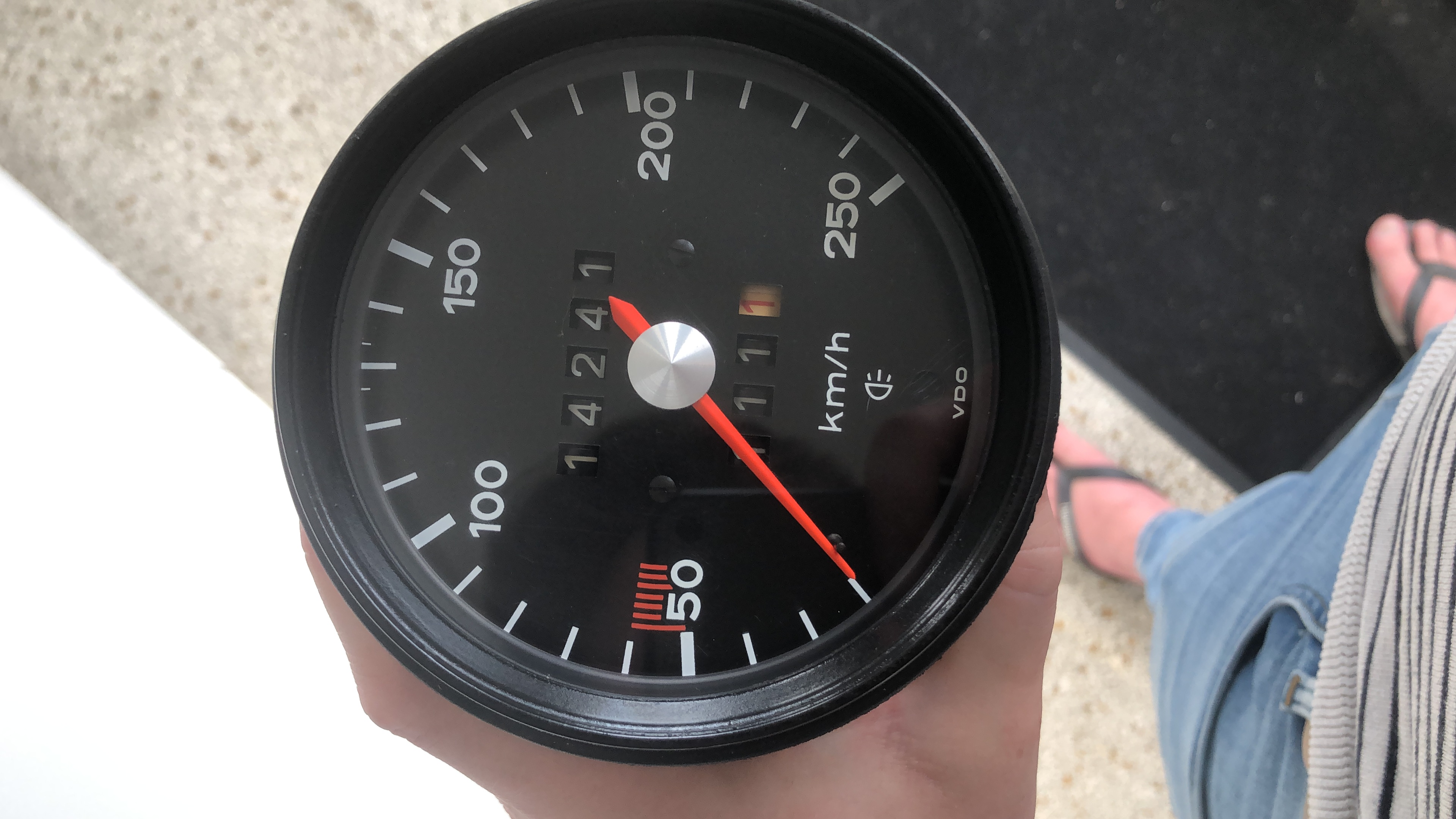

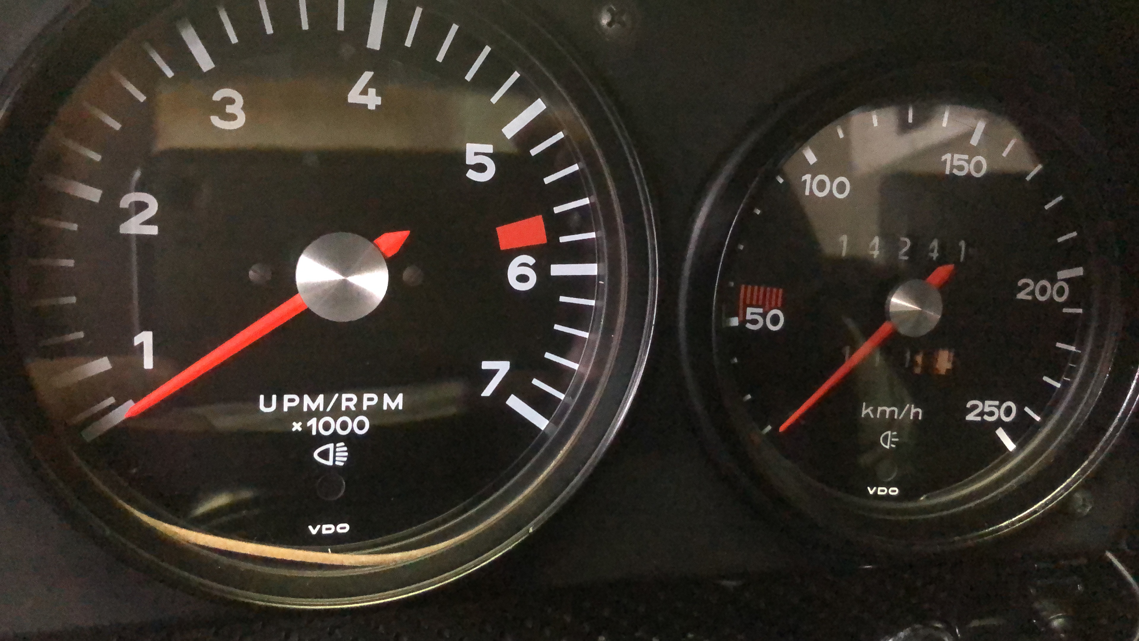

Swapped out the MPH speedo for an (250) km/h one. The km/h one needed some work, but after a quick fresh-up it looks good as new.
(IMG:style_emoticons/default/sunglasses.gif)

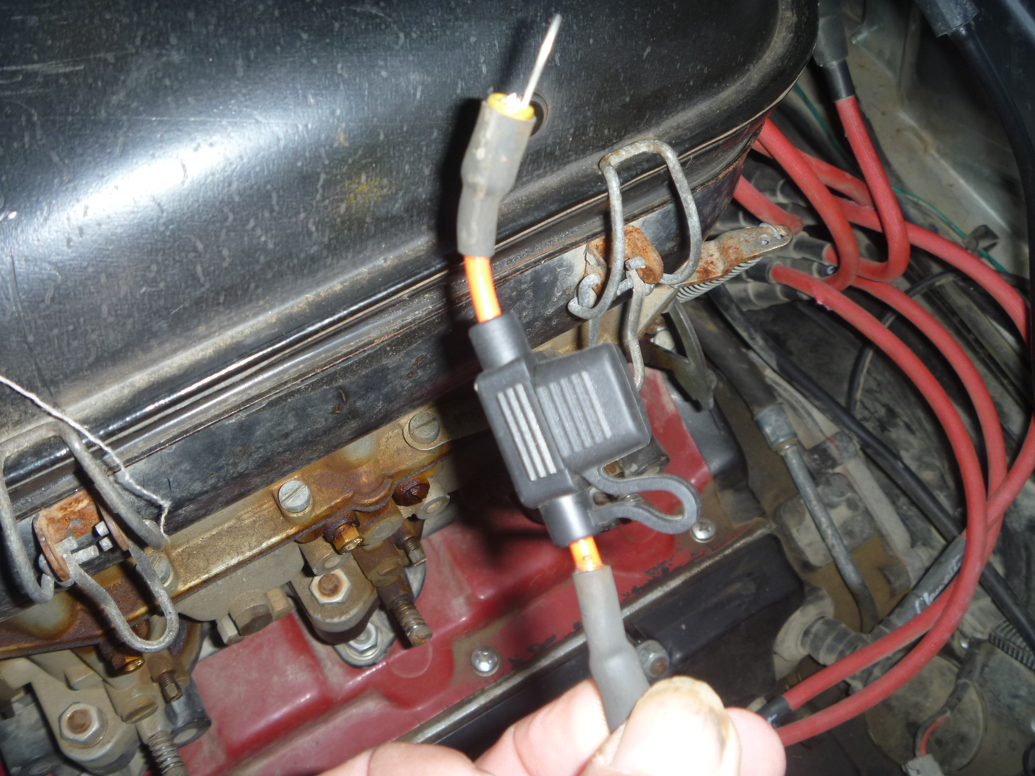

Not locked down anymore as we are on level 2 and level 1 should be around 2 weeks away.

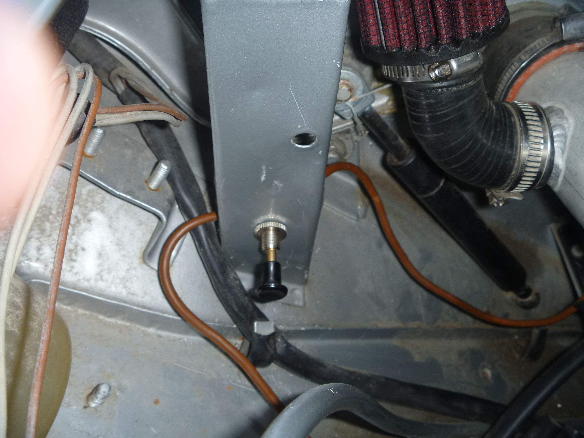

Just small jobs but knocking the list back,got the aux power supply fused @ the battery and put in a secret fuel pump stop switch for security reasons and to isolate pump while doing other work "key on".

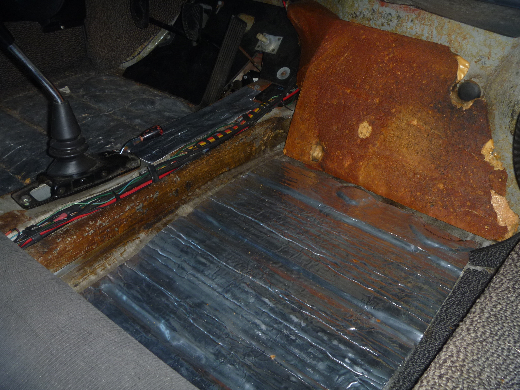

QUOTE(porschetub @ Jun 4 2020, 04:56 PM) *
Not locked out anymore as we are on level 2 and level 1 should be around 2 weeks away.

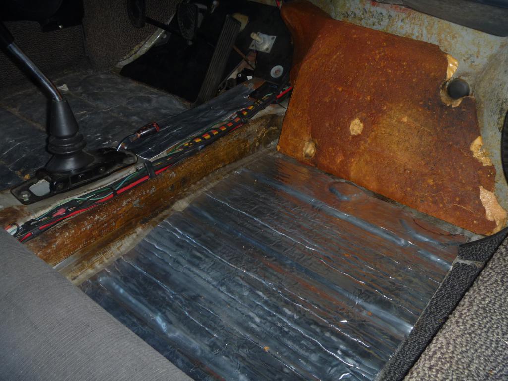

Last of sound mat on the RH side of floorpan ,mats back in and fitted properly.Attached Image
Excuse the dirty engine that's a grin and bare till I move to a better situation without a shitty gravel entrance road when I sell my house.

QUOTE(porschetub @ Jun 3 2020, 09:56 PM) *
With what appears to be brown wires, did you simply cut the ground to the pump with the switch?
I've been thinking of doing something similar....

QUOTE(FlacaProductions @ Jun 4 2020, 12:34 PM) *
That's what I did on mine - put the switch the ground wires (mounted the switch up under the dash. So, while you can cut either side,, I prefer to use the ground wires, so there's not a live wire under there when I'm working on other stuff or fumbling around blindly trying to find the dern switch by feel.

QUOTE(FlacaProductions @ Jun 5 2020, 04:34 AM) *
Yes ,found it to be an easier solution.

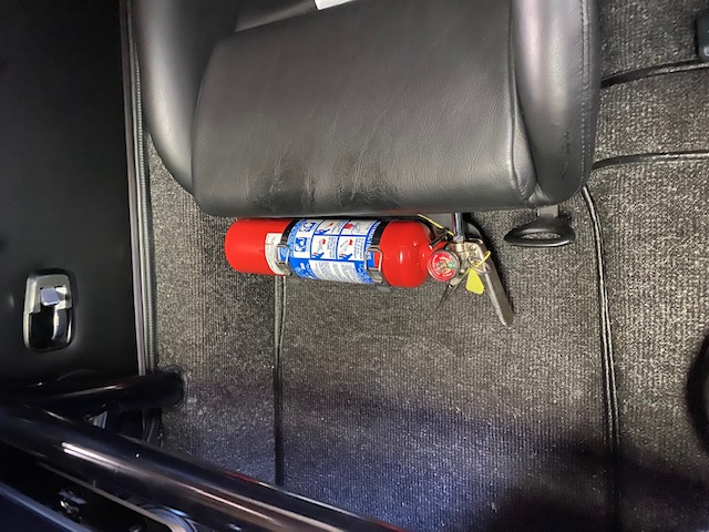

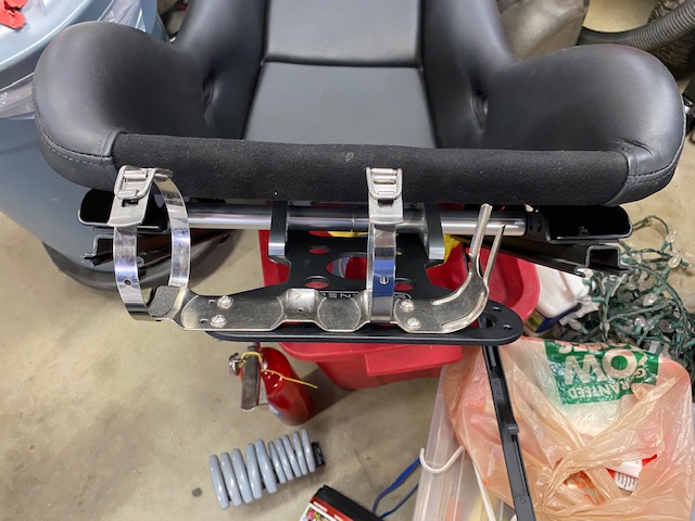

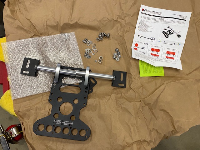

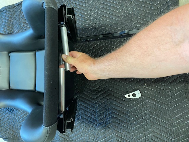

Hard mounted my 2.5# fire extinguisher in the 6 using a Rennline universal mount. Had to cut down the aluminum shafts that the plate mounts on because the 914 seat rails are too narrow to their "universal" spec. Seems overly complex on some levels but fits really well once customized and installed:

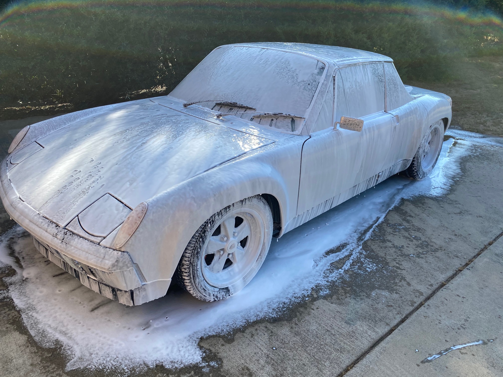

Washed it up for the drive tomorrow. "Someone" was breaking in new tires and there was tire soot all over the back end (IMG:style_emoticons/default/happy11.gif) also wanted to make sure the oil was all off from my last attempt to go to a drive

Wow ! That’s a lot of soap! It will probably lather up every time it gets wet. (IMG:style_emoticons/default/poke.gif)
