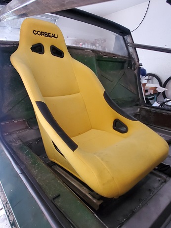

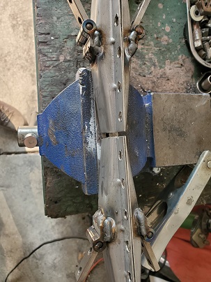

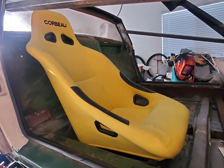

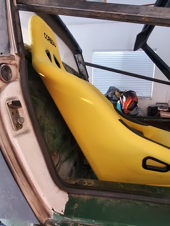

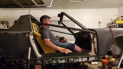

Welded in the new seat hinges and played with the seat placement so I could get and idea for what's comfortable before I welded in the other supports I have.

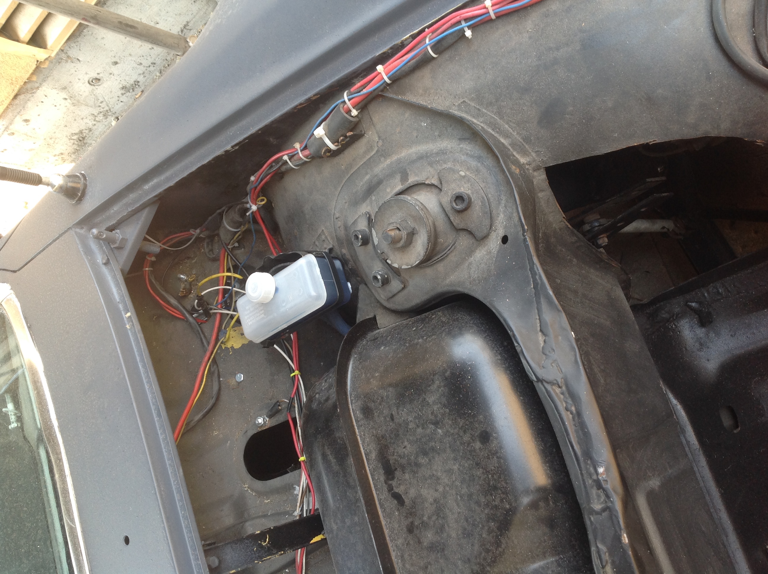

Brake reservoir was chipping away. Could not bring myself to paying 90-130 for a factory one. So I remembered our cars are Porsche/ VW and this fine specimen from bugs was only 10 bucks (IMG:style_emoticons/default/lol-2.gif) Attached Image

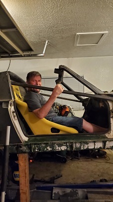

Ladies and Germs, we have seat placement!

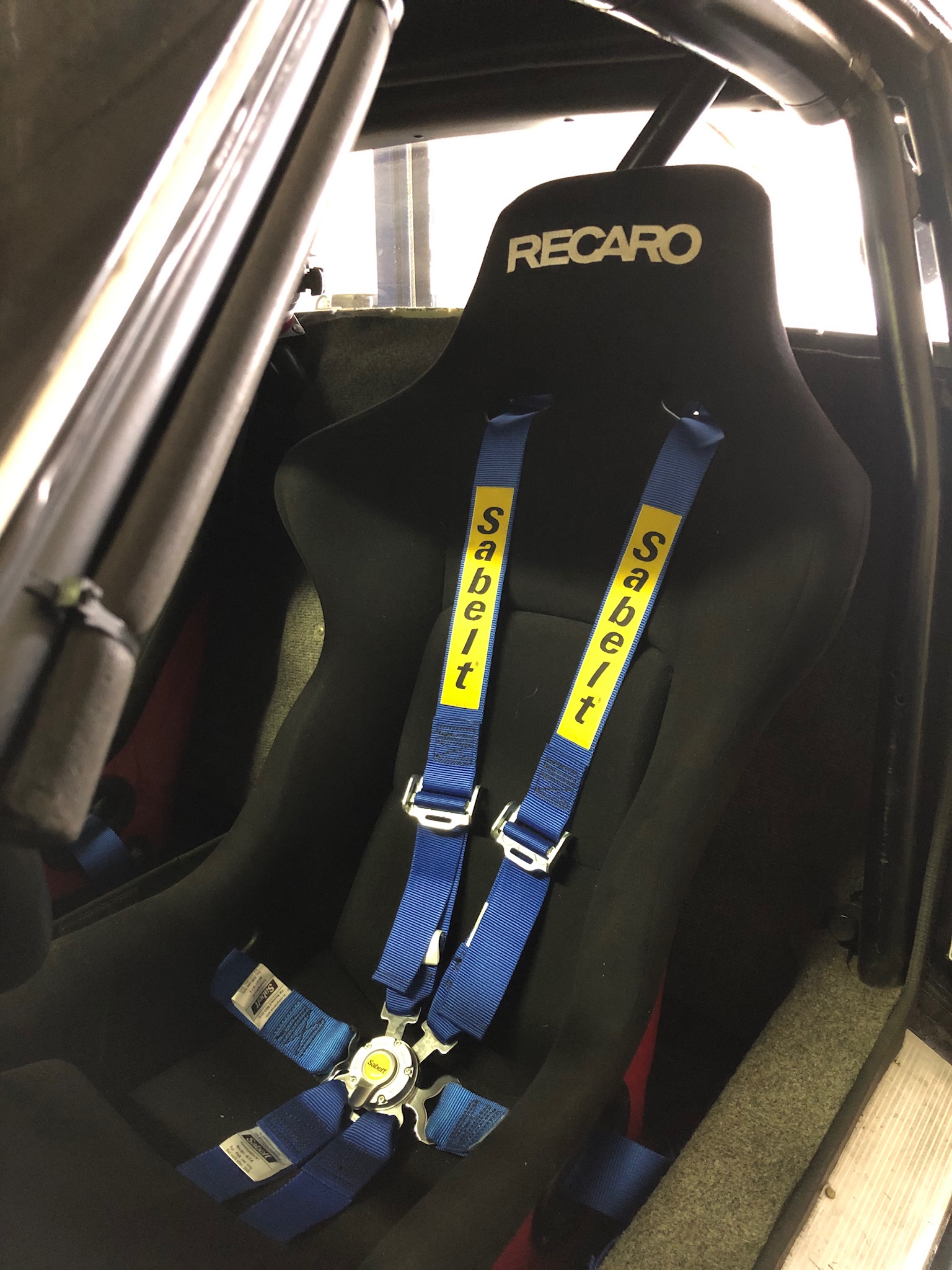

Apparently seat weekend!
Re-mounted these on the floor, with an adjuster so I could gat a bit more helmet clearance with the top hoop.

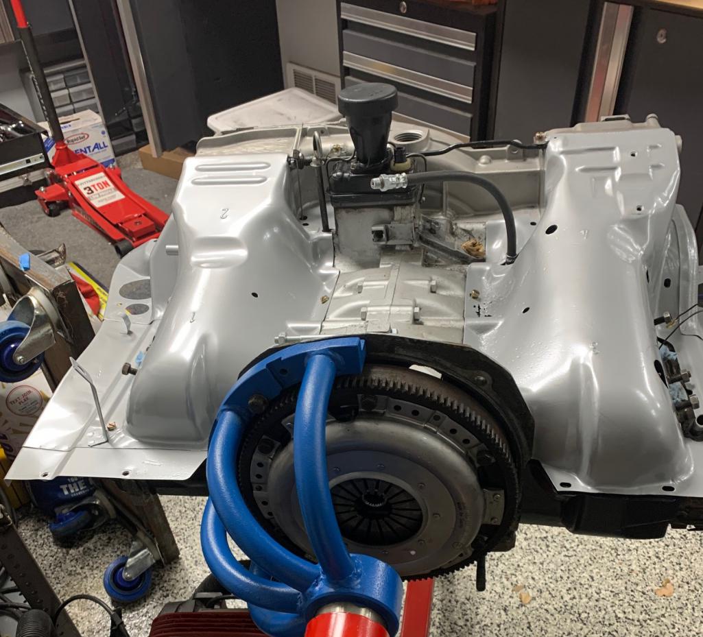

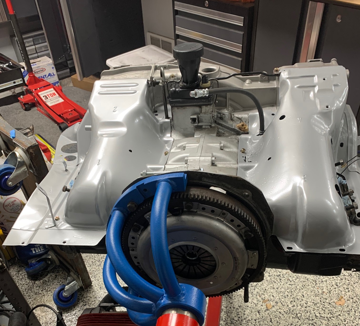

Getting the engine rebuild complete.

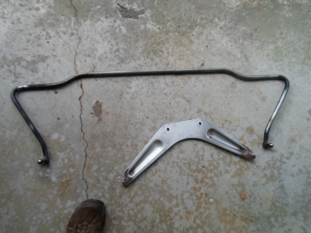

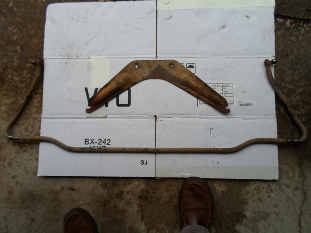

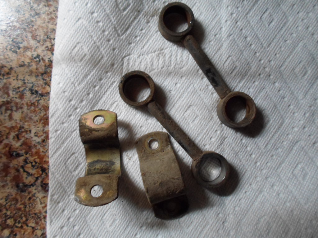

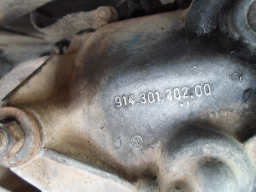

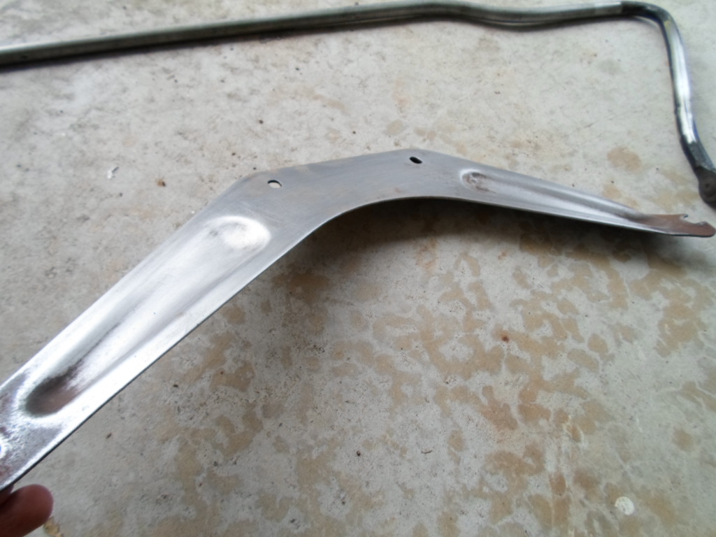

I had some time today, so I removed the boomerang and the rear sway bar, ...also cleaned up the transaxle a little bit ....lots more grease/gear oil to remove, but at least now I can read the # on the back of the transmission.
got about halfway done with sanding both the hangar and the sway bar, and put the droplinks in vinegar to soak overnight.
I think I might just clearcoat the hangar.....I kind of like it in its raw state....

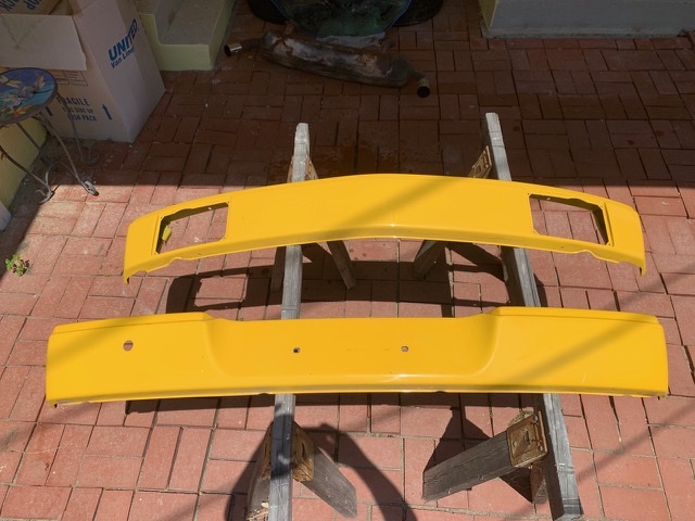

Bought these beautiful bumpers from a local S Cal member.
Gotta get all the other parts now: tops, grills, lights, rtc

dont forget the cover plates for where the bumper shocks stick thru ,
and also in the rear, there is a hole in thebumper for where the tow hook can screw into but our late cars had it in the steel bumper and the early cars had theirs welded onto thebody so if you want that it will have to be added.---
good luck with your latest project- however if you do this , i dont think there is an original copper metallic that still has the BUB's and is still original color too.
Yours, mine and Brad Mayuer of 914LTD all are back dated bumpers......

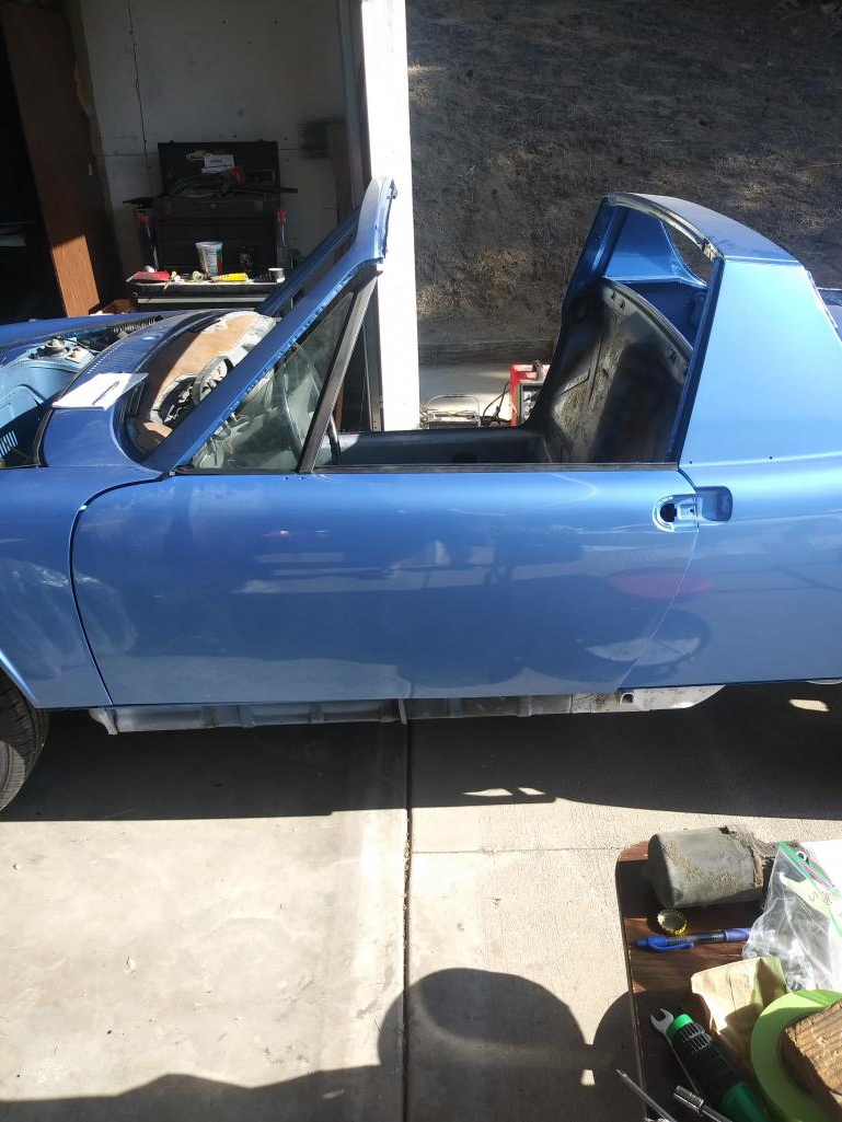

Hung the driver's side door (preliminary for now, got to add rubber and adjust) for the first time in two years.
Putting the passenger side door together now.
One small step for man.......

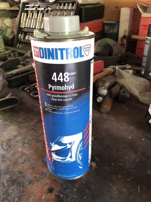

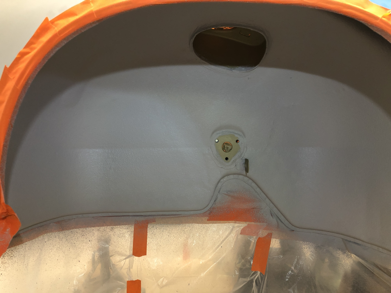

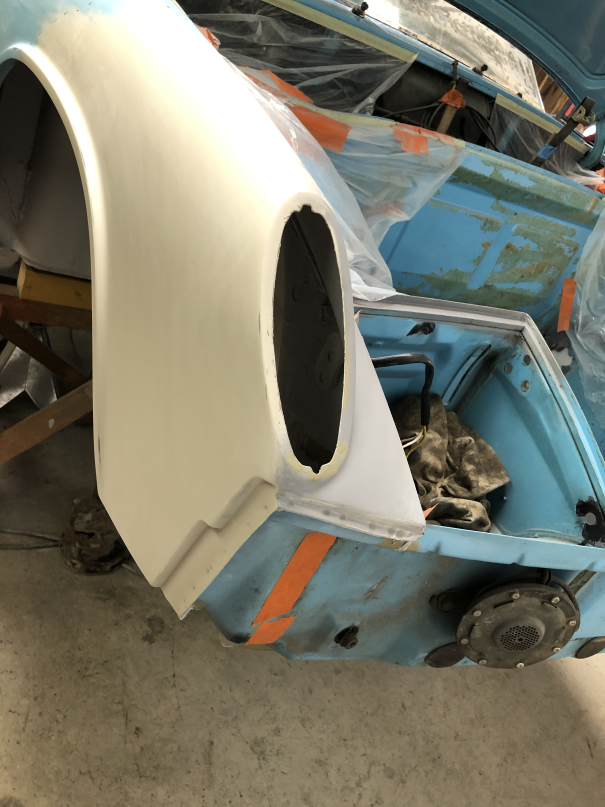

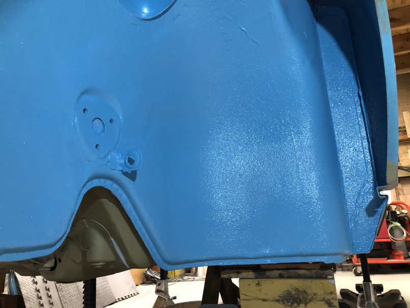

Made some nice progress last weekend, sprayed undercoat and painted the front fenders... (IMG:style_emoticons/default/piratenanner.gif)
I used Dinitrol Pyrmohyd 448 for the undercoat... A bit expensive but I like it.
Then painted with 2K laquer
Oh, also deleted the side markers... (IMG:style_emoticons/default/biggrin.gif)

man that looks nice!!!
