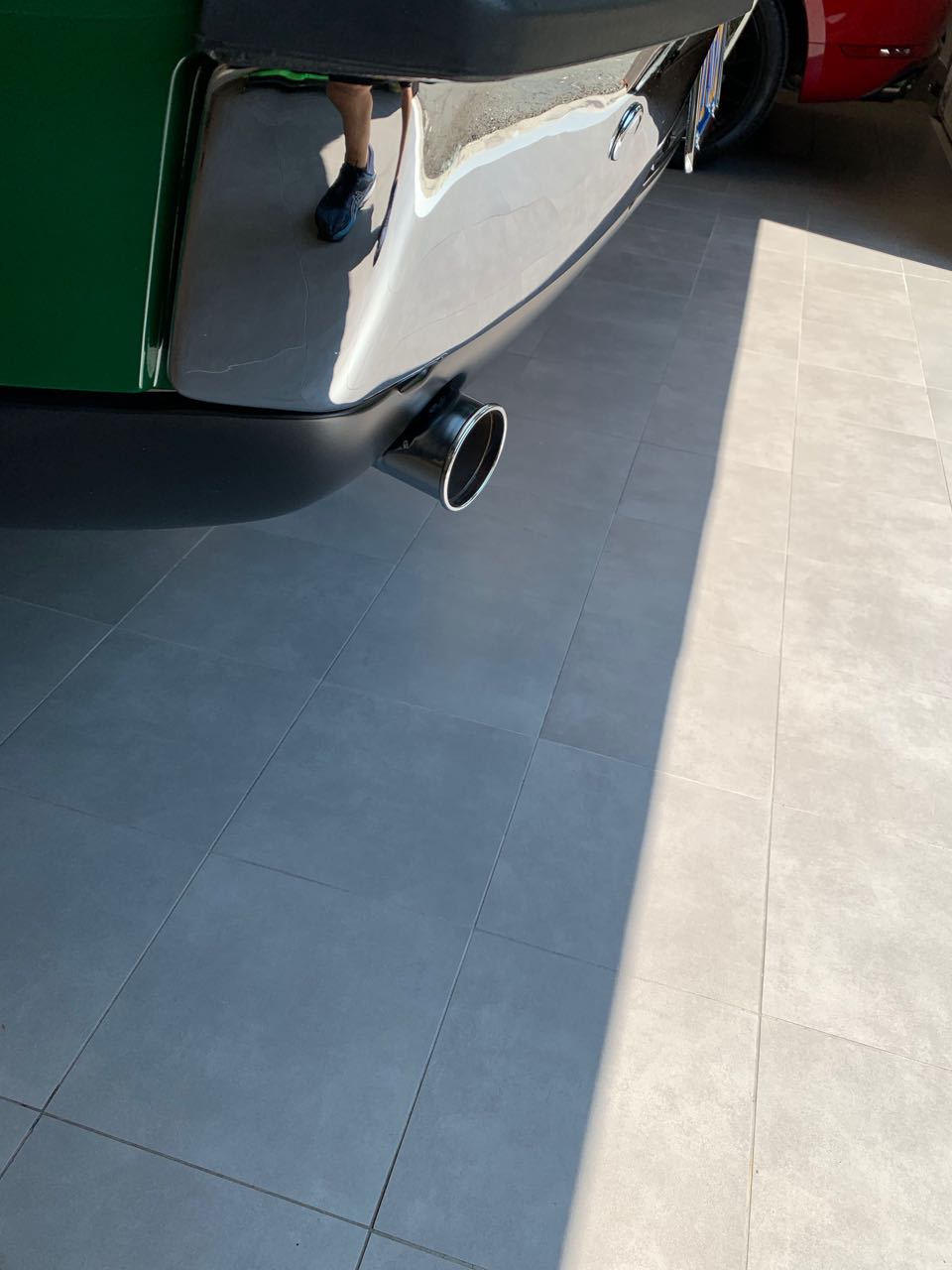

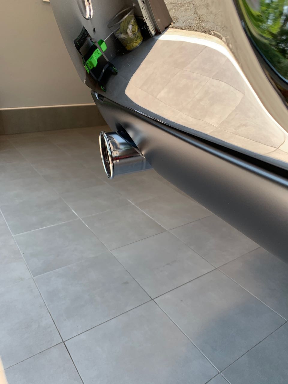

That looks really nice.
I installed the chrome exhaust finisher on my Ben's muffler. I sent the stock 914-6 finisher to Ben and he stretched it on his expander pipe muffler machine and then he welded 2 nuts on so I can secure it because stretching it eliminated the indentations to hold it securely to the pipe.
I then applied a nice coat of carnauba wax to the car. Going to take my son to lunch tomorrow and want to take the Six.

Hey that worked out better then I thought it would.. Did the set screws make it there? I am not sure as I bought 4 so I thought and I have 3 here still.

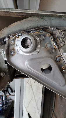

It must've been a Friday afternoon... drilled the welds out, turned it around and rewelded it so it wouldn't drop off my jack when I lifted it!

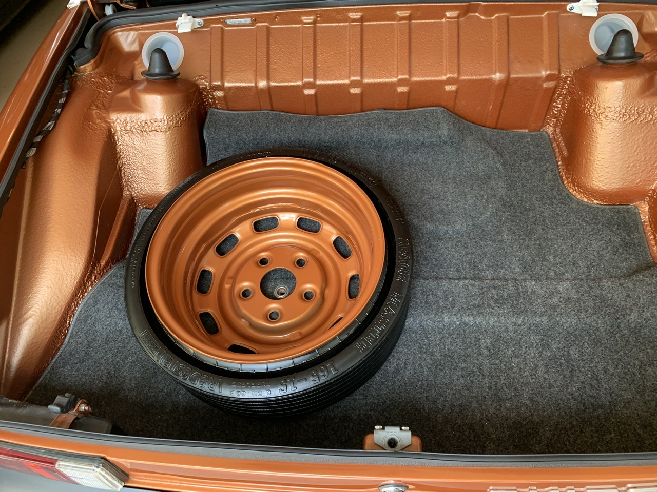

little project today, spare tire beautification,
fixed lest at the master cylinder and replace the belly pan.

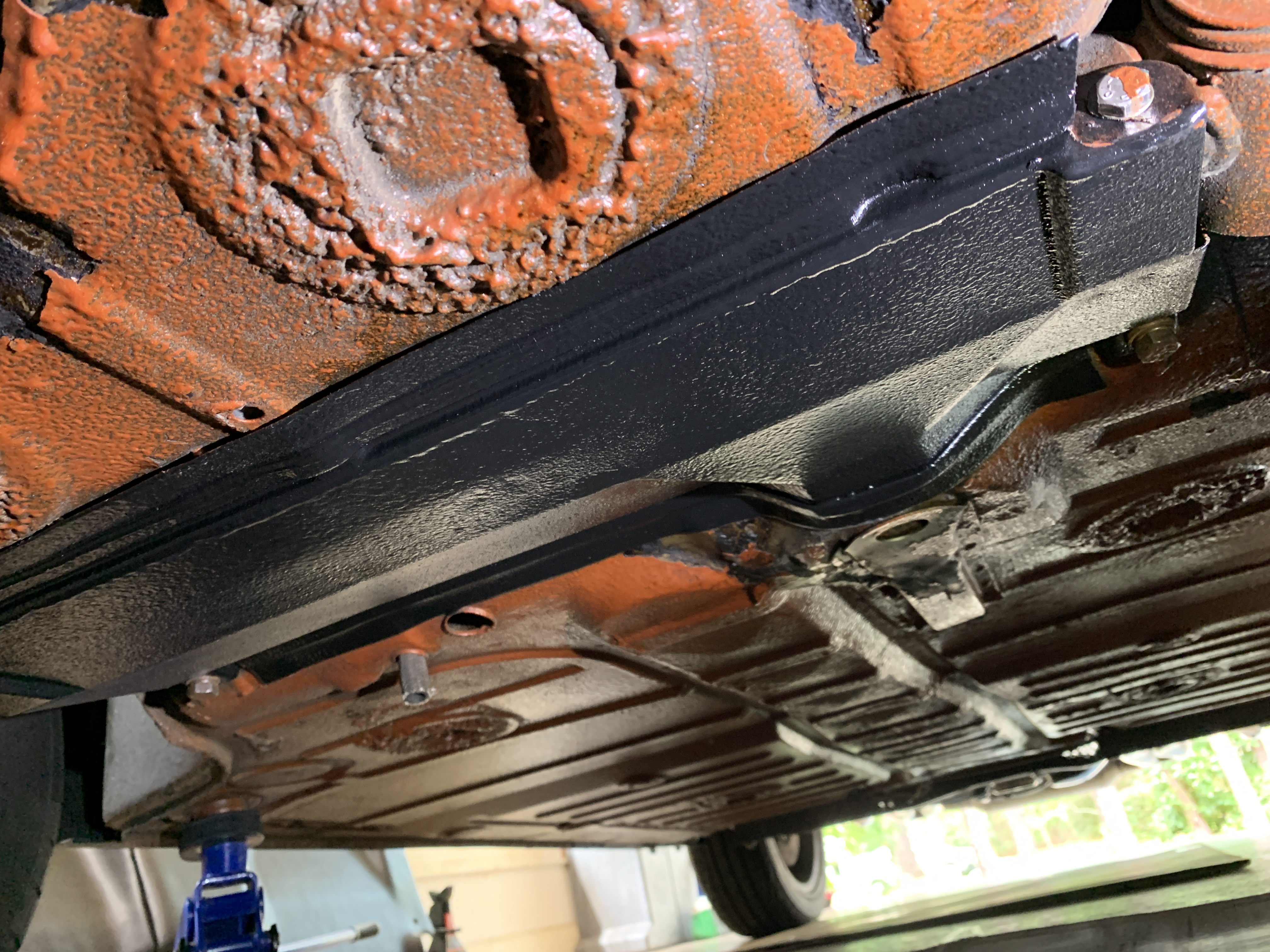

belly pan back in.
i also took the front rims off front to get new tires mounted . getting ready for next trip!

I see your welding with gas now. Looking good. (IMG:style_emoticons/default/beerchug.gif)

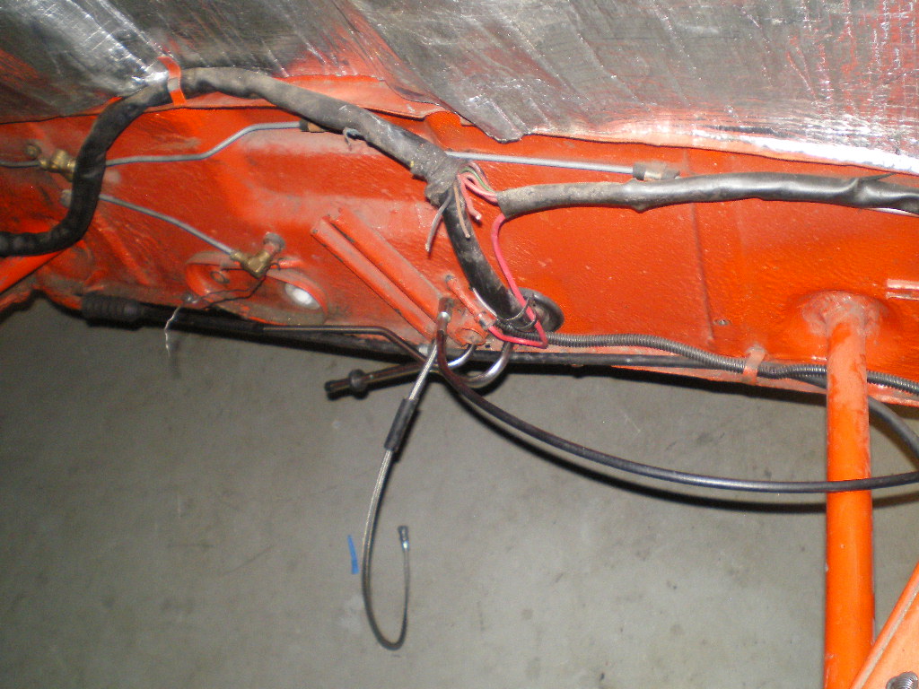

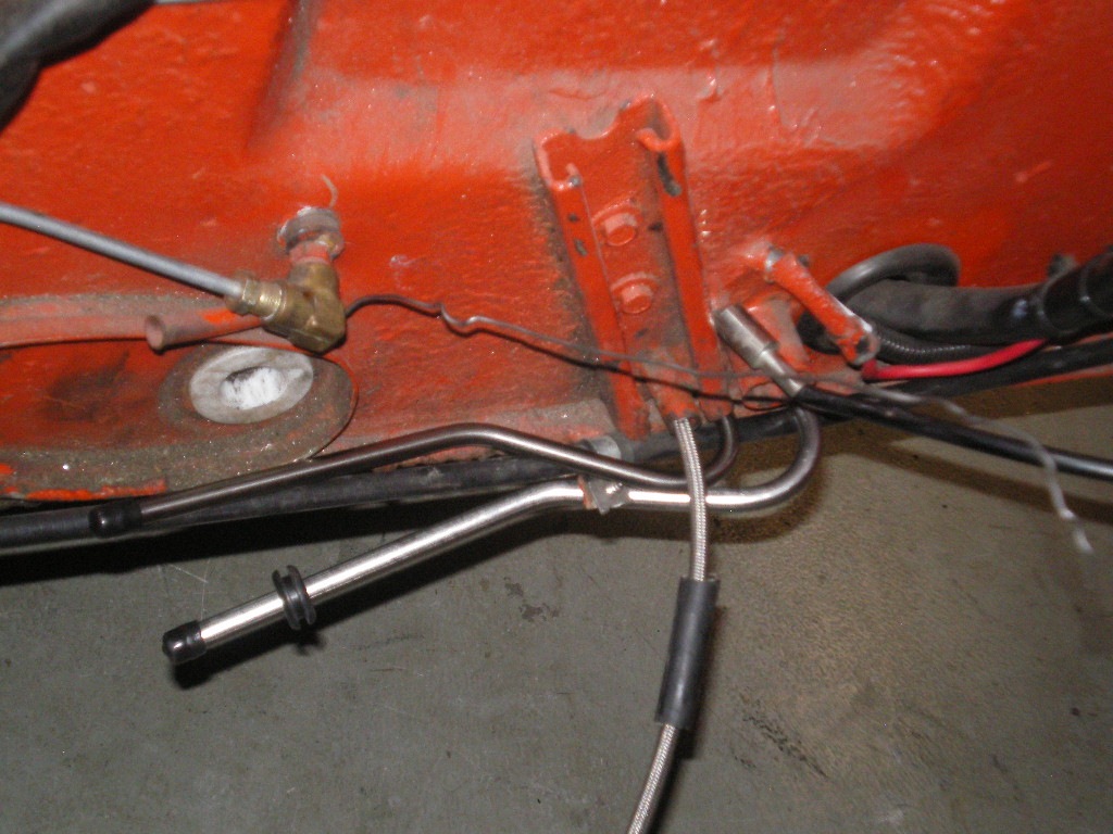

Well, this was done yesterday. Pulled my tank and installed new SS lines. Who here has a discerning eye here?

Pointed towards the driver's side, rather than the other way around?
