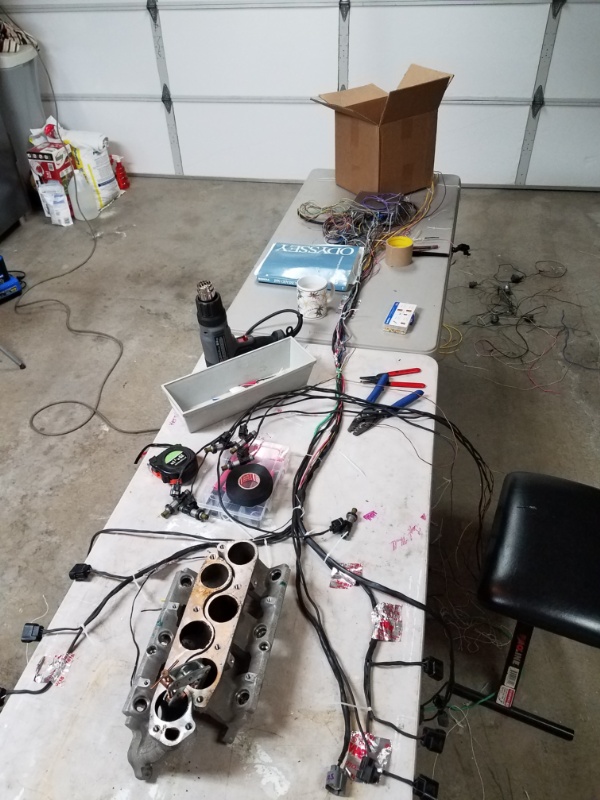

Took engine harness out and shortened it by about 2.5 feet. I think I can still remove another foot from it and I would be okay

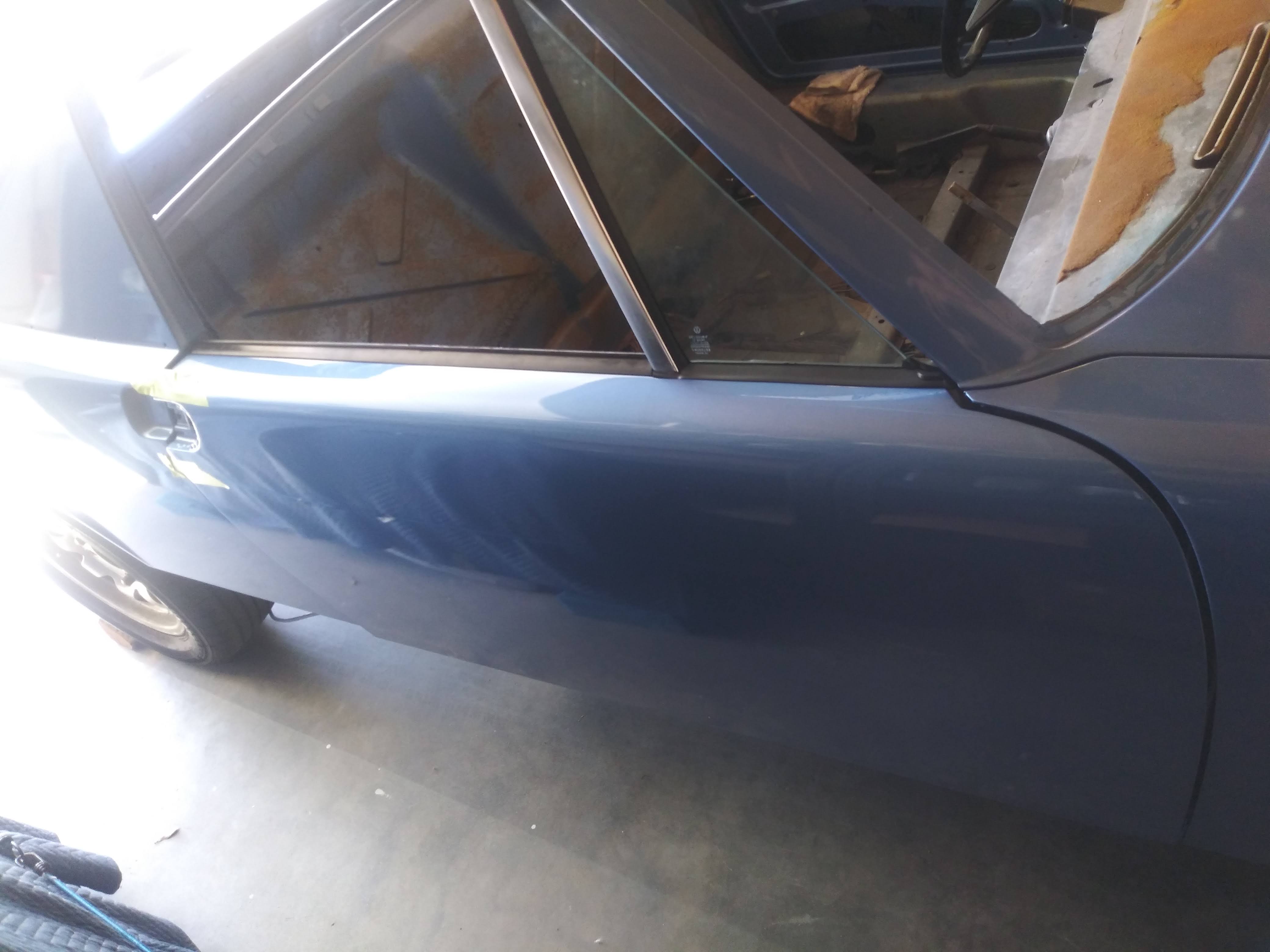

First steps in getting the doors on permanently, both sides are now hung. We're going to get the seals, door handles, strikers and surrounding rubber installed so we can start the fine tuning of gaps.
Every day, it's moving a little further along (IMG:style_emoticons/default/smile.gif)

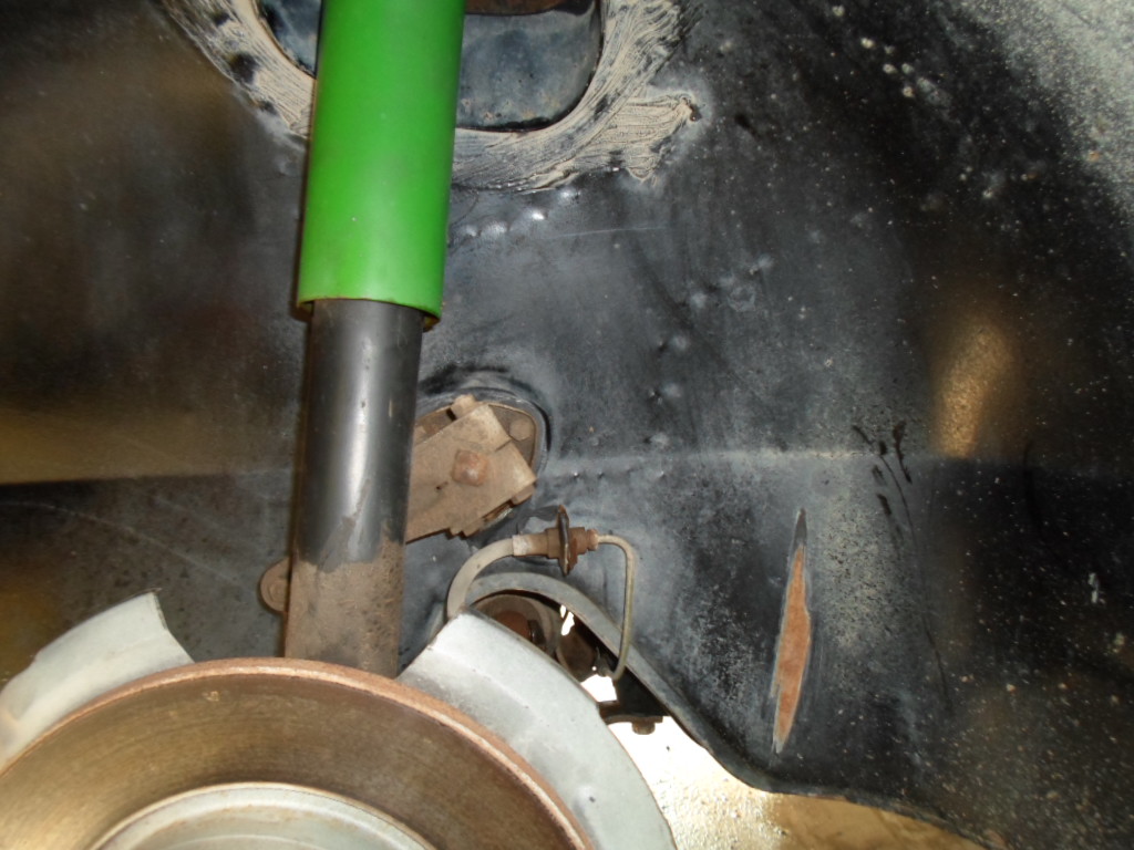

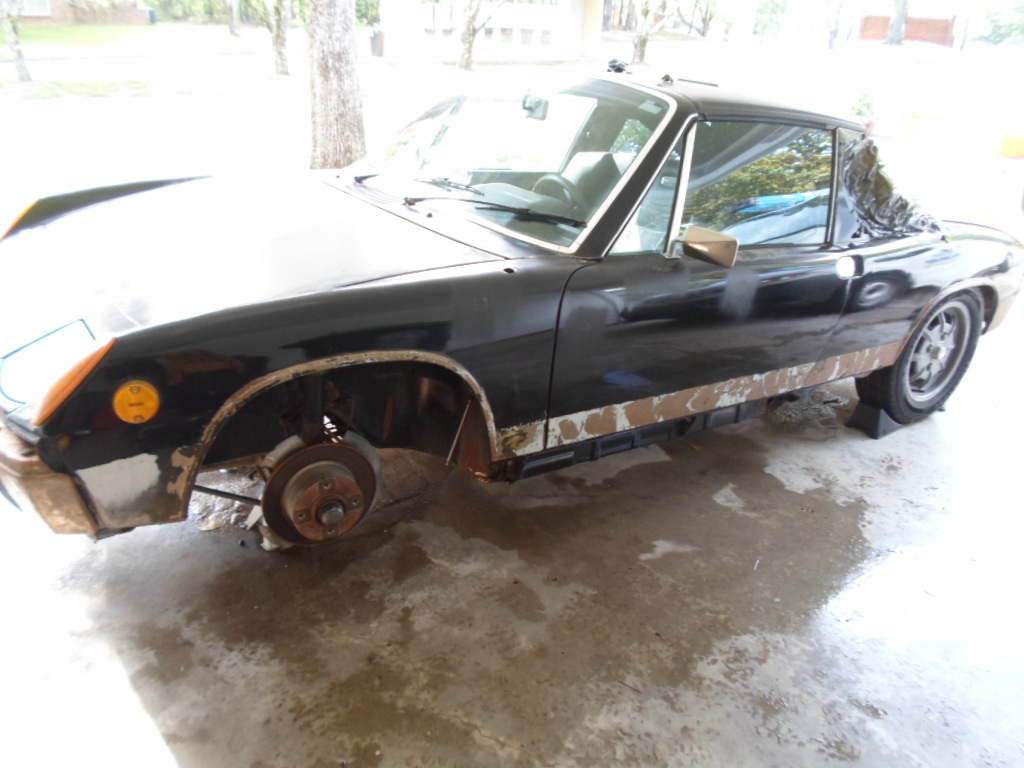

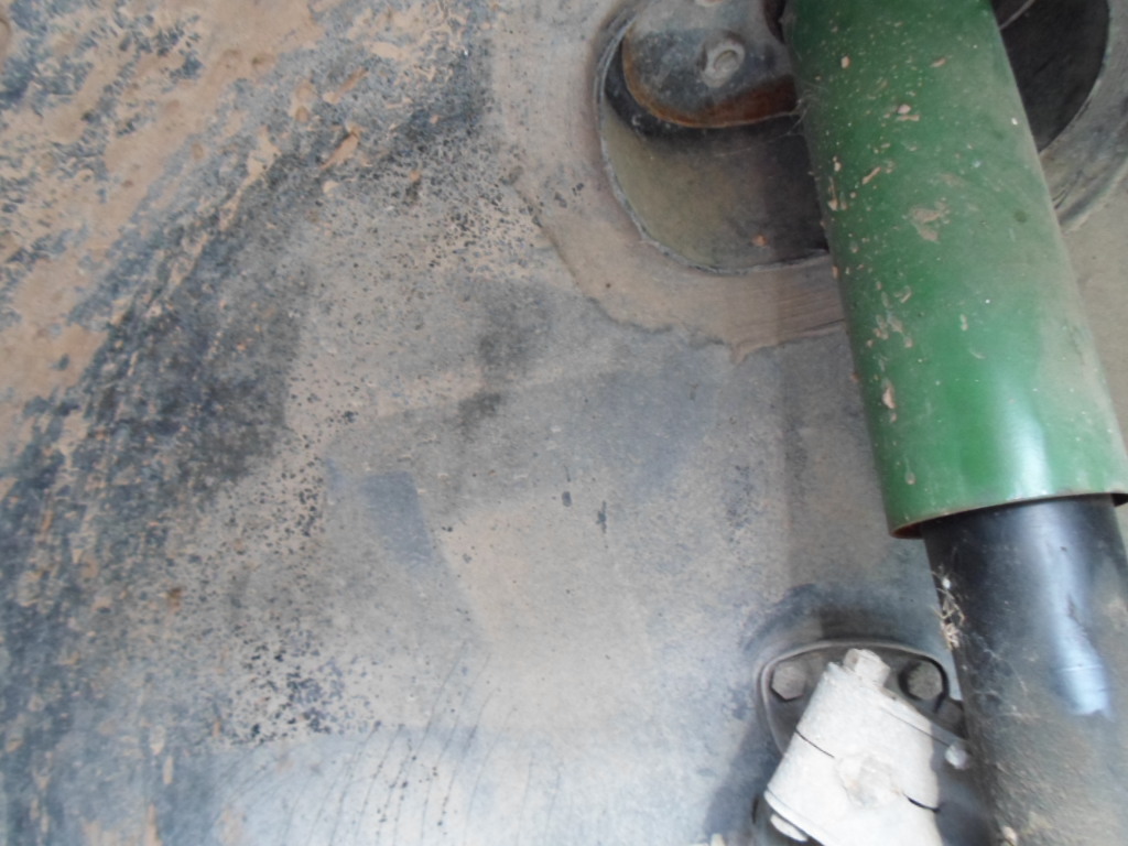

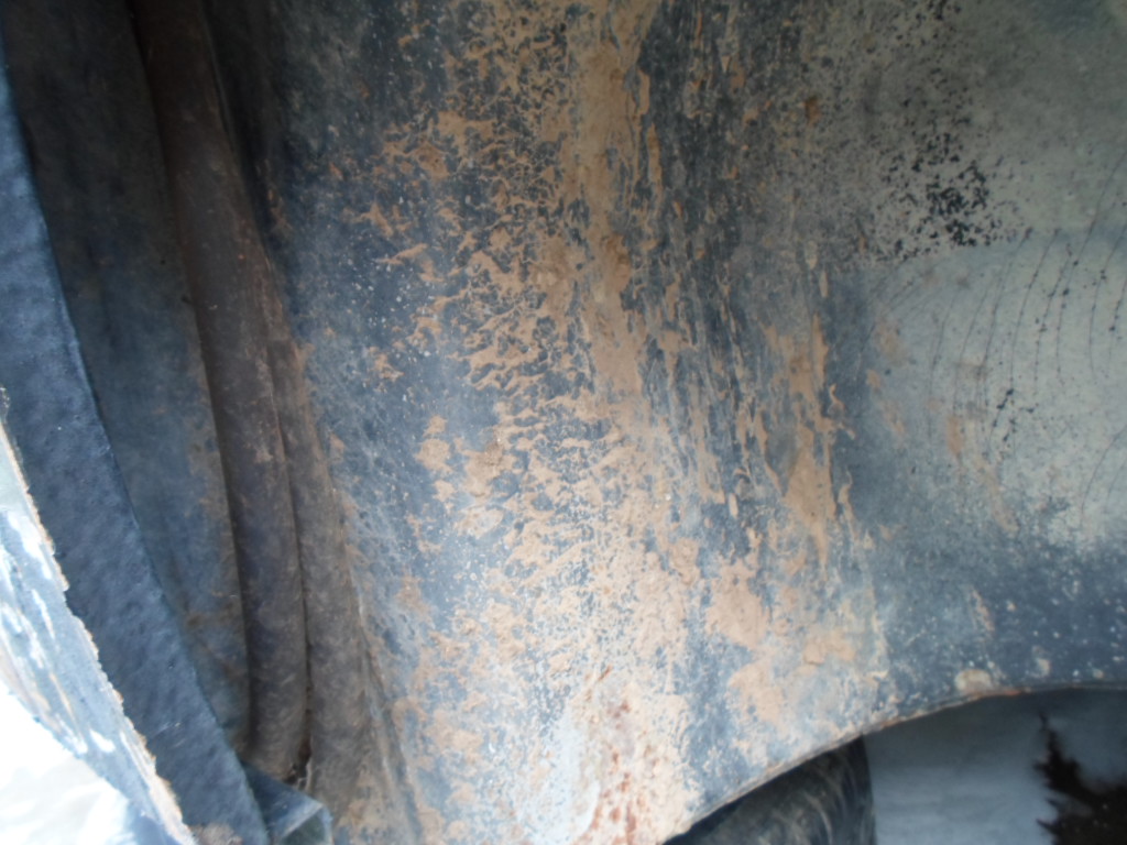

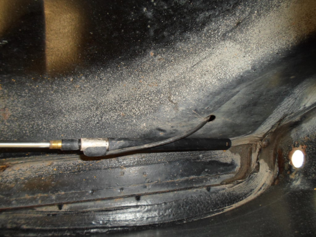

Since I pulled the front calipers off and sent them out to be rebuilt, I figured I should at least get out the bucket & sponge and wash most of the dirt out of the wheel wells. Other than the fact that everything needs to be re-bushed and/or replaced, the wells themselves are relatively rust free with original paint.
Attached Image Attached ImageAttached ImageAttached Image
I added one gratuitous post of the car on jackstands.....or in its natural environment.

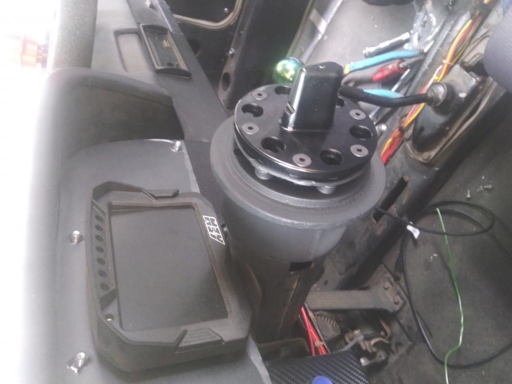

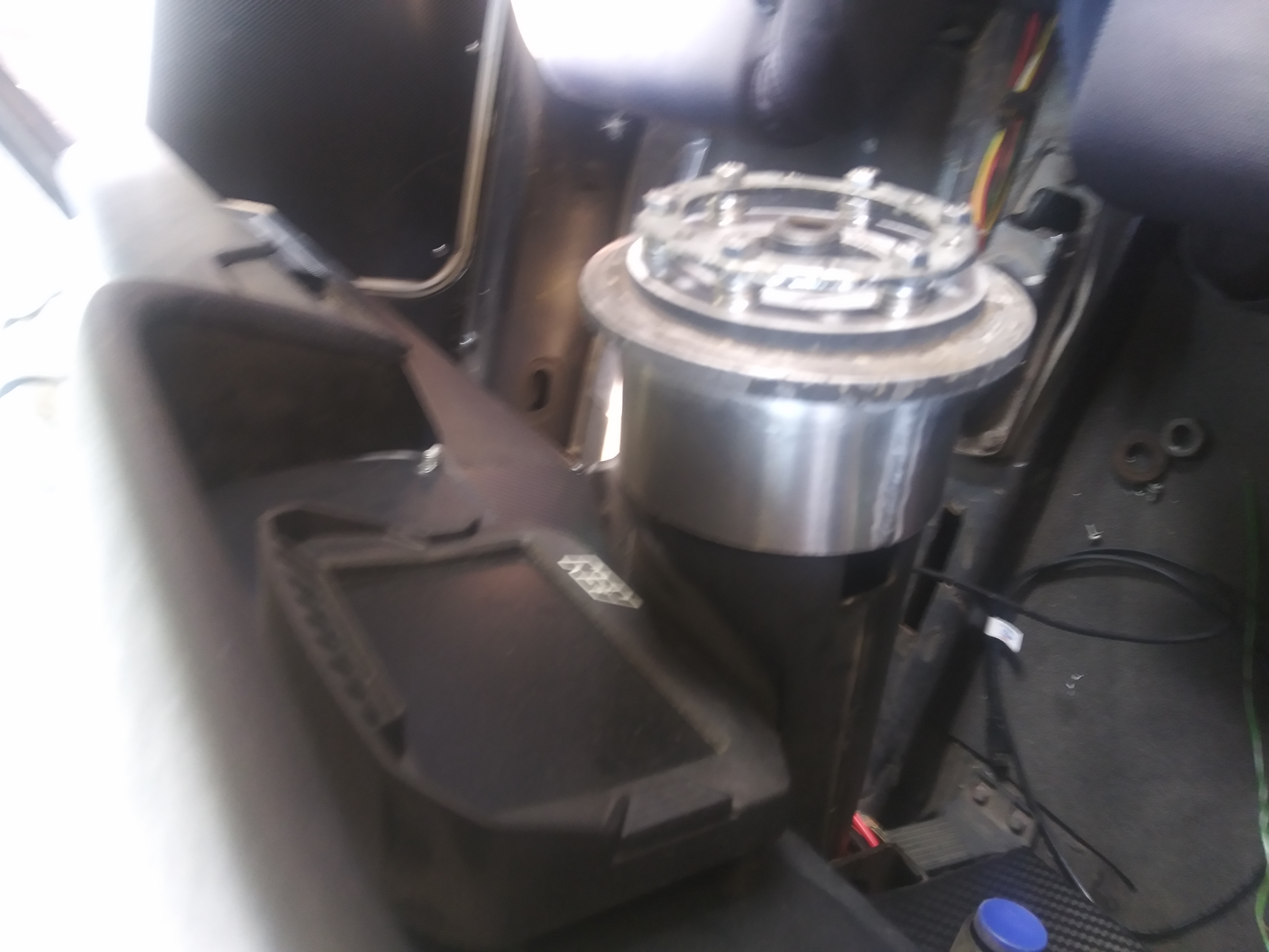

Installed my Rennlist quick release hub. Very satisfied with the product. Kind of tricky cutting my momo hub down because the ring that attaches the steering wheel to is steel and the hub was aluminum. Ended up cutting aluminum bracket to close so had to improvise to attach steel hub to aluminum bracketAttached Image

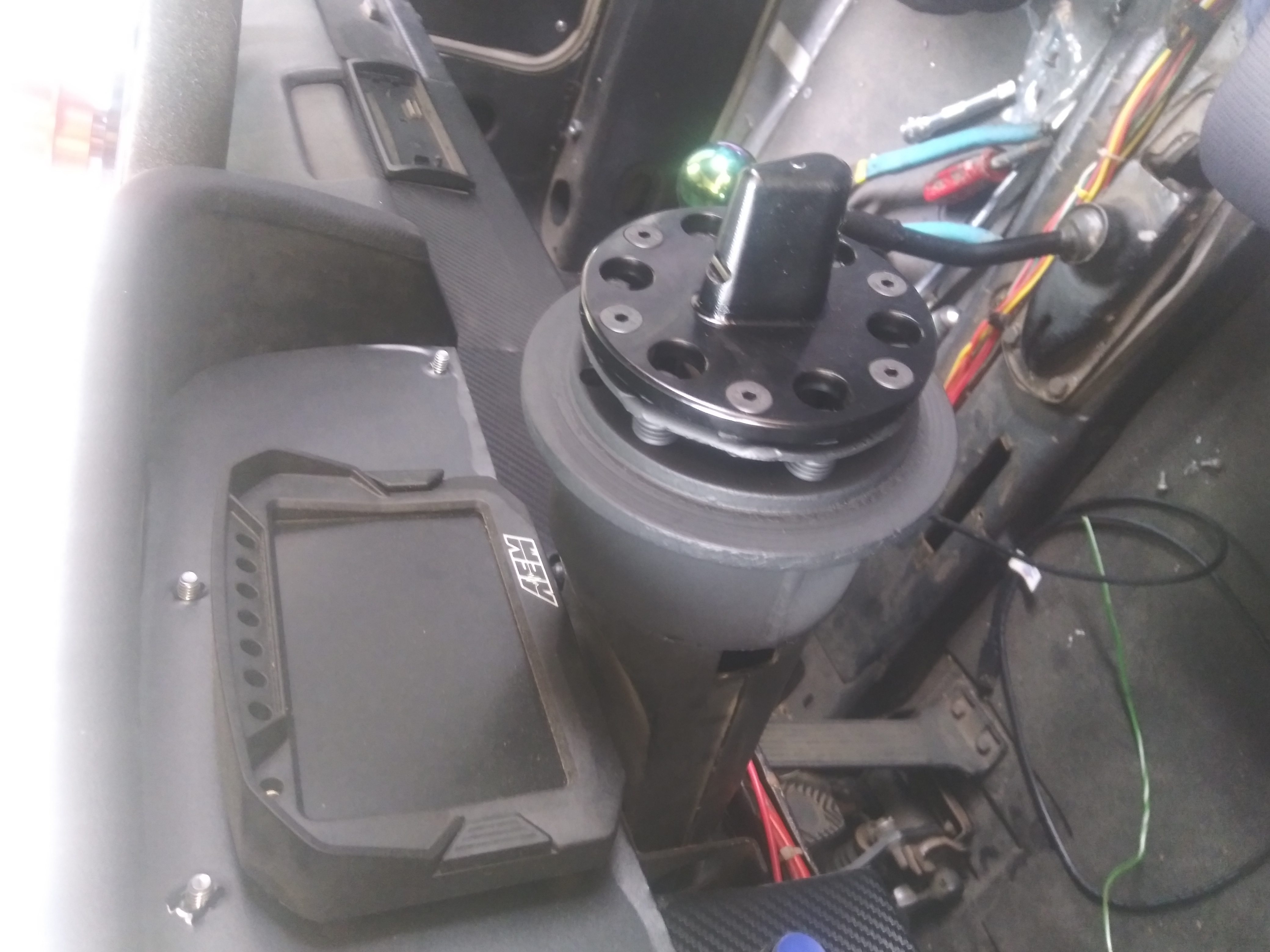

Final productAttached Image

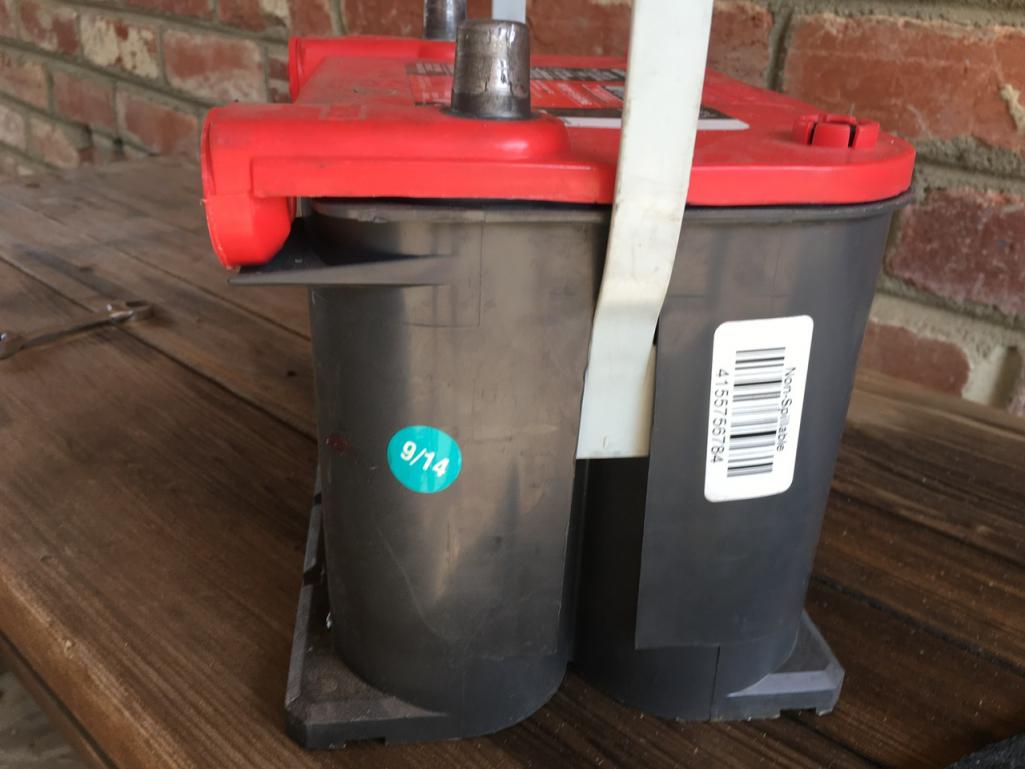

was fooling around with #58 today and decided to pull the battery. check out the manufacture date..

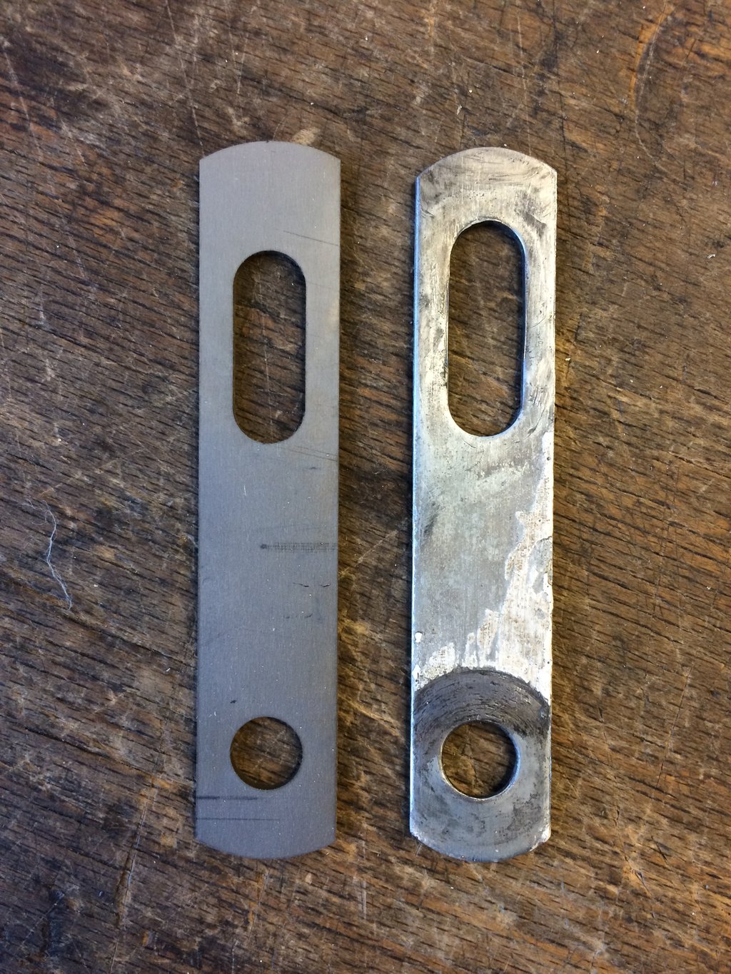

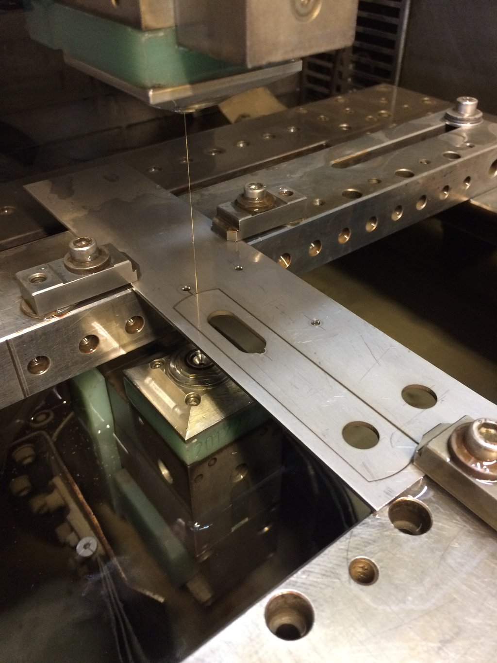

The hinges of my deck lid interfered with the engine grille when fully open. I wire cut 2 new pieces of stainless steel to limit the opening of the lid somewhat. Worked great. (IMG:style_emoticons/default/smile.gif)
