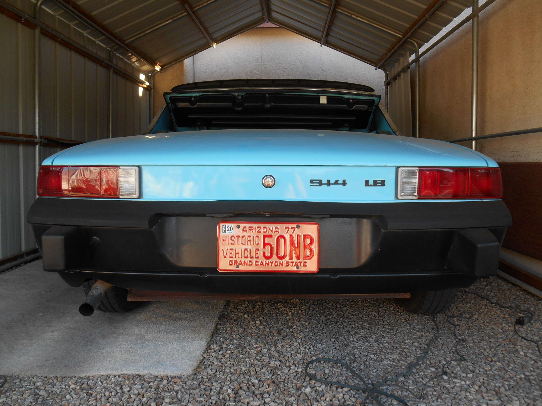

Got the PITA Main Targa seal in today. Everything went okay, just sore tired hands. I did use a screen roller on the seal going down the channel, worked real good. Don't even want to tell you the time involved, lol. so now the old 71 has all new seals in window, and top area. (IMG:style_emoticons/default/piratenanner.gif)

Forgot to mention it was the 914 Rubber seals.

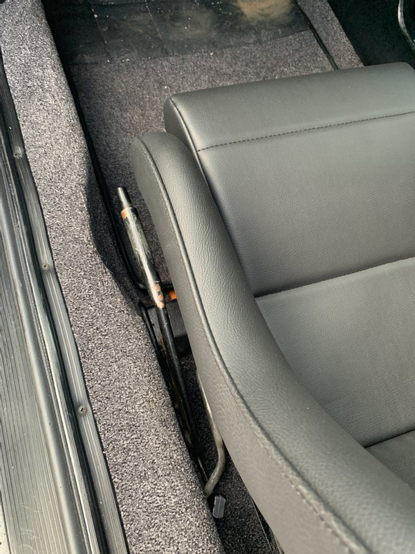

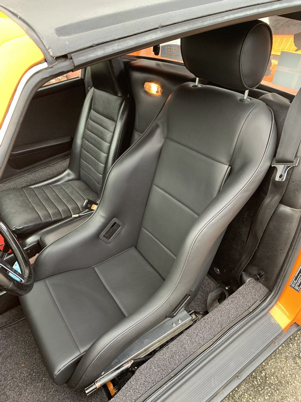

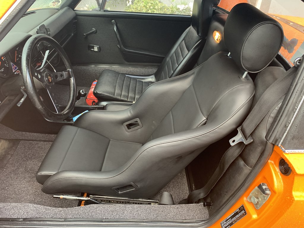

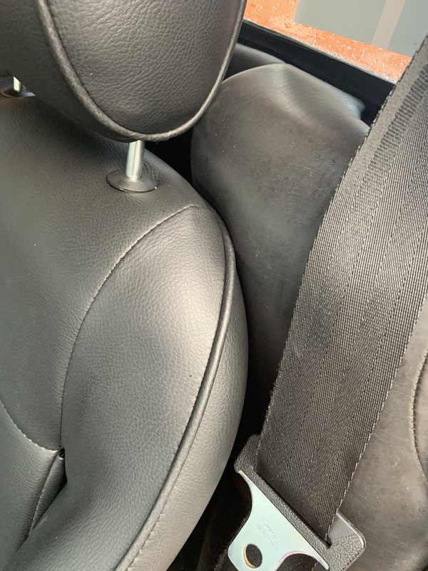

Trial fitted new seat (Cobra RSR) – narrow enough to allow handbrake access (many aftermarket seats are too wide), fouls backpad, but seat is in exactly the right place for me so undecided whether to remove backpad and replace with carpet, or not.
Another plus is that the RSR is a very shallow seat, about the same depth as the original, so no height problems there, either. Narrower than stock runners, so waiting for some material to arrive to make simple adaptor.
(IMG:http://www.914world.com/bbs2/uploads_offsite/i.postimg.cc-22846-1604999009.1.jpg)
(IMG:http://www.914world.com/bbs2/uploads_offsite/i.postimg.cc-22846-1604999009.2.jpg) (IMG:http://www.914world.com/bbs2/uploads_offsite/i.postimg.cc-22846-1604999010.3.jpg)

Nice job!

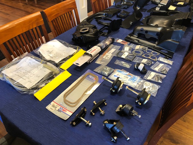

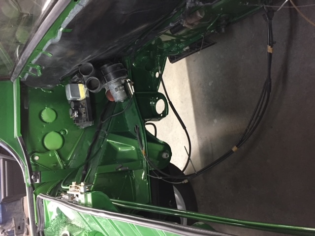

Getting ready to put the motor in the restored bay.

looks nice!! it’s kind of fun putting all back together, and once you clean up the car like that it’s hard to put any old stuff on that motor! might as well do it all! isn’t it nice we have so many vendors that supply literally everything you want or need?

Perhaps an upholstery shop could modify your backpad (if that is something you would even consider?) such that the new seat fits into the backpad better.
Seat looks like it offers a lot of support.
Very nice.

I'm probably going to remove the backpad anyway, as part of the 914's transformation into a road/comp car using full harnesses, but I agree a decent trim shop should be able to modify it to suit.

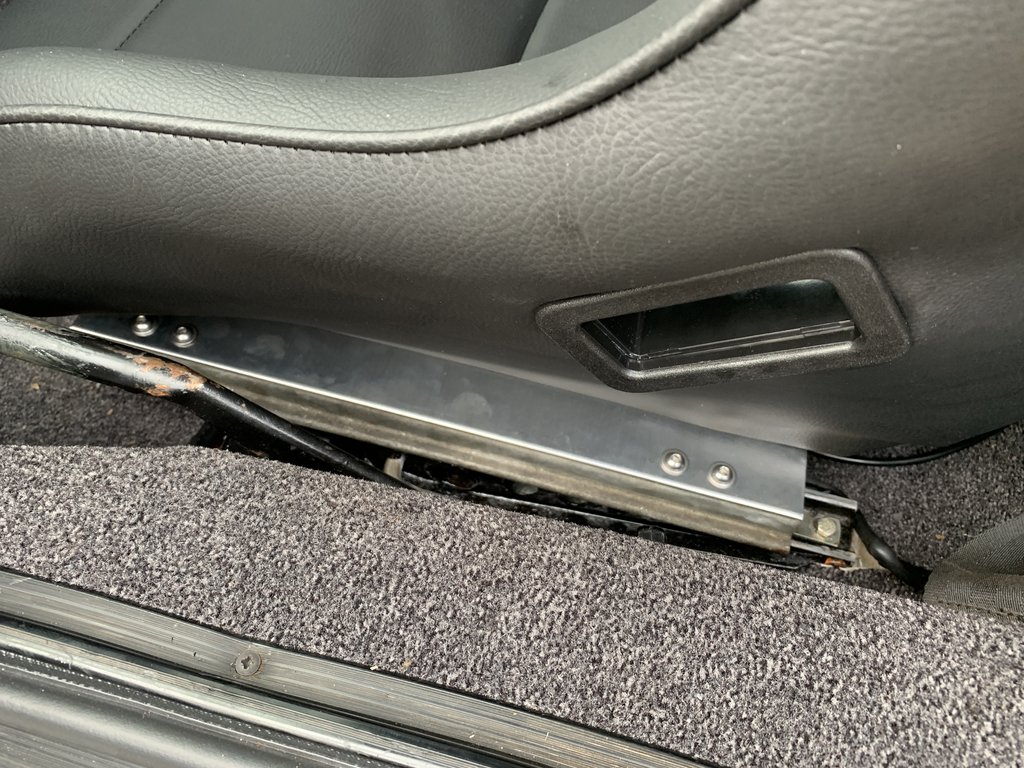

The seat is now fitted properly – very easy mod using the stock runners. Removed the runners from the original seat, bolted then to the underside of a 40cm x 40cm piece of 4mm-thick alumin(i)um, on to which the seat itself is then bolted. The height of the seat squab works out to be exactly the same as stock – I'd been worried it may end up too high. So, now have supportive aftermarket seats and all the benefits of factory runners and tilt mechanism. Perfect!
(IMG:http://www.914world.com/bbs2/uploads_offsite/i.postimg.cc-22846-1605256721.1.jpg) (IMG:http://www.914world.com/bbs2/uploads_offsite/i.postimg.cc-22846-1605256722.2.jpg)

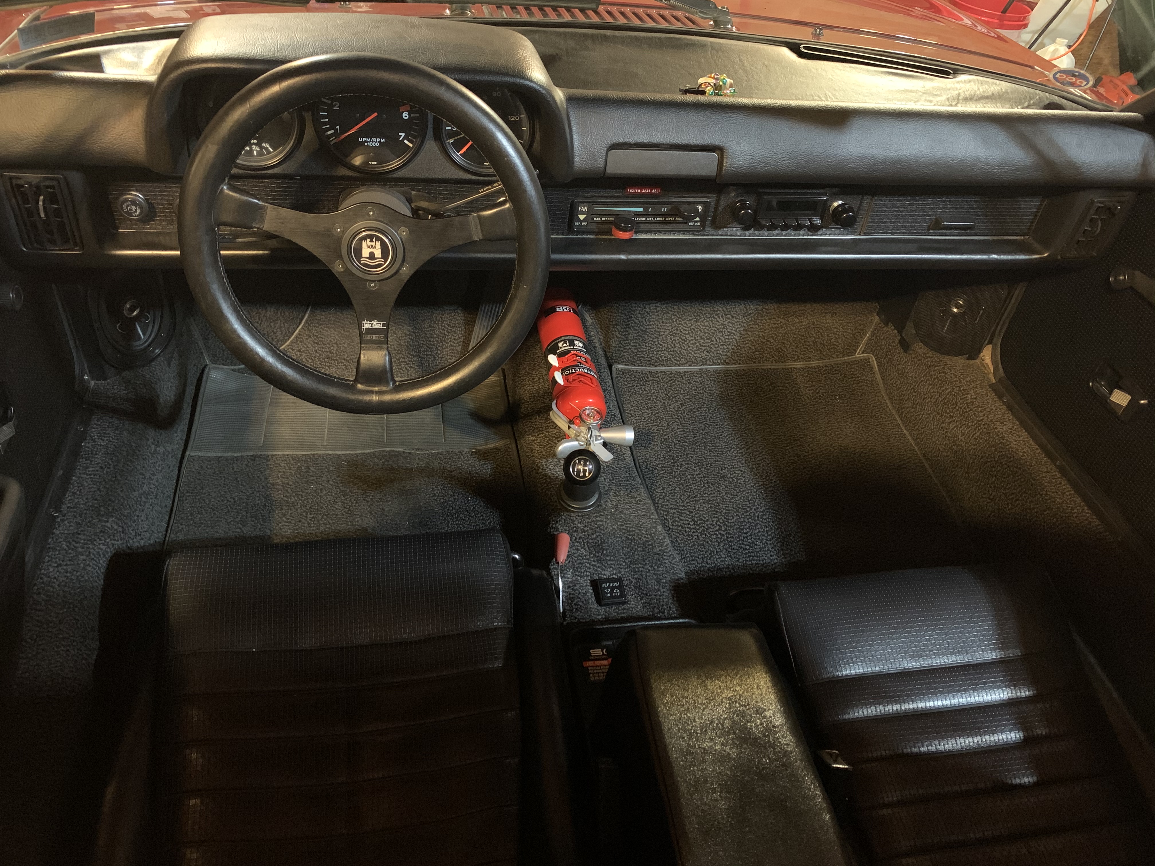

Installed Momo Jackie Stewart and Halon Fire Extinguisher.Attached Image

I rode in a car with a 3.2 and felt for back pad. It was night and day more louder than my 3.2 with back pad. The owner drives with ear plugs. Curious if there is a way to put dynamat under the felt? (IMG:style_emoticons/default/idea.gif)

+1 So much easier today than five years ago... great vendors make it fun.

I have a layer of Dynamat on the bulkhead already, and it made a huge difference. My plan was to try the felt/carpet on top of that and see– if it's too loud, I'll look into getting the backpad modified.
