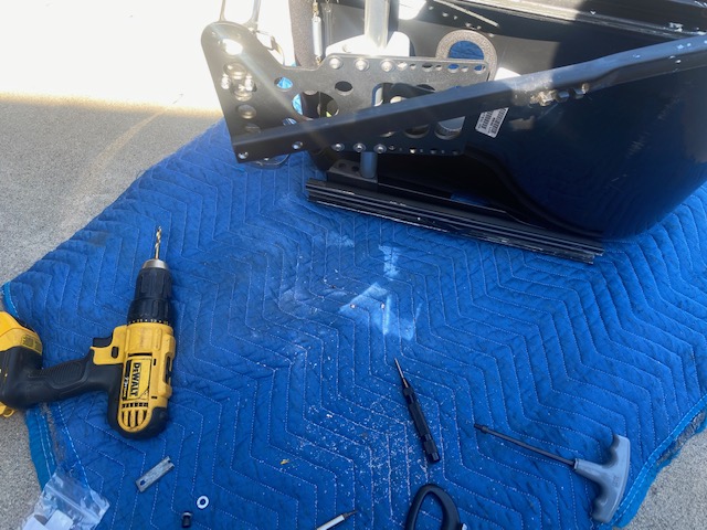

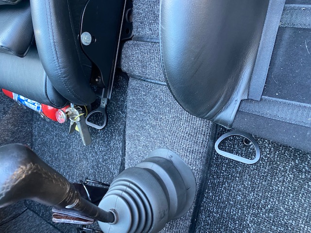

Had snapped off one of the seat adjustment handles when cleaning the car up for Luft8 (hadn't been washed in many months)...Of course the new ones look different from the old ones so you have to do both, 1st one took me like 45 minutes, the 2nd took like 10 (IMG:style_emoticons/default/laugh.gif)
Still need to reseal my Lexan back window but didn't want to take that on right before Luft, with the cage stuff in there I'm not sure if monkeying that window out is going to be easy peasy or a hellish endeavor

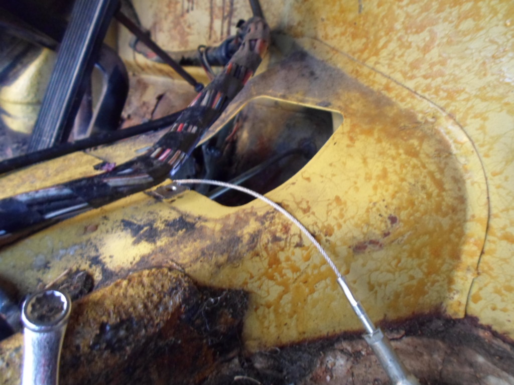

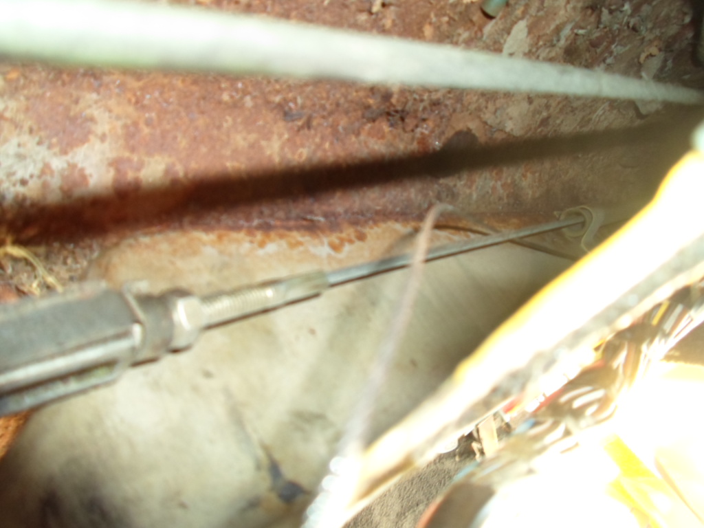

Installed a new accelerator cable in preparation for the installation of new Tangerine Dual Carb linkage install....
You can see how easy it is to wrap one with the clutch cable ( I didn't leave it like that).....as well as how rust and grime builds up in the tunnel....
Luckily for me...someone has previously "modified" the pedal board for easier removal....

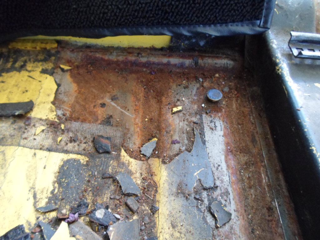

Speaking of rust.....while I had the seats and floormats removed, I couldn't resist peeling up some of the tar.....found some surface rust....but all in all...pretty damn solid.....removing all the tar.....project for another day(s).

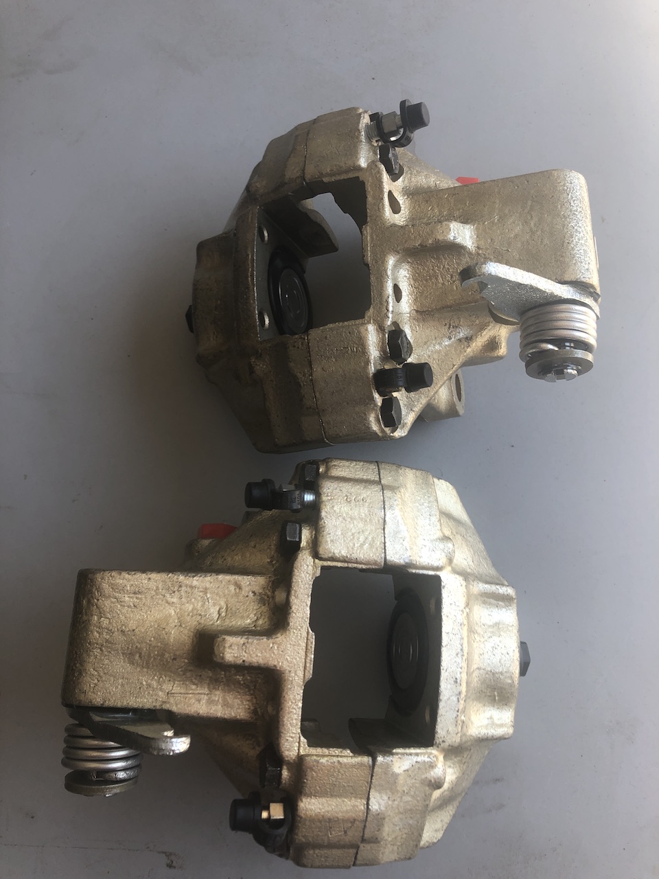

3 Coats of clear caliper paint on fronts and rears

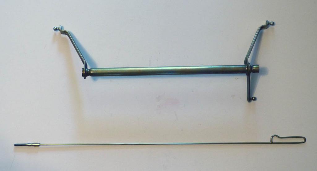

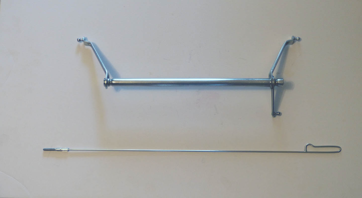

Did some more plating this morning. Had to get a larger container and mix some more electrolyte since these were too long. Three strikes of zinc....
and the dichromate dip. This pic has some dark shadowing, but in light the iridescence is nice. Much better than the previous black paint.

@914Sixer Did you use gloss clear caliper paint? That is all I have been able to find.

Yes clear gloss but it really is not that shiny. Had to order it, none of the parts houses had it in stock.

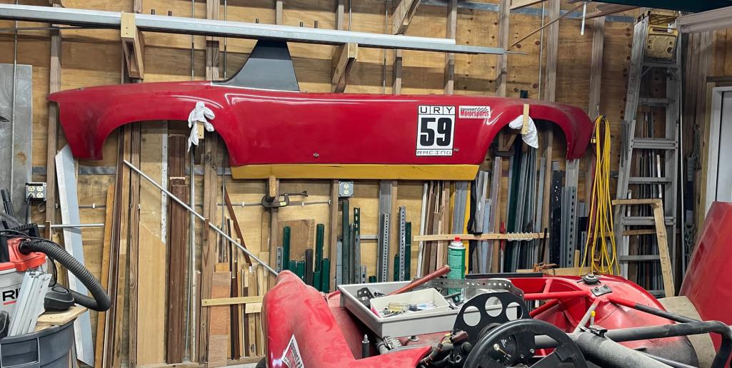

Here's something probably no one else has done. I hung the body on the wall. (IMG:style_emoticons/default/beer.gif)

Nice. !
Not the same
But metal
MIATA’s are &@$”.?!

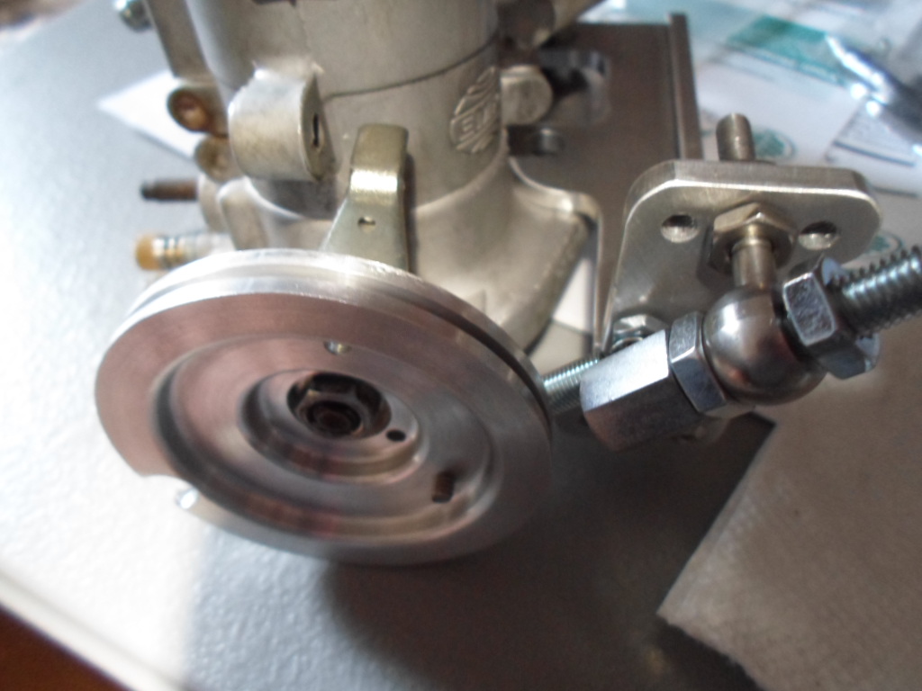

Worked on converting to Tangerine Cable Linkage....made a few mods, added phenolic spacers, but ultimately I'm gonna need to buy taller intake manifolds as I have clearance issues with the plugs.
