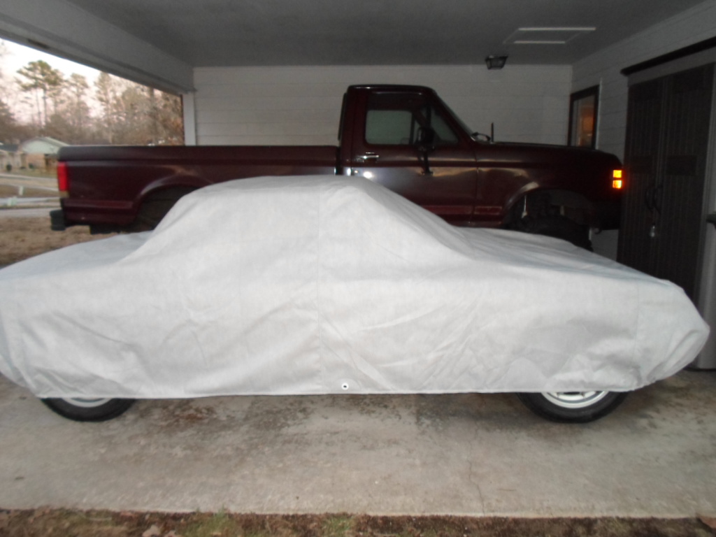

Washed it, drove it, and then put it back in the carport next to my other 30 + year old vehicle. Then I covered it with it's new winter blanket from CoverCraft.

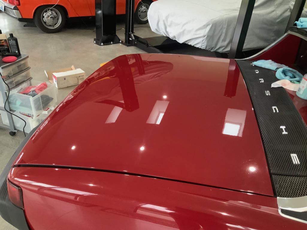

Started the paint restoration on a 46K mile original 76 2.0. Car was probably in storage since the 90’s, and it took three passes with a clay bar to get it to stop turning black from the oxidation and dirt. Cut polished with three different products and levels of wool pad, and then soaked all night in #7, followed by wolfgang.
The first pic was after washing and one pass of the clay bar.

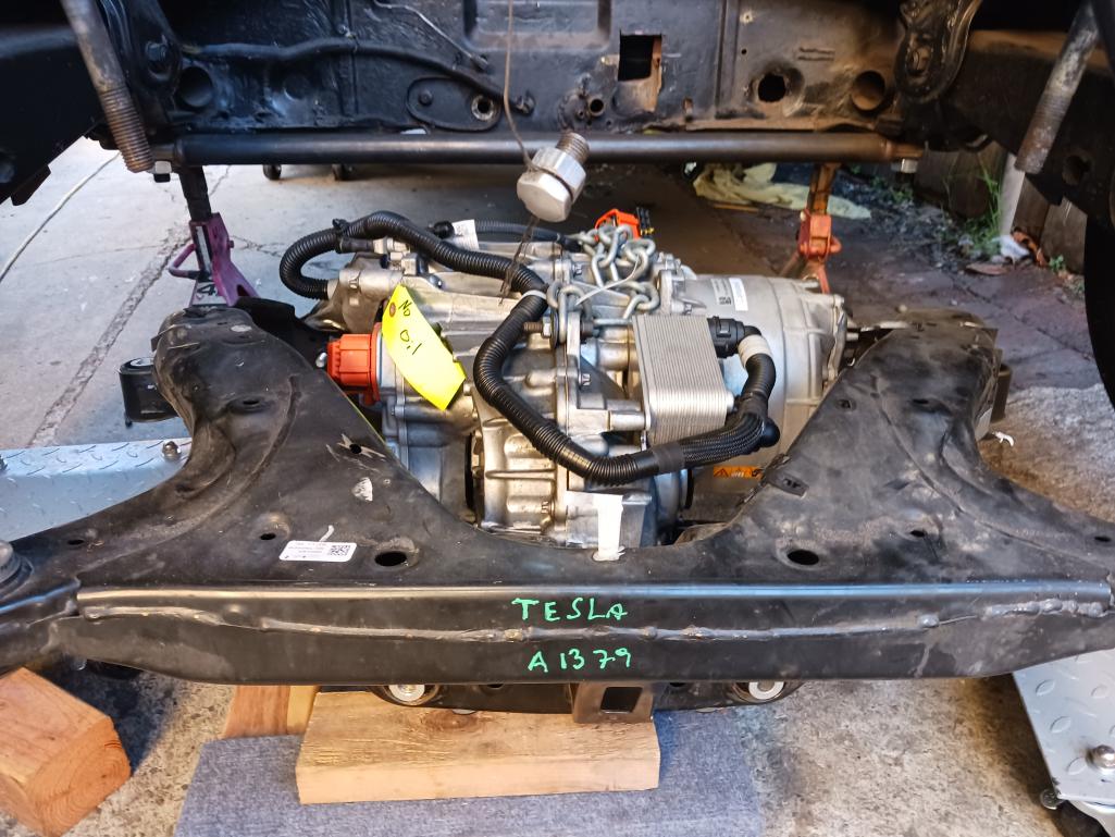

Messing around with mountAttached Image

QUOTE(Jett @ Dec 24 2022, 06:52 PM) *

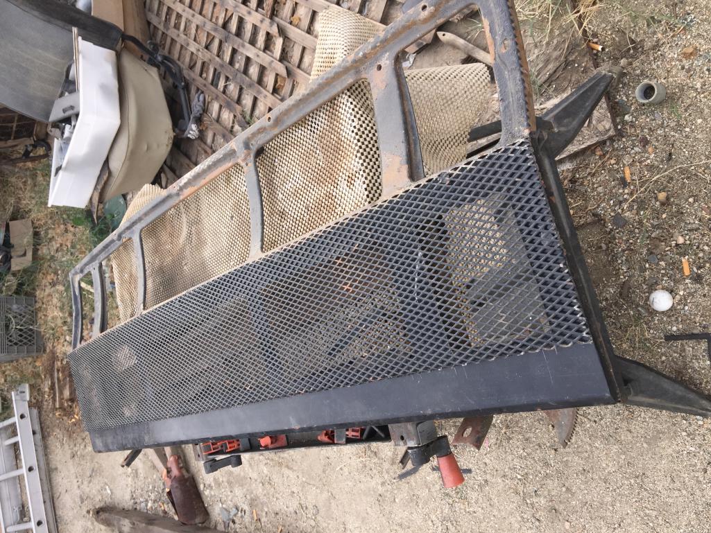

Started preparing to drop the engine for the first time. Removed the engine bay lid and found the brackets damaged and a PO fix of riveting a piece of aluminum angle iron below to keep them in place. That explains why the hatch was always a bit wobbly and sitting low. I may weld in angle iron to replace the brackets themselves - unless they are bolted in behind the seat back. Either way I am not touching this bit until I have the engine out ...

QUOTE(Chaznaster @ Dec 26 2022, 08:37 PM) *
After some searching, I see the brackets are still available. Might just try to tack them back together where cracked as they seem tight to the firewall. Just need to remove the bolt very messily welded to the right bracket ...
New ones are available from RD: https://www.restoration-design.com/store/product/PP343

QUOTE(Gatornapper @ Dec 26 2022, 05:35 PM) *
Wow. Stunning. And stunning find. Malaga Red. So much better than Guards Red.
Mine being repainted to original now.......wanna see full pics when you are done.
GN
That’s great… started on the trunk, which has three small places where paint is chipped.. notice that the lid still has factory sticker (IMG:style_emoticons/default/smile.gif)

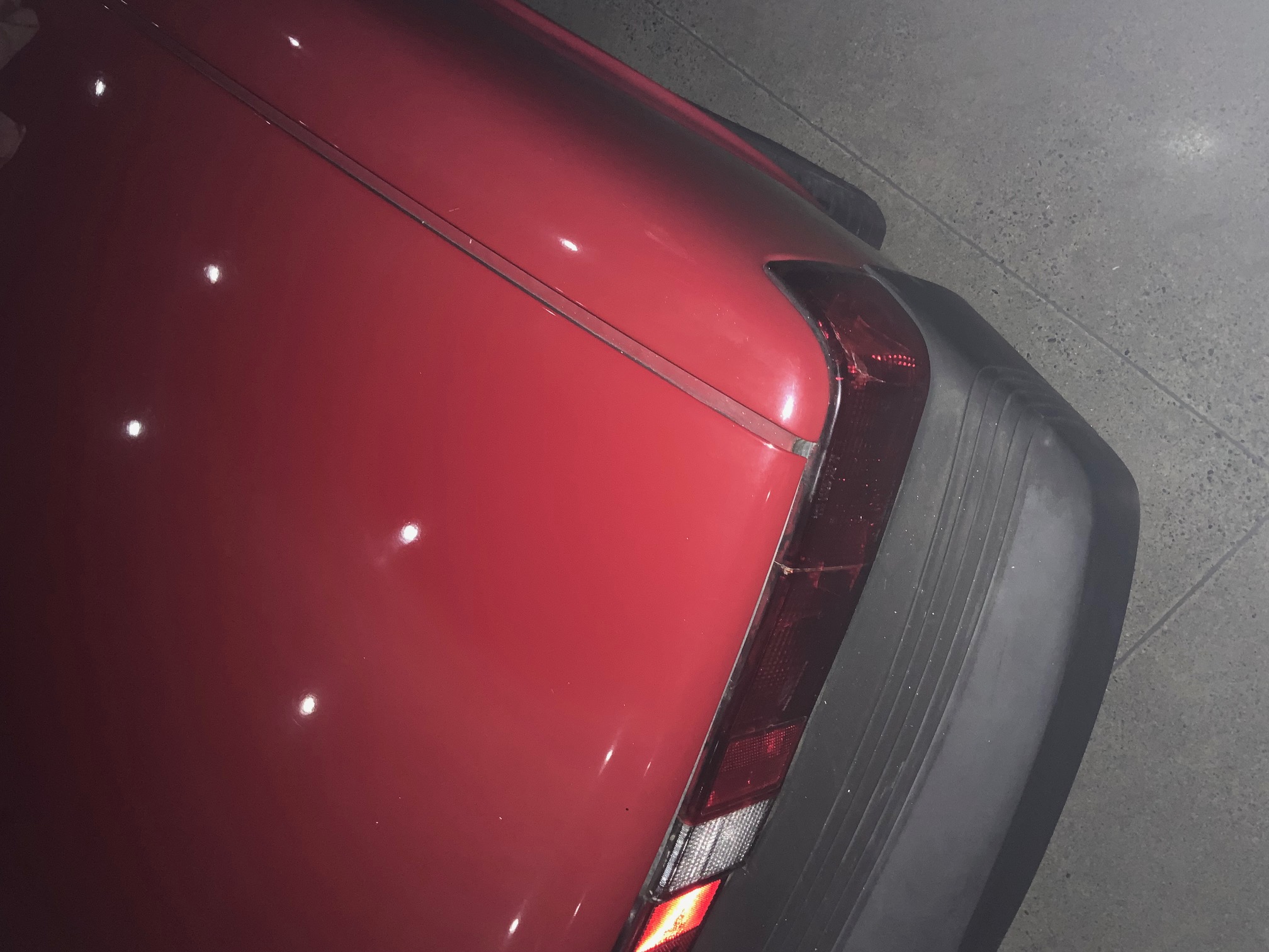

Took the 80’s Porsche plaque off the back and was surprised to find the emblems (IMG:style_emoticons/default/smile.gif). PO used black silicon to stop the taillight water leaks.. also did the fronts!… luckily I have a full NOS set of lights for the car. Looks like some welding and painting to fix this egregiousness!! Going to pull the bumper (IMG:style_emoticons/default/smile.gif)
fun project, that looks so clean, amazing low miles! going to be cool seeing it back on the road after such a long time, looks to be in good hands.
