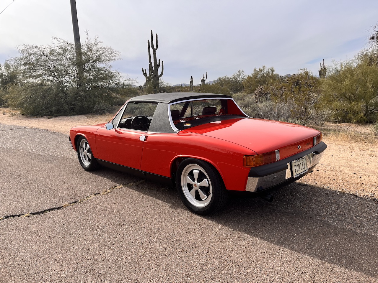

Felt bad for all my old friends back in the midwest buried in snow so took the '73 out for a drive after putting on new tires. The old tires were at least 20 years old and drove like bricks...Attached Image Attached Image

Beautiful car. (IMG:style_emoticons/default/smilie_pokal.gif) Those wheels really make the entire car 'pop'.

wow 20 yrs old tires?
Now definitely and big big difference with new tires!
Again, your car is beautiful!

SKLI.... That has to be the best looking 914 I have ever seen. Great picture!

Thanks guys- Harvey Weidman is the man for Fuch's. You may have to wait a while, but it's worth it!

Are these 16 x 6’s?
Your car looks fantastic with these on. Clean and super nice

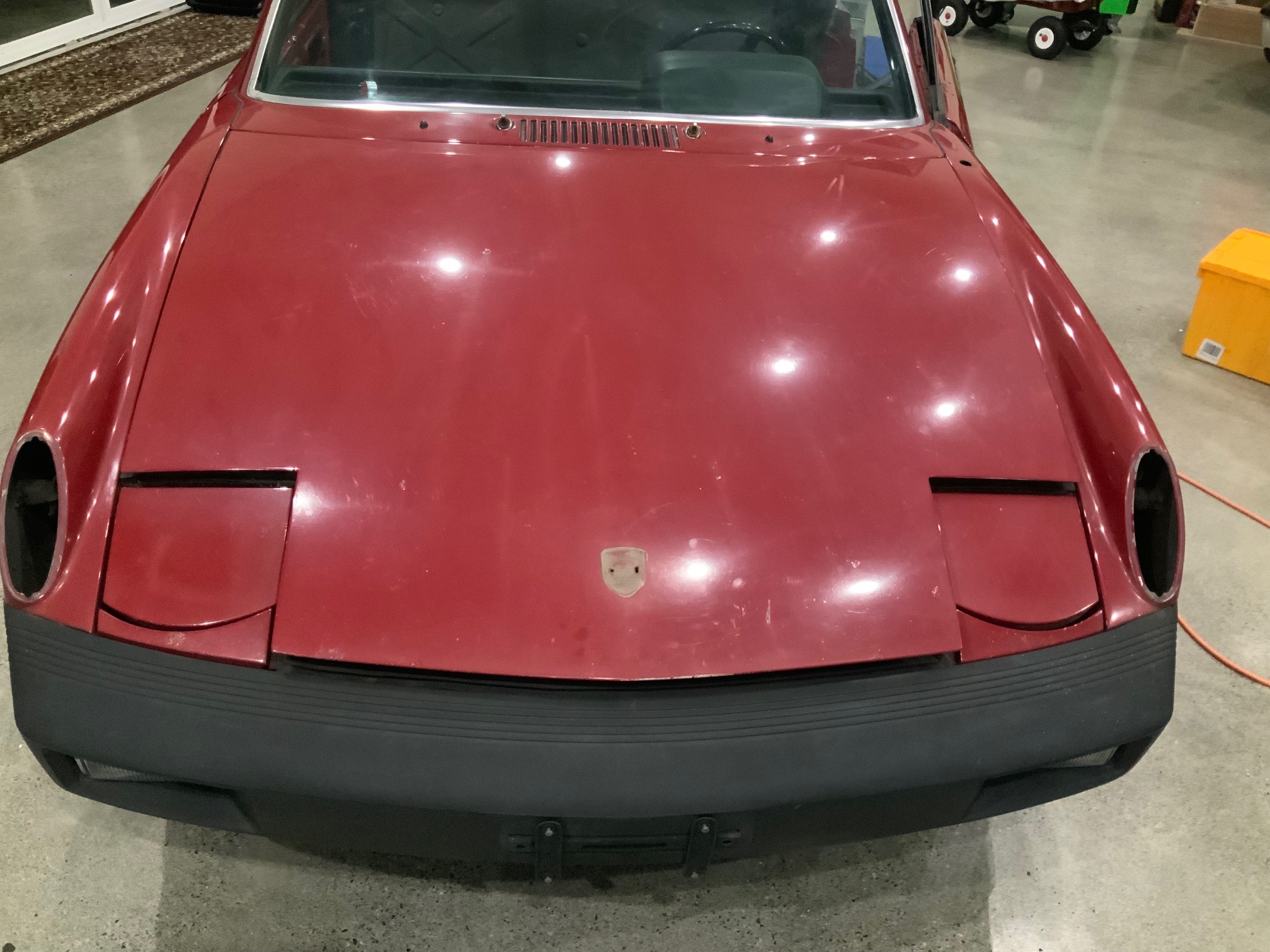

Finally getting to the hood and fenders, but have to deal with welding the hole from the PO. Why do people put these badges on our cars!

Yes, 16X6, off the front of G body 911. Perfect for 914 with upgraded hubs. 205/50/16 tires of which there are great choices.

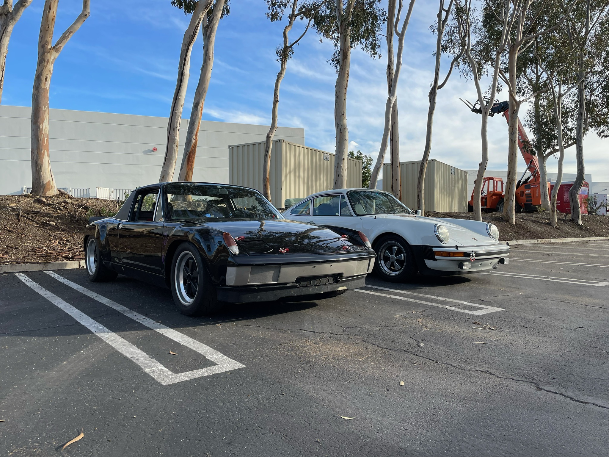

Had my own two car show, had to get them out of the way so I can start cleaning out storage…

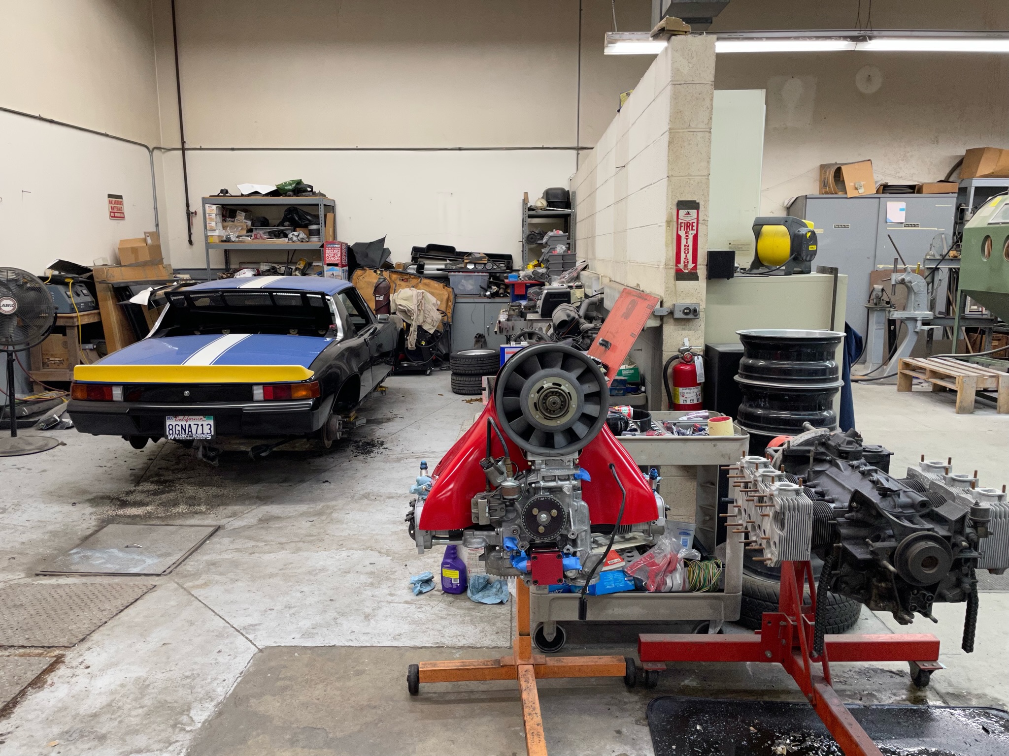

Pulled the drivetrain out of the Six for degreasing and maintenance work.
The engine is covered in de-greaser in the pictures. I finished cleaning it last night. I cleaned the heat exchangers too.
I am going to do the timing cover gaskets, adjust the valves, replace the plugs, fuel filter, air filter, and the fan belt. I do the fan belt every time the motor comes out. It is much easier to do it when the engine is on the ground, and fan belts are cheap.
I found that is is easier to remove the motor for stuff like this rather than fight the limited space in the engine compartment.
I also found that we have a split CV boot on the right inboard joint. So that will get fixed as well.
Getting him ready for the Texas Hill Country rally in March!

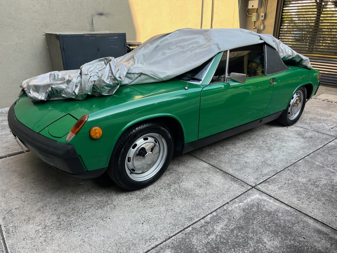

It's been raining pretty good up here so my car is hibernating in the garage.

get some 20x30 prints of those pics and put them in your office/man cave/living room. That is one nice looking 914!!
btw: my 914 has full tread 30 year old Michelin XZX's on it. These were the tire to have 30 years ago. It's a shame the car never ran any miles on them...I will be replacing once the rebuild is a little further along.

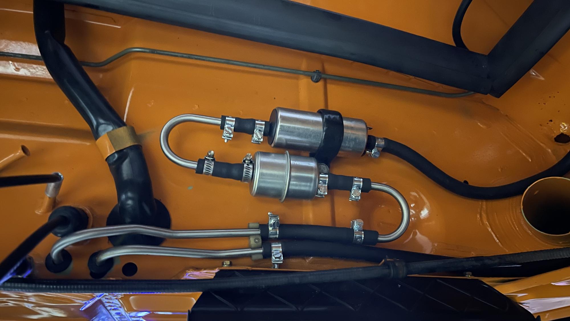

back dated fog lights, mocked up front...adjustments down the road.
Installed fuel pump/filter.

Car is looking great!
