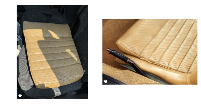

I fixed my seat cushion today. The guys in the shop did a great job

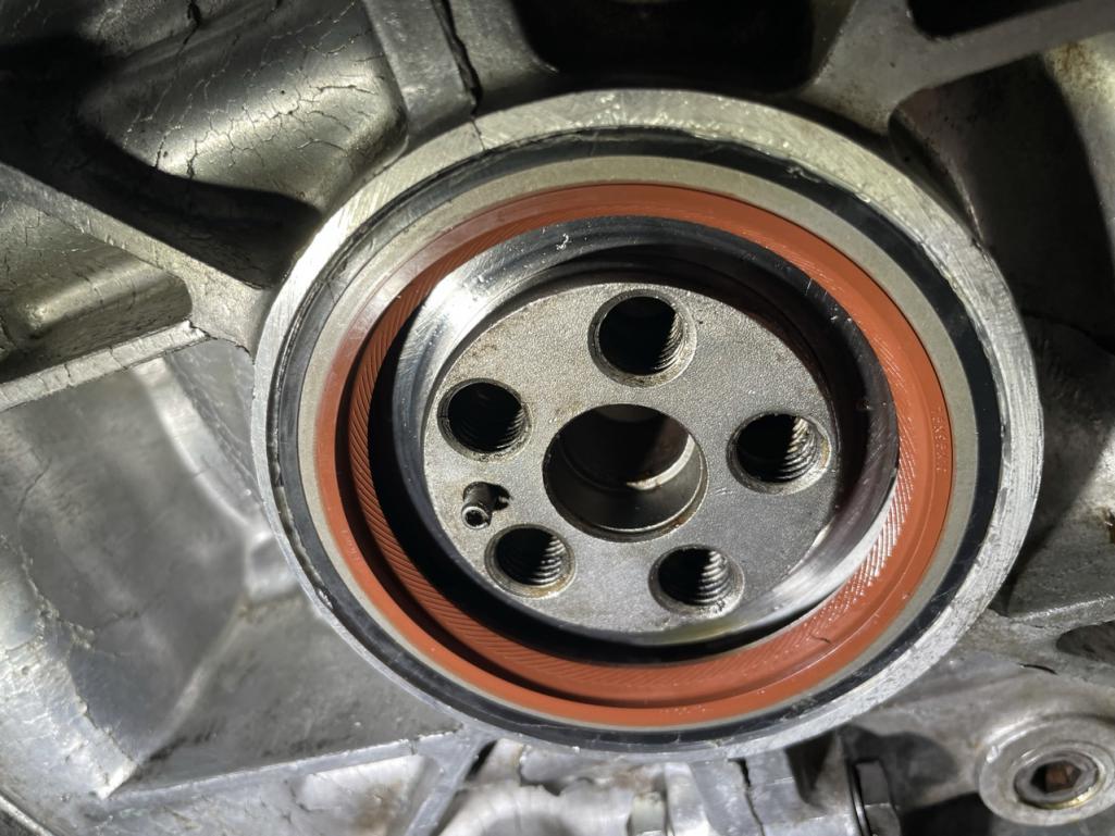

good to know except we’d have to do that when the motor is being built so i guess that’s an option for a future build.
I finished my install of new RMS from Ehrling, and the motor is back in the car- i did notice when i pulled the flywheel there was a lot of oil behind the seal !

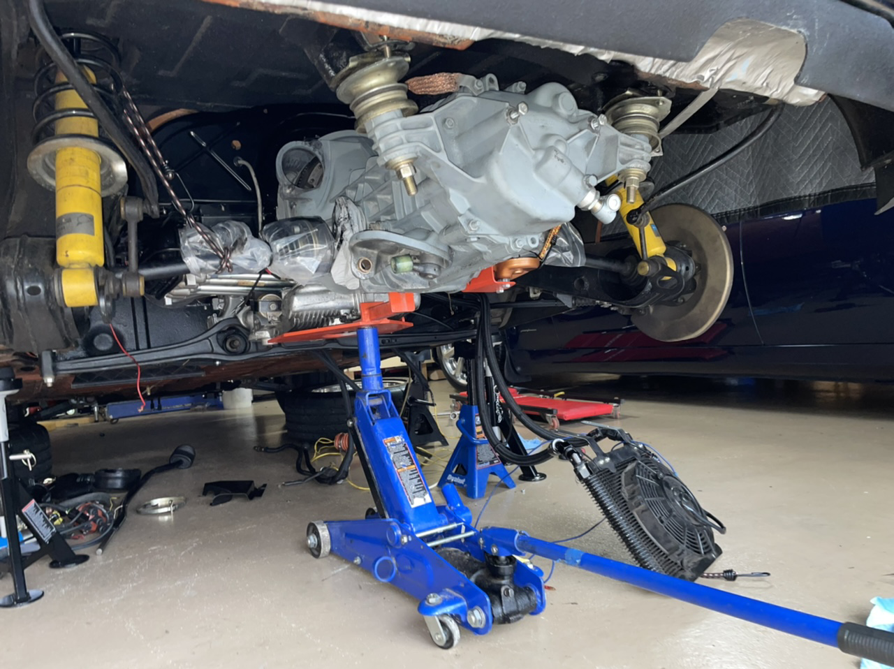

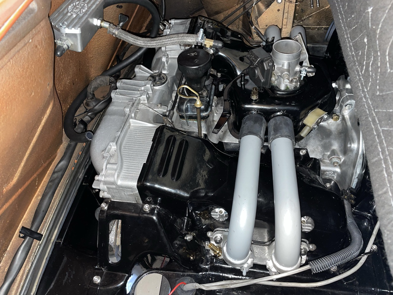

I finished up the install of a new rear main seal we did the pushrod two seals on the driver side since they were dripping slightly as well and mound of the transmission clutch etc. and the motor is now back in the car it’s been a busy weekend

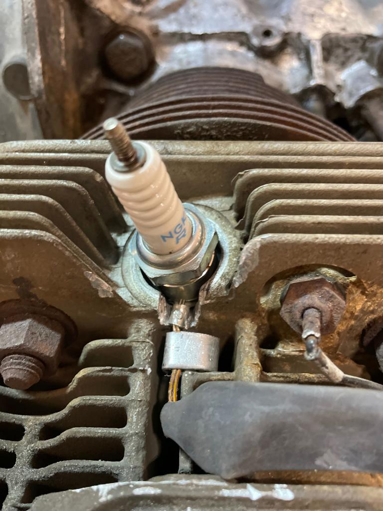

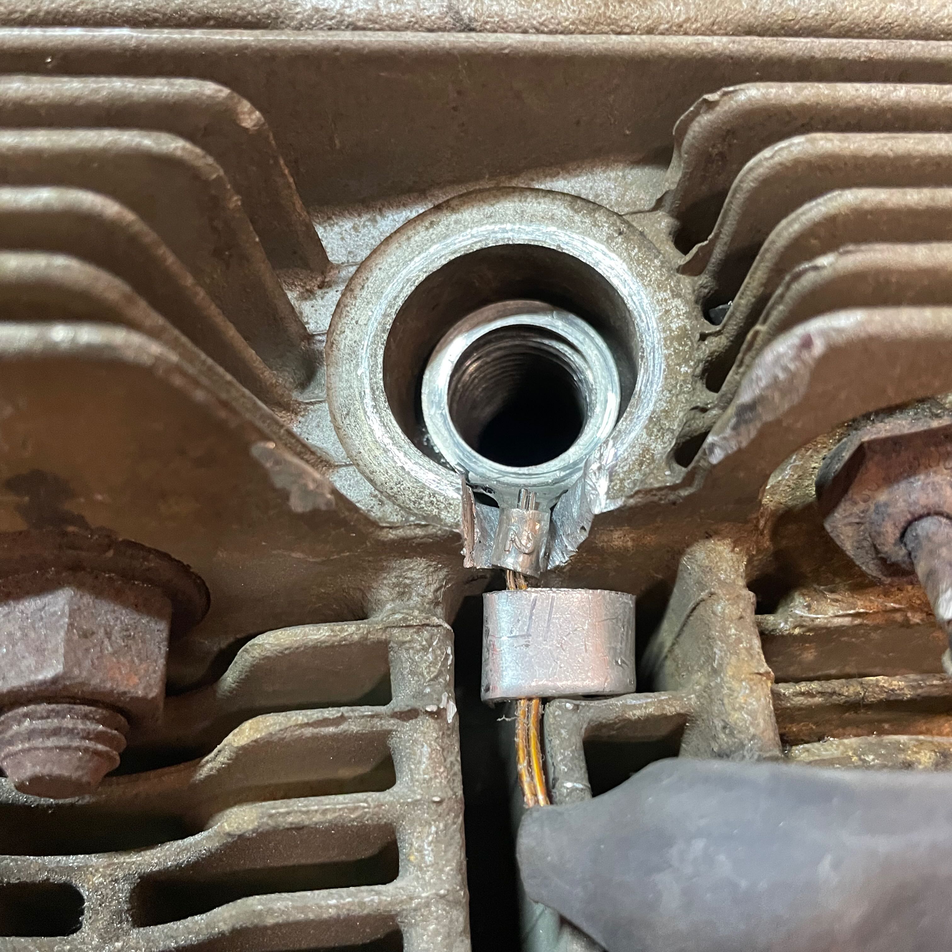

Installed a Dakota CHT sensor. Cut a channel for the TC wire to travel.

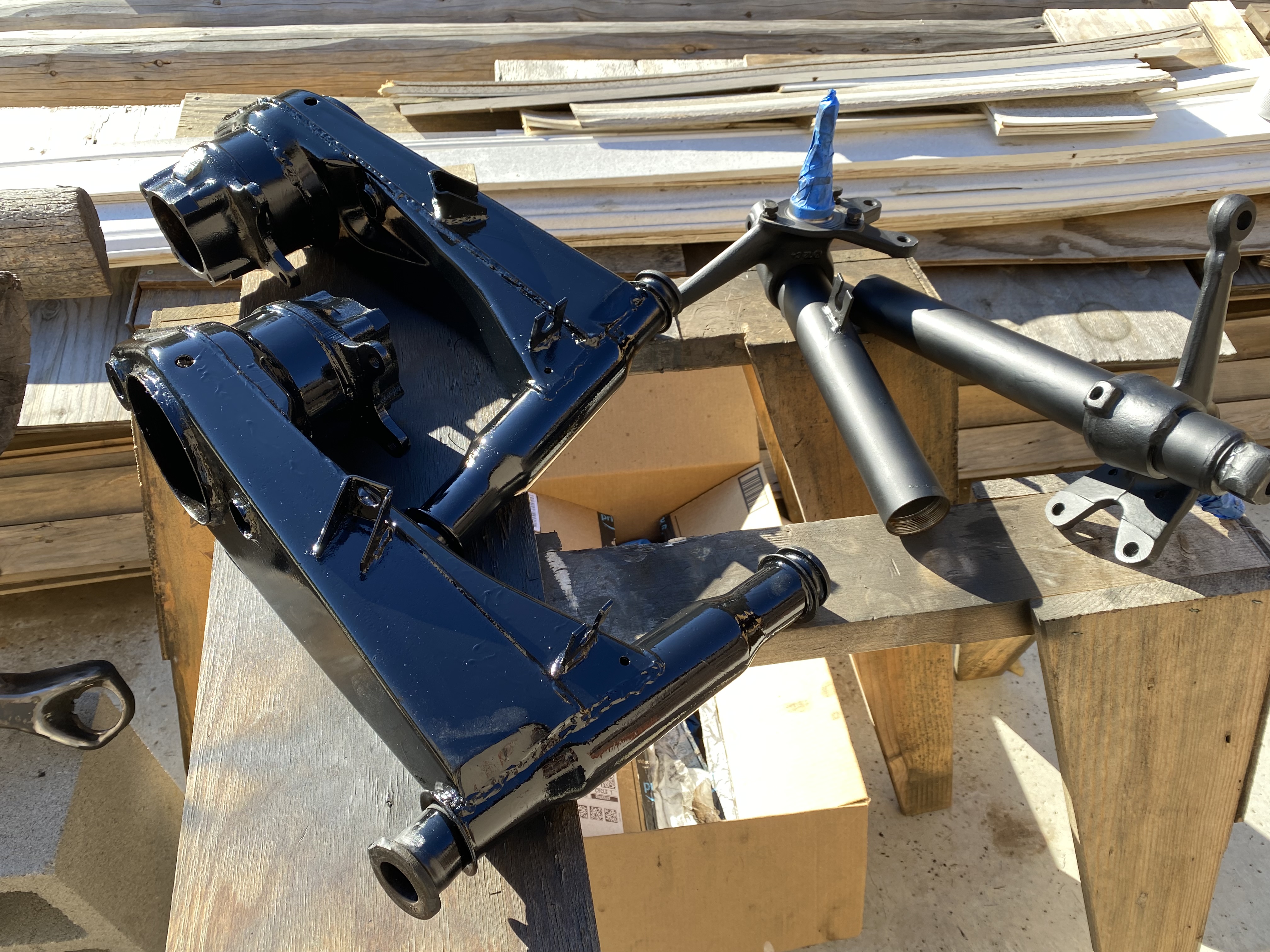

QUOTE(Jeffs9146 @ Jan 3 2012, 08:41 PM) *
Here is what I started today.
Remove old 4 lug suspension and get new 5 lug suspension finished! I am busy the rest of the week so I will have to wait until next week to put it back together with my 16x6 fuchs for the front and 16x7's for the rear!
Nice!
I’m doing the same exact project but keeping the 4 lug pattern with Superlites 16x7 on all four corners.Attached Image

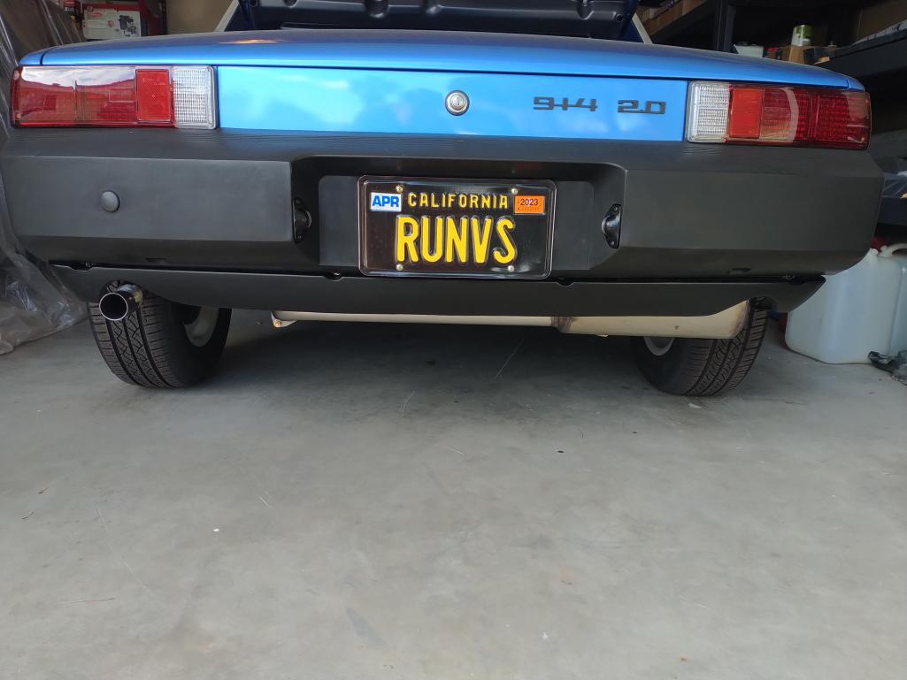

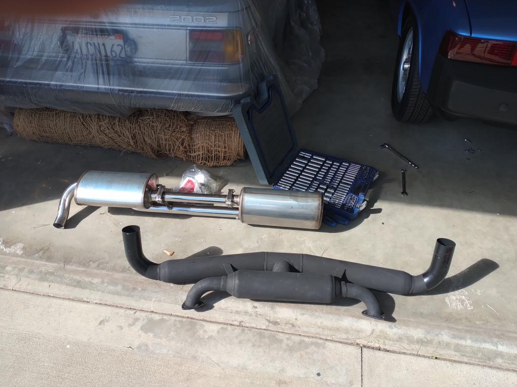

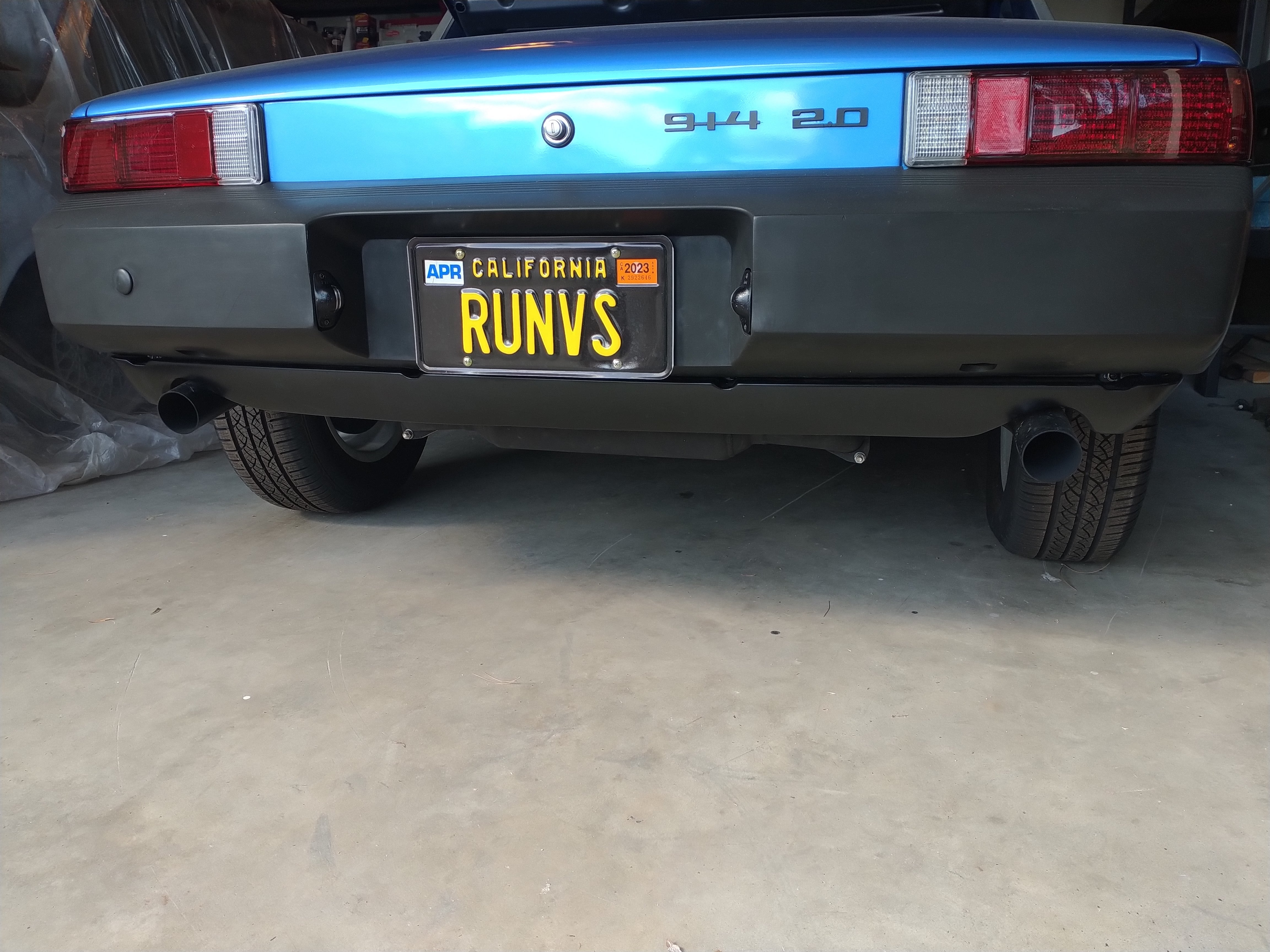

Out with the old(ish) in with the new. Now maybe my wife will go on rides with me. (IMG:style_emoticons/default/smile.gif)

I admit I loved the SS 2-in, 1-out muffler I had on my car and no doubt would still be running it were my ears 20 years younger. But I am glad I switched to a stock muffler- my ears thank me every time we go for a ride. My wife likes the difference too- though admittedly, she is not in the car that much. She likes when I get out of the house and leave her in peace. (IMG:style_emoticons/default/beerchug.gif)

QUOTE(Chaznaster @ Feb 12 2023, 05:49 PM) *
How hard is to to cut that channel, what tool do you use? Do you leave the spark plug in the hole or plug up the hole with something ? My engine is out of the car so it will be easier.
Sorry for all the questions.

QUOTE(913B @ Feb 13 2023, 02:56 PM) *
Thanks,
I started with a carbide Dremel bit but it got fouled by the aluminum so switched to a Dremel cutoff wheel. Not as neat a job as with the carbide bit but it got the job done. Filed it near the end to flatten the bottom of the channel.
For the metal shavings, I removed the spark plug and filled the hole with some of the tacky stuff used to hang posters (fun tak?). Then vacuumed the hole out before puling the tacky stuff out. It seemed to work pretty well.
