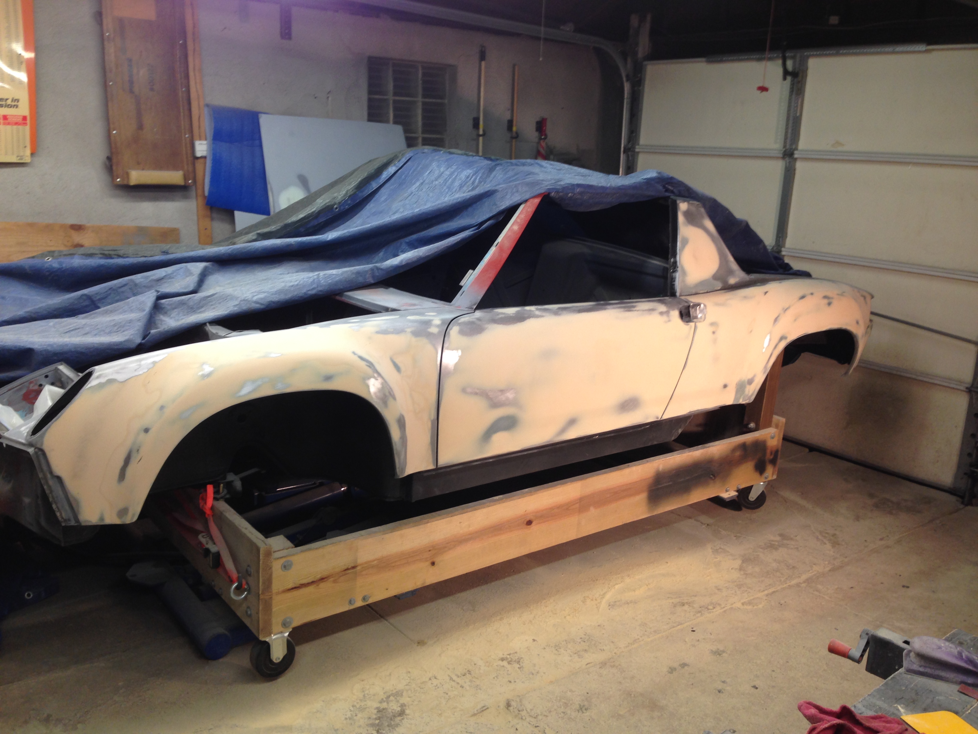

Finished the filler work on the drivers side. Slicksand tomorrow. Takes me forever because I'm an ameteur. Not looking forward to the trunks, cowl and engine bay.

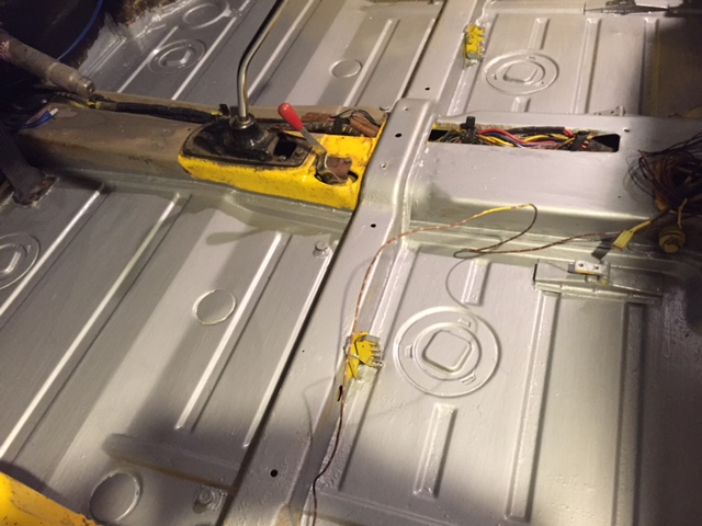

Finished preserving my original floor pans (de-tar, de-seam sealer, wire wheel everything, ospho, 2 coats rust bullet). I may brush on some new seam sealer this week.

So far, so good. I haven't had great luck with POR-15 (and neither have many others), so I figured I'd try RB. The pros recommend epoxy primer, but I'm not really set up to spray. My floor pans were in really good shape to begin with. Arizona/California car and I don't intend on ever taking this out in winter or rain here.
Brushing RB on was super easy. I applied 2 coats. No topcoat. I'll be putting dynamat-type stuff over most of the floor pans to replace the tar.
As I understand it, the Ospho is what does all the work with stopping rust. The RB just seals the metal and prevents moisture from getting in. Let's see how it holds up.

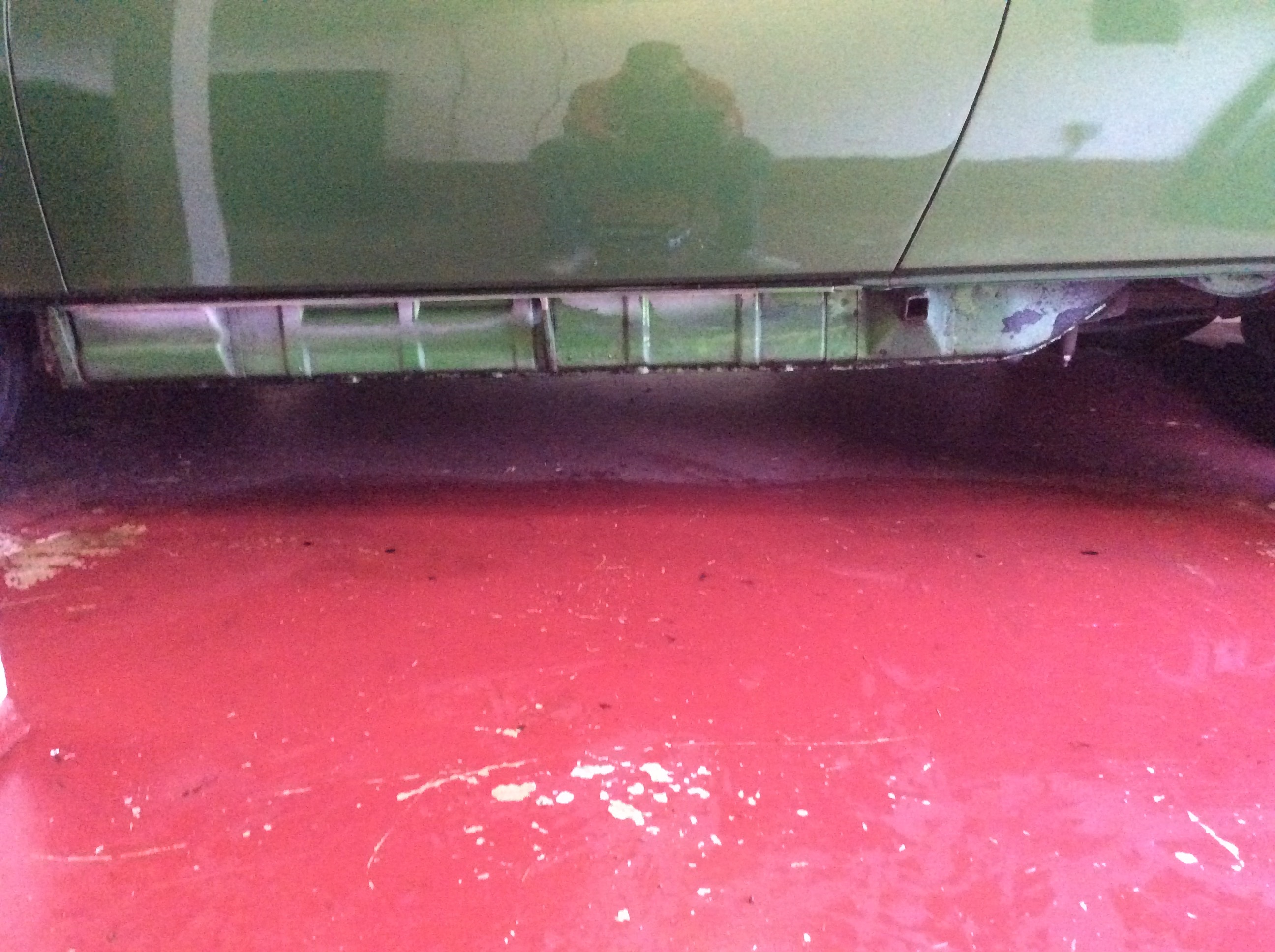

Finally built up the courage to pull the rockers of a newly purchased 75 2.0.
Not too bad (IMG:style_emoticons/default/smile.gif)

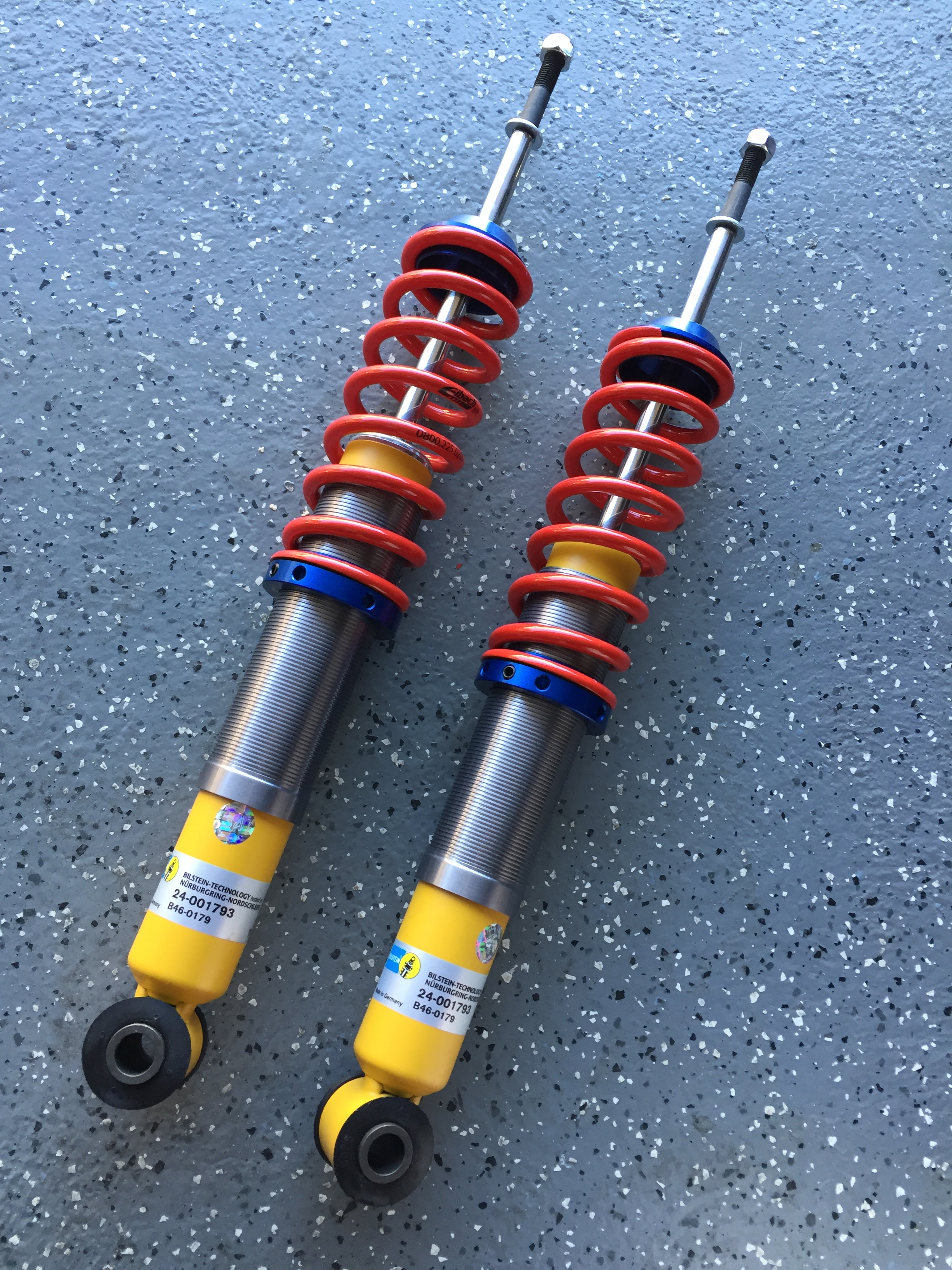

These were at the front door (I unpacked them for the photo op) when I got home today. Bilsteins with collars and springs. Fully adjustable.
BTW, I can't say enough good things about Clint at Rebel Racing!

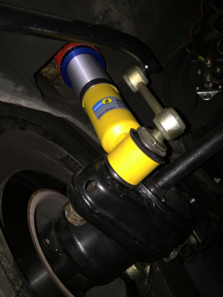

Larmo63
post Feb 10 2016, 08:06 PM
Post #7178
Posts: 4,267
Joined: 3-March 14
From: San Clemente, Ca
Member No.: 17,068
I had to dive right in….

QUOTE(Larmo63 @ Feb 10 2016, 06:06 PM) *
What size did you get? I have there 175 lb springs on the rear of my car.
Seems to work nice with my 21mm torsion bars up front.
I need to go to an autocross to know for sure
I adjusted them for a 1/2" rake front to rear
